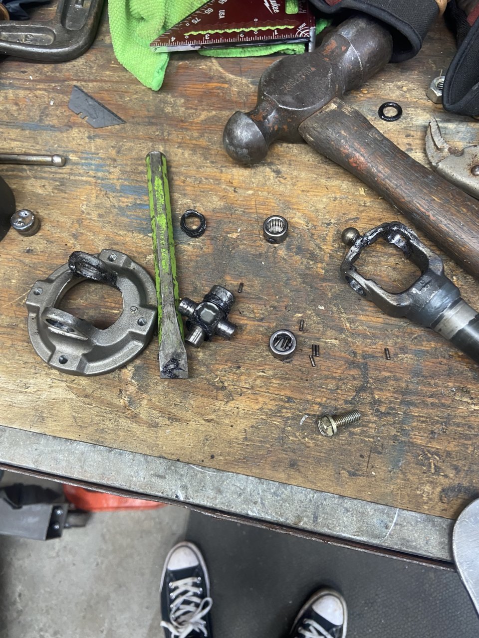

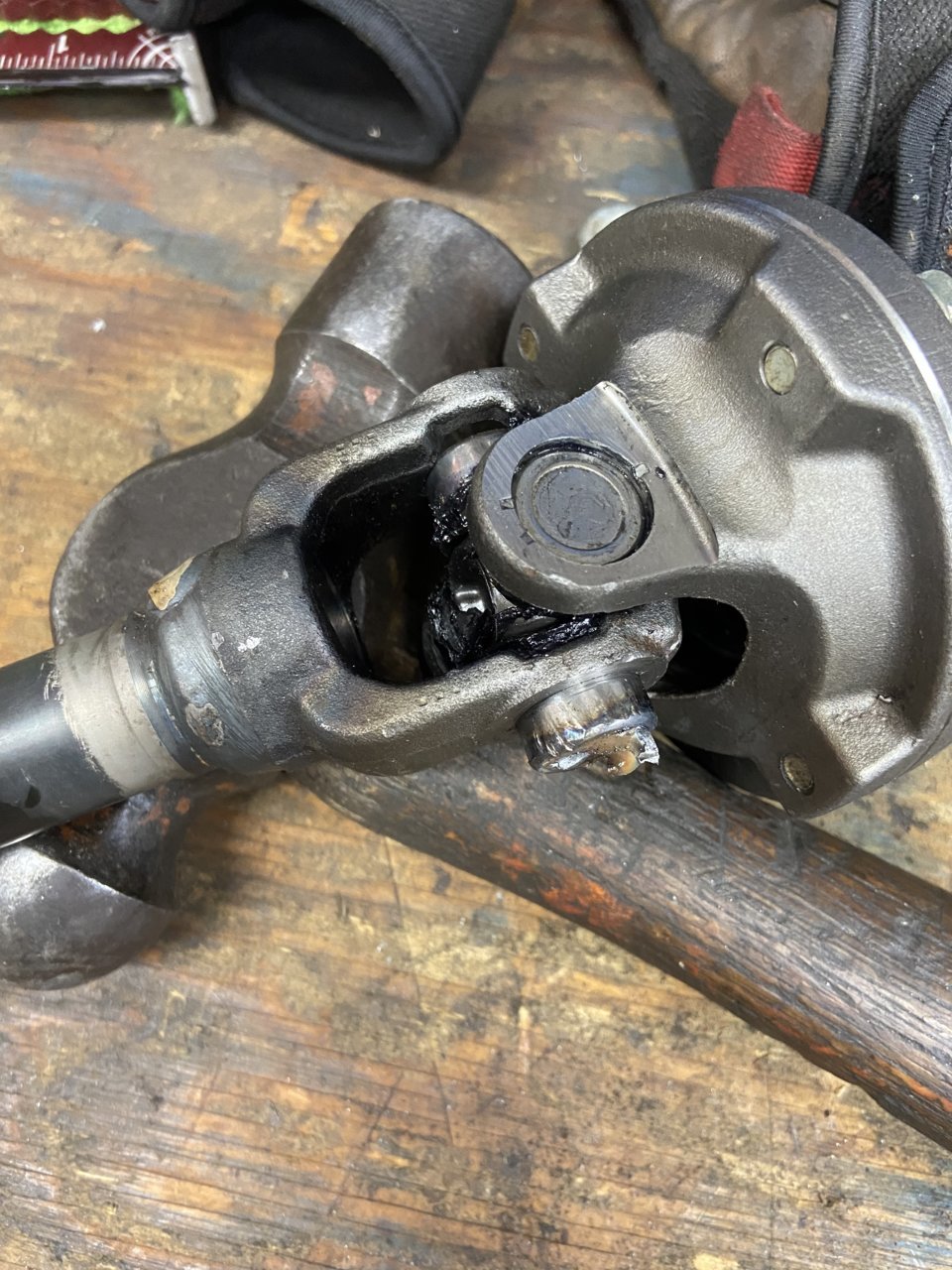

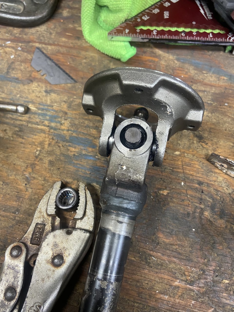

    i got my joints and they are true 3/4 and too big. Gonna weld one to steering wheel side but I have to use the parts on shaft to make another. I can’t get the damn you joints out clean. Have you ever done this?? Have one practice joint then I have to do it right on other side.
    5F8D406F-EBCB-4D61-A3C1-D5E3FE2DA429.jpg 2EE19DC6-FDCB-4CC7-93DB-776D94CB89EB.jpg
    got it but idk if I can do one clean.

    I tried and they are staked in there so, so basically a PITA to pull without destroying them.

    Yep! I got 2 out and was able to salvage 4 caps but when I repressed them the joint was super stiff. The caps can’t handle the press and cave I think. And I can’t find them local.
