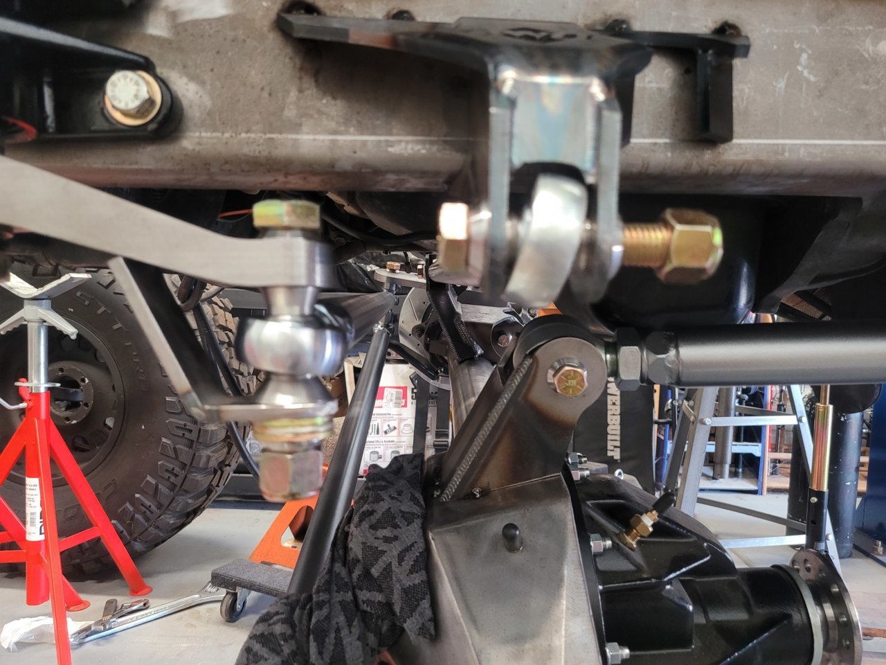

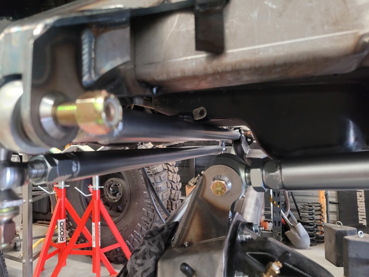

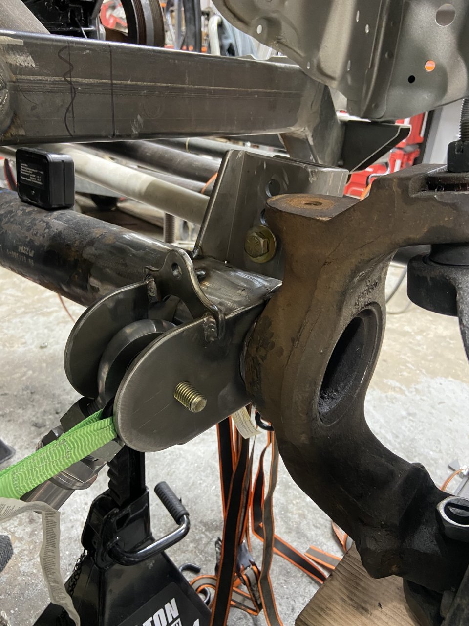

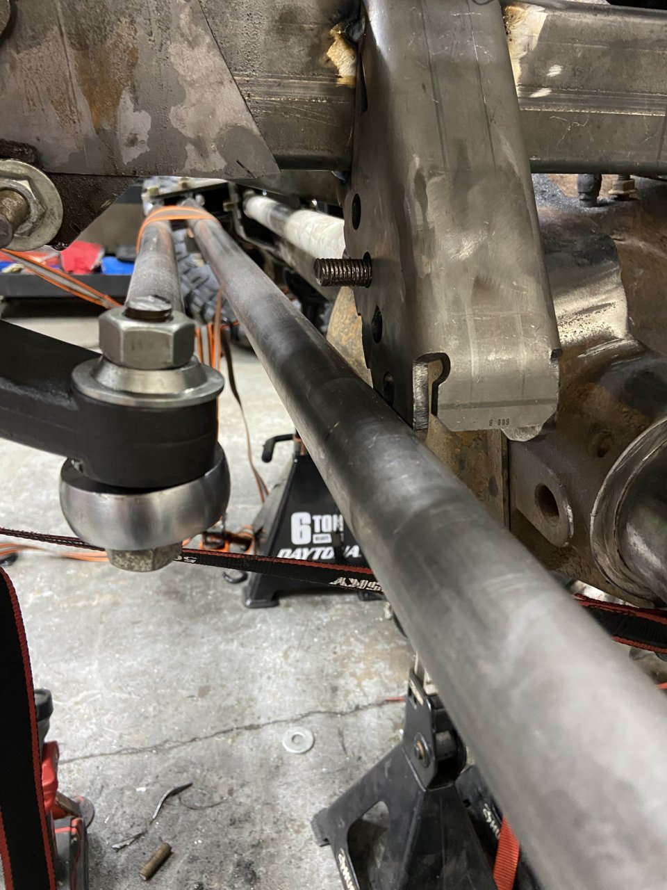

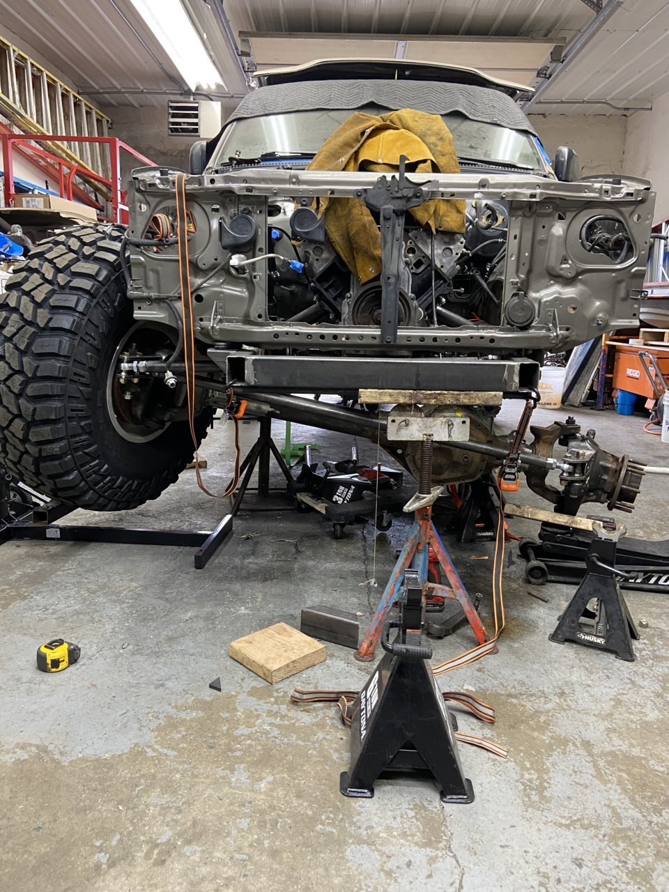

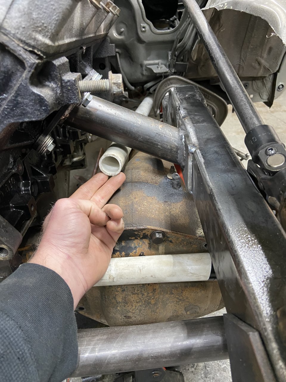

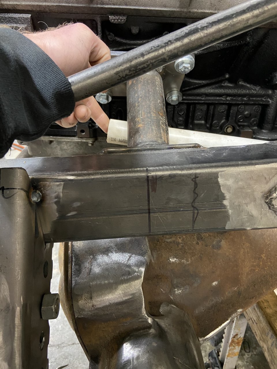

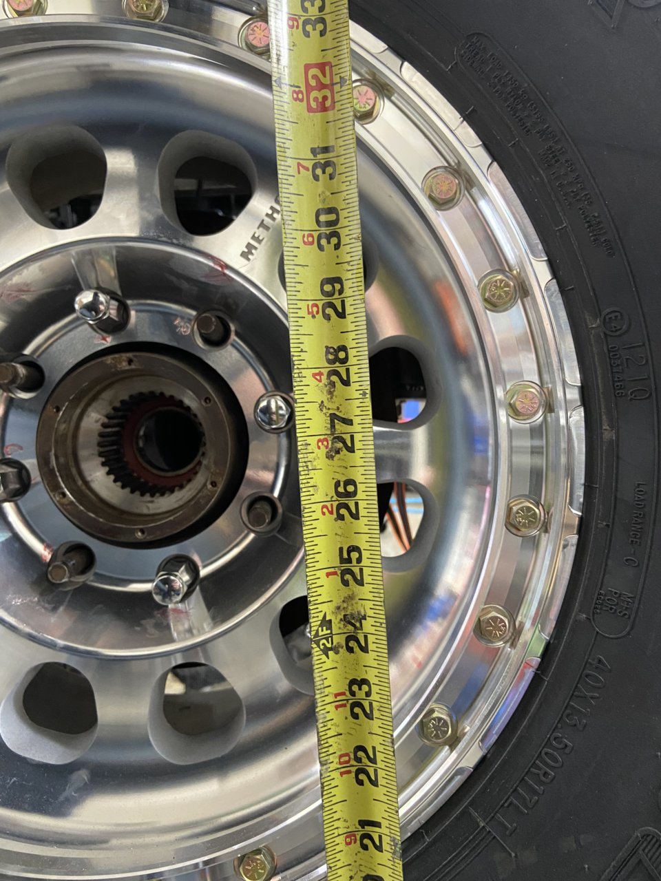

    2F105F77-1239-426D-9740-12A297B40D89.jpg Trying to get shit done today. Have to trim Panhard mount at frame and put two bends in the rod if I want to get to 26” center of axle and clear diff cover at full steer.

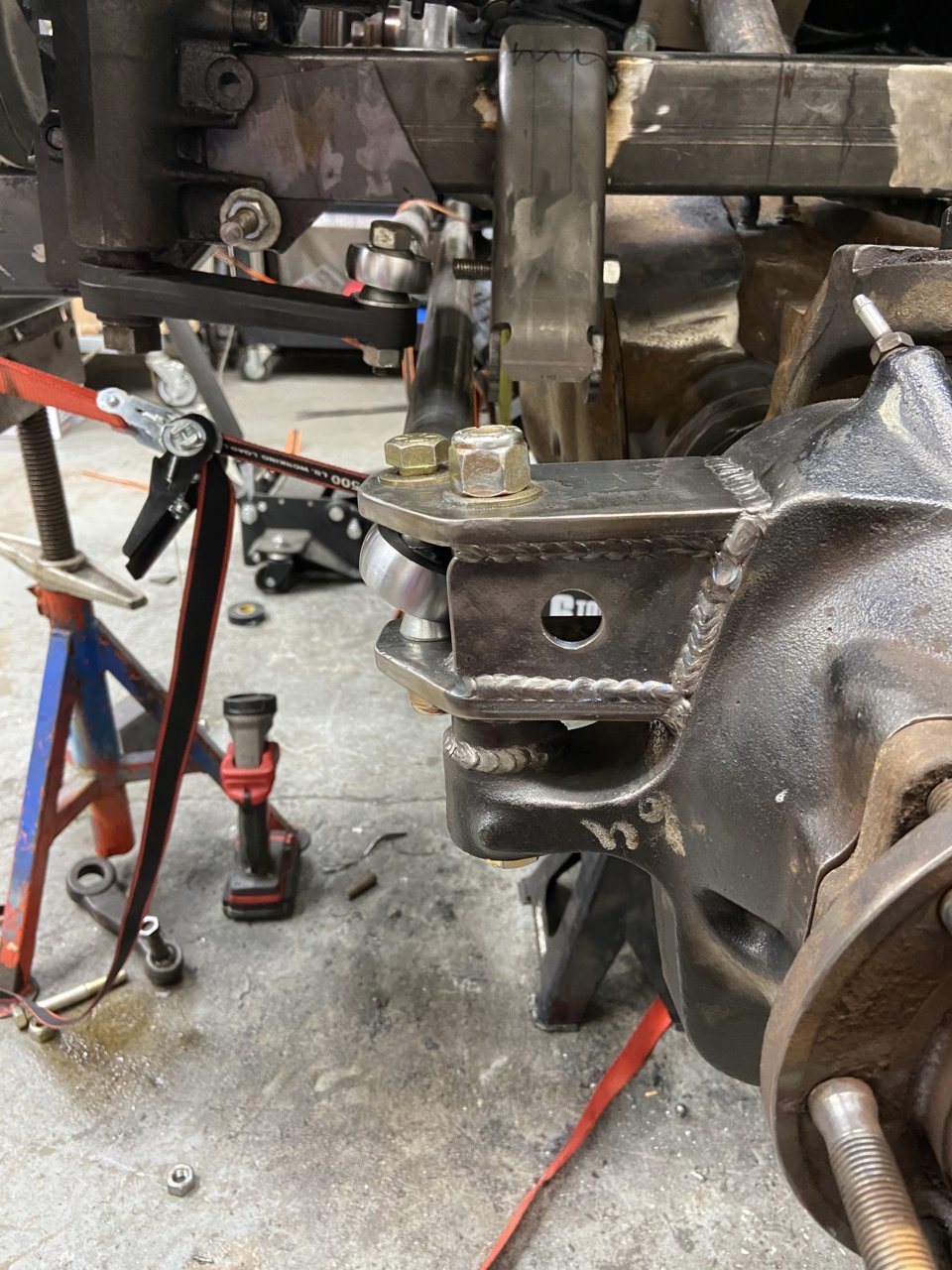

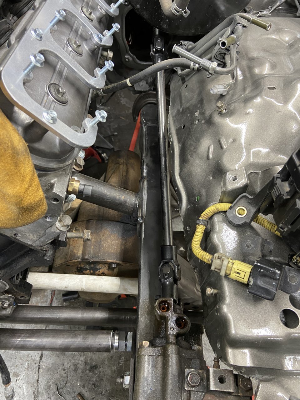

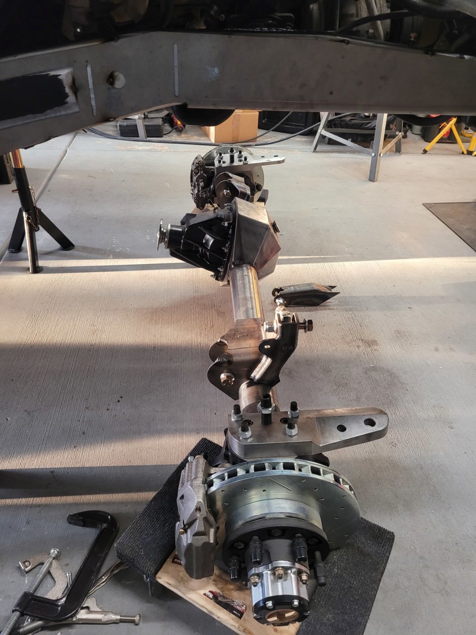

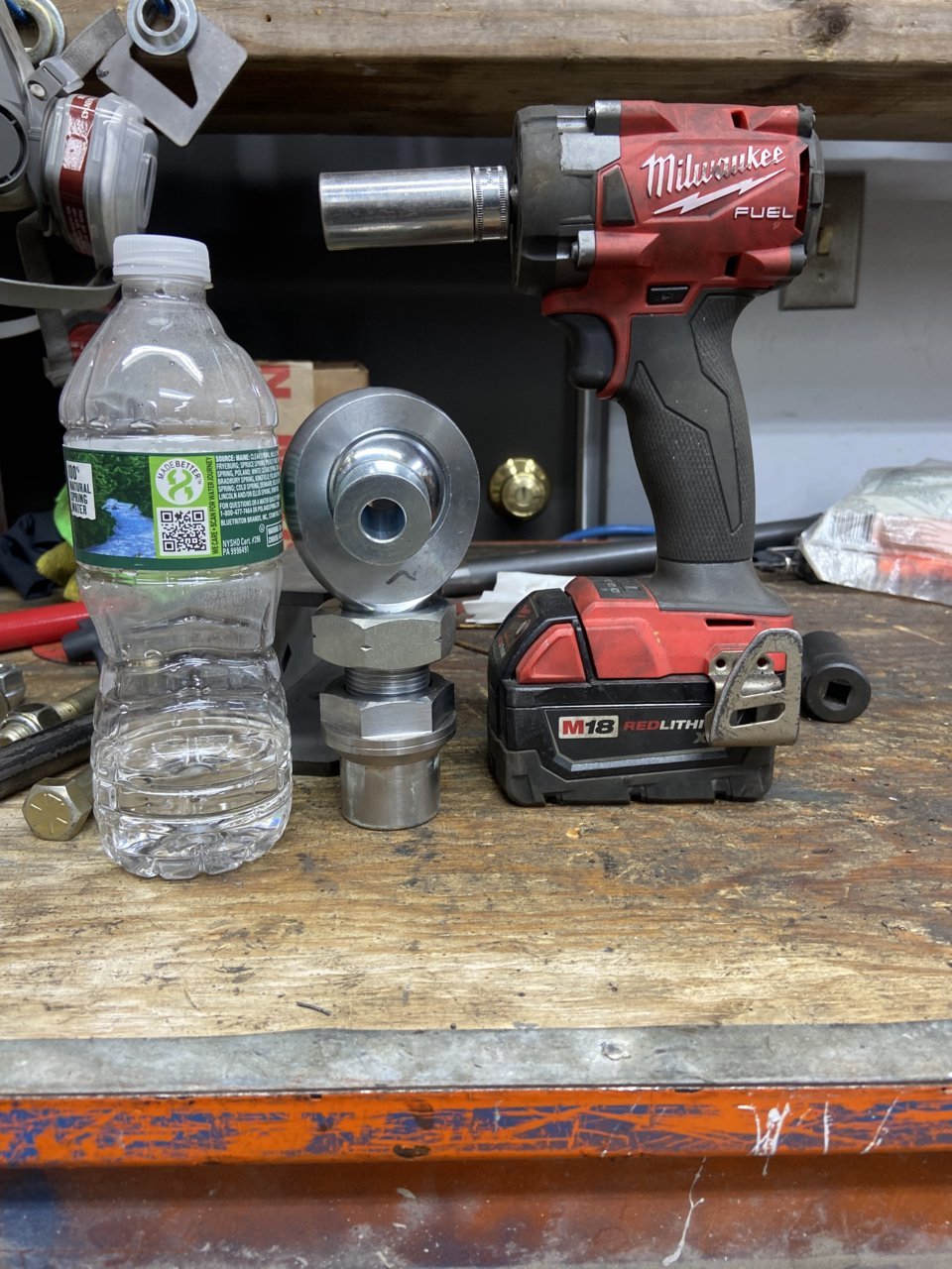

    Steering linkage. Cycling these things by yourself is hard work. First time sweating in like 6 months.

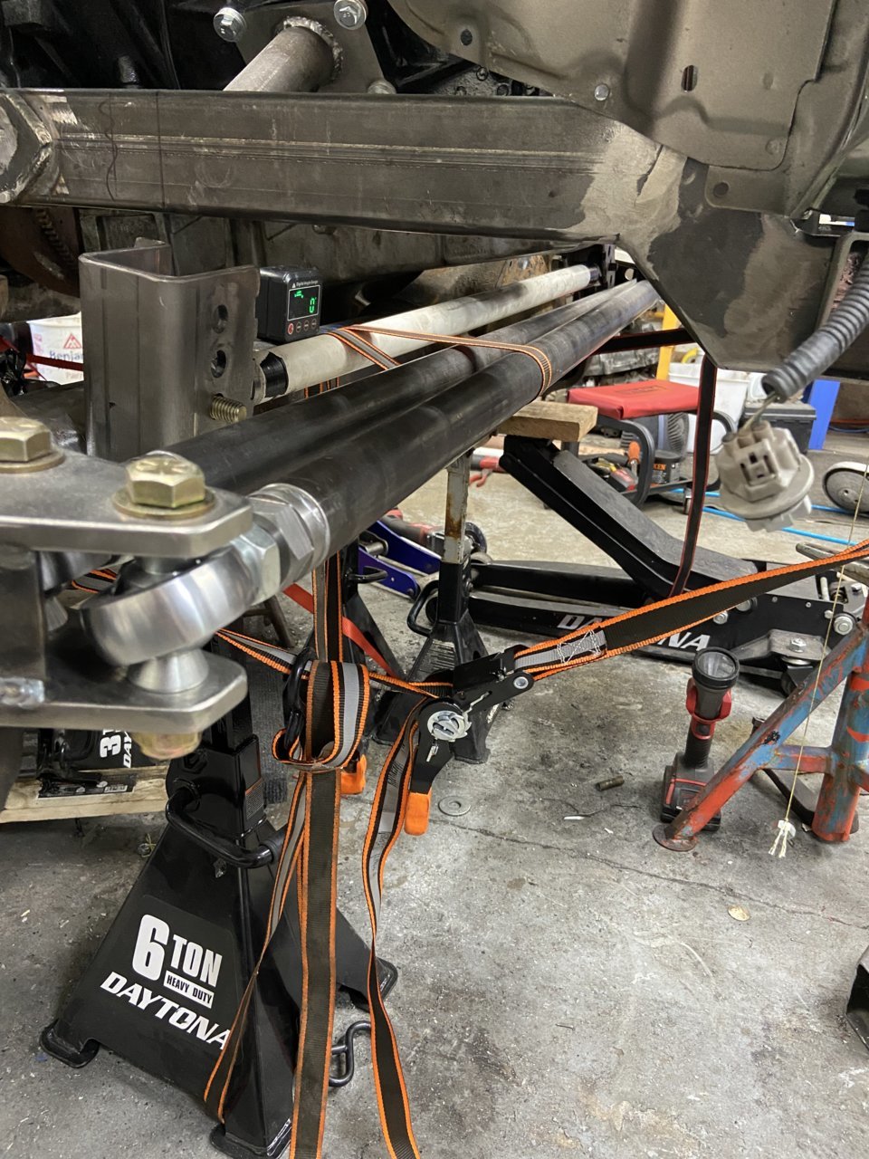

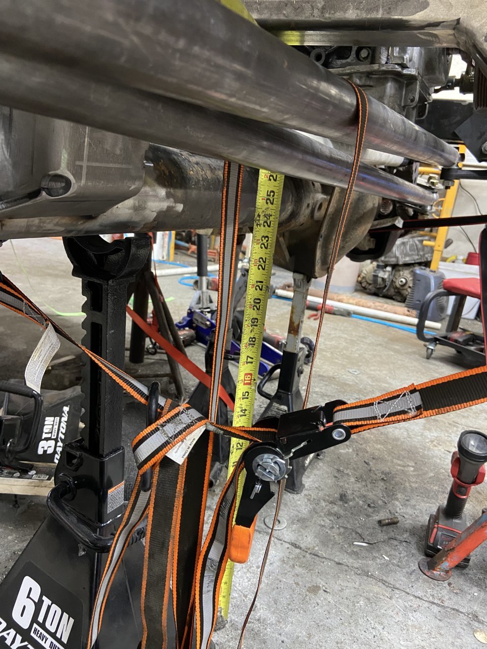

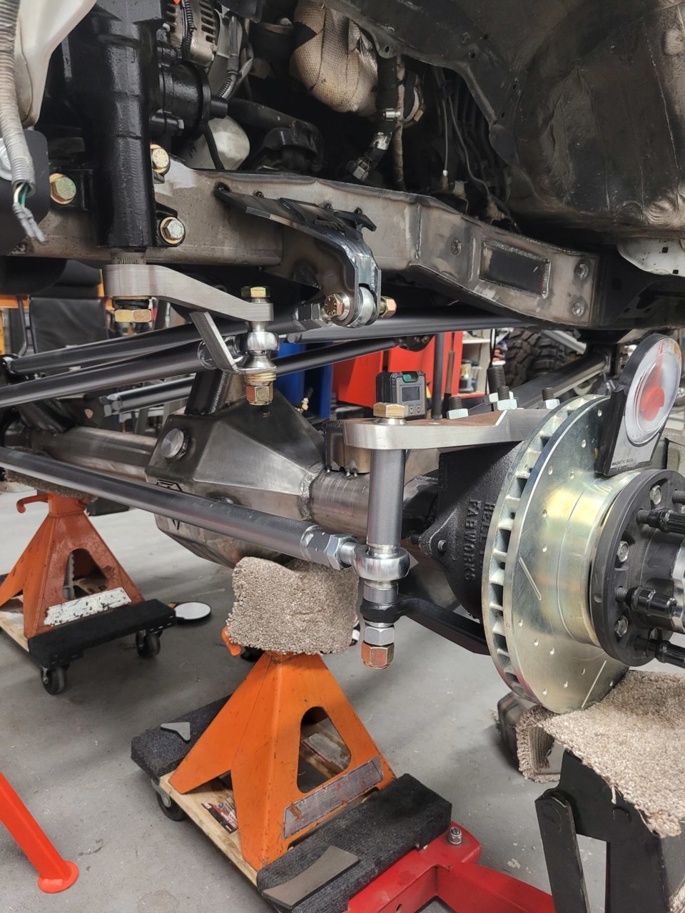

    Upper is gonna be tight but looks ok. Should get 8.5” of separation from lower mount.

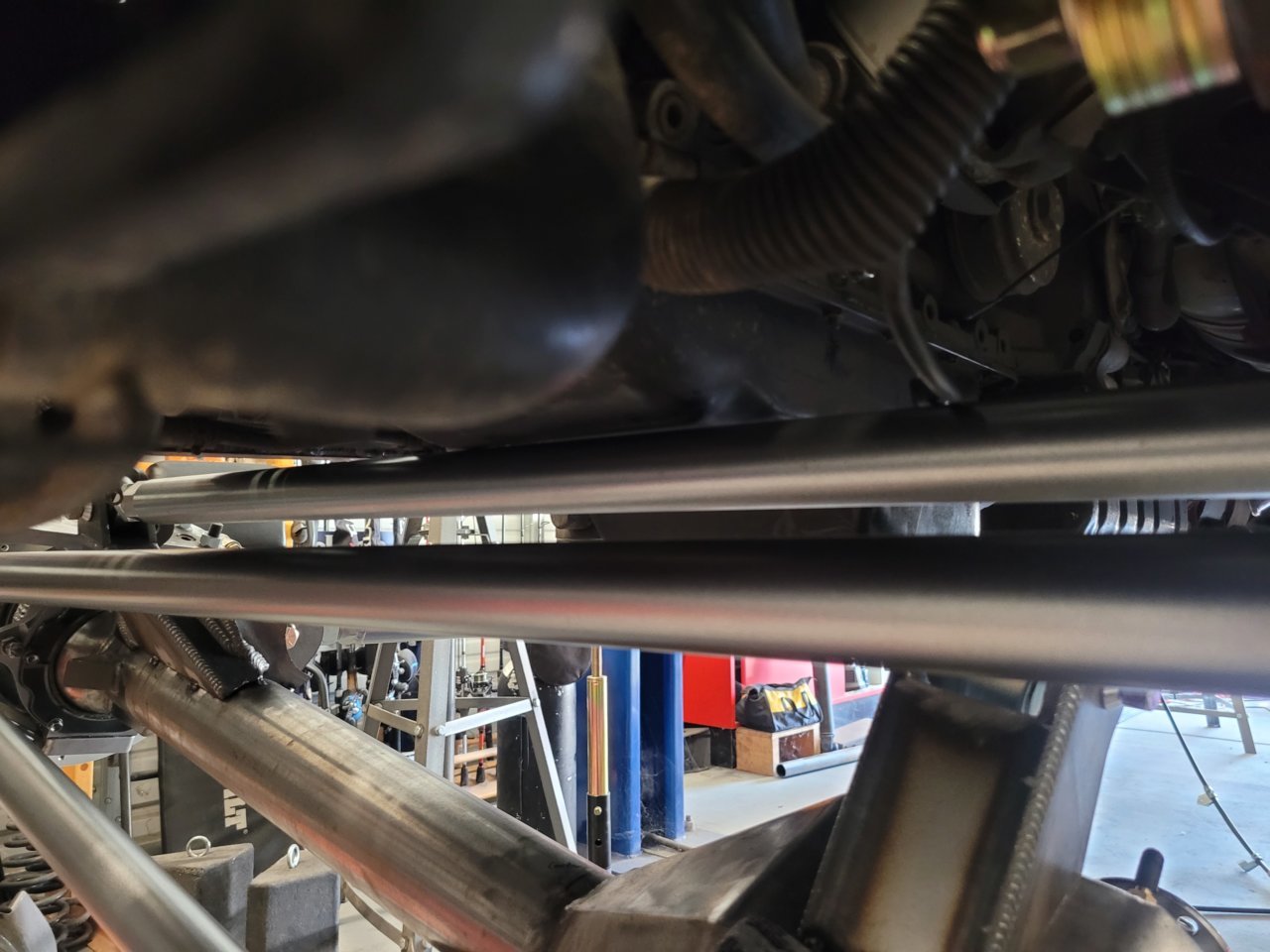

    Some TAF stuffing. More pictures just for you :p

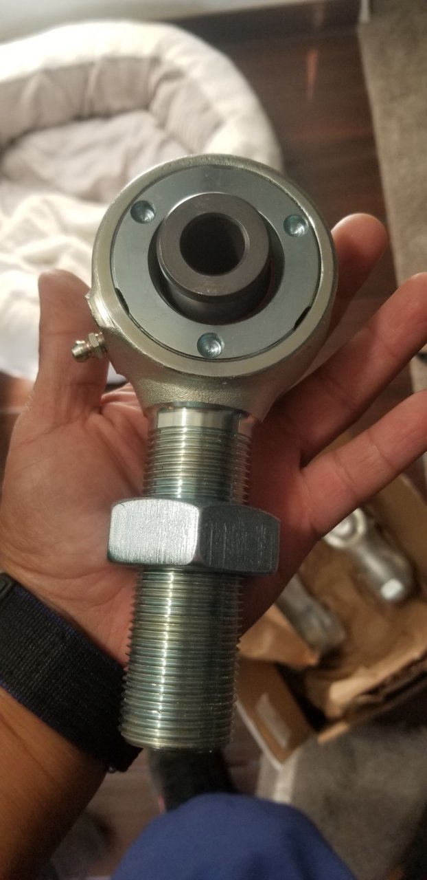

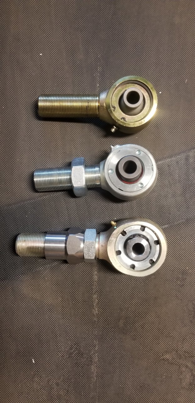

    Some more teaser. And they said 1.25 heims are SMALL. Rockjock vs Ballistic vs 4WU older heims

    damn! Looks nice. I like the pitman guard! It all looks clean!
    Yeah, I’m super tight right now. Prob need to move steering up like 1/2”. I need that frame mount for trac! That would give me mad space and so clean!

    The pitman will get box on the outer as well. Rather have a double shear and strength.

    Nice! Those look way nicer than mine. I have 1.25’s for lowers. Wanted enduros but ended up w these reg ones cause I couldn’t get at the time. The speed shop guy said he didn’t like them. We’ll see.

    #197244
    6,305
    Planet: EARTH
    I'm running those regular ones at the rear axle brackets. Supposedly they're stronger? IDK.. But I do like the fact that the other 9 are rebuildable. I'm running massive 5/8" bolts through them instead of reducing in bolt size.

    @02hilux this is my front btw. The rear is prob 1/2” shorter.

    the claim mine are rebuildable. They have black stuff on one side but idk htf you take them apart.

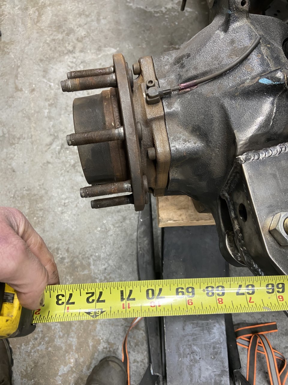

    That's good. My WMS is 69"
    Pros and cons being so wide. Hard to squeeze through tight rock spot but is more stable on gnarly climb and have better road manner

    6,305
    Planet: EARTH
    My understanding is they're not. But heck, what do I know.

    How long are your front lower link from mounting hole to mounting hole?

    i don’t have the rear mounts done because I’m doing them in dom and my die hasn’t come yet. But there is a trans mount that I may incorporate w links.
    Right now I have 40” eye to eye testers but may go slightly longer when I actually cut the dom.

    Not home to measure my links but IIRC my front lower is 42ish and rear lower is 44ish. They're both in the lower 40 something
