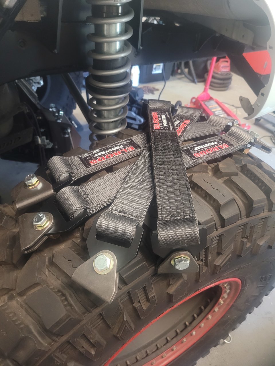

    It hurts a little.... I thought about just running tri layer $25 generic brand strap but figure I'll end up regretting and probably buy replacement after a few years. Seen these straps in person and they look nice and thick. I like the aluminum sleeve they added to prevent strap damaged at the buckle. Pulled the trigger and need to get them welded on sometime this week.

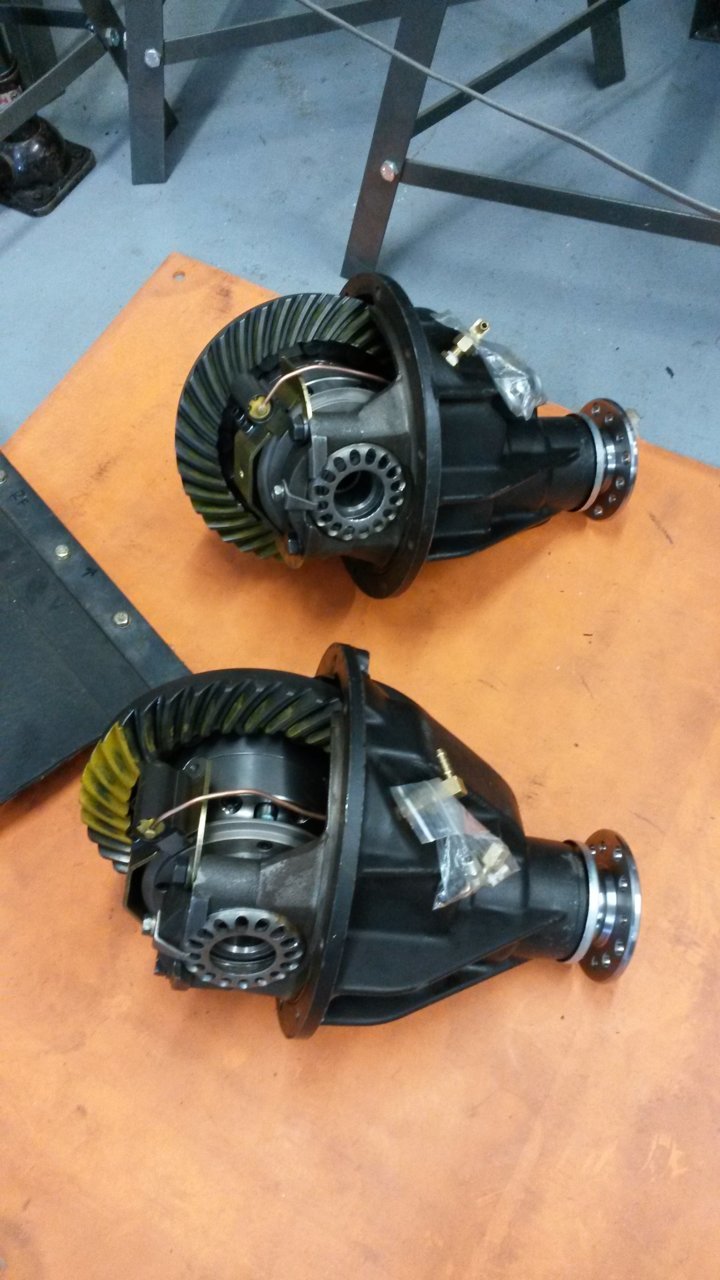

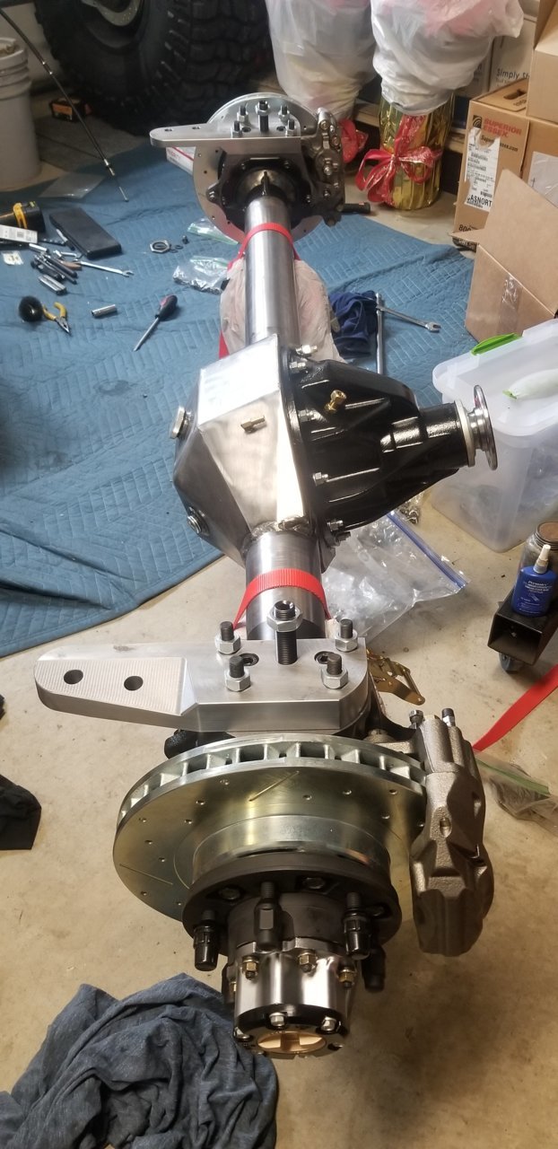

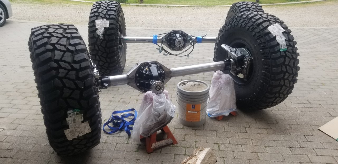

    Since I went to the LS I kinda have to have the tons, especially w what I want the truck for but if I lived in ca and just used it for rocks I would have just got those same axles you have. Light and clean. Prob fucking cheaper at the end of the day.
    I’ve seen before but it’s been a while. You have the pic of both the axles before they went on truck? Wanted to see them again.
  9. Jun 6, 2022 at 5:28 PM
    #609
    02hilux
    02hilux What do you mean there’s no road, I’m here
    Sep 14, 2016
    #197244
    6,314
    Planet: EARTH

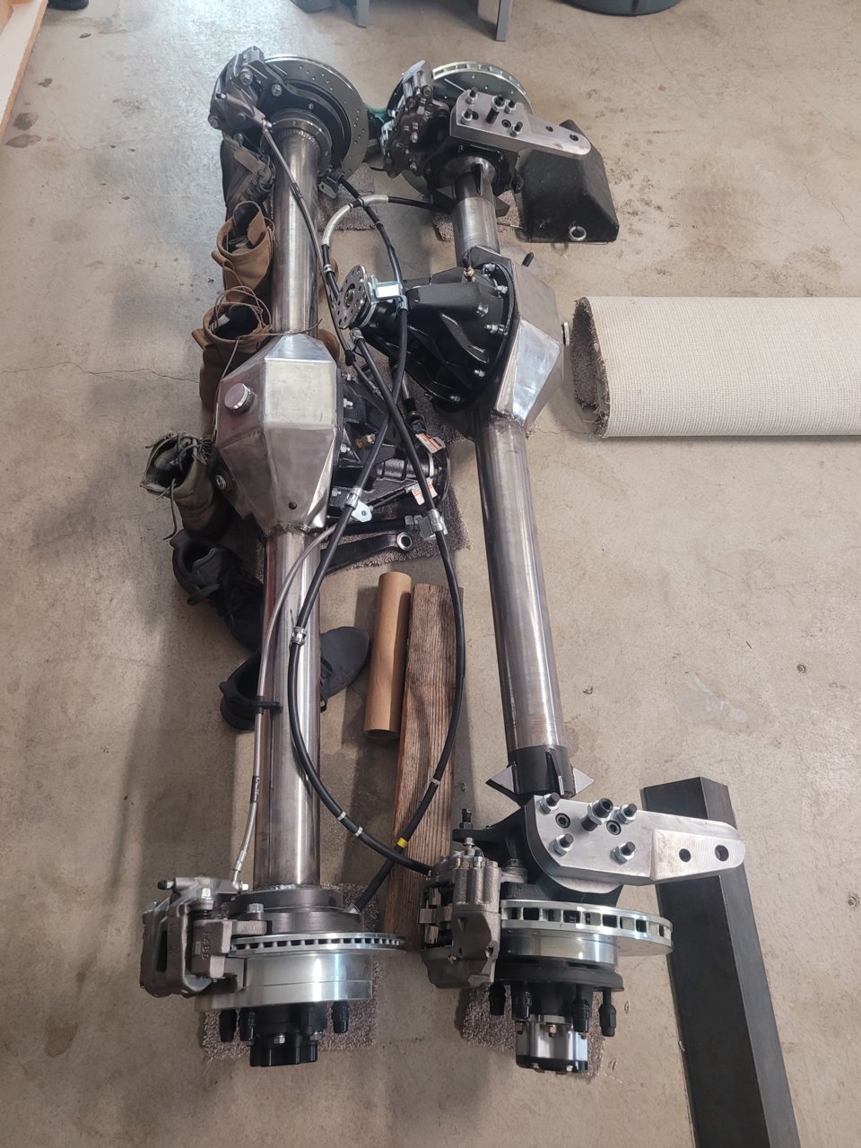

    I transfer most of pictures to my PC already but these are on my phone. They were bare housing and arrived in pieces

    Geez. Those things are so nice! I like the clearance for one and the 3rd member as well! Super easy to fix even on a trail. Do those things have like chromoly shafts too?

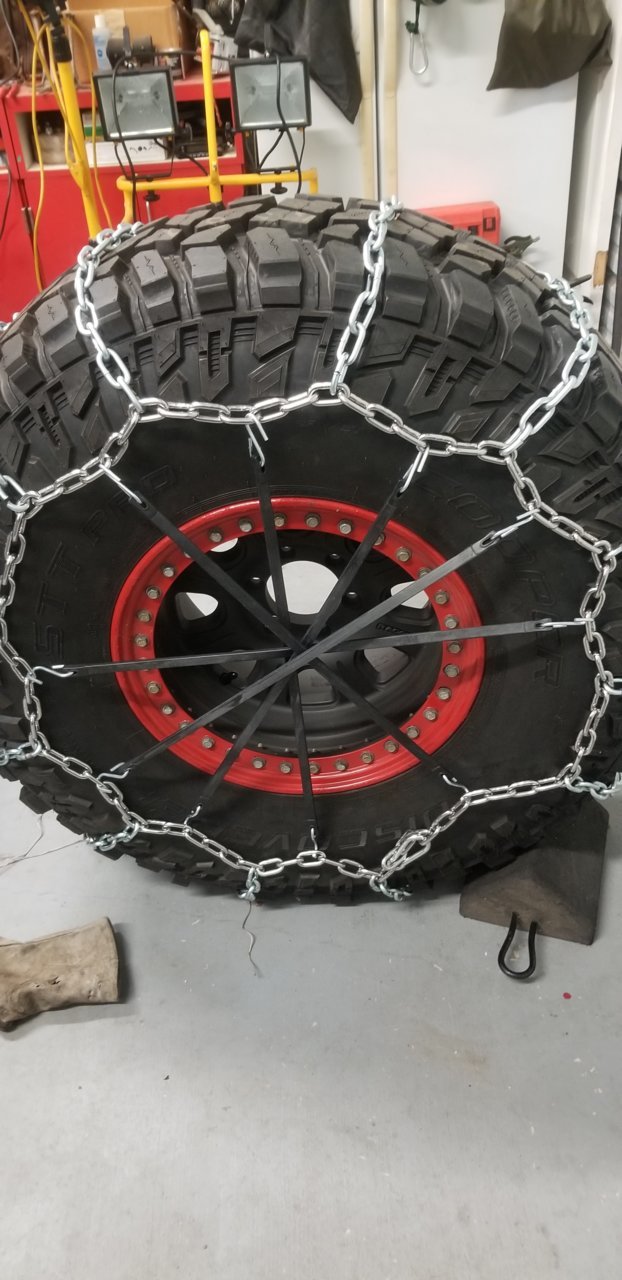

    Made my own snow chain for snow wheeling

    Wtf! That’s cool as shit! I’ve never used snow chains!! The mail men have them on 2wd so they must work crazy on that rig!

    I do a lot of solo hunting during winter months. There's time even with locked front and rear on ice and I'm just spinning on 35s. Had to put in chain on all 4 to gain traction. Figure I'll make them for the 40s as well. It's cheaper to make vs buying

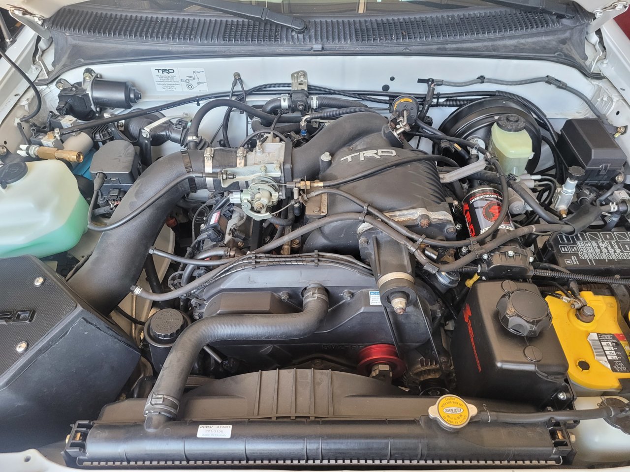

    Here's some random

    How did you link the chain? Or did you modify a pair to fit? I want those!

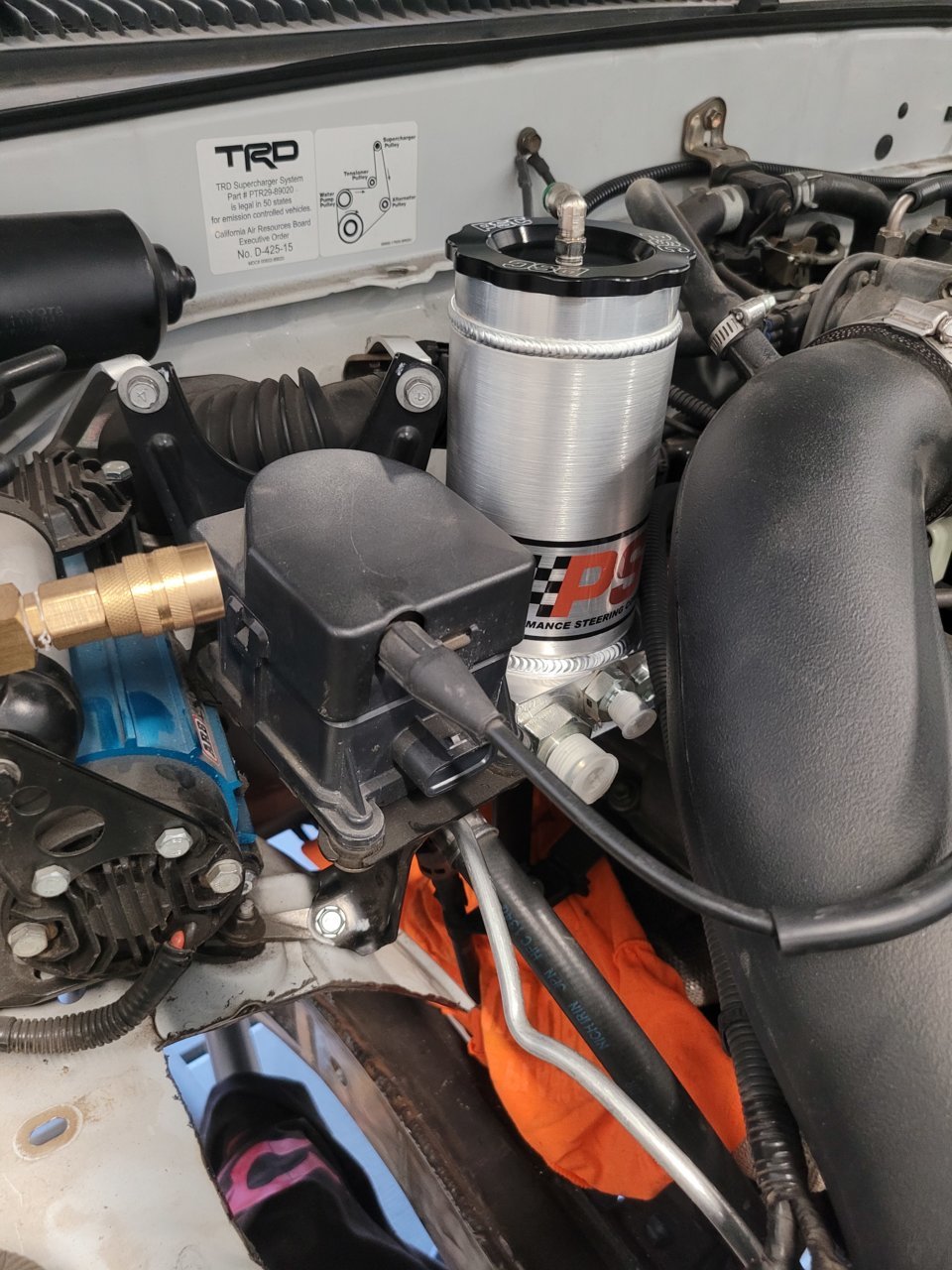

    That engine bay is nice as shit but damn! You are maxed out!

    For the snow chain? I cut the last link, twist the link to open and placed the side chain in. Then twist it back closed and weld it.
    As for the engine bay, there's no more room now. At least in the picture, there's some. Now, both tower protrude into the engine bay and the PSC resovior is placed between the firewall and cruse control area.

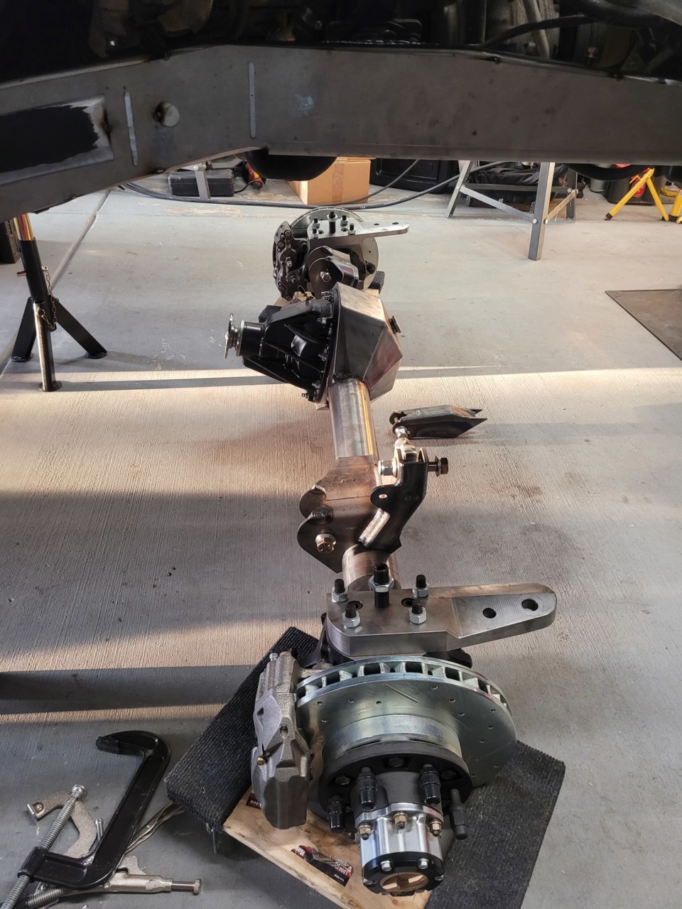

    oh shit. I was wondering how you were gonna get those 14’s in there! The first part I took off my truck was the cruise! Lol. Never used it on any vehicle I’ve ever had.
  19. Jun 6, 2022 at 6:20 PM
    #619
    02hilux
    Sep 14, 2016
    #197244
    6,314
    Planet: EARTH
    I use the CC all the time. Especially on long trip.
    The 14s are all in. Test fit and will be pulling them out after I weld on the limit strap mount to paint.
    Yota X[QUOTED][OP] likes this.
