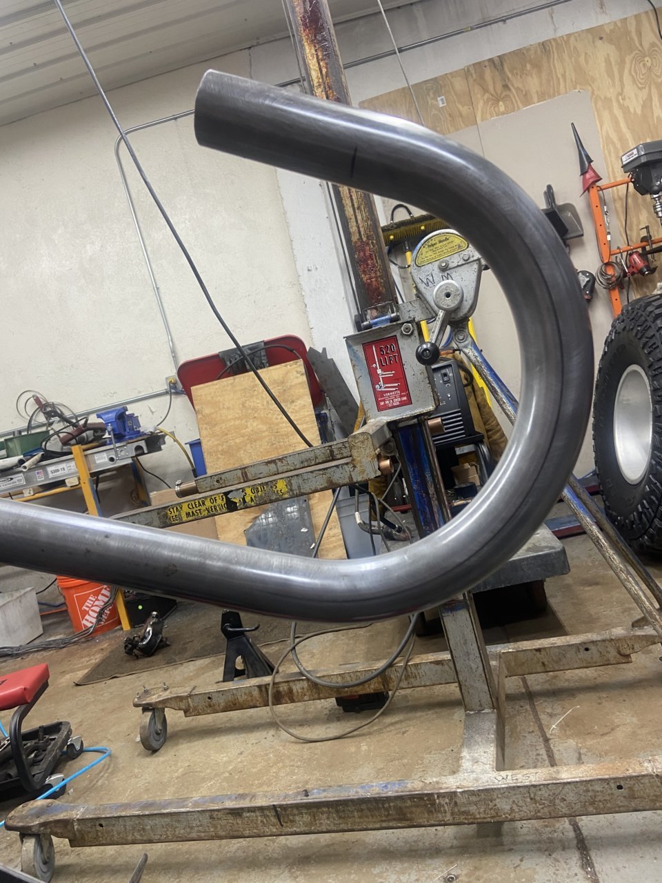

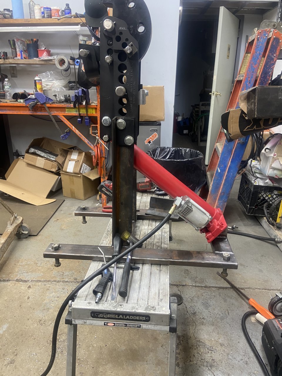

    Ran out of welding wire, had no material and kept breaking the stand when the ram started but I scavenged up some scraps and temp braced it. That piece of dom was my upper link so now I gotta get more.
    Plan is to rip that 180 bend in half so I can bend 1.50” also.

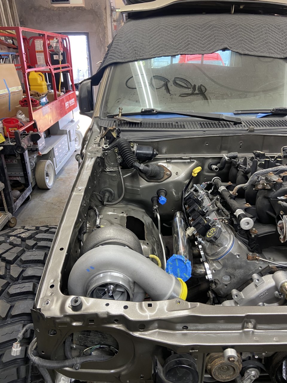

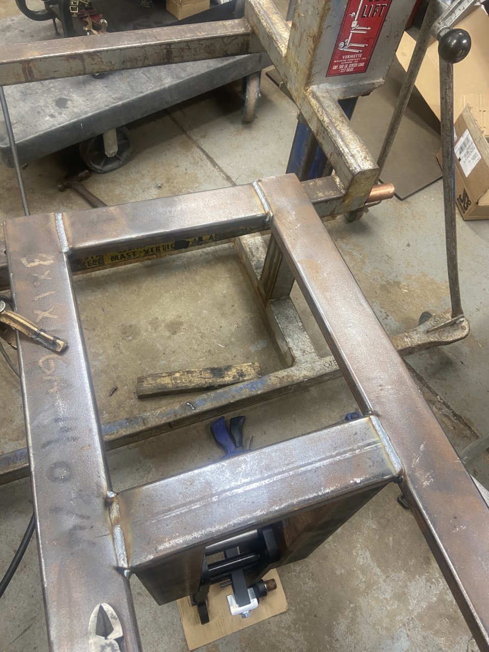

    Wasn't gonna put a pic of this for a bit cause I didn't know if I could make it work. But, spent the last 2 weeks planning and now that I have all the tubing, flanges and tig and have come up with a very non invasive way to pipe it and it will not interfere with anything other than the hood.

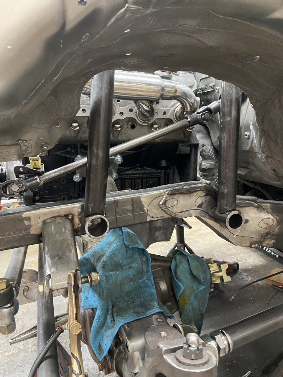

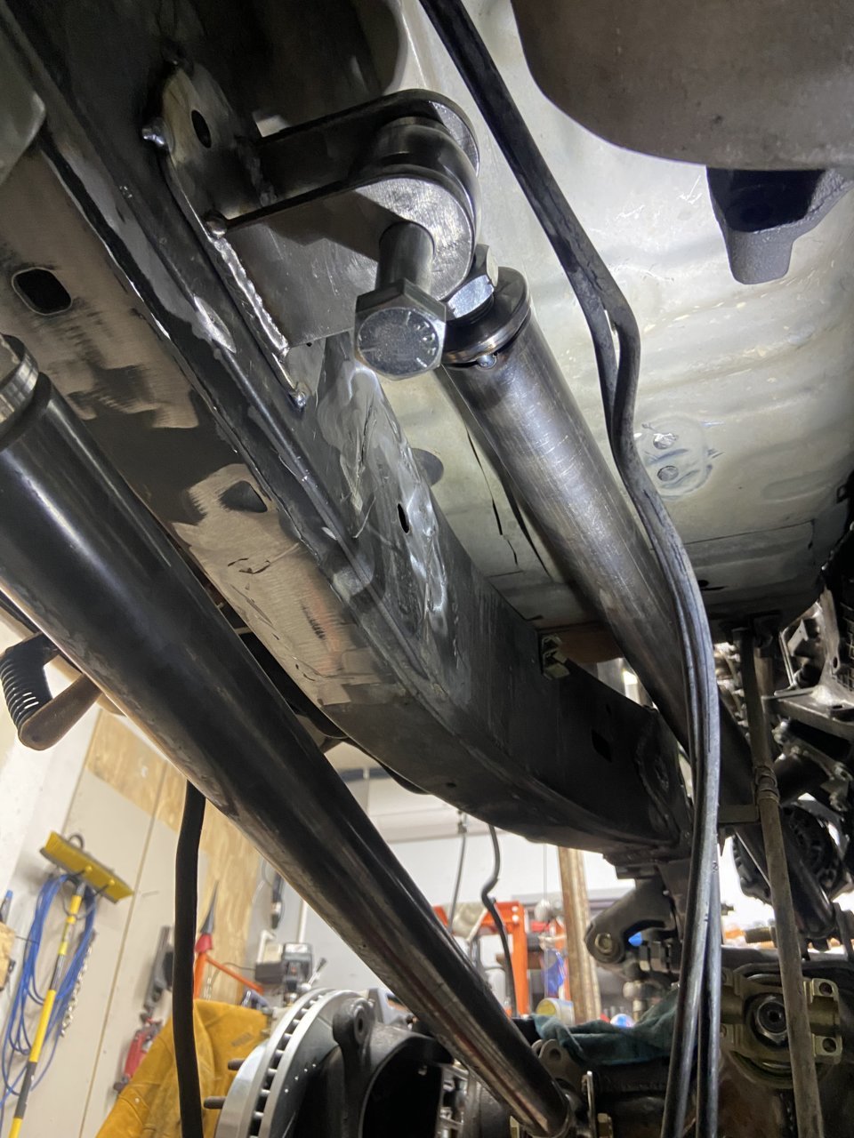

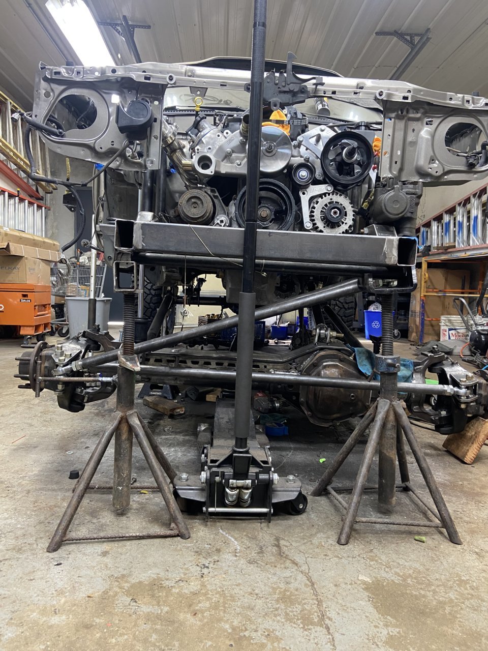

    Finally got a few hours to work on truck. Got the towers figured out for the most part.
    Not loving bending tube, notching and dealing w DOM as much as I thought. Idk wtf I’m doing and it’s like guessing w everything. I’m so scared to ruin a $50 piece of pipe that its stressful and I can’t be as creative as I want to be which sucks.

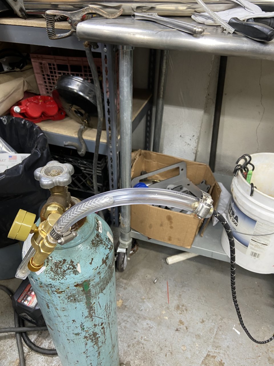

    This Agron gas regulator is money. Except it’s not. Had to do Pakistani engineering to make it not leak.

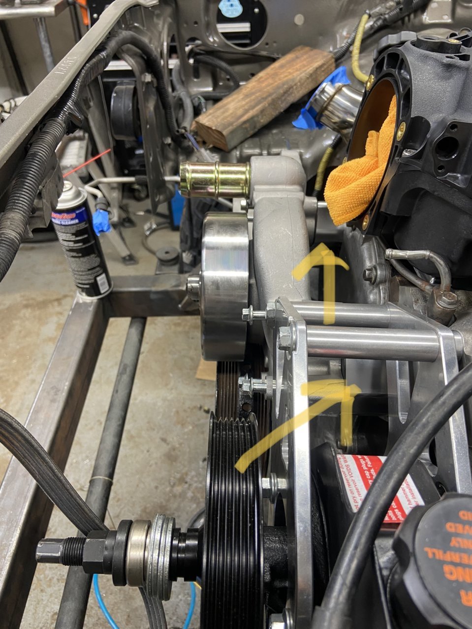

    And the water pump is un-pressable so figured out a super easy solution that I should have done before. I got 1.5” spacers and gonna have the machine shop deck them down 3/8” and I’m set.

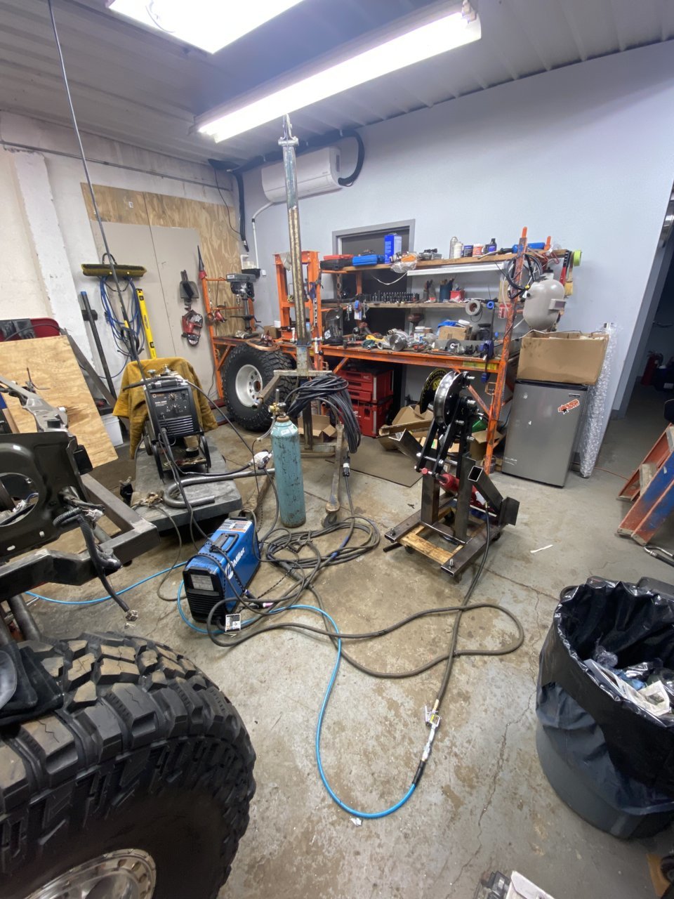

    Way too many things going on at the same time. Super counterproductive. Can’t even walk around. Total shit show.

    LMFAO.... Remind me of myself a few months ago when I had a cluster f#ck in my 25'x30' man cave. I was litterily tripping over extension cords, tires, metals, axles.... You name it.
    I think they shipped the tube bender to you by mistake... :anonymous:

    Thats what I have. 20x35. It sucks, but I can deal with the cluster fuck and still get shit done. I finished up the hoops in flip flops and didn't even trip on anything. Its the losing parts thing. Every fucking day I lose a part that I had the day before and it takes me like 2 hours to find. I lost all my spacers for the coils also. I have to buy those tonight. stupid!

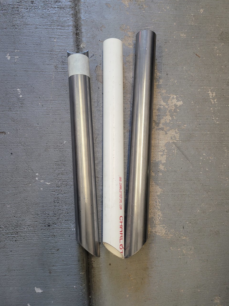

    When I'm too cheap and lazy to go buy a hole saw to precisely join two tube together. Cut and grind to fit.

    And when DOM get costly after a few mistakes, I cut them out of pcv pipe first to get the right measurement before cutting DOM.

    Wish I had a band saw like that. The dom notching has not fucked me YET. But prob will. If pvc could make a 180 degree bend that would be awesome!. I actually figured out that if I want to make an offset bend I just measure the width I want to go and bend to that. But, yeah, dom is fucking expensive. you don't want to go all cowboy and ruin a $30-50 piece. All the other fab, I can just redo it for like $5.

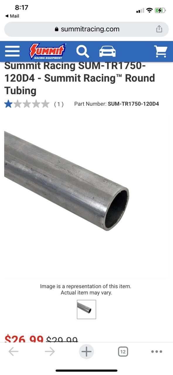

    Yeah, i sacrificed 2, 4 footers for my hoops. Cut like 6" off each end. Summit ships (2)1.75 4ft lengths for like $56 i think it was. Its like half the price of local.
    Shop around all you want but unless you have a cheap ass metal spot like 2 miles away this is the deal.

    Yea, that's cheap for dom. ~$7 a foot

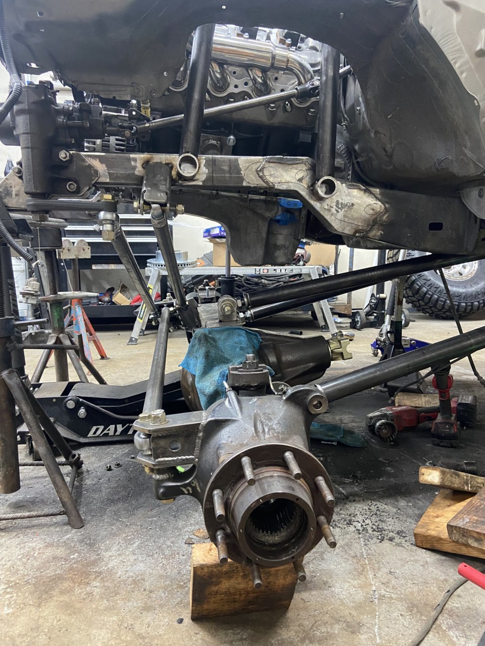

    Finally initially done w suspension. With the current pan I have about 4.75 up and whatever the max on coil is on down. New pan I’ll get about 1 full inch more so I’m gonna set my coil to accommodate.
