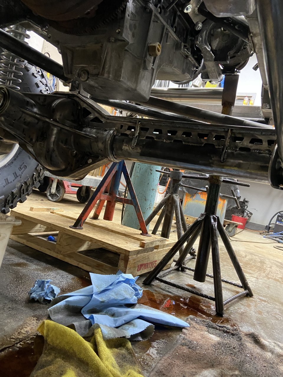

    Got a little cavalier dropping the trans pan and didn’t realize it weighed like 20lbs. Sprayed about 2qts all over my nice clean axle that absorbs oil like a sponge, all my links and my tig torch. 2 for 2 in 2 days.
