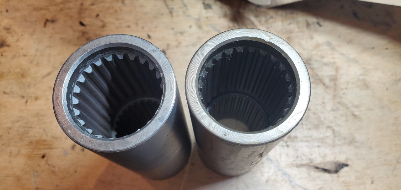

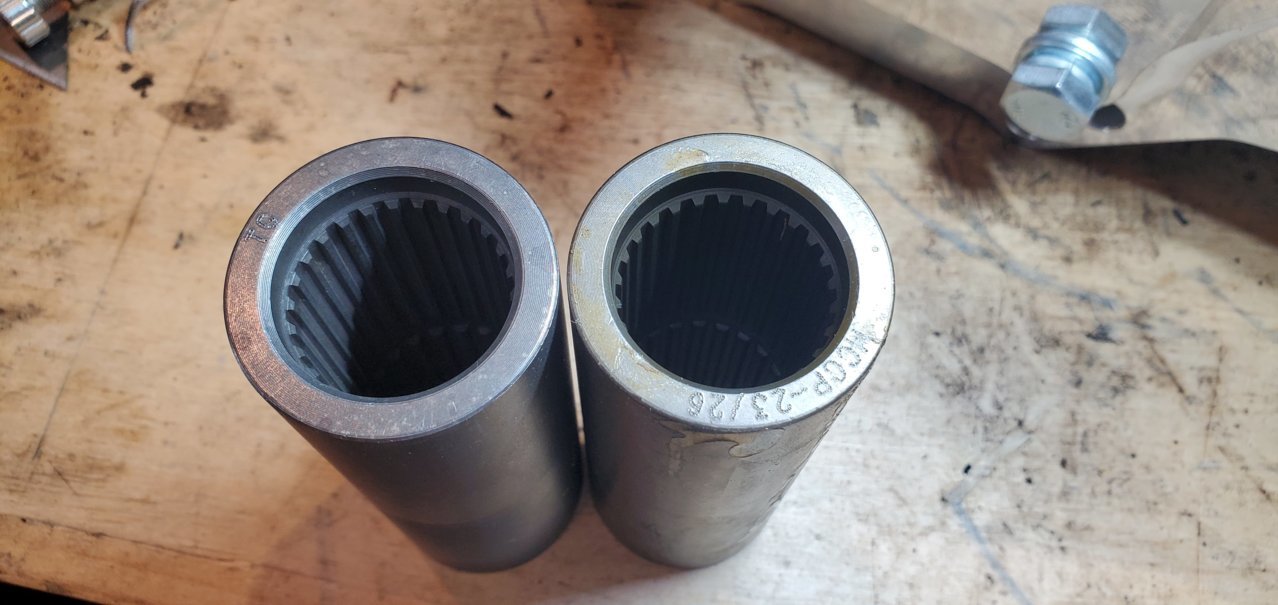

    Yea I have a couple pictures comparing both of mine as well. Overall dia and length are the same, but it came down to the spline profile.
    The TG one would go on the MC gears kind of, but needed a rubber mallet and needed the assistance of a gear puller to get off.
    Although both of them for me didn't have a "slip-on" fitment onto the 26 spline tranny output. Had to use a metal sledge to get that guy on there.
    TG left and MC right.
    I believe this side is the tranny output side. Similar looking cut
    CB side:
    taller and more beveled teeth on the TG one. Which definitely contributed to the tight fitment on the MC gears

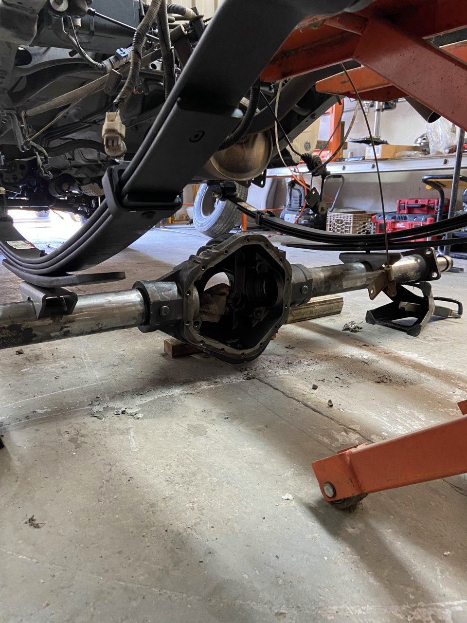

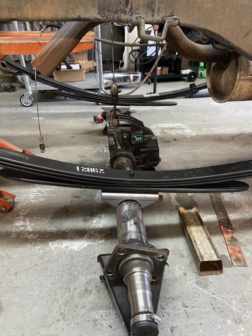

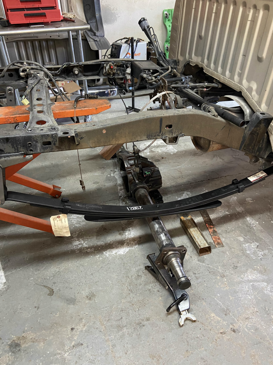

    Finally got the axle prepped and threw it under truck to get an idea of where to start. I set it at 3 degrees based on some things I read but that just doesn't seem right. It is way lower than where the t case flange will be.

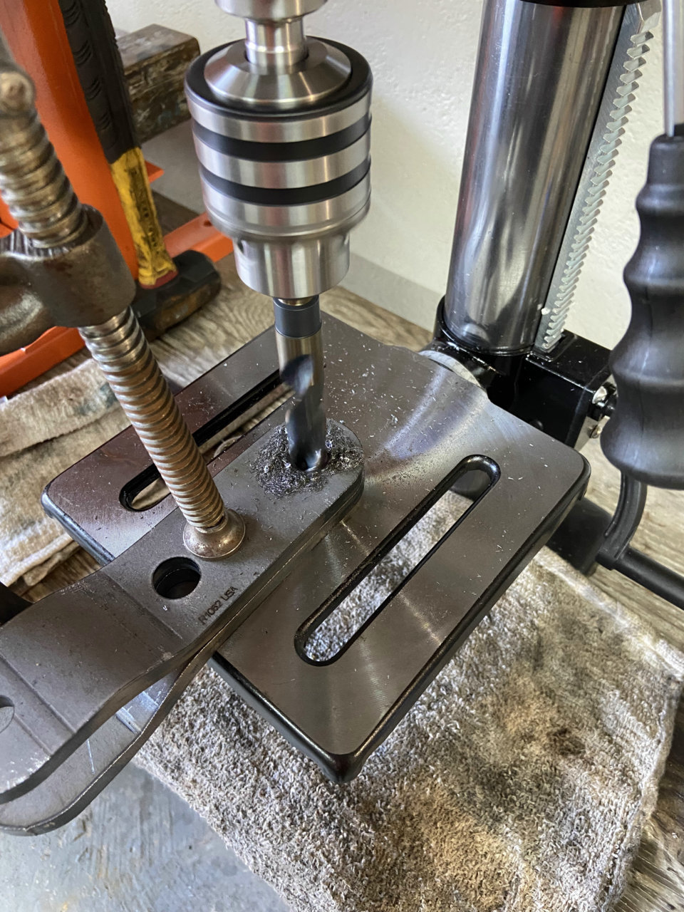

    Got the new shackles but I burned my 9/16 bit up so got stuck before I could swap them on truck. I got the two 3/4 holes done thankfully.
    Ruff stuff 6" with a 5/8 offset.

    Isn't it 3° off centerline of the driveshaft at ride height?
    Yota X[QUOTED][OP] likes this.
  14. Feb 9, 2022 at 9:57 PM
    #74
    Yota X
    Yota X [OP] Some say dresser, I say dryer.
    Jul 11, 2019
    #298961
    5,268
    NW New Jersey
    1st gen
    ls turbo, tons, 40's and a partidge in a pear tree
    Prob. Idk wtf I’m doing with this as of now. I’m putting the trans housing in empty so I can remove it easy and gonna bolt t case up and see where I’m at with the flange.
    I still don’t know what kind of shaft I should run yet.

    Source: https://www.motortrend.com/how-to/91758
    "According to Bickel, a ladder-bar suspension normally requires degree of pinion angle, a four-link requires 1-2 degrees, and a leaf-spring suspension requires up to 6 to 7 degrees."
    "Ray Currie of Currie Enterprises, which specializes in rearends and rear suspension systems for race, street, and off-road applications, agrees that pinion angle is a pretty simple (theres that word again) concept. He explains that a universal joint is designed to handle between 1 and 3 degrees of pinion angle. This is a safe operating range for the U-joint"
    "In all examples, were talking about negative pinion angle, i.e., the pinion is nose-down in relation to the driveshaft."
    "According to Currie, the average car crafter should strive for between 1 and 3 degrees between the tailshaft of the transmission and driveshaft, and 1 to 3 degrees between the driveshaft and pinion. Furthermore, the two angles should be nearly equal (between 1 and 3 degrees), but always opposite (see crude diagram)."
    I set mine to -2° when I setup my SUA.

    So we left the shocks off, threw the wheels on the axles, strapped the axle to the leafs and then put it on the ground. Set the angle with a digital angle finder and then tacked my perches on. Used a floor jack under the 3rd member to position the angle up or down.
