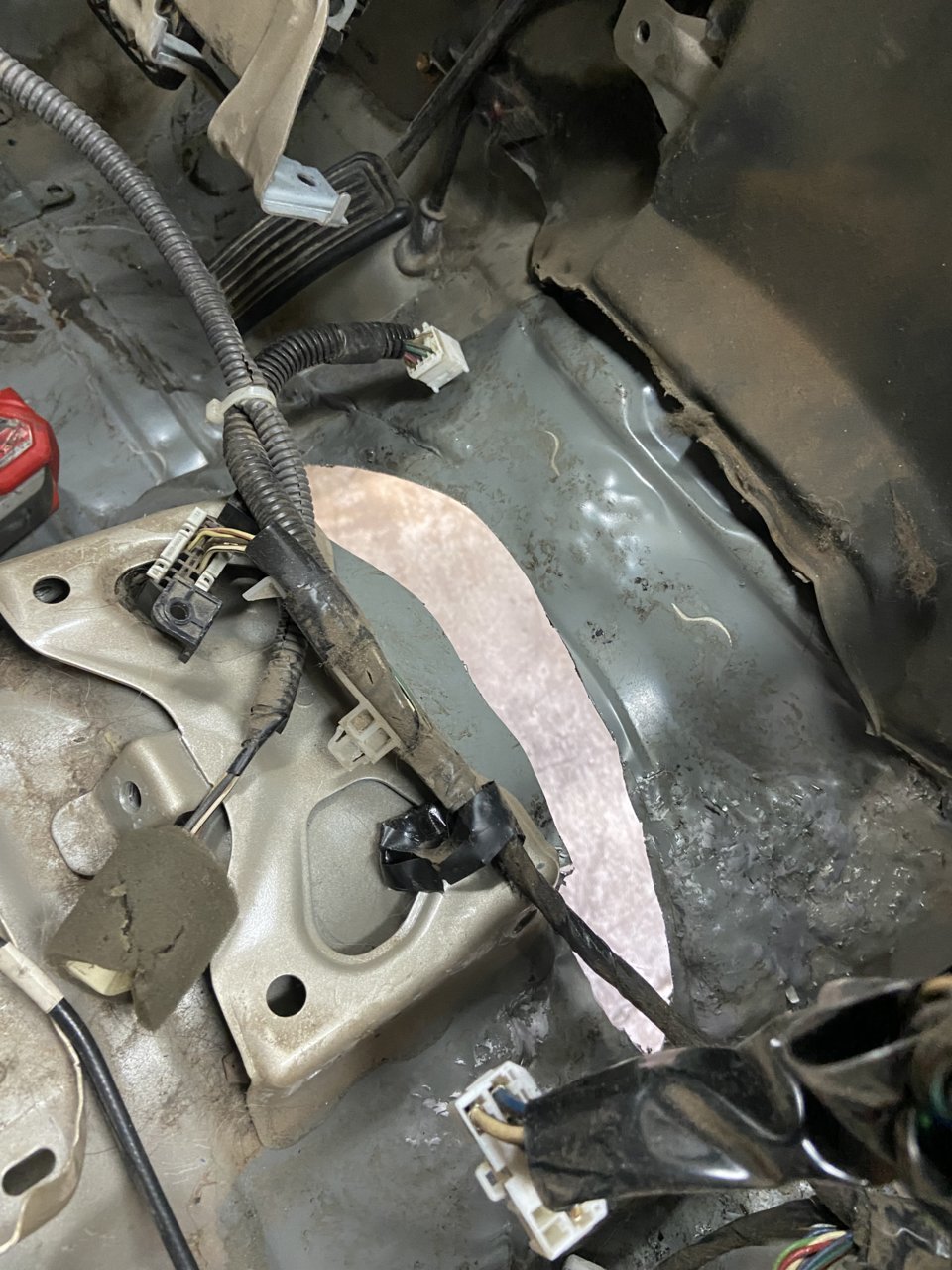

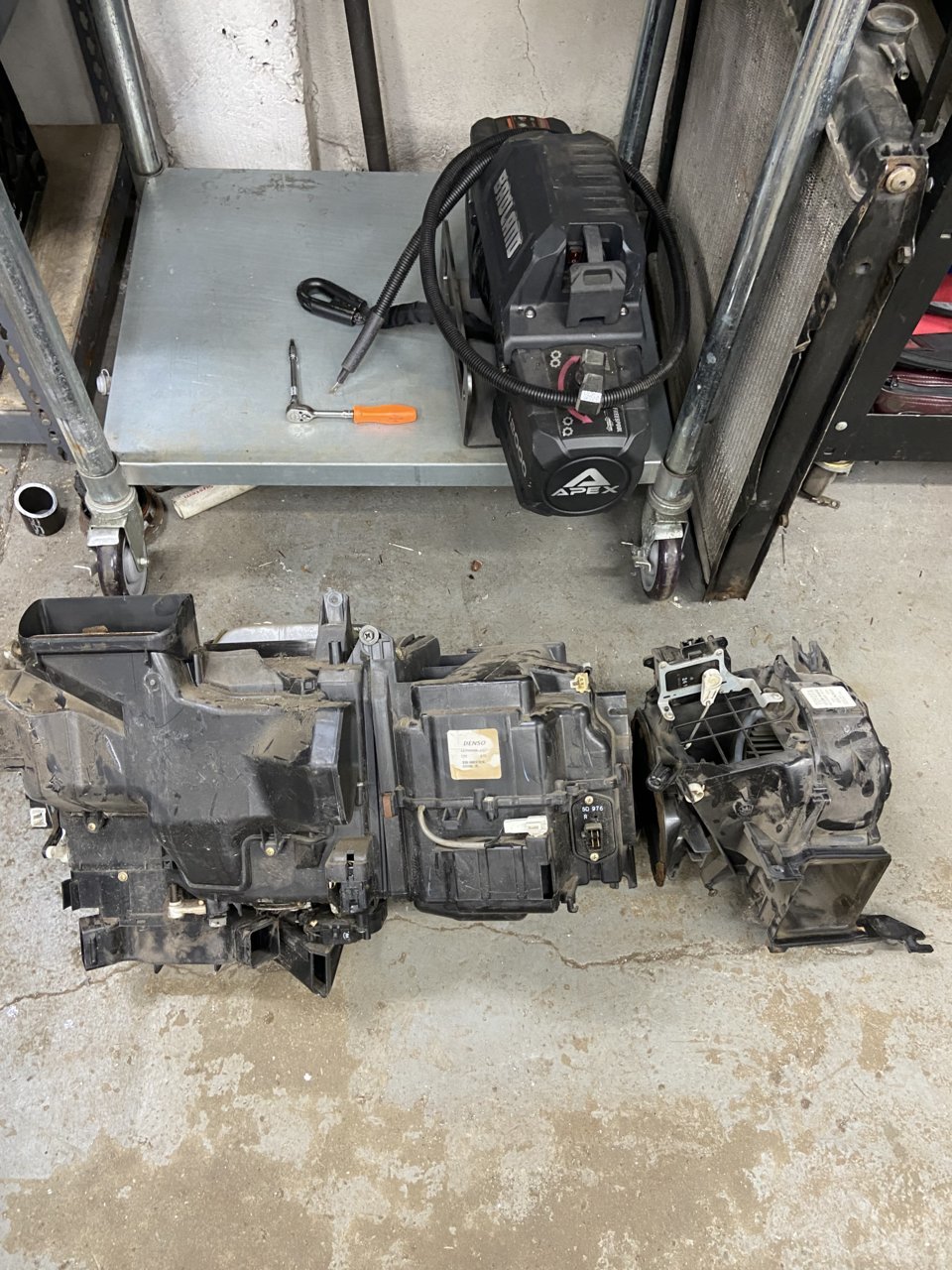

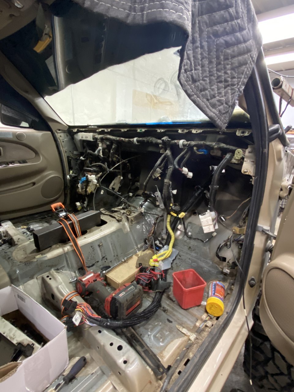

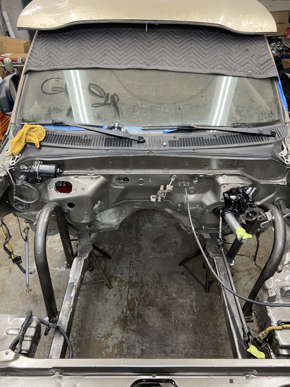

    Got fuck all done over the weekend but been busting ass for the past 2 hours. Got motor out, firewall done.
    I feel like a stupid ass time traveler who goes back to the point right after dumb choices and gets to relive agony again.
    And I pulled a donkey move and pulled blower to cut this out when I prob didn’t have to. I thought it was way back. Didn’t know til it came out though.:cool:
    T case vent area.

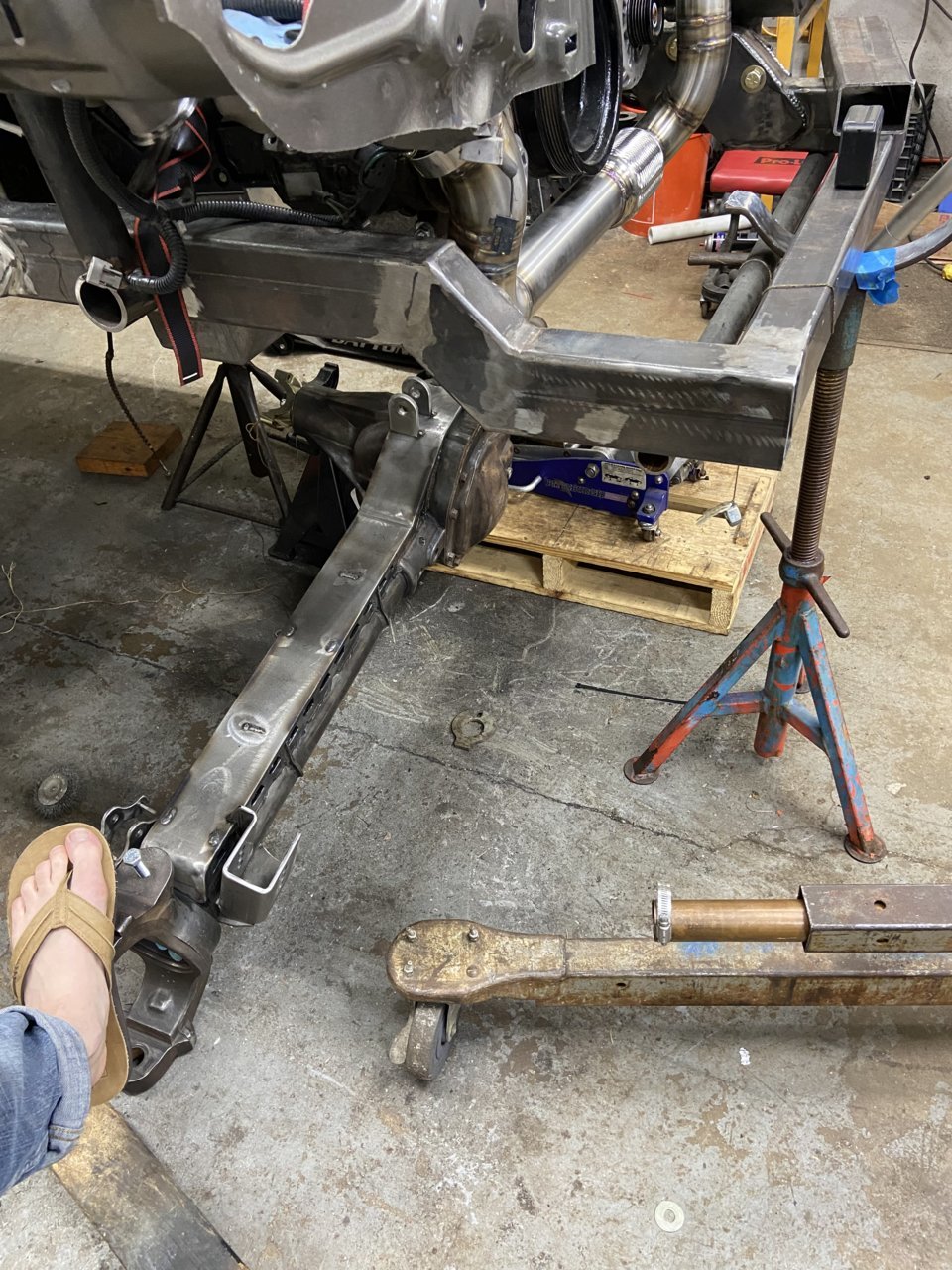

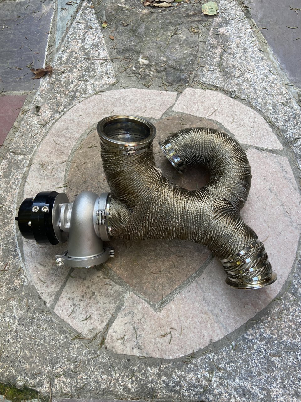

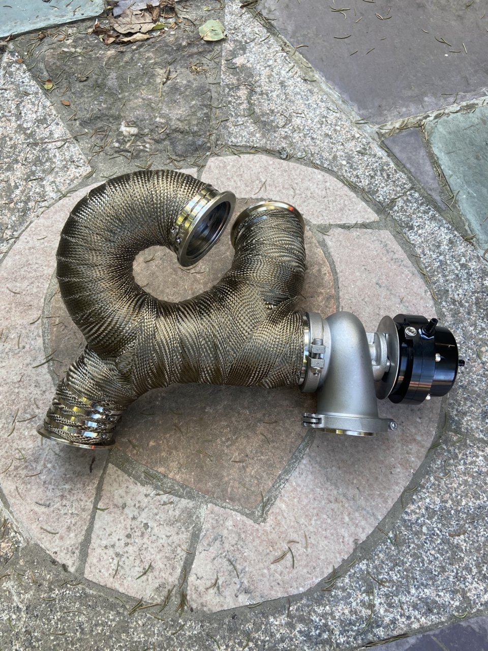

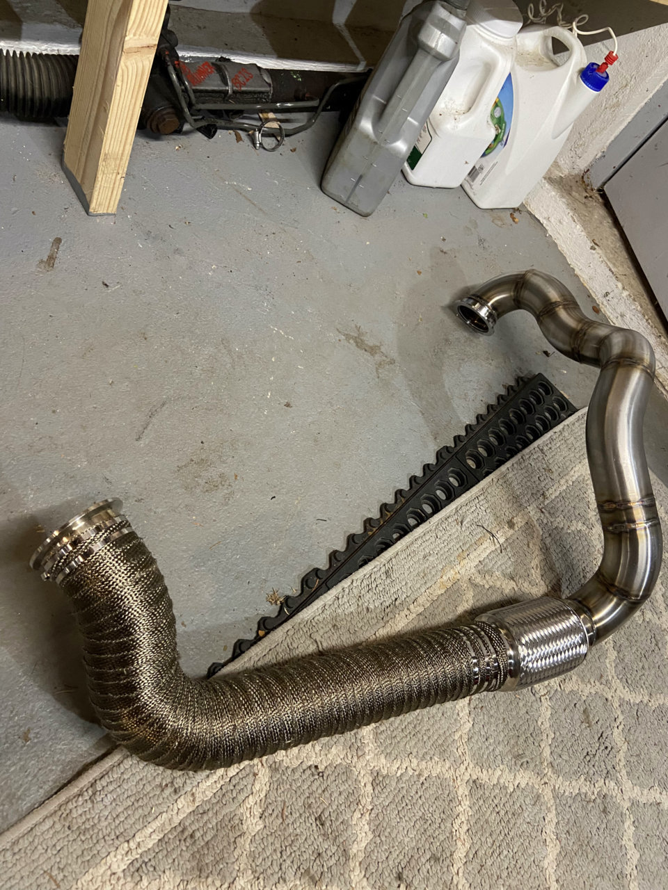

    I’m back to doing shit work and it sucks.

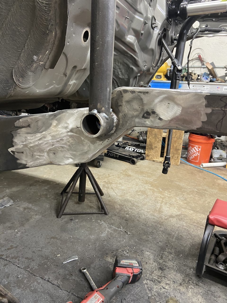

    Cleaned up frame I wasn’t happy with. Took forever. Had to add a lot of material and watch the heat. Gonna add one or two more small plates then paint.
    And wrapped the collector. Sucked. Wrapping is prob one of my least fav things to do and it’s actually very hard to do by yourself. I think it turned out nice though.

  17. Aug 29, 2022 at 7:15 AM
    #937
    v5ensx
    v5ensx CARB legal is not CALI legal
    Sep 19, 2014
    #138656
    1,804
    I have issue with those d@mn metal ties breaking or coming loose over time. I now use hose clamp.
    Yota X[QUOTED][OP] likes this.
  18. Aug 29, 2022 at 7:08 PM
    #938
    Yota X
    Yota X [OP] Some say dresser, I say dryer.
    Jul 11, 2019
    #298961
    5,268
    NW New Jersey
    1st gen
    ls turbo, tons, 40's and a partidge in a pear tree
    Yeah, I still haven't figured out exactly the best way to tighten them. I was actually gonna wrap the whole exhaust with 14g copper wire. I think it will look cool and it will dissipate some heat while keeping everything tied up good. This one was the hardest. Used almost 25ft of wrap on it. IDK HTF that was even possible!

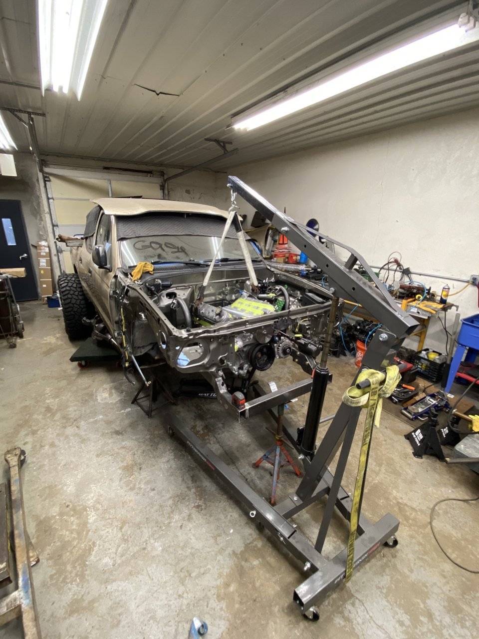

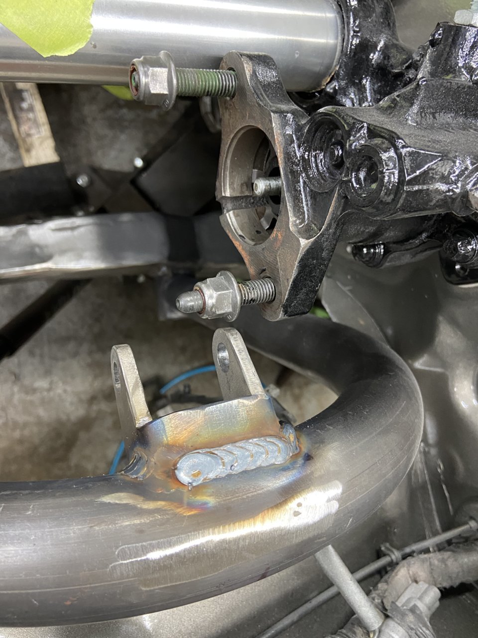

    NW New Jersey
    1st gen

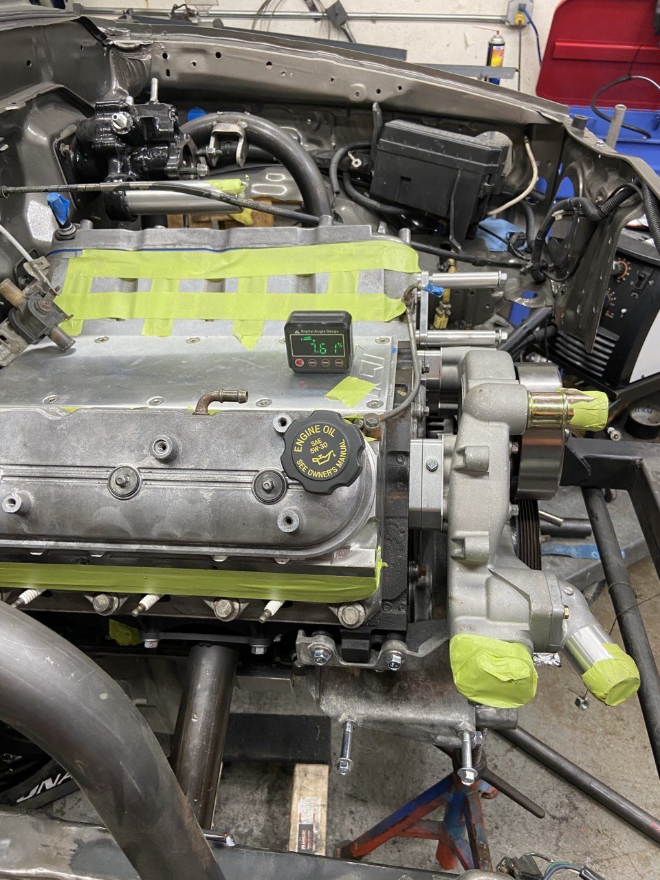

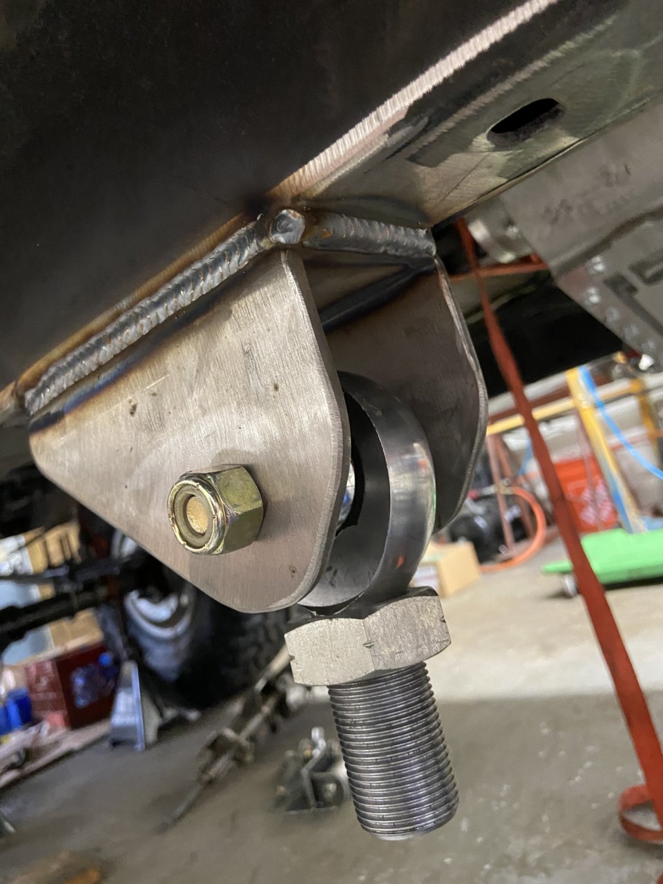

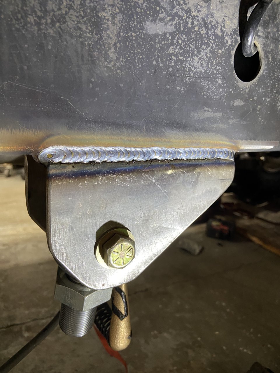

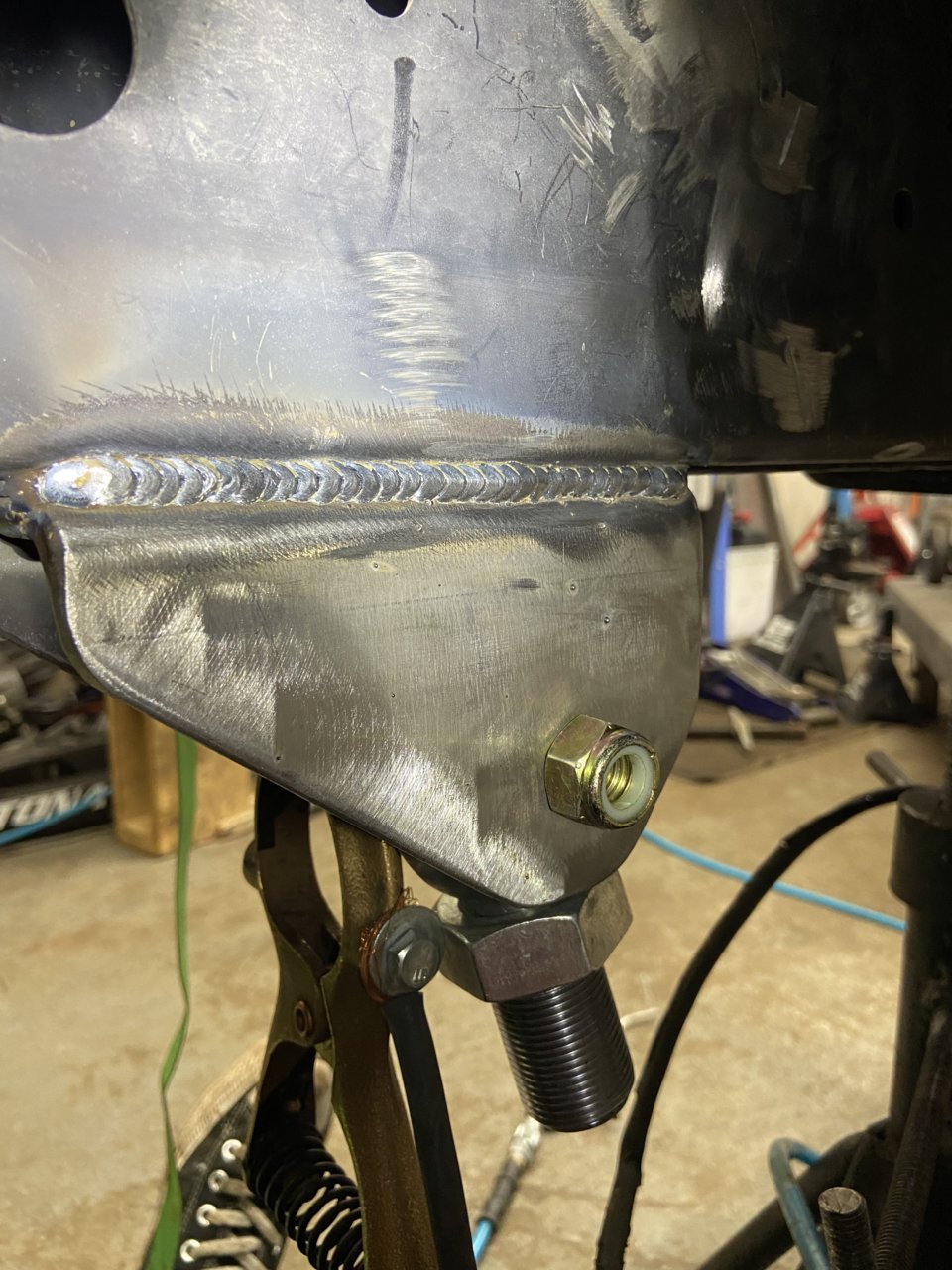

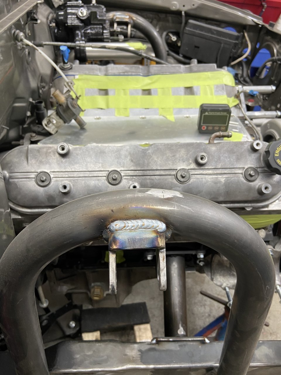

    Got the motor tilted up about 2 1/4 degrees. Prob about 2 inches at the case. Raised the entire motor up 1/4” and back 1/4-1/2” as well so I may have a bit more room.
    Final weld on rear link mounts turned out nice on inside w that big ass gap.
