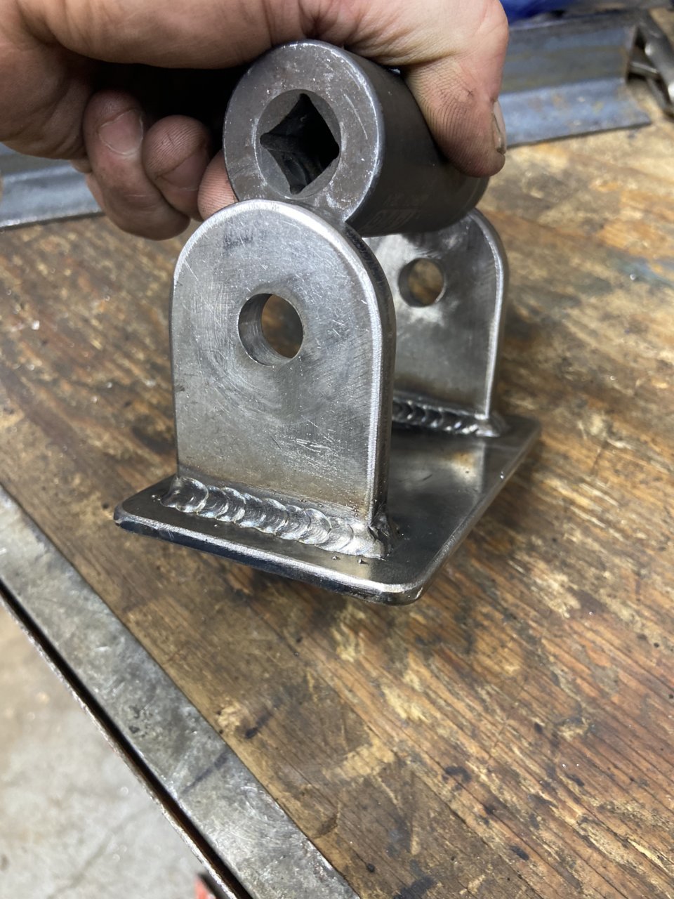

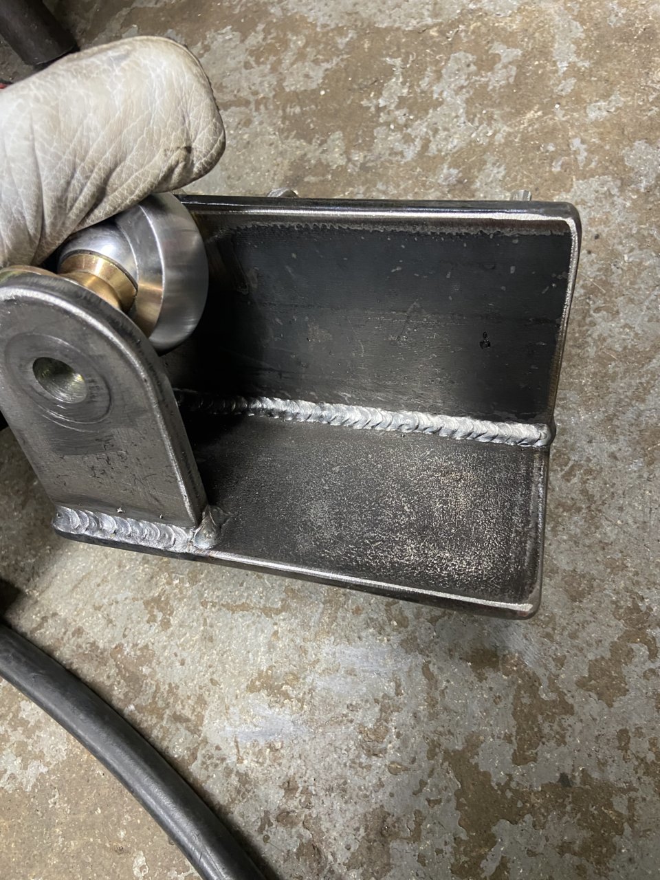

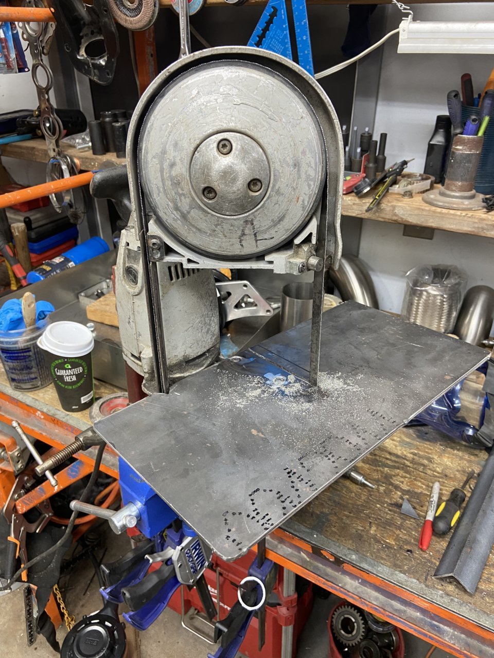

    Made a band saw thing too. Works pretty good. Totally forgot to take a pic of crossmember almost done.

  7. Sep 12, 2022 at 7:13 PM

    I love my portaband setup! You will wonder wtf you have been doing this entire time without it!

    Thanks man! The mig is coming along. I welded those on the ground cause my bench is full of shit. Have some 2x2 1/4" id throw you if you were close.
    Im looking forward to cutting stainless tubing with it. The evo doesn't work for 16g stainless even with the $120 blade.

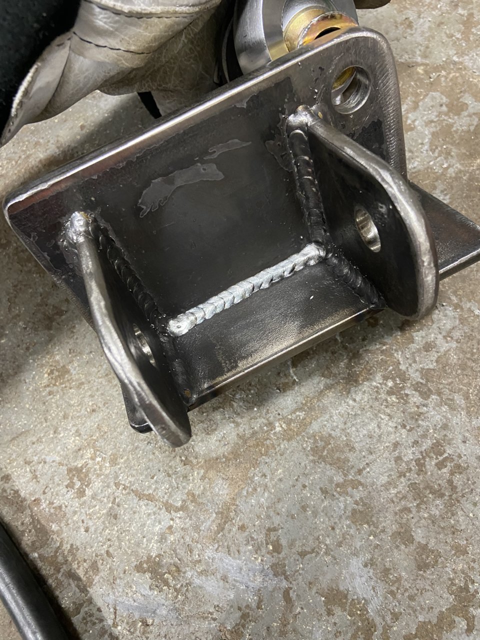

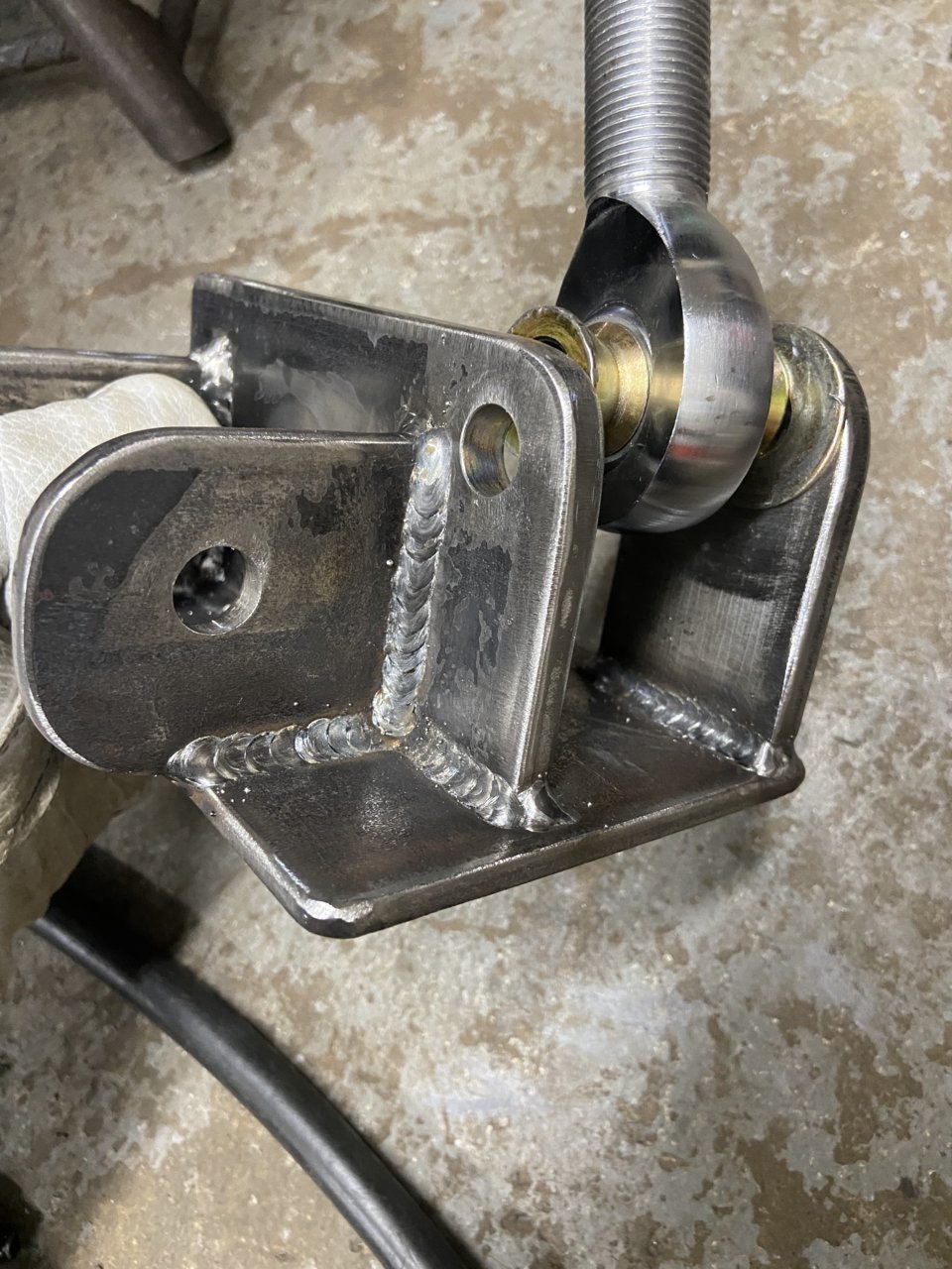

    Idk how the fuck @malburg114 got 2 crossmembers done in a weekend. I have 14 hours in this one plus the fab on the upper link/xmembr setup. 2hrs of welding alone and I still have to make the damn plate to trans and another One later for t case to do it right. Fuck!

    Making crossmembers absolutely sucks. I reused the center of a TG plate one to save time and it was still annoying to get flanges to line up on the frame side. All work on your back

    Yeah, I burned my hair, back, ankles and caught another acetone rag on fire. Fucking sucked! Im so happy im done with frame mounts. Just have to weld up a solid piece of dom to the frame in rear for ladder bar setup and its a wrap to get me driving at least.
    Im not even gonna think about the bumpers I have to fab still. :mad:
