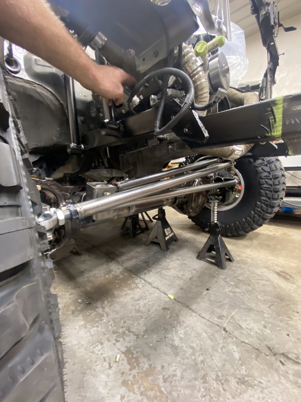

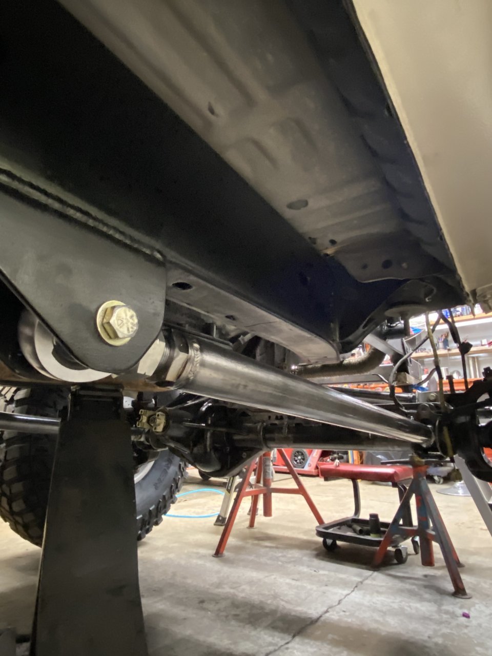

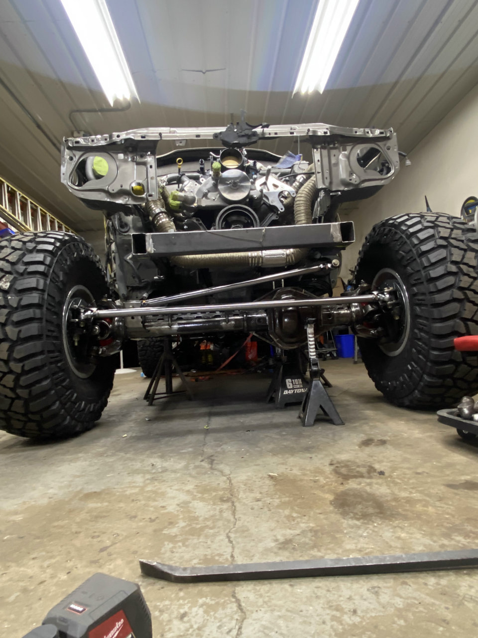

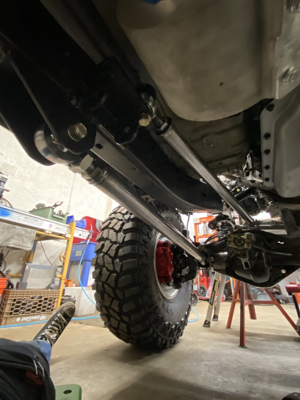

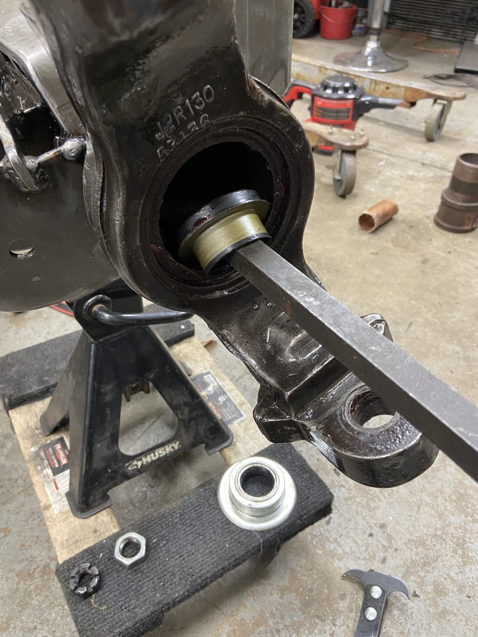

    Evening started out Shit but made it happen. The links look really cool.

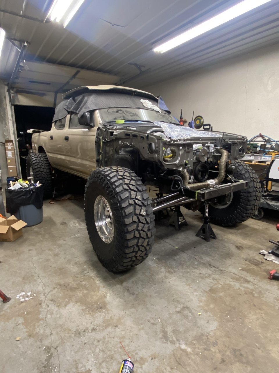

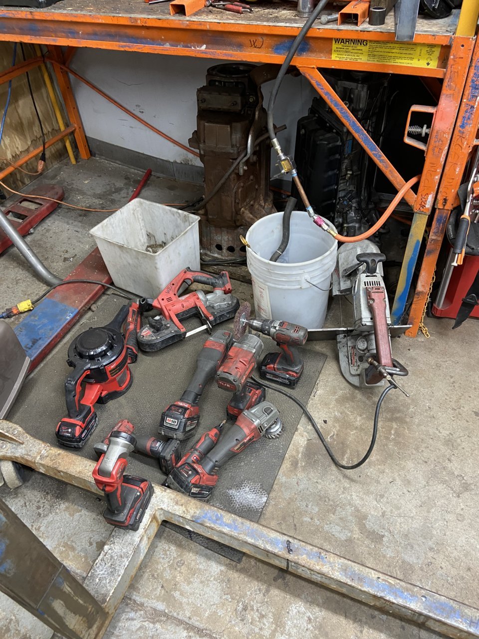

    Most of the boys hangin out while I clean. They put the work in this week. @Sperrunner @Kwikvette

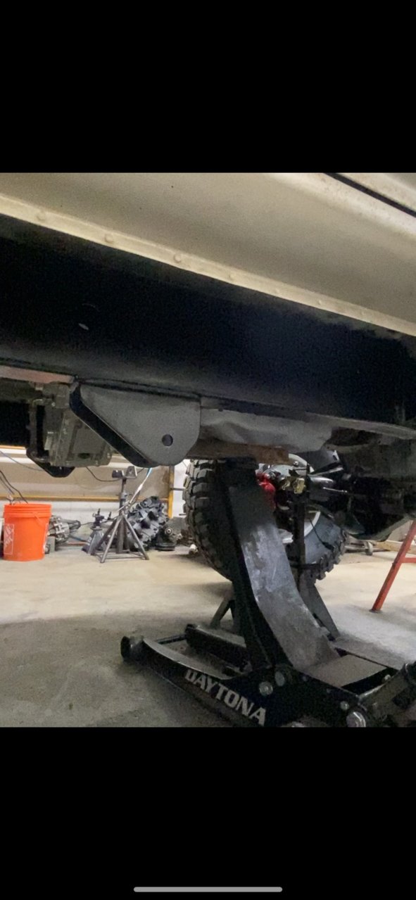

    Painted from the front new section back to the leaf mounts. I used a foam 4” mini roller. Painted w a brush and then rolled it out. Fucking turned out perfect. Ended up redoing the whole front end. pic sucks. Has the slightest bit of texture to it.

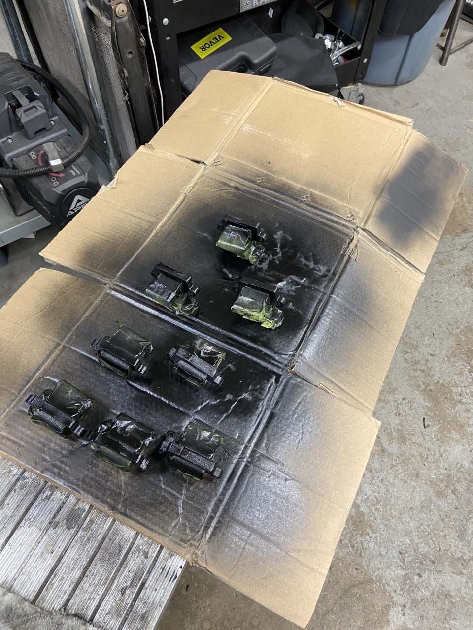

    Painted some coils w bedliner cause they are like $50 each. Fuck that. Btw, if anyone wants tons or a v8. Remember, 8 is a lot and the bigger the more expensive. My front axle has like $300 in seals alone.

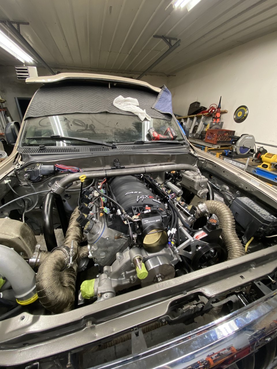

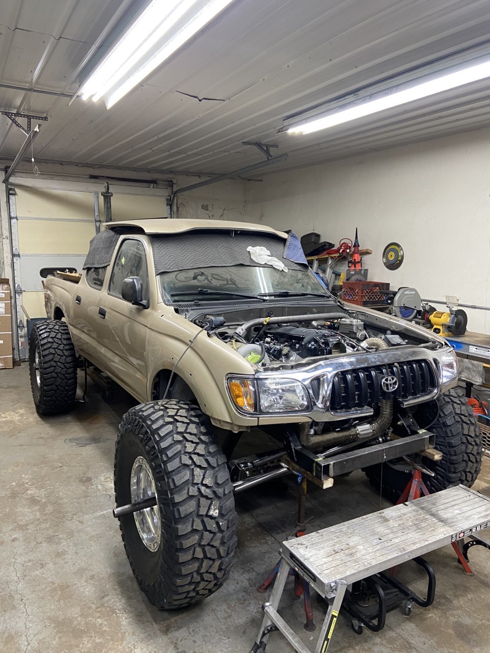

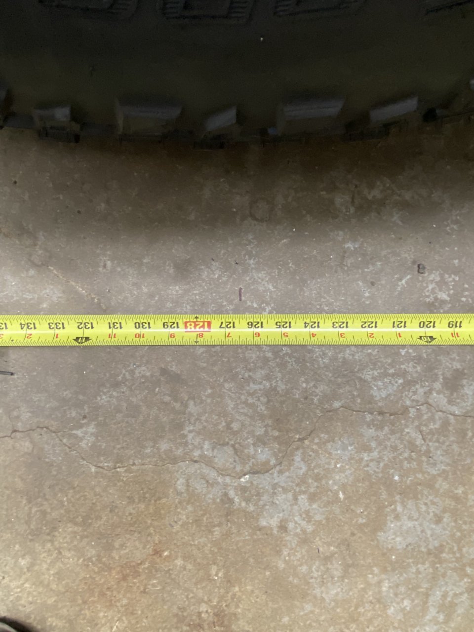

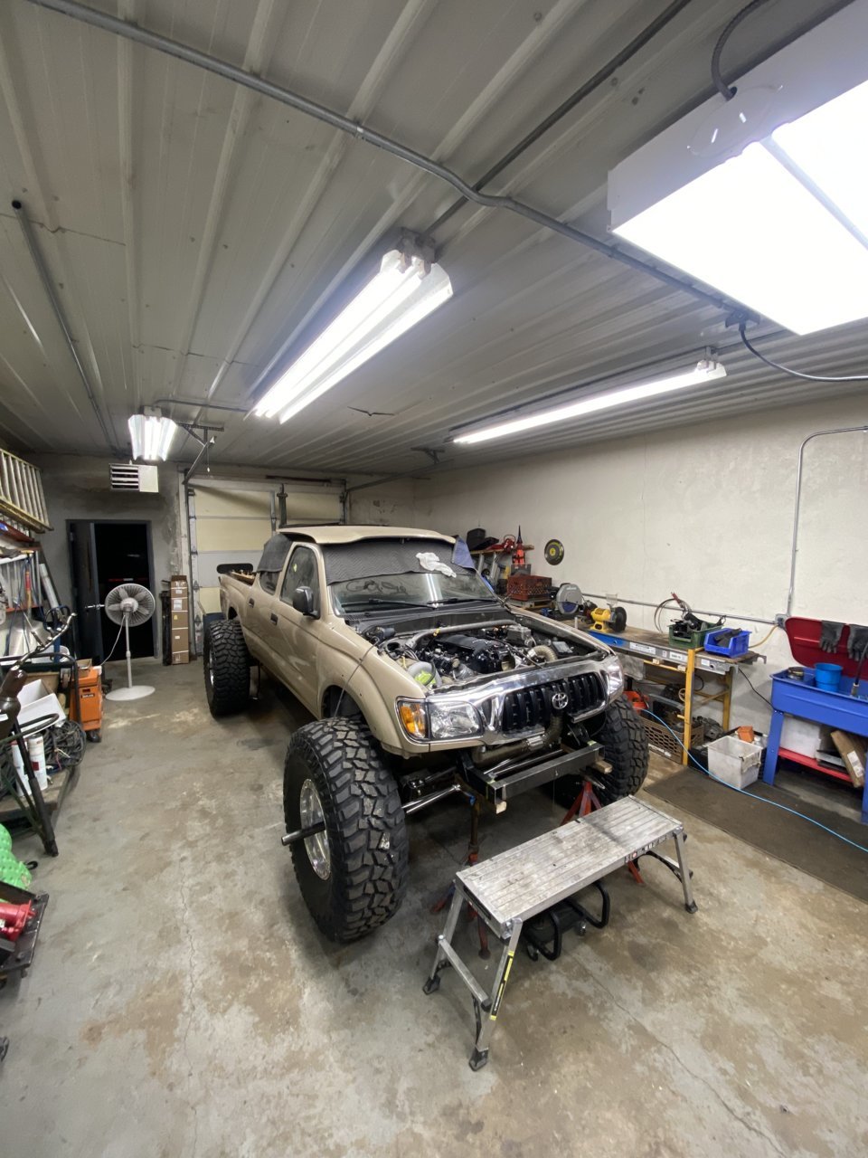

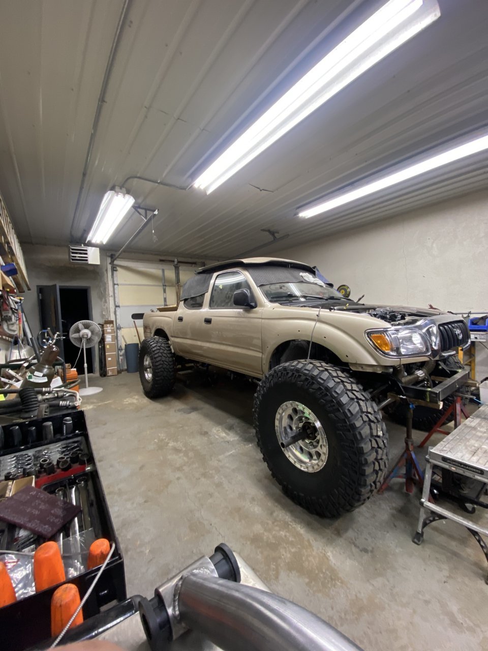

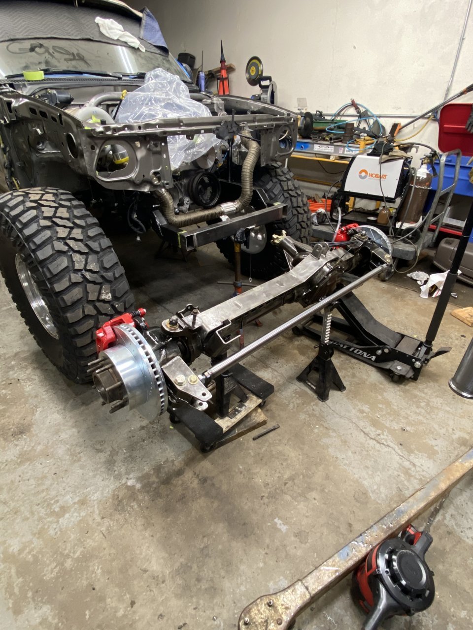

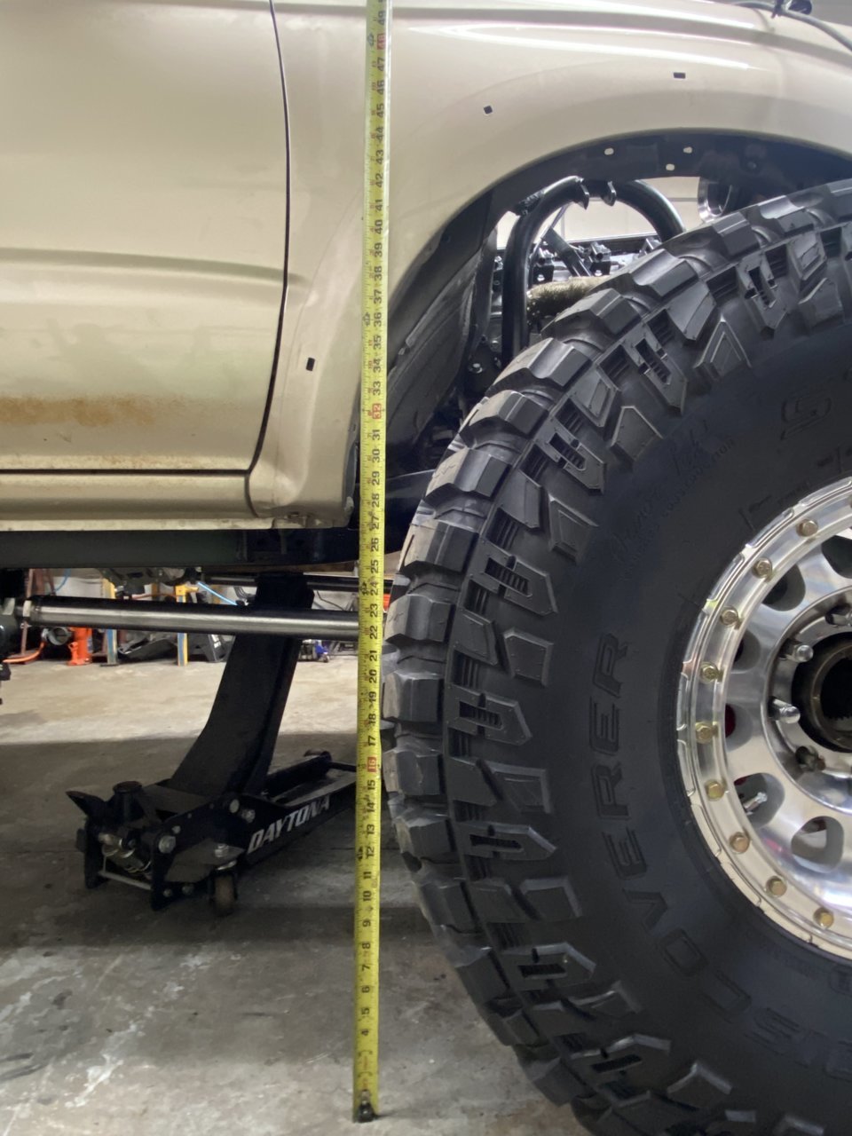

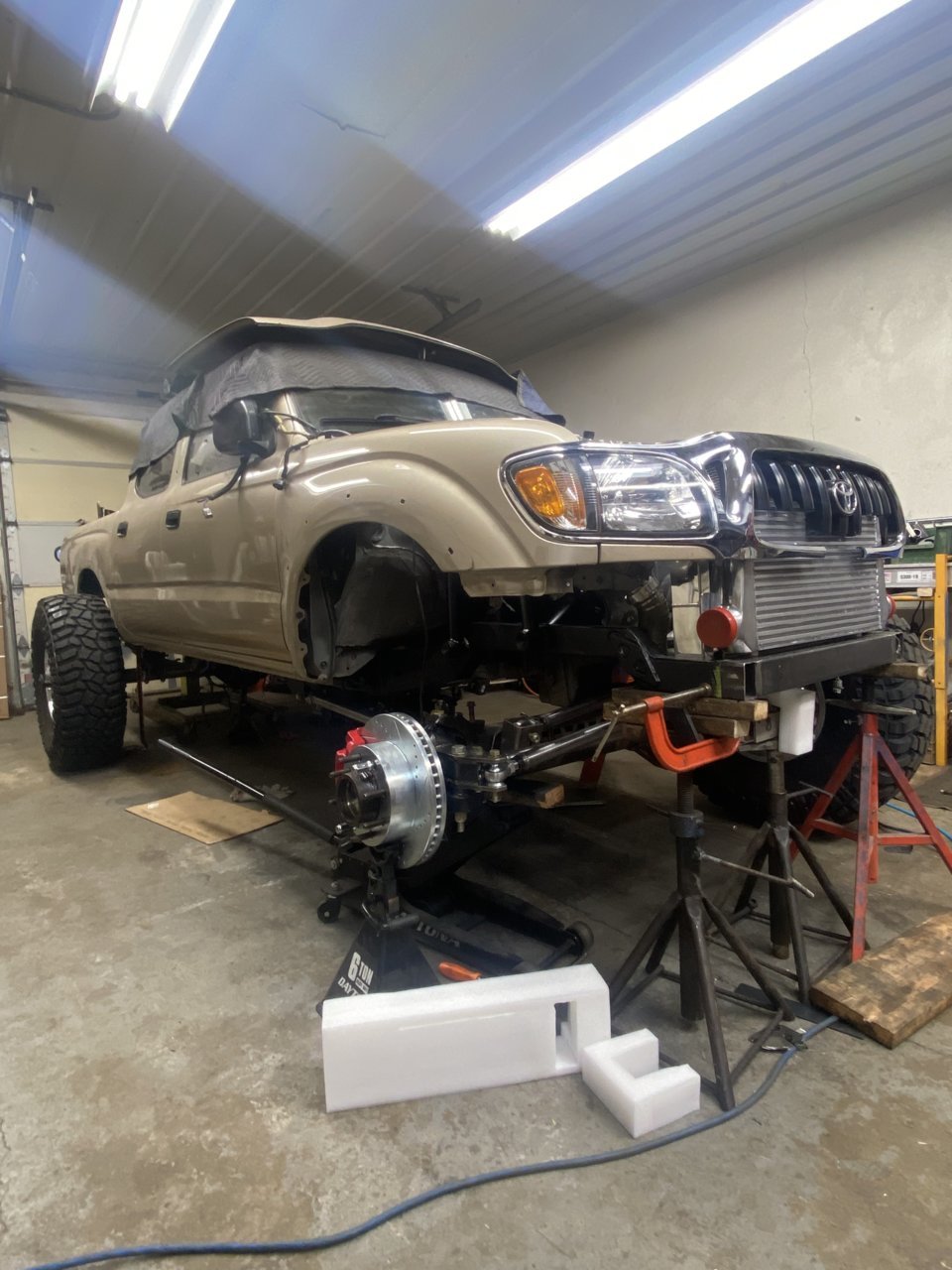

    Going on my 12th hour at the shop. Got a lot done. Did a full shop clean for the homestretch as well.
    Things are good at 24.5 but I’ll prob run 25.5 cause I think it looks a little better. I’ll see when I trim a little. Gonna cycle once more while shocks are off also.
    126.5 wheel base.
    She looks good. I’m happy with the way it sits.
    4F06C588-6292-4A36-8629-96BBB84B06A0.jpg 0F4150D5-68D3-493D-A053-0694FA866F2B.jpg

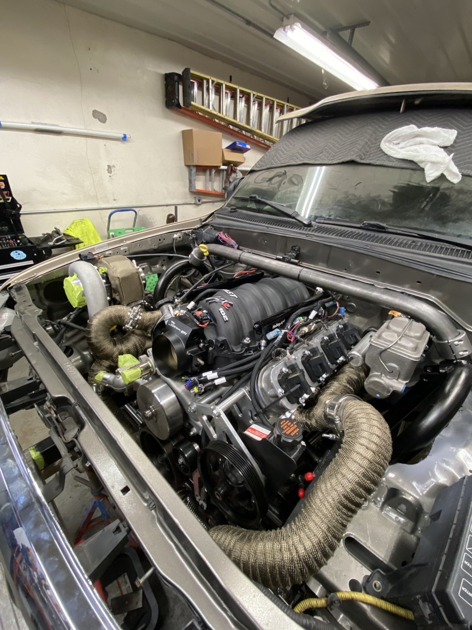

    And the big ticket item. Harness hooked up. Gotta loom it up a little but nothing crazy. Just gotta tie into the old crap and terminate a lot of old harness.

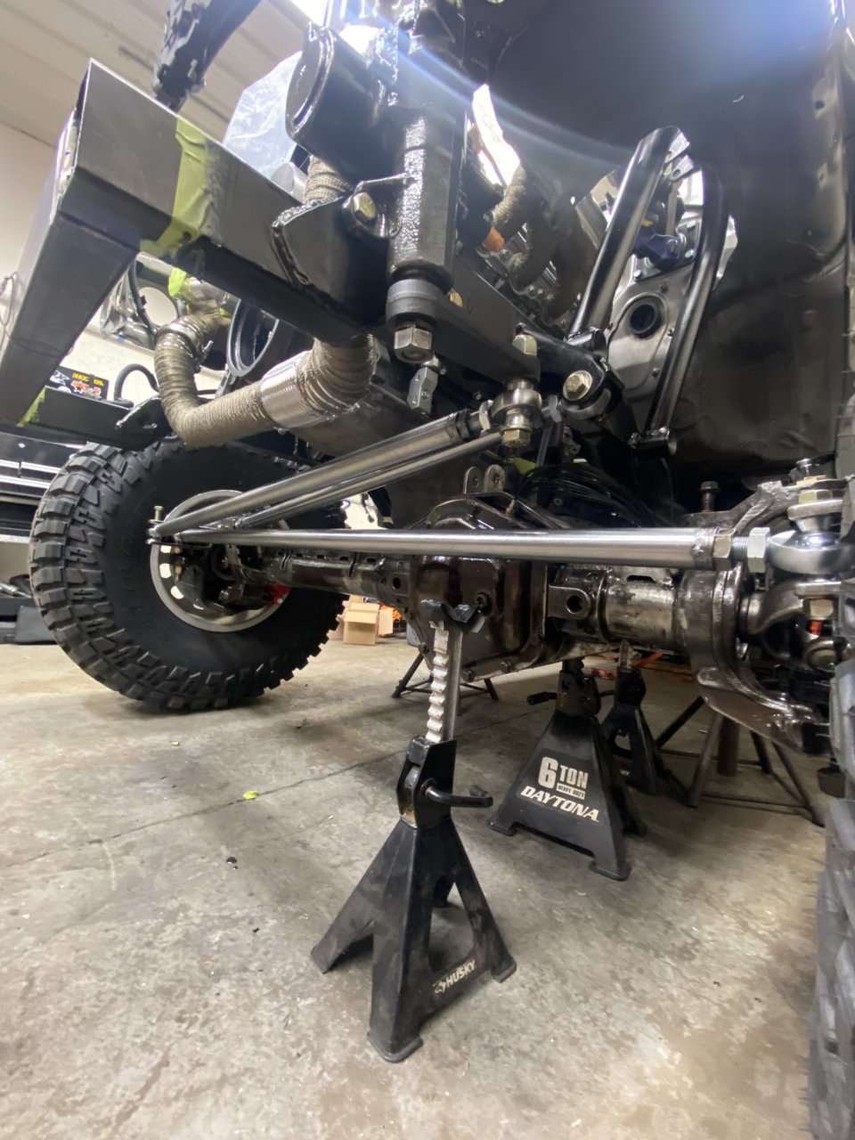

    Few more shots of links.
    33006403-F3D2-42B0-9A3A-E66AFAF47367.jpg D01AA272-B400-4F55-A1B7-2823724384FA.jpg

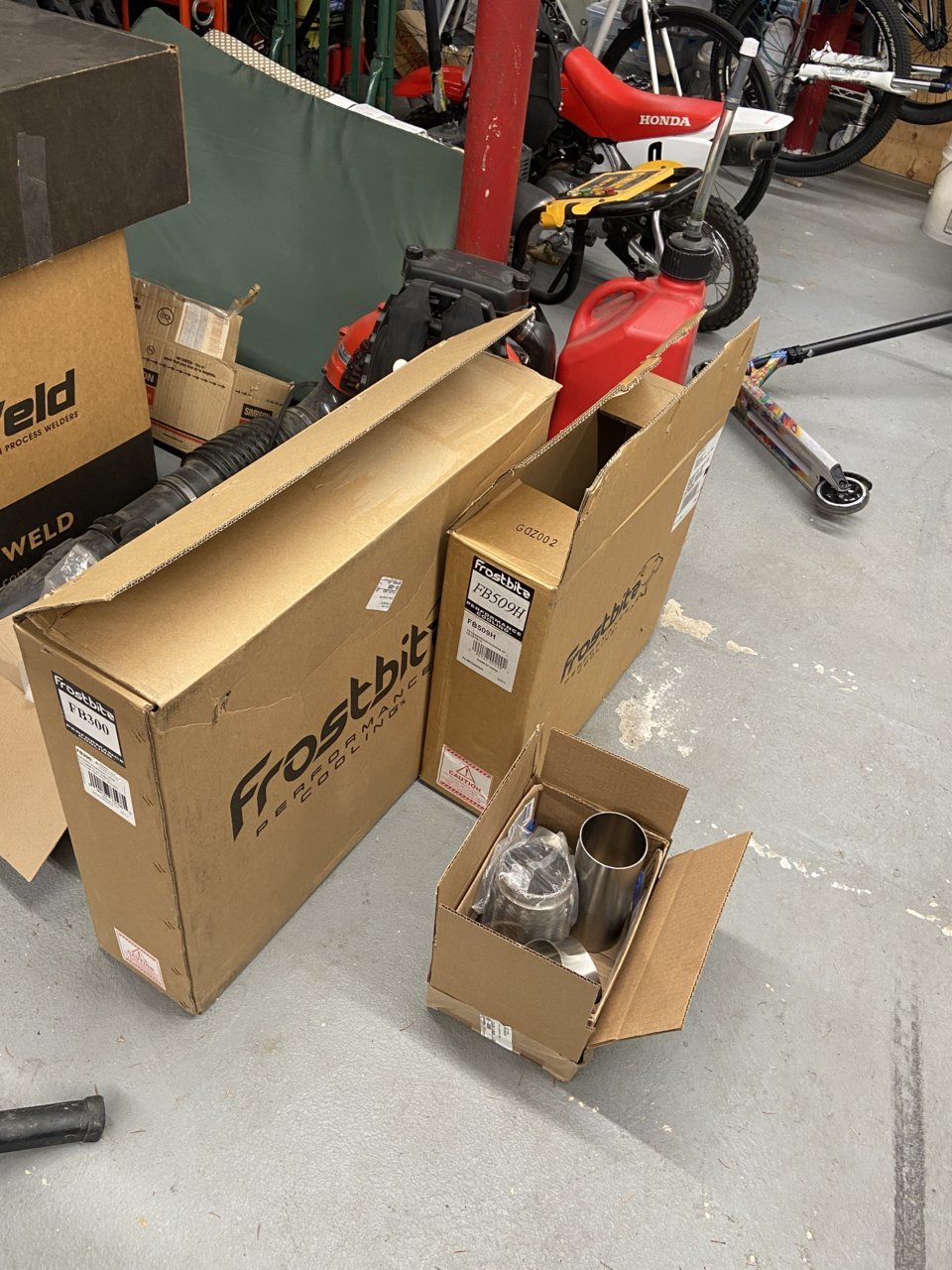

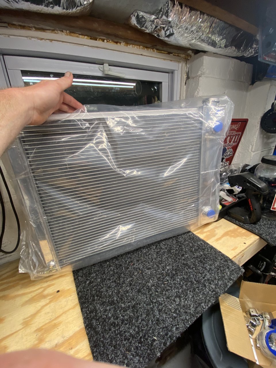

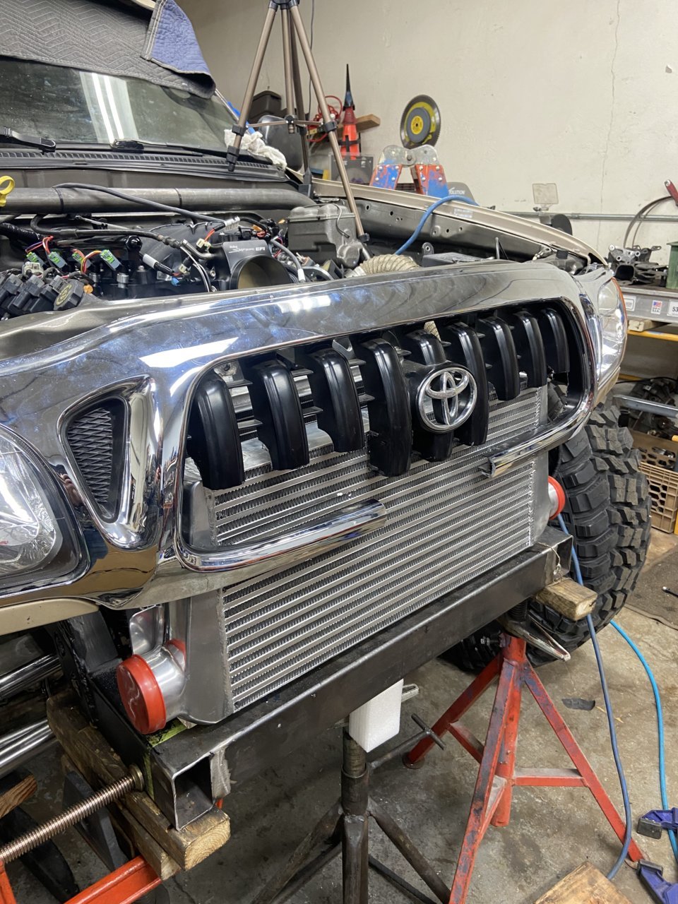

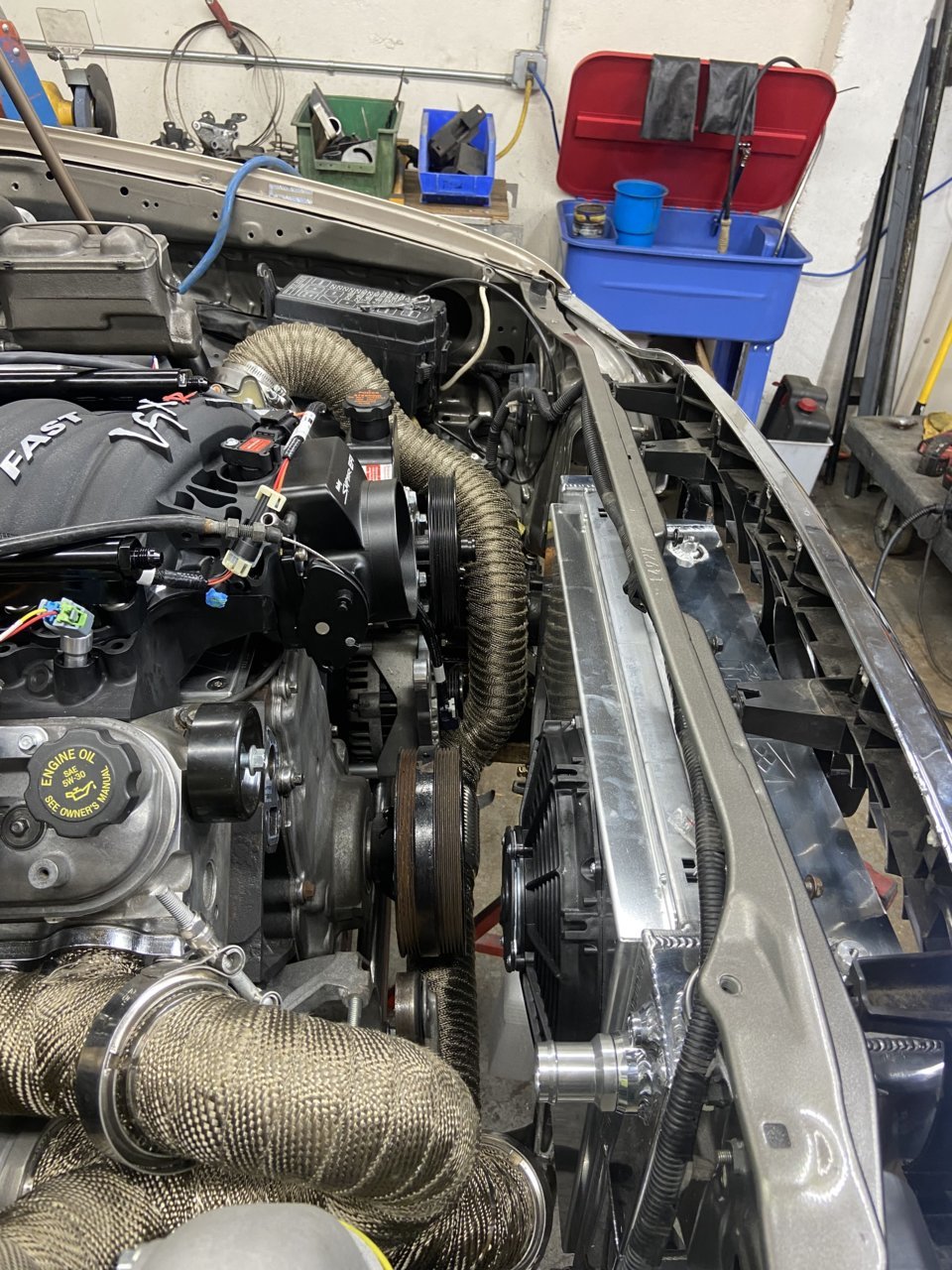

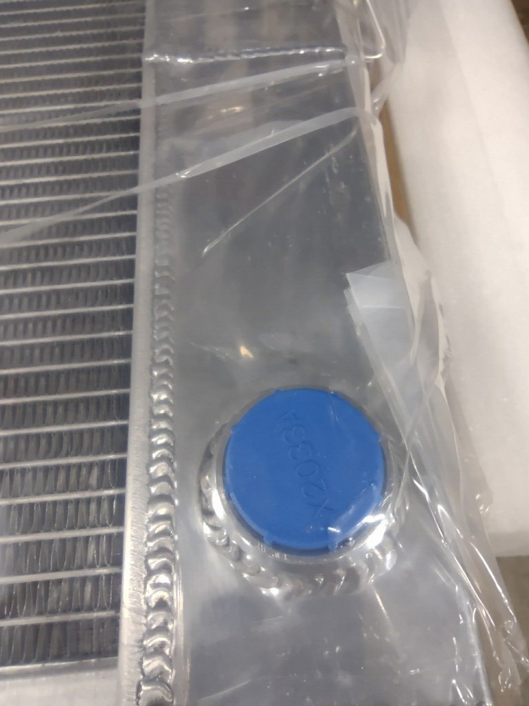

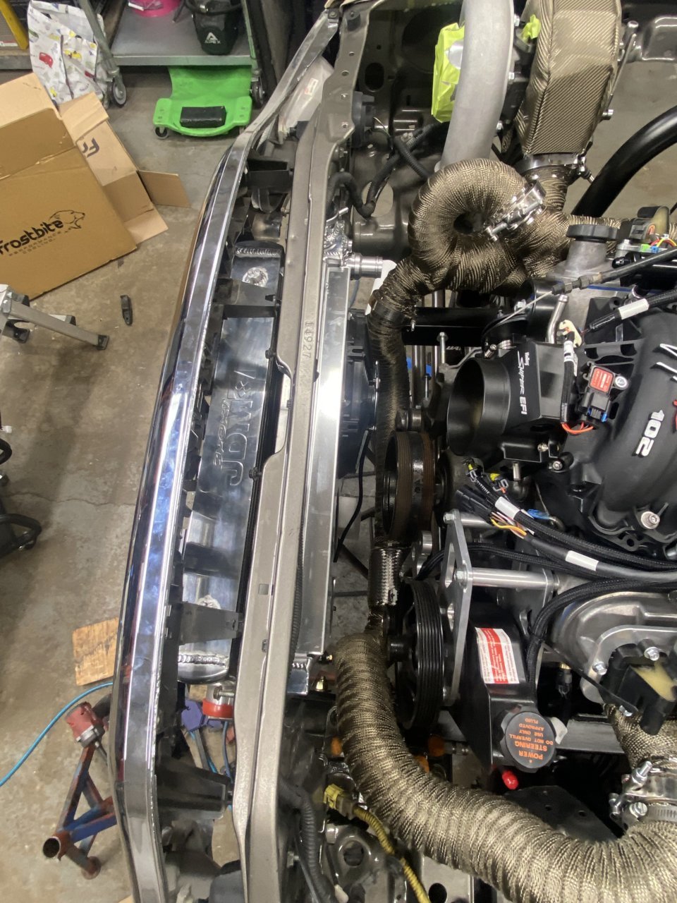

    Got my radiator/fan setup.
    2A35FB6E-F249-4B1E-A6ED-17150C4F29B8.jpg F894D6E7-884A-4BD2-B645-ED4C4F694510.jpg
    The 10 yr old sweatshop kids usually weld better than this. Must have had some trainees that week.
    And as I expected it fit like everything else I try to put on this beater. I’m running out of car to cut away. Condenser needs another inch or so. Right now there is a 1.5” gap between IC and radiator.
    Had to remove one fan. Gotta move it over an inch so it doesn’t melt.
