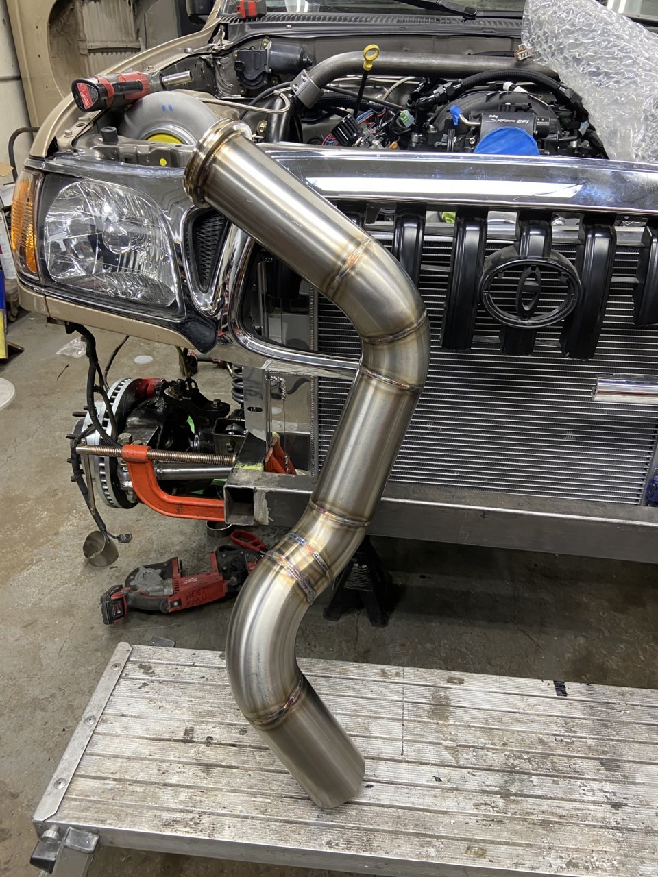

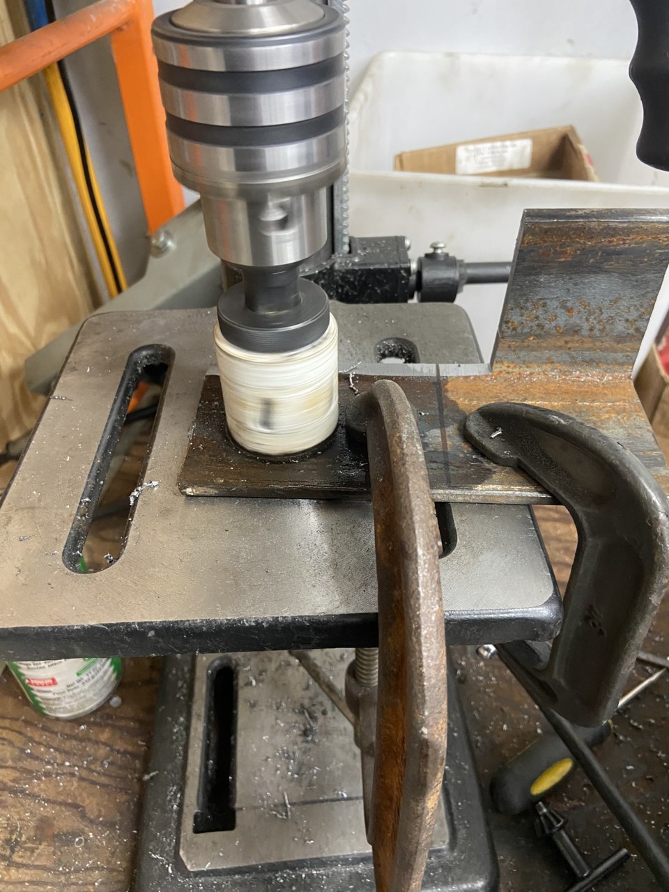

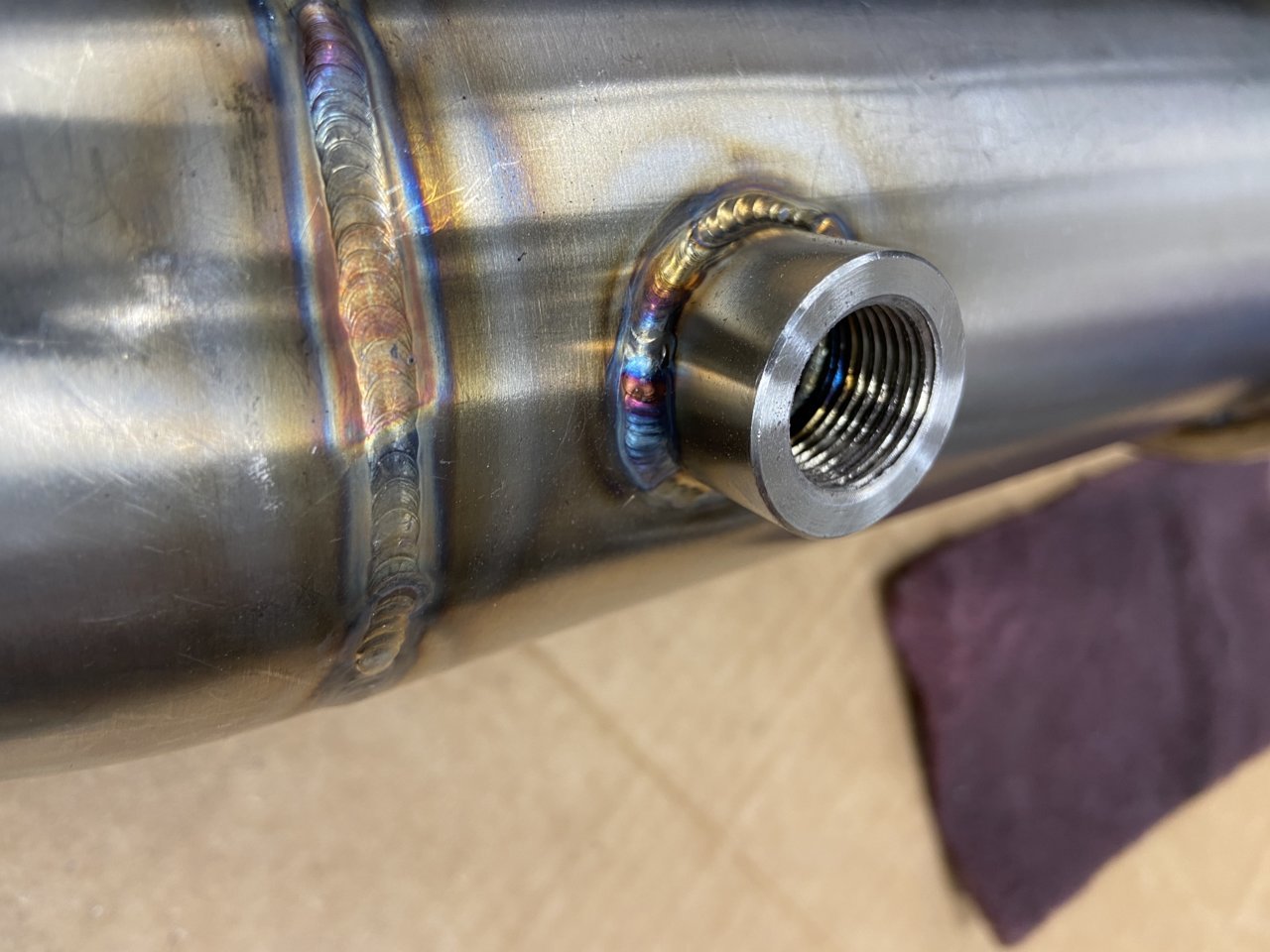

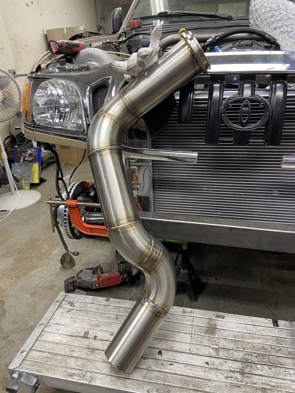

    Final product minus the vband and o2 bung. Had to extend it a bit and hone out. Kinda get a better idea of how big it is in this pic.

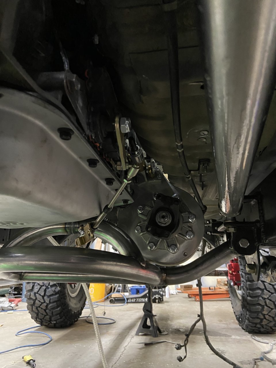

    @malburg114 @02hilux

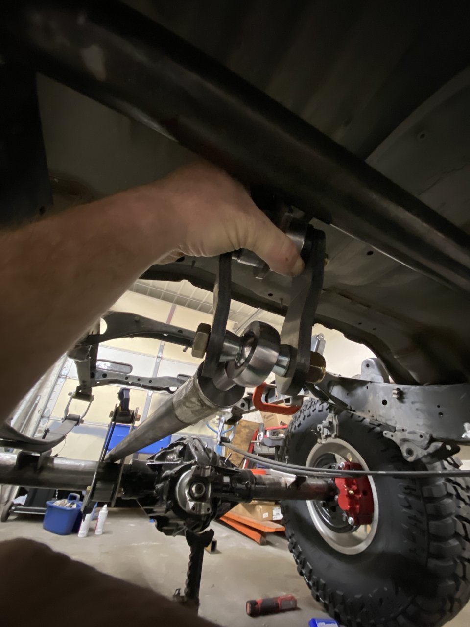

    do you see any issues with this? About 15 degrees forward and prob the 5-7 degrees in from axle mount to tower.

    ToyRyd04
    ToyRyd04 Taco Transformer
    Aug 5, 2011
    #61217
    1,879
    Greg
    Perryville, MD
    '04 PreRunner
    SAS'd PreRunner Diamond Axles Crawlbox
    Would recommend turning that shock axle mount 90*. That way your building in the ability to handle the shock moving when the leaf springs are cycling.
    Otherwise being mounted in the same axis (as pictured) your putting more strain on the shock shaft and can risk bending if pushed further than the shock mount bushings can handle.

    malburg114
    malburg114 Well-Known Member
    Dec 26, 2012
    #93766
    3,816
    Las Vegas, NV
    2001 Toyota Tacoma TRD
    What toy said. Rotate the the lower mount. I’d imagine you’ll have to angle the tops toward the center of the truck to clear the tire at articulation. I found angling the shock tower towards the front and mounting the shock mount off the front of the axle tube help combat axle wrap a little too.

    slander
    slander Honorary Crawl Boi
    May 10, 2013
    #103909
    8,964
    Hickory, NC
    02 Tacoma, fixed with curse words.
    Box that frame while your back there so you don't bend the fuck out of it in like 4 planes like me.

    Yota X
    Yota X [OP] Some say dresser, I say dryer.
    Jul 11, 2019
    #298961
    5,268
    NW New Jersey
    1st gen
    ls turbo, tons, 40's and a partidge in a pear tree
    Ok. I’m actually having a slight issue w that in the front. May have to notch it slightly.
    Those come w a natural offset that is a bit too much. Prob gonna have to cut it off and mount the flat part instead to get it more vertical.
    Thanks for the info guys.

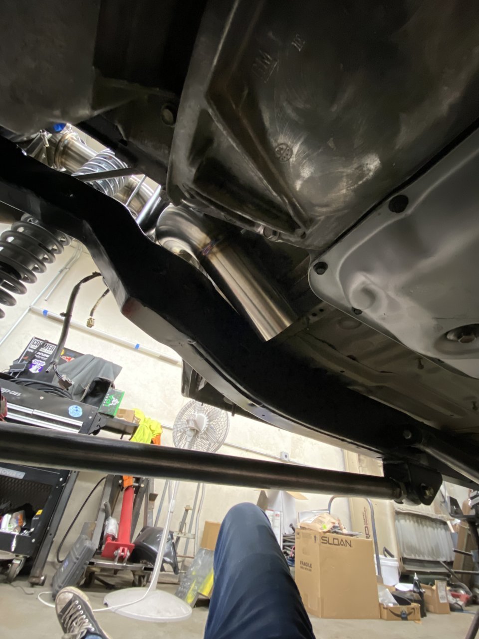

    Super big ticket item banged out finally.

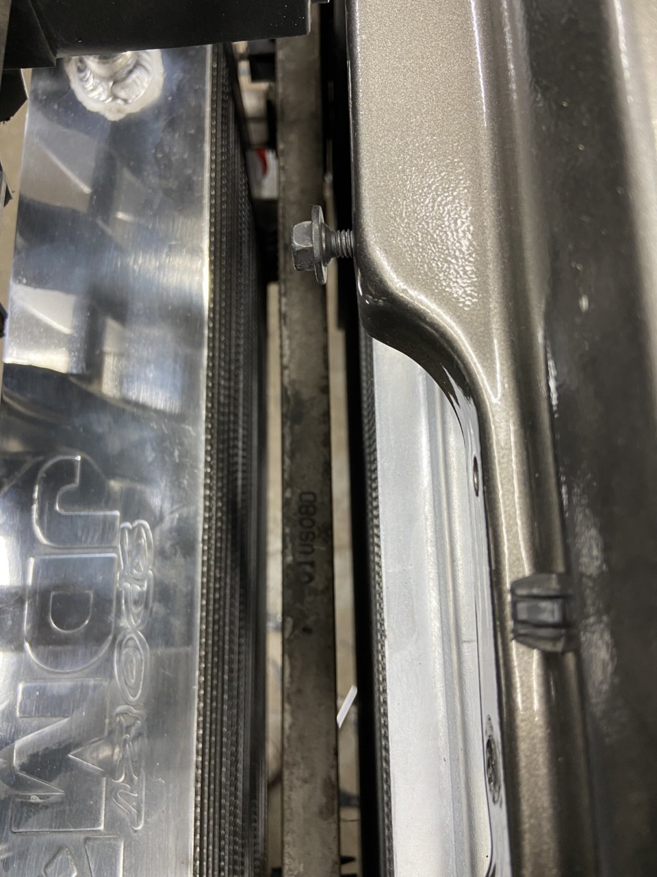

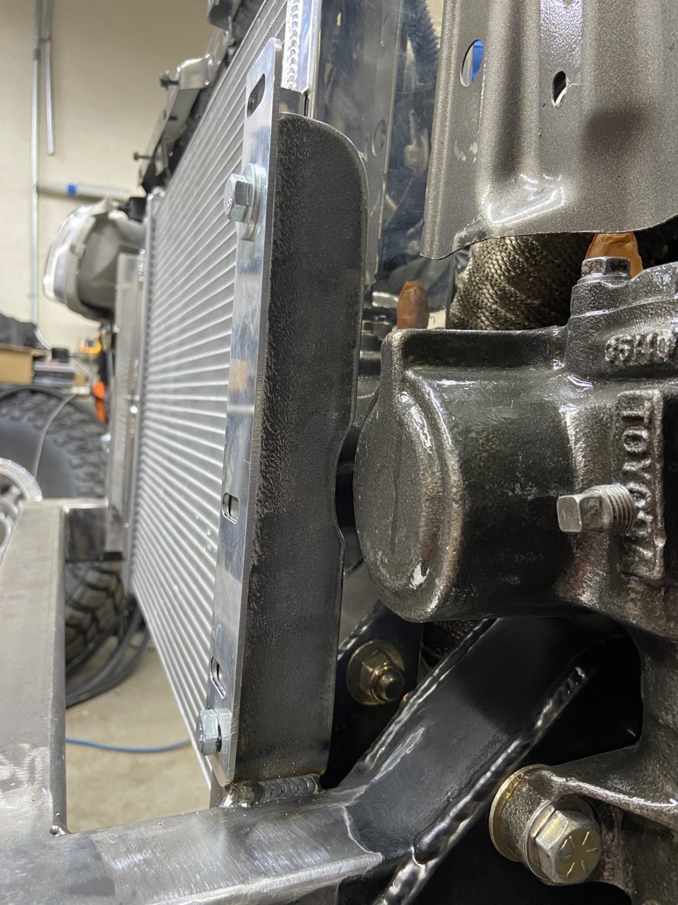

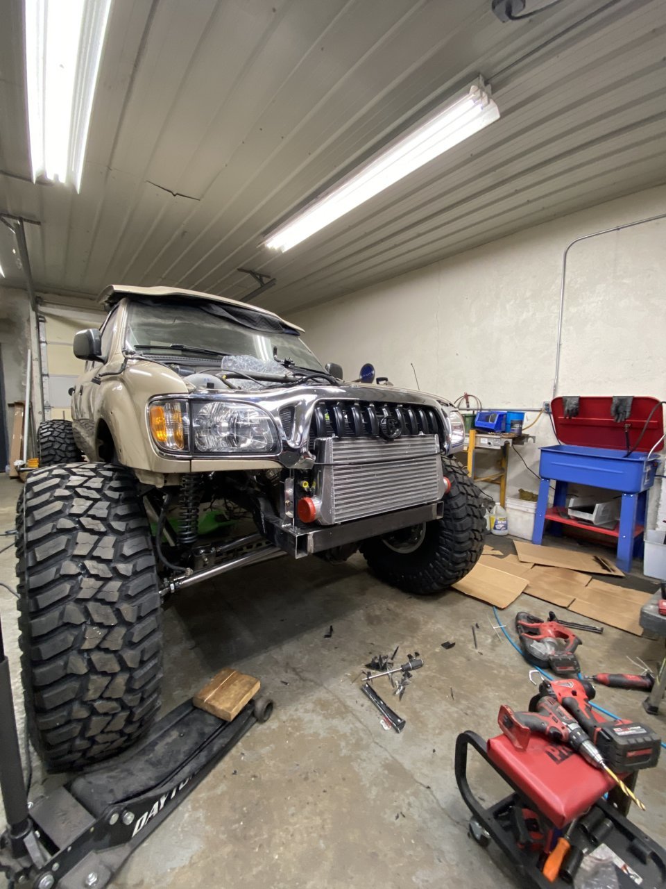

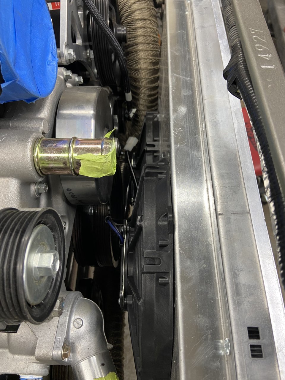

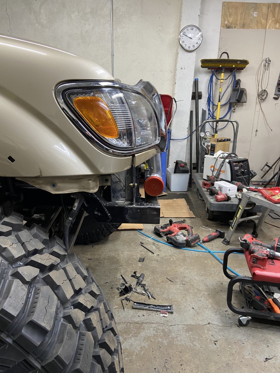

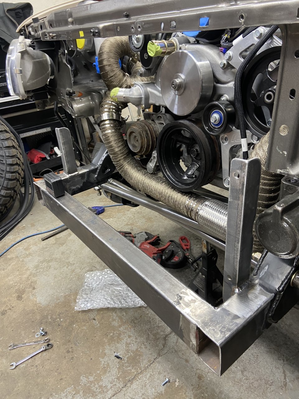

    The Toyota gods have been on my side the last few days. Got stock condenser in and I’m pretty sure it will work. Lost the grill and she looks buck toothed as fuck but that can be fixed easy. Winch gonna be slightly farther than I want but fuck it.

    Wide band bung.

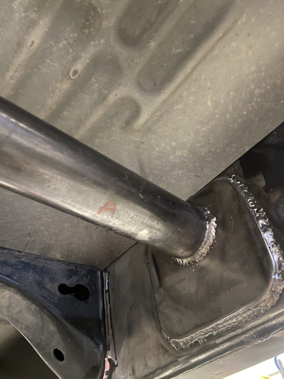

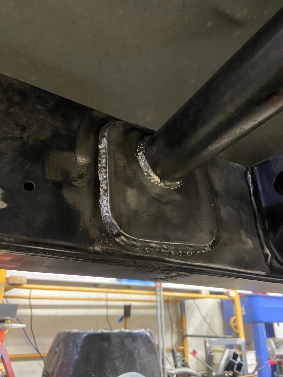

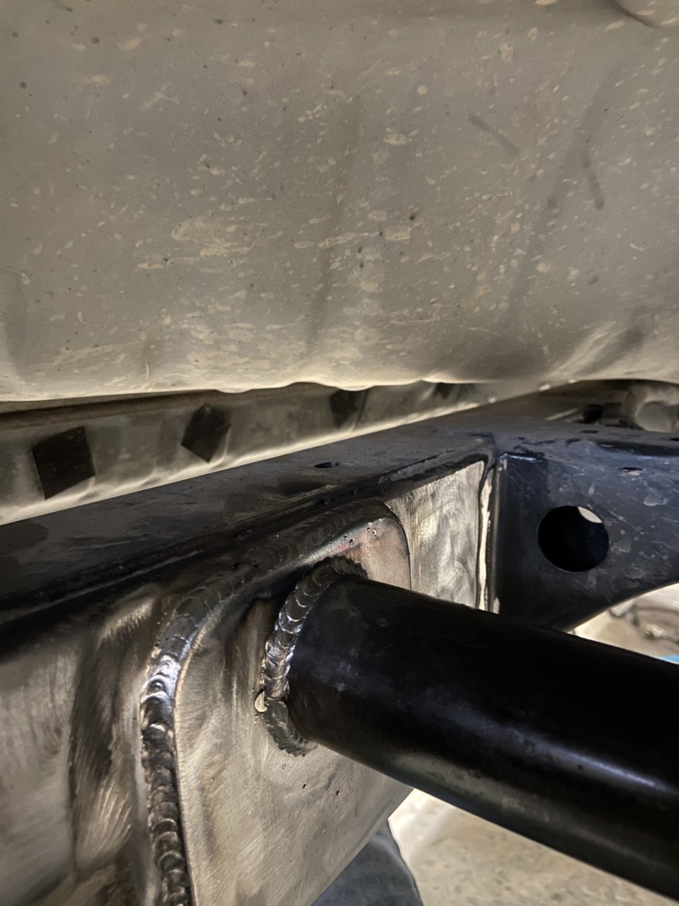

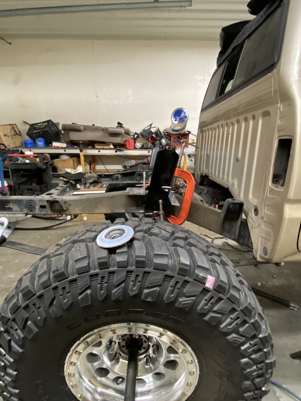

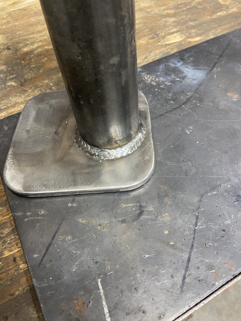

    Anti-wrap bar brace. These frame welds are such a pain in the ass. Shit everywhere, helmet hitting everything and it got a little crooked on me and I didn’t even catch it.

    02hilux
    02hilux What do you mean there’s no road, I’m here
    Sep 14, 2016
    #197244
    6,305
    Planet: EARTH
    Look good to me
    Yota X[OP] and skeletron like this.

    skeletron
    skeletron Disgraced Member
    Dec 2, 2020
    #348476
    2,180
    Clark
    Sakerlina
    2020 TRD Broh
    Yeah I think I'm too blind to even see the imperfection
    Yota X[OP] likes this.

    Plate got crooked. Its fine. I just hate when you spend time fabbing shit and you let the heat warp something or you do something crooked. Just annoying especially at this point.
    Working on mount to brace now. Typical AW bar setup from what I’ve seen at least.

    02hilux
    Sep 14, 2016
    #197244
    6,305
    Planet: EARTH
    Yes sir. Heat will NOT be your friend...
