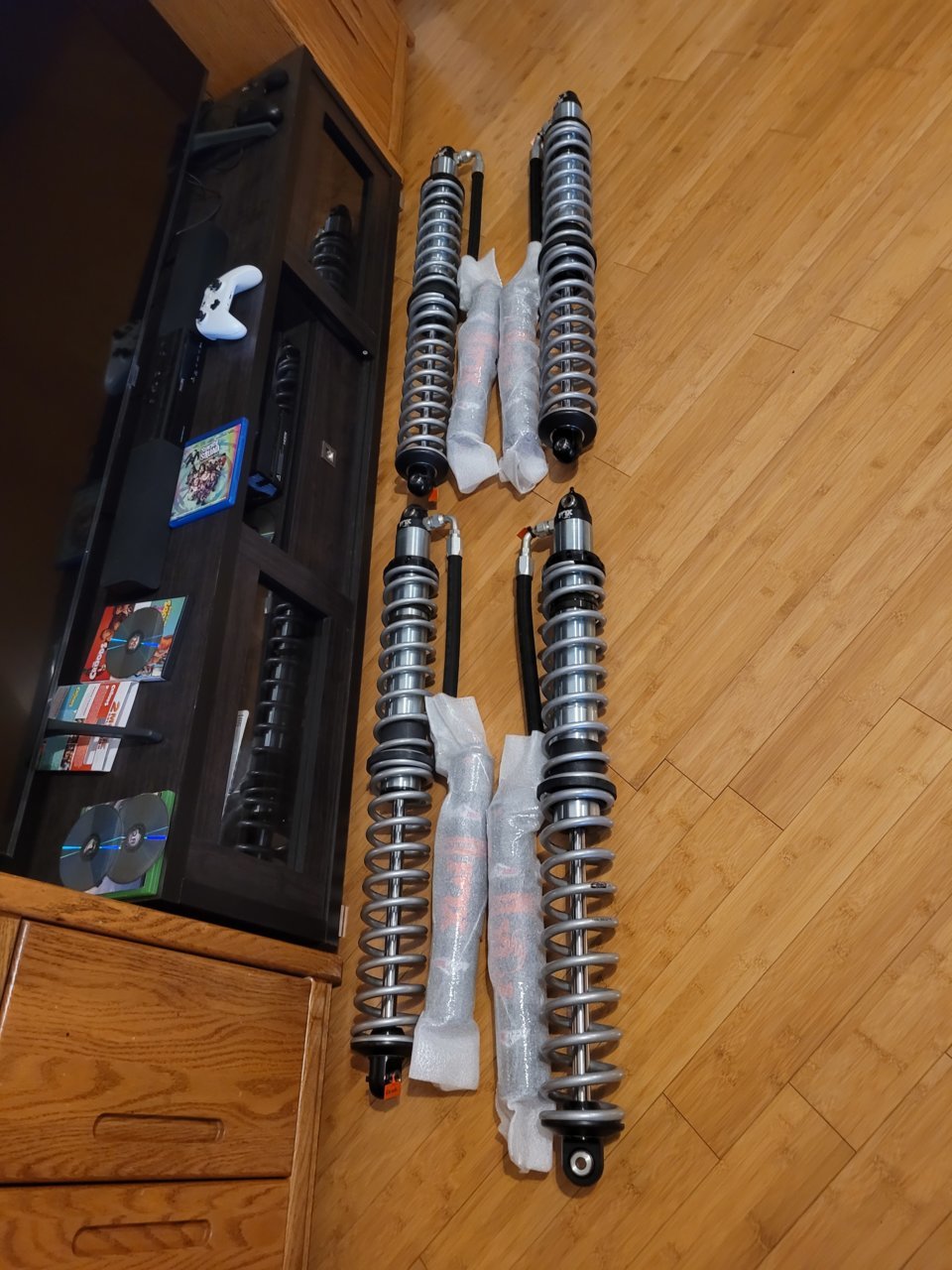

    I got 14's to fit perfectly on my rear end. I can use the entire 63 spring with about 1-2" leftover on both full bump and down travel.

    What is your eye to eye at ride height? Im at 26 and think I may have to raise now for these.

    Good question, I'll have to put my leaf pack back together and check. I currently only have the main leaf in. I'll try to measure that Tomorrow for ya! I did have to run an OSR kit, without it the 14 would not have fit.
