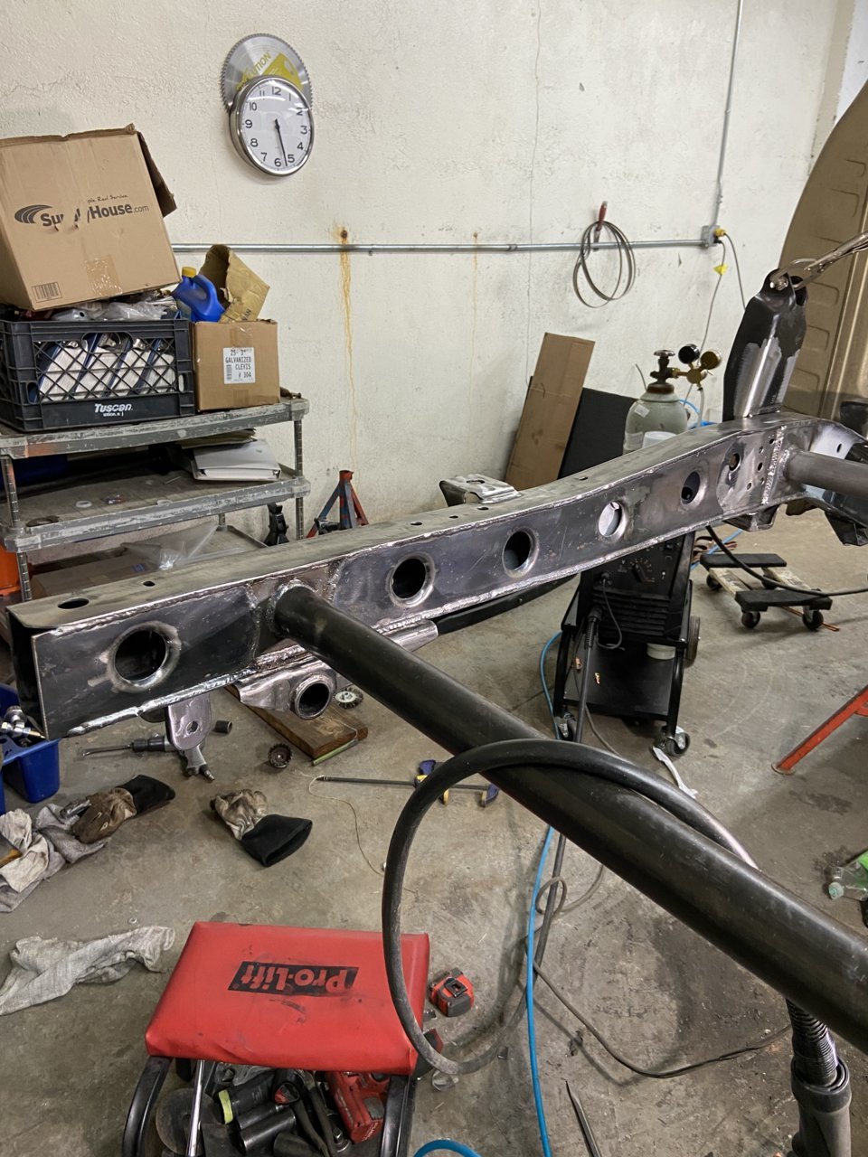

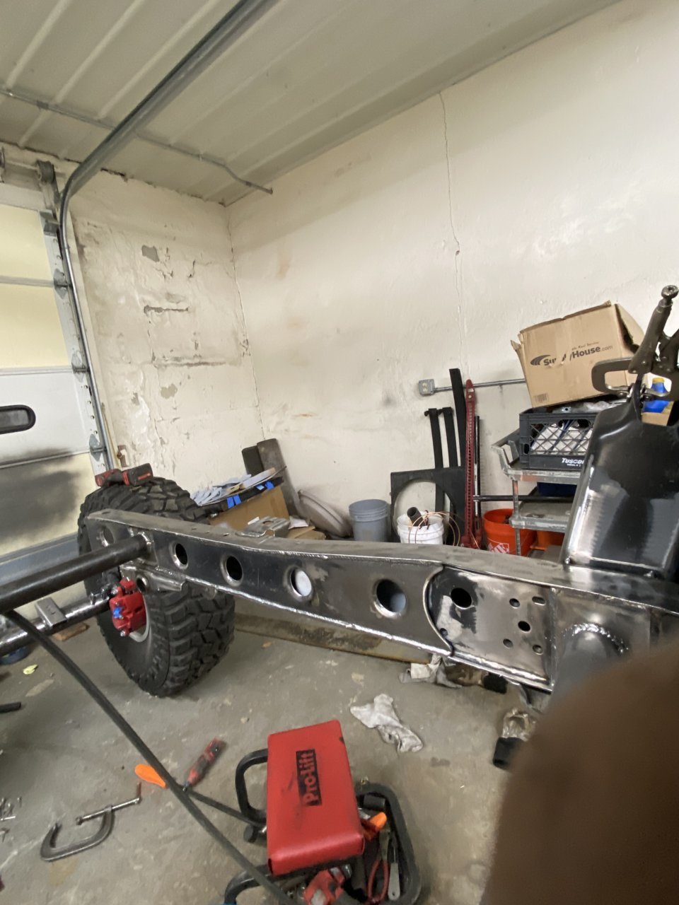

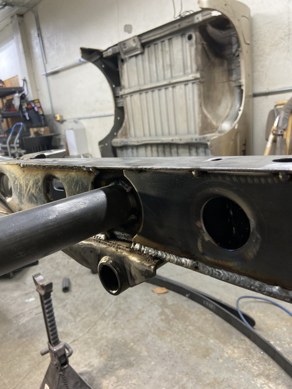

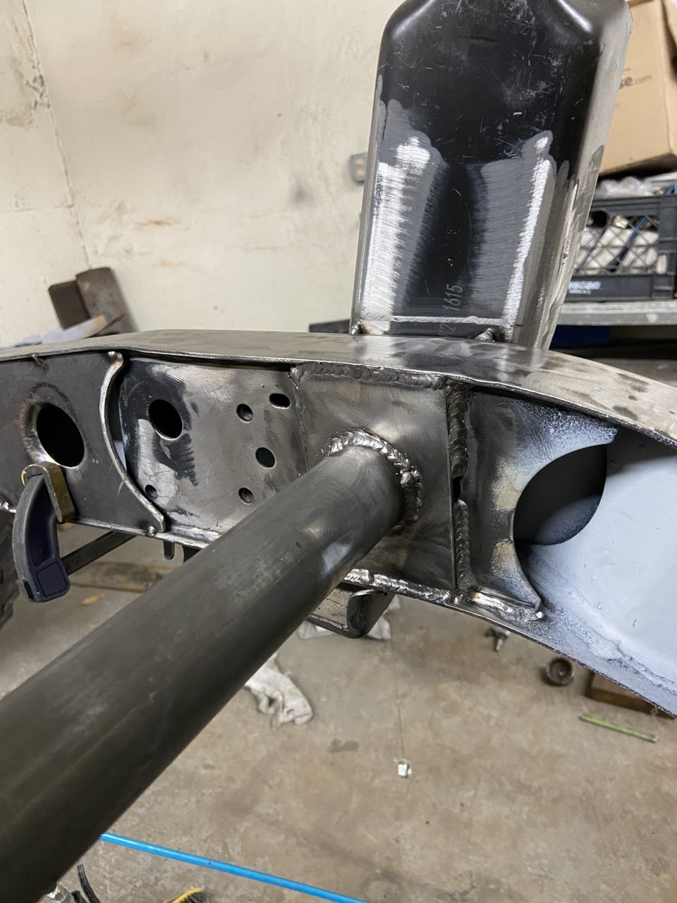

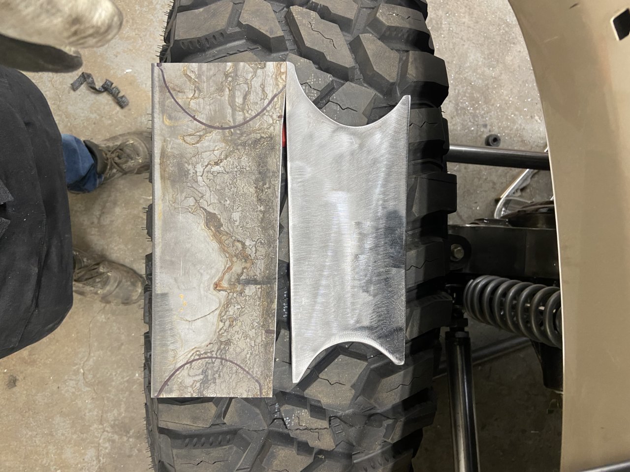

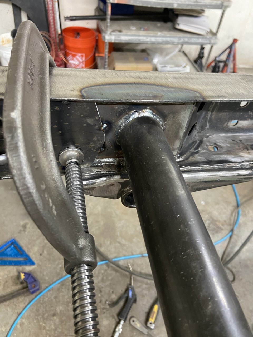

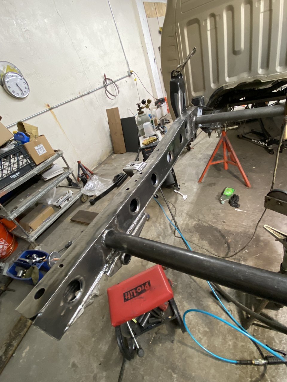

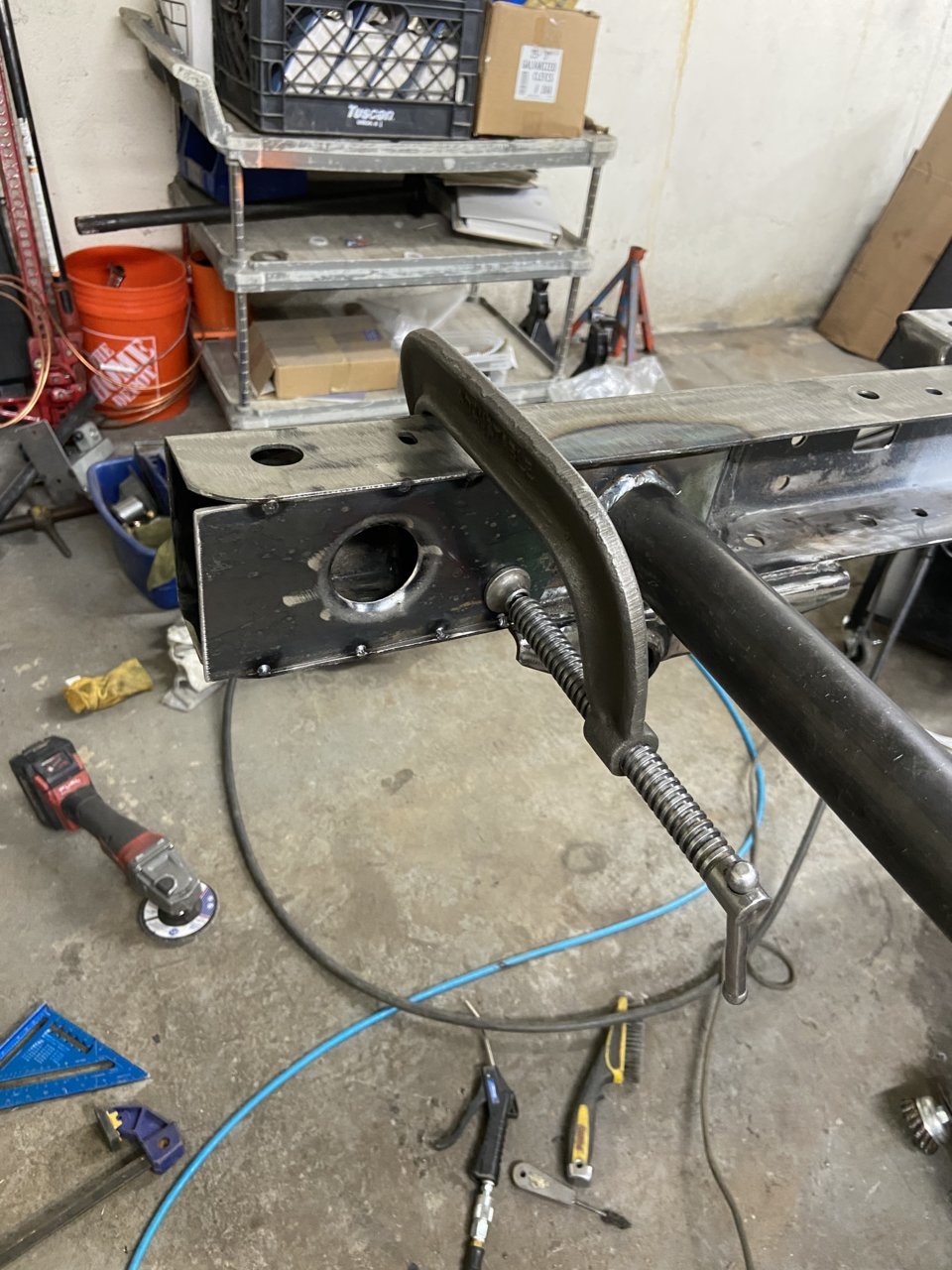

    Didn’t realize how weak these frames are till I started this.

    Aren't they heat treated?
    So yeah they're C channel so far from being as strong as a fully boxed frame but they should hold up well for the average person.
    That boxing of your frame is looking sharp!

    Drop bracket lift and booger welds
    The fab part of me LOVES the dimple die frame boxing. The NJ salt has me concerned.

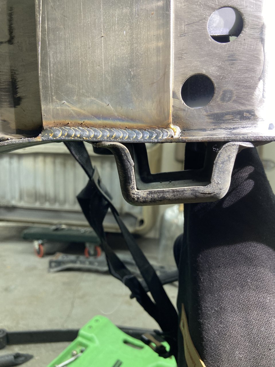

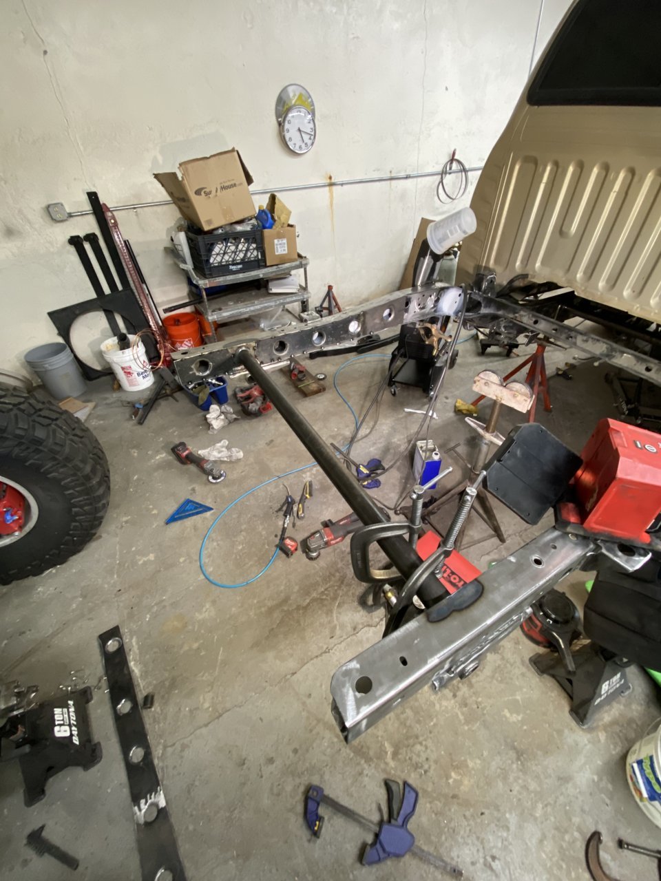

    I know. I’m soooooo close to being done fabbing though. I’m over it. Just wanna make shit at my house that I can walk away from for a week. It’s been a hard year.
    They are heat treated now! Lol

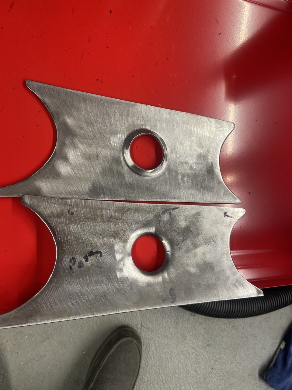

    I like it too. Super slick looking. Im gonna have an 1/8” of chassis saver on that whole shit. Gonna spray inside if brush won’t get it all. That was honestly the reason I started putting holes in it. Wasn’t for looks. It was to paint the damn thing inside!
    This is 3/4 of one side done. Took me 2 hours to Fab x-brace and weld this fucker. Had to keep skipping around cause of heat so not great for nice clean runs but I figure the dimple die holes will distract the average critique. Lol
    Started off strong then started getting tired and lazy.
    Did the x-brace then removed rear factory one. Did another then removed the second. I wasn’t a fan of where they were located anyway. Now there is one at shock towers and one almost in the rear. Plus the other one for the anti wrap. She’s fuerte!

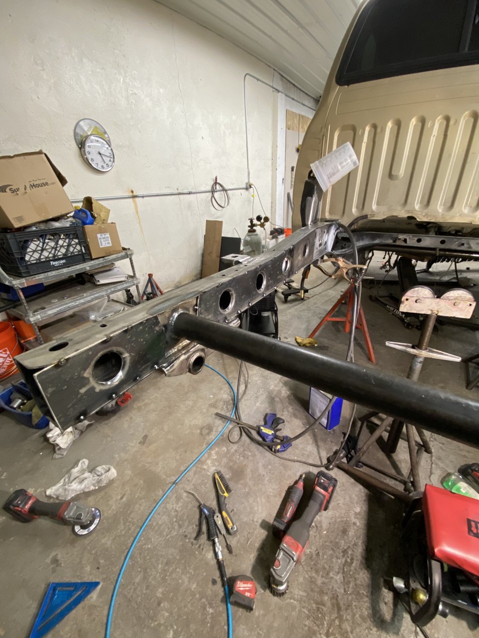

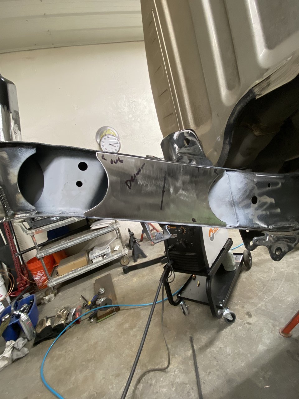

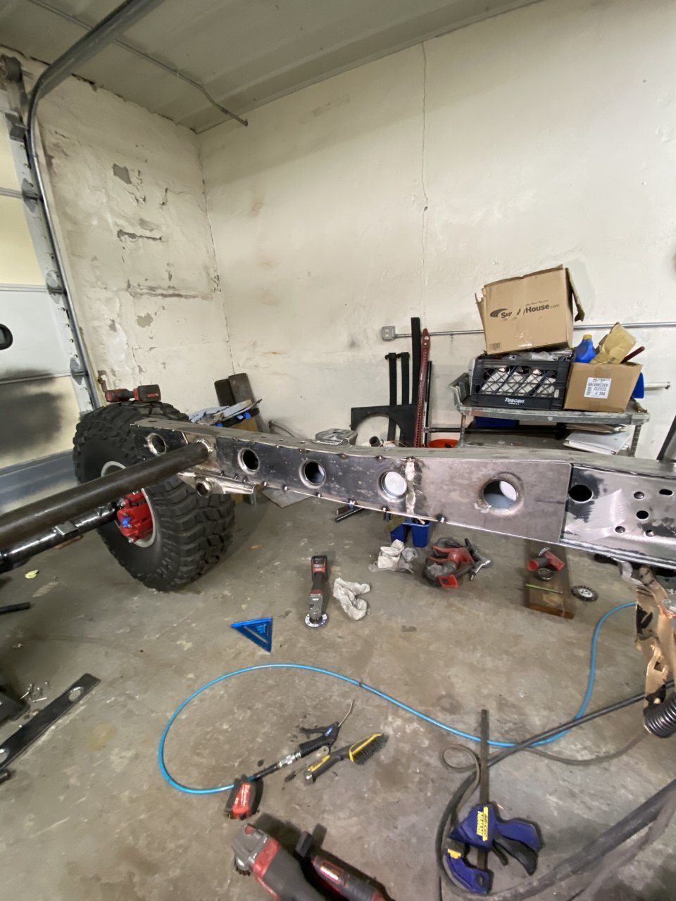

    Got the other side kinda done. Having gas issues. Idk why but was welding like shit so stopped and called it.
    Redid the pass side diff at the rear by bumper where the plates meet the cross bar cause I didn’t like the first setup and it’s better for corrosion. Looks 10x better I think.
    9E3353DF-88E8-4F1F-A68D-6AAF6F512626.jpg E8676987-F4AF-4B48-97BF-55B16B162AF8.jpg A8B81420-89DB-4A03-BD1B-F11843E81A59.jpg
    All about the dimple die. Figured out how to do it nice now. These holes are way cleaner than the main plates were.

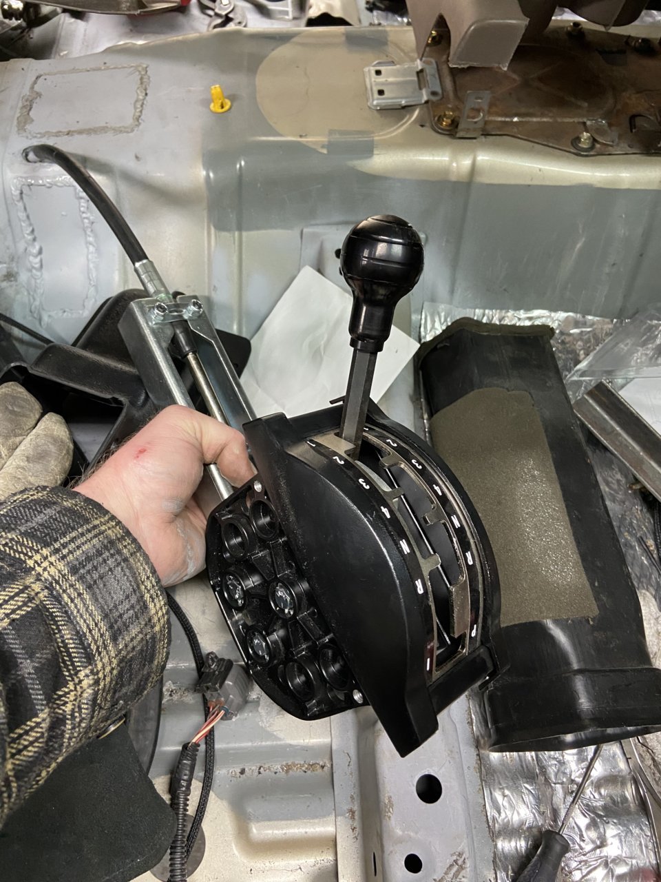

    This thing right here is fucking garbage! Idgaf how many rock buggy’s or prerunners have them. WINTERS GARBAGE! The only thing it’s good for is testing my patience and blowing my mind. Its a straight up autozone special on so many levels and whoever thinks otherwise deserves one. I can’t believe that I have this in my truck. Fuck!

    Woulda used it but can’t. Trans has an extra gear.
