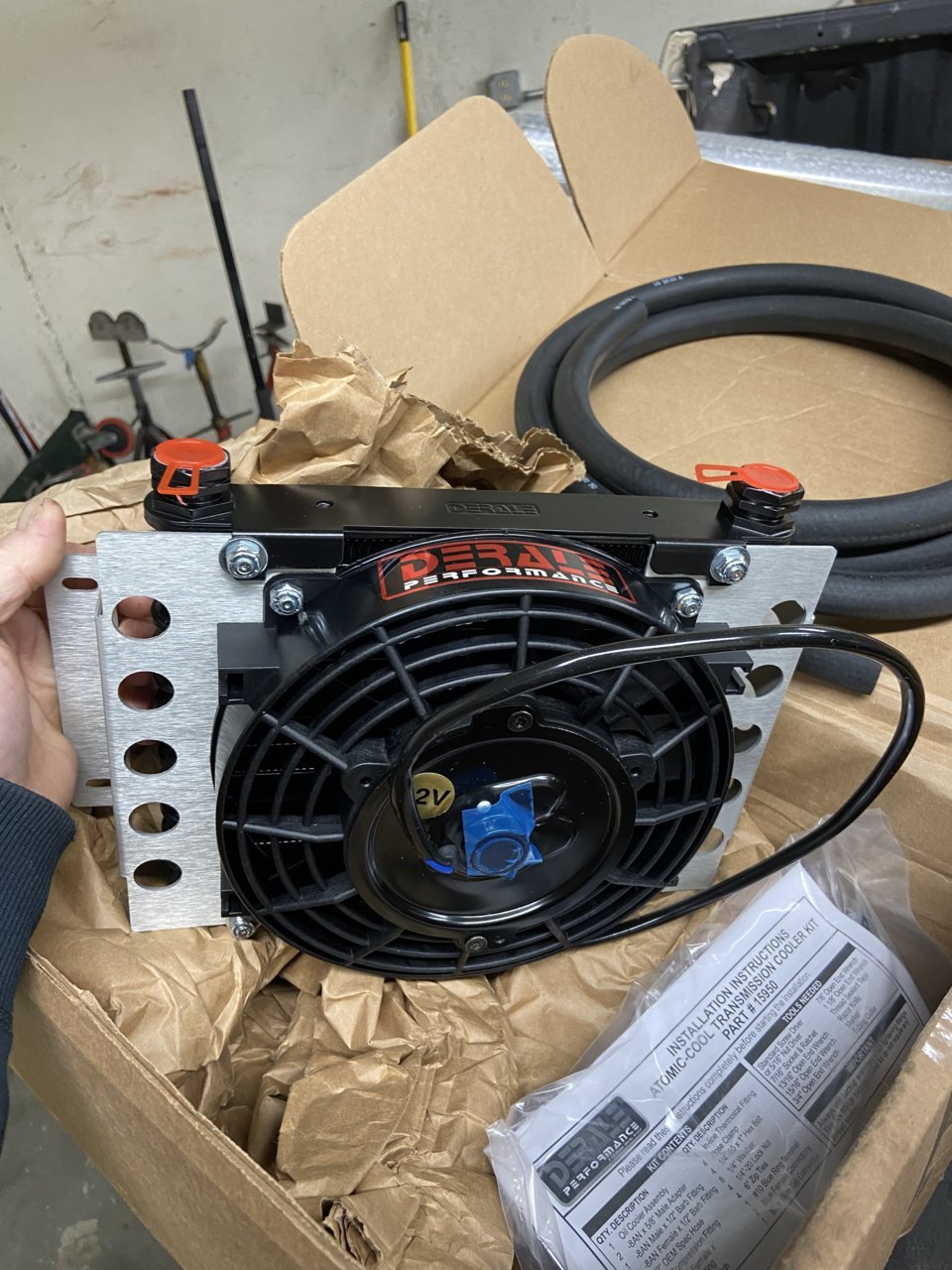

    Derale makes a good product.

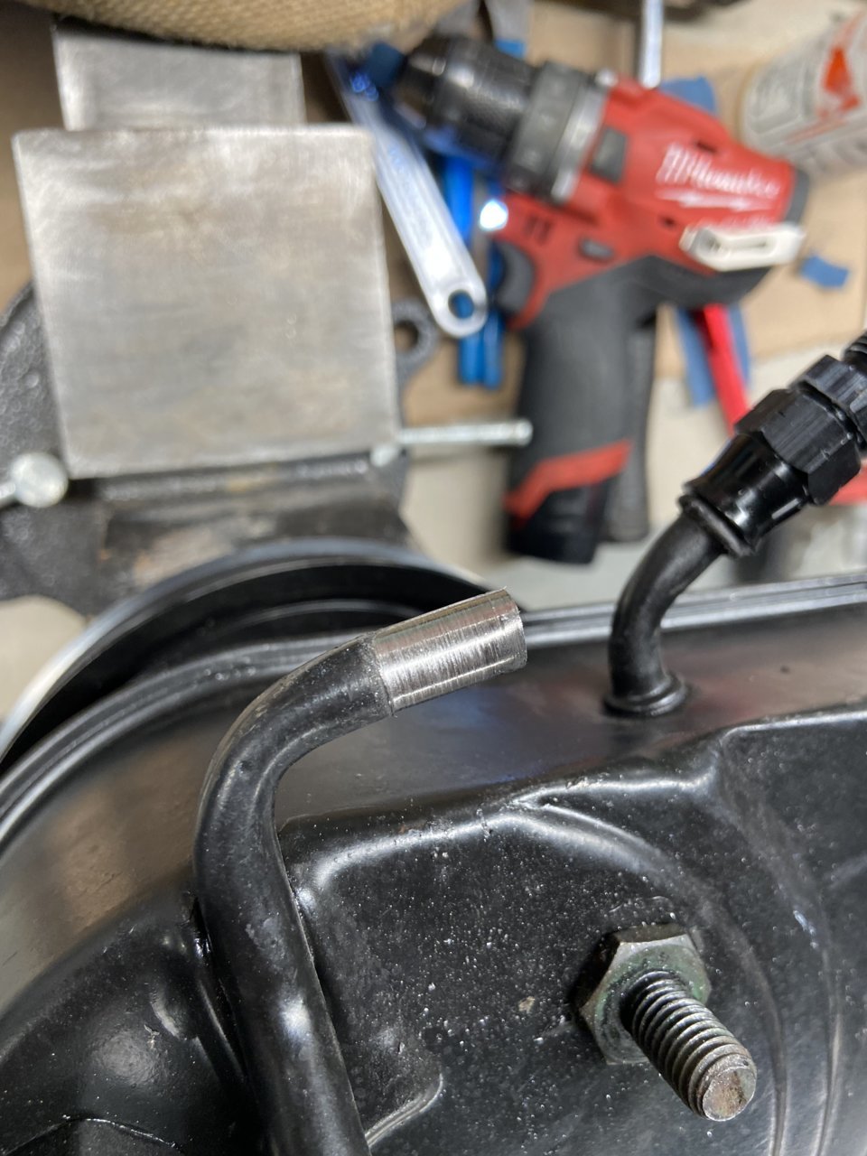

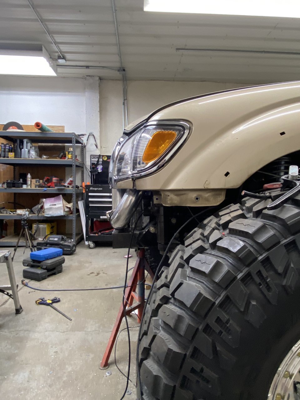

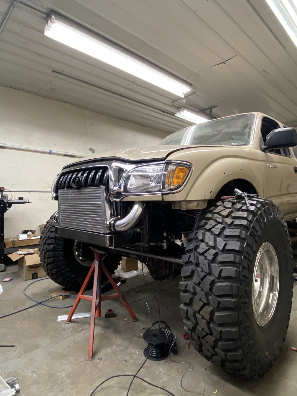

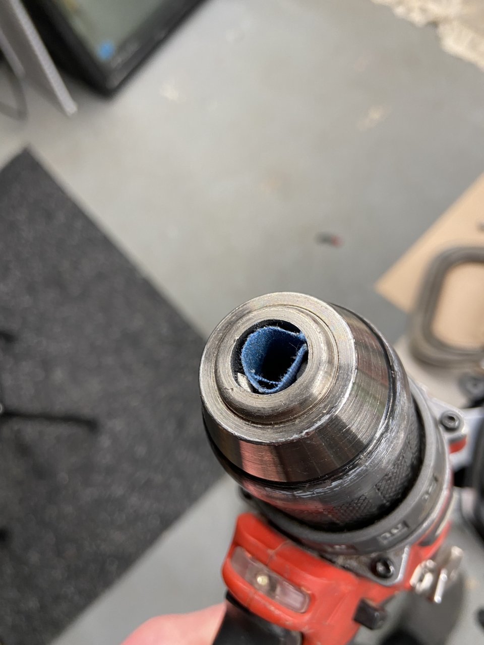

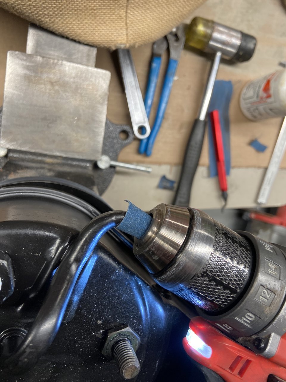

    Backyard trick of the day.

    Drop bracket lift and booger welds
    It took me way too long to realize that you didn't sand the one entire step off and that you shortened the one tube past the step. :anonymous:

    Lol. Yeah cut the one back so it would be far from manifold.

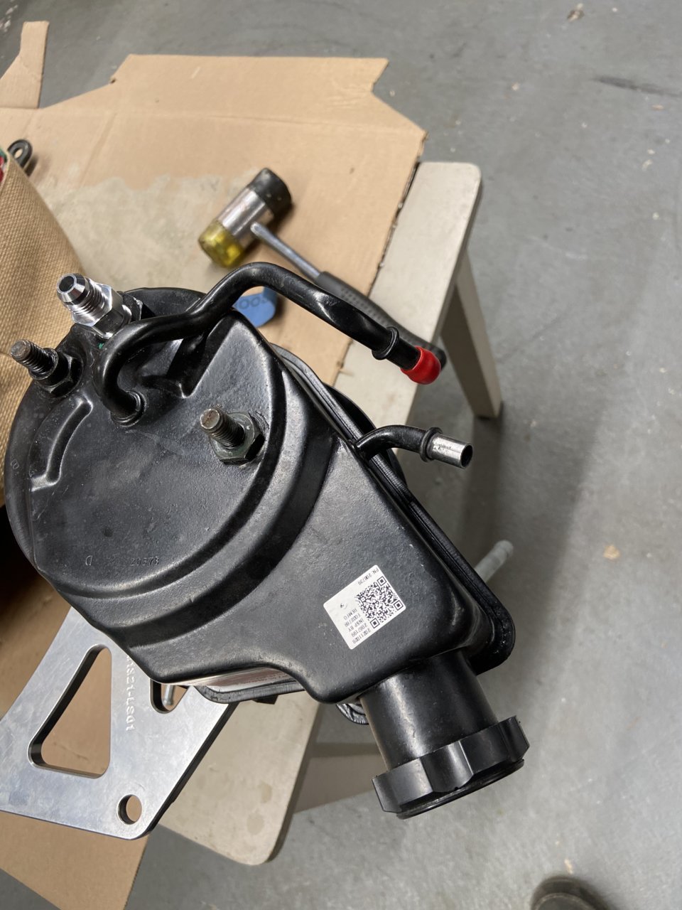

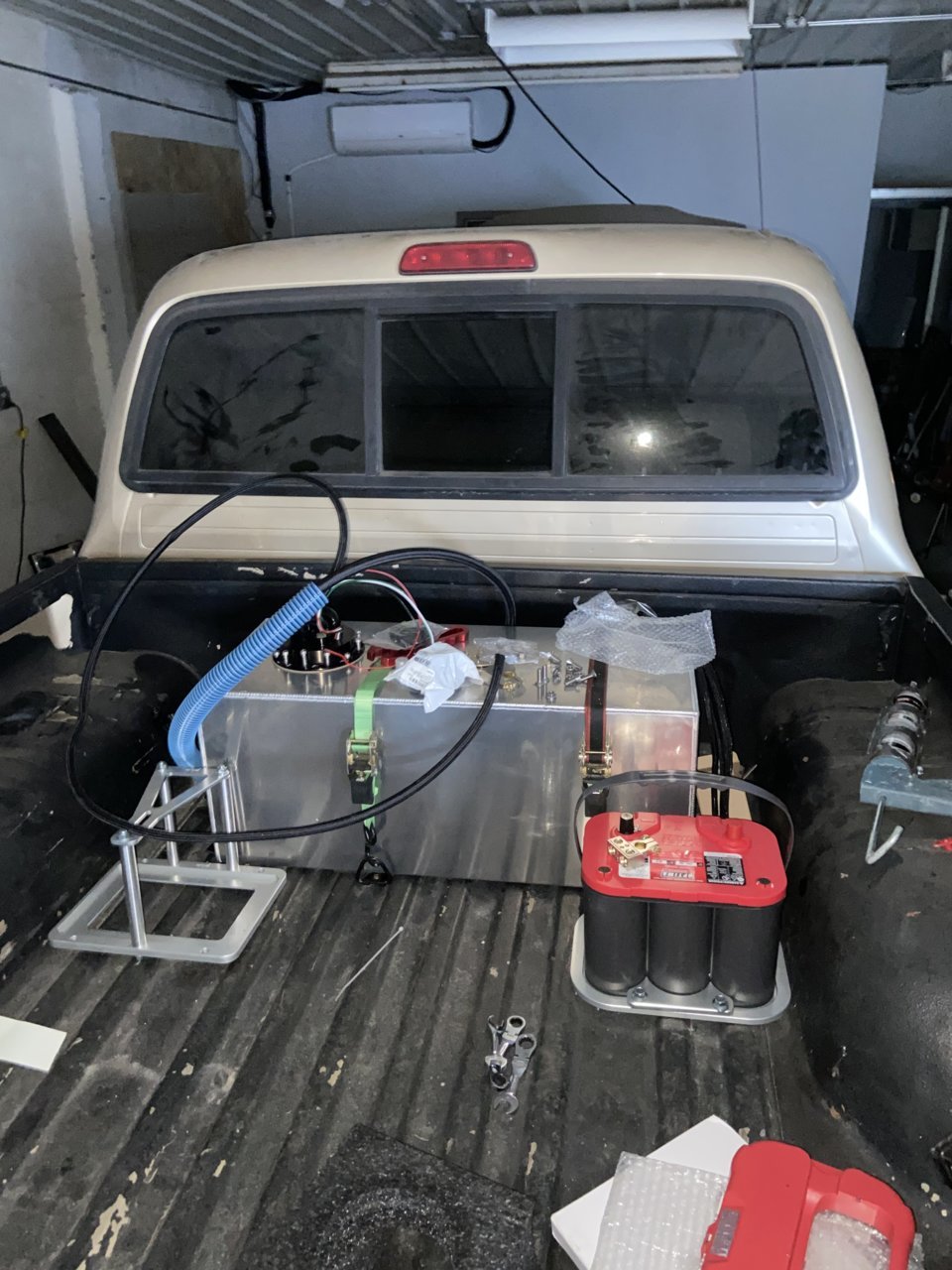

    Got a whopping 30 min shop time today thanks to a school holiday.
    D664A0A2-CFDB-49B6-9979-AF28D01D64ED.jpg 89EAB74A-A349-4BAF-8F76-9AAF8F4ACF09.jpg A67113FF-3ABB-4D3E-84D5-DBCC7CF075E0.jpg

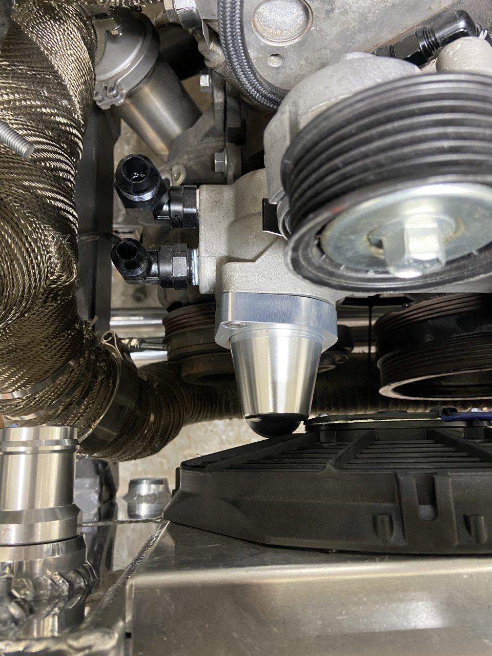

    Finally got this swivel thermostat housing
    Final battery location. A tire just clears. Had to go w a different battery tray from same company. Even nicer than the other.

    ooooh I like that optima hold down tray. No top strap. Slick

    Yeah it’s def cleaner than the other one. Not as easy to swap out but looks better. I got 2 of them but one came w out a second hold down so have to get another one. Sucks.

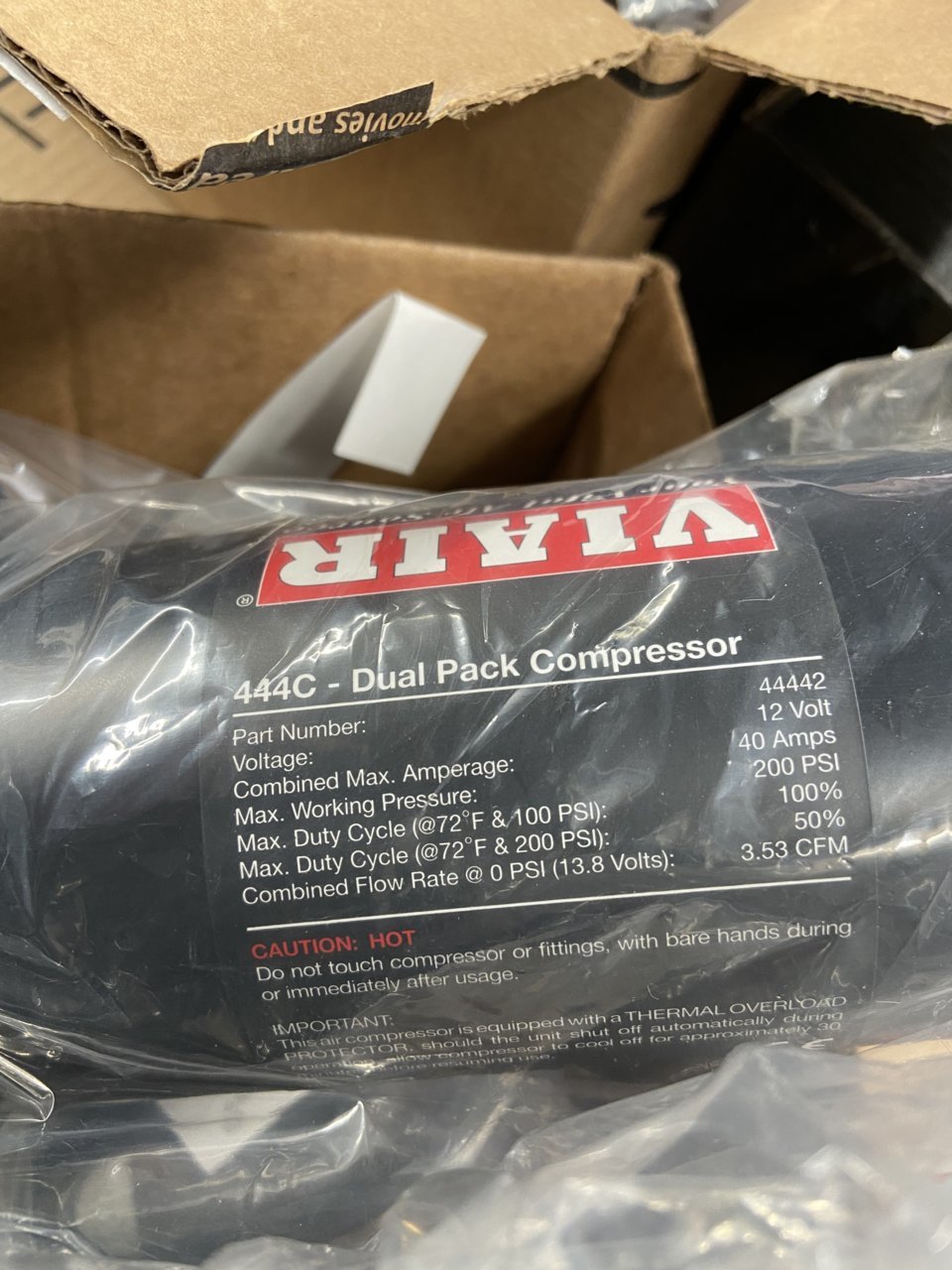

    Yeah, have the whole kit. dual batt, dual compressors, charger, monitor, etc. Gonna mount the charging setup but prob wont wire it for a month or so. Getting truck running is first priority at this point.

    Oh yea forgot about those compressors. Them some big bois. Gonna draw a buncha amps with those.

    Yeah, they run 40 amps as a pair. My alternator is 145 amp so should be good. They will only cycle hard with air up of tires. Will have a 2 gallon tank to help out.

    Ya that checks out. My ARB dual pulls 28 and does 6 cfm. What's the combined air output on those?

    Not as good as arb but they were kinda cheap. I think $297. $339 plus tax on Amazon actually.

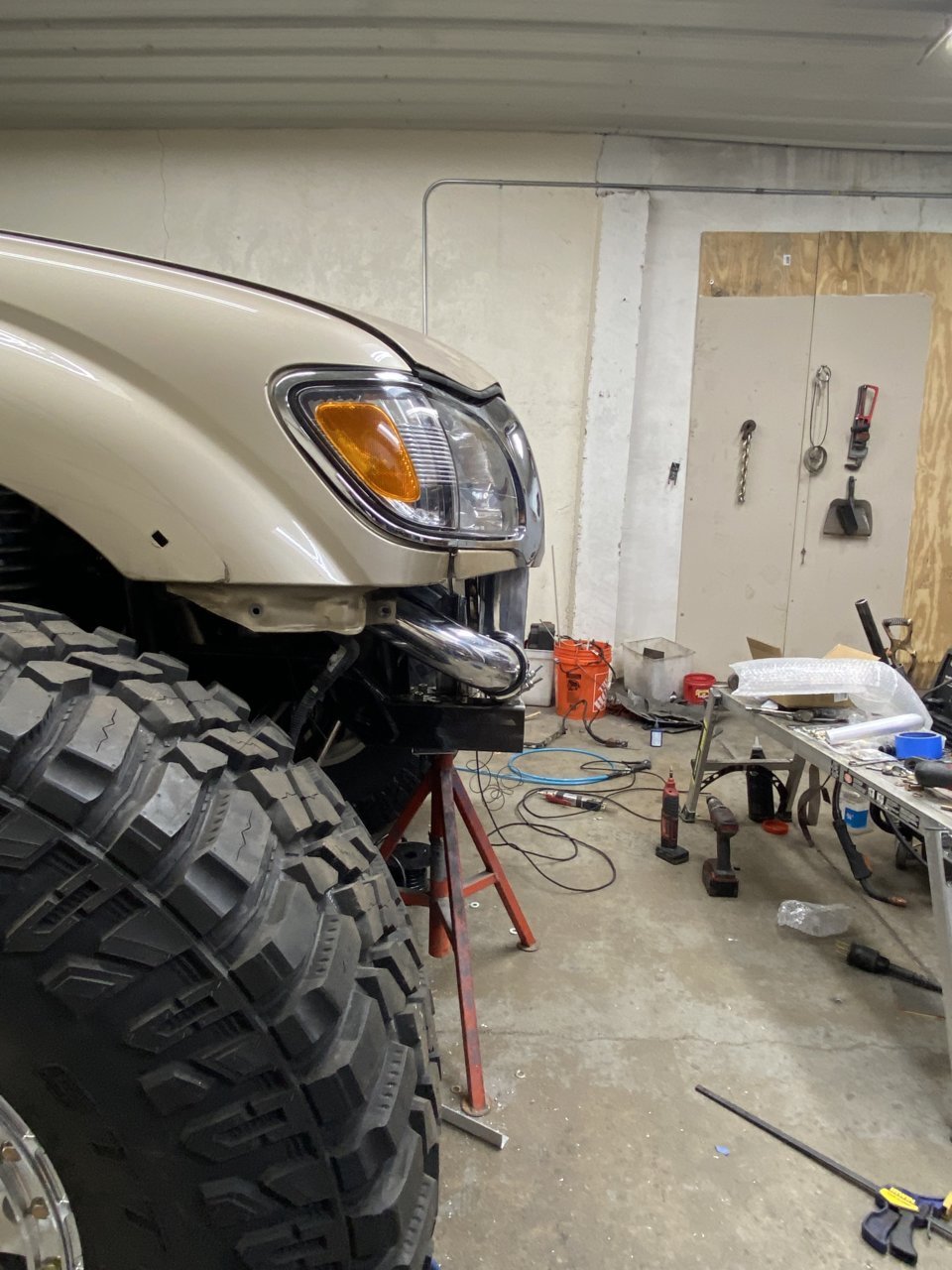

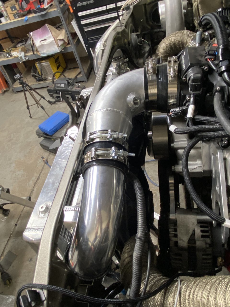

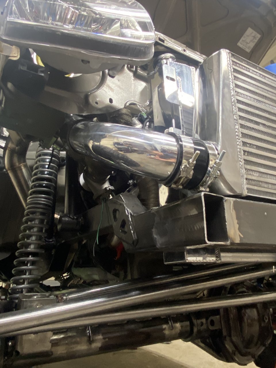

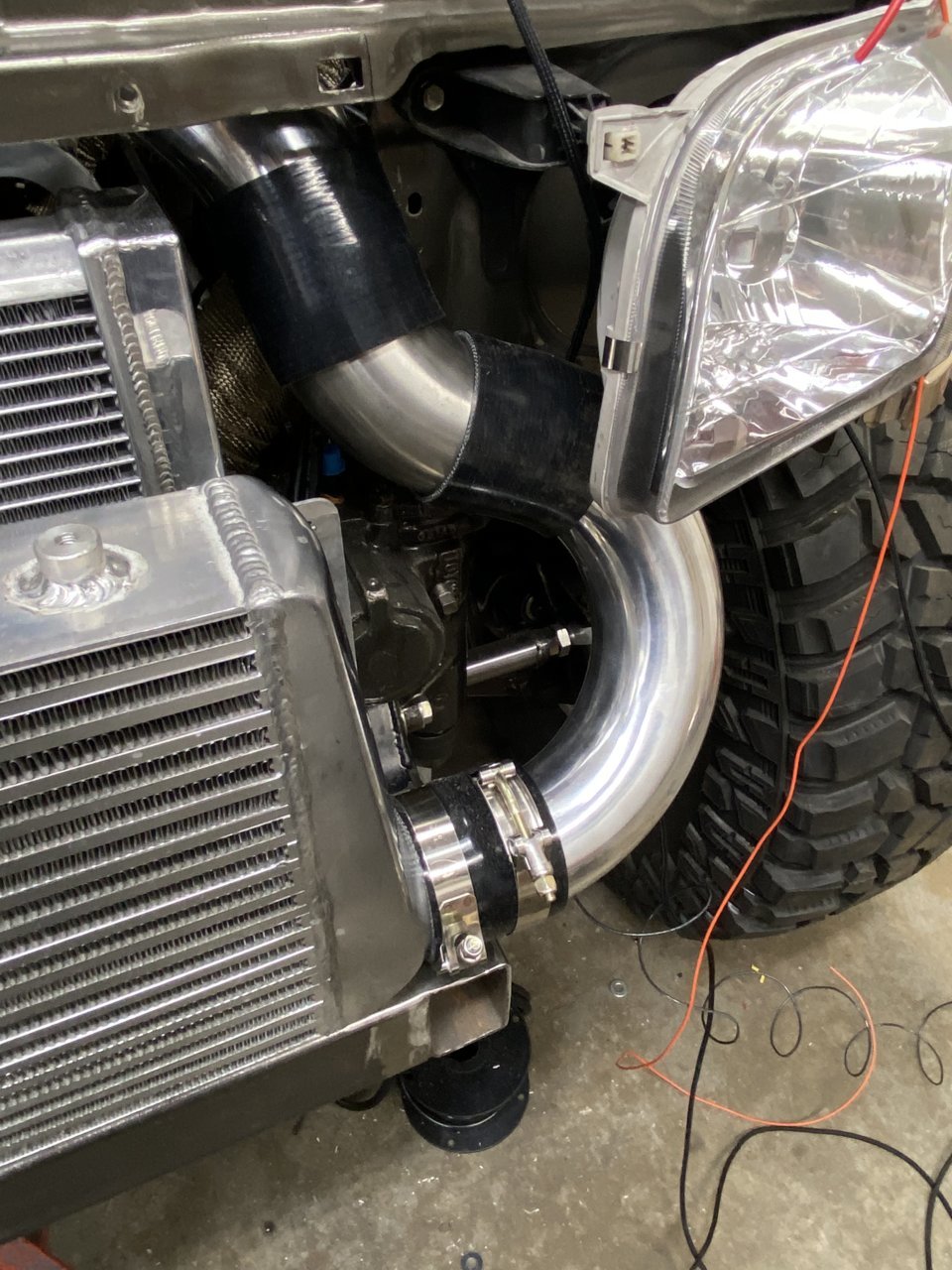

    Intercooler piping is usable. Have to make a few welds but the bands will work for now. Everything fit ok. 10x easier than the exhaust.
