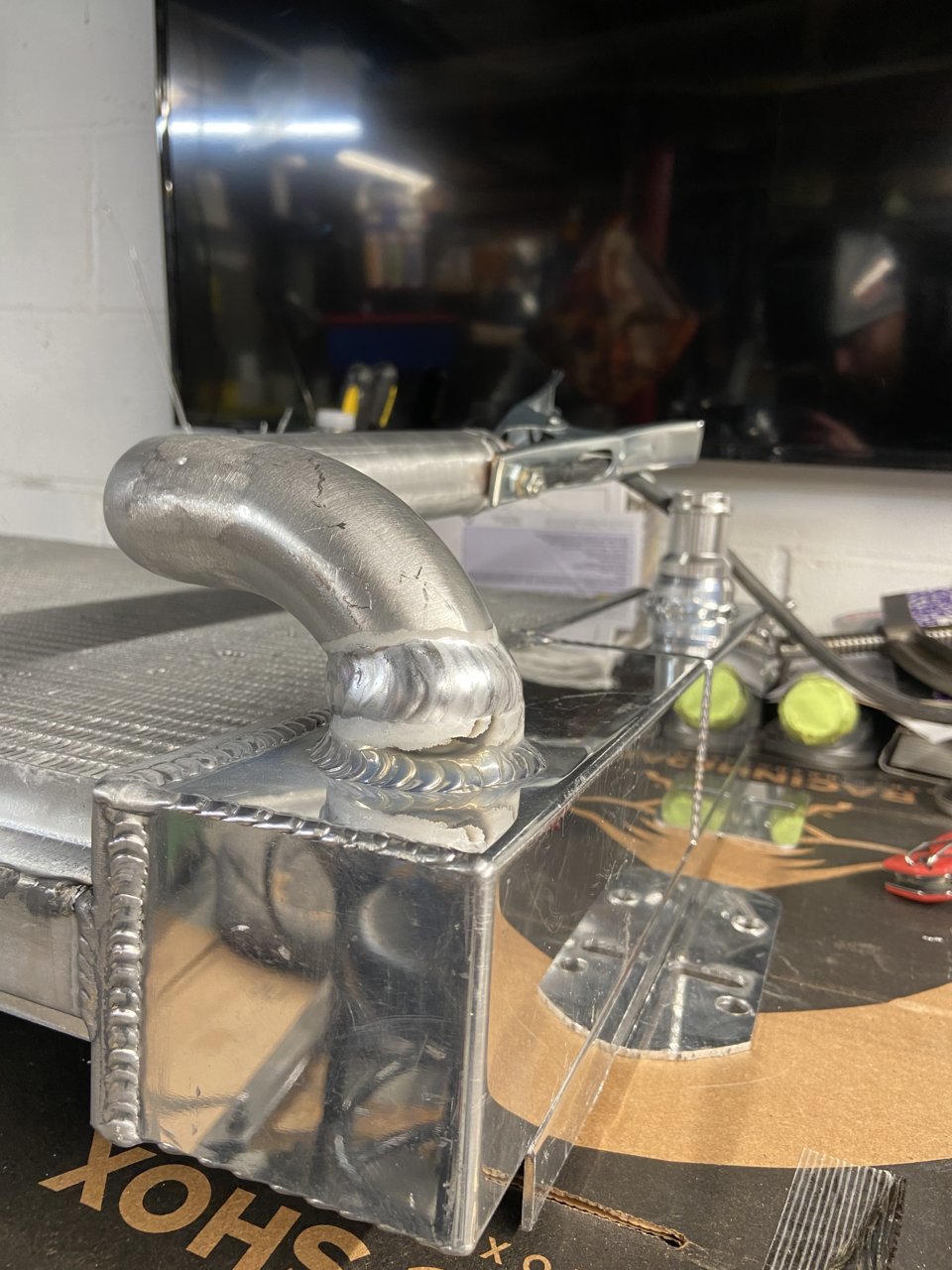

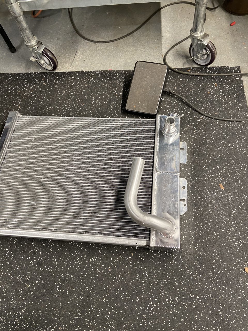

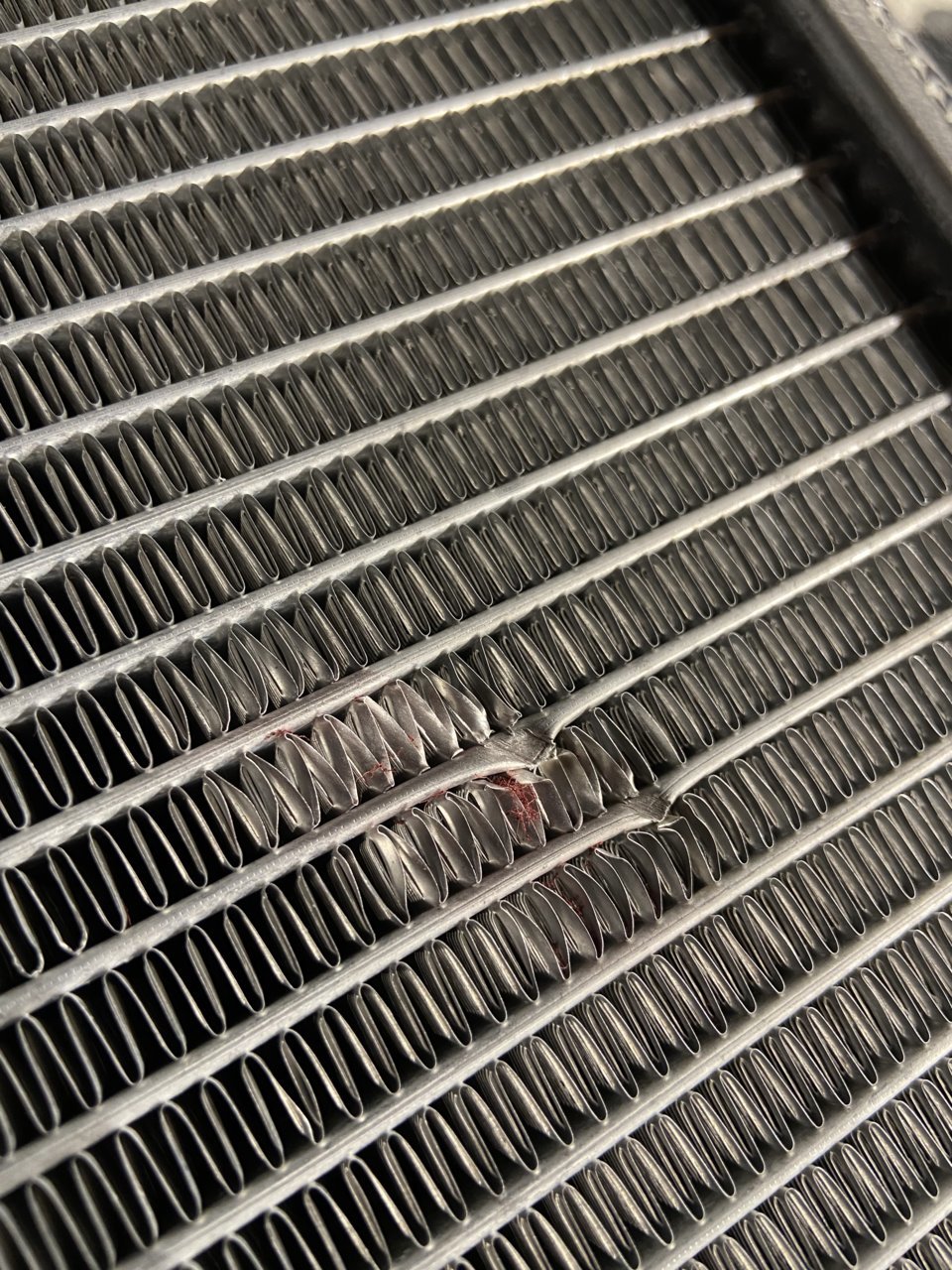

    Things were going ok. Nothing too bad. Had to weld this stupid tube on a big ass port. Finished the job. Feathered it smooth w a weave. 59AFFEBC-BB9E-4E41-8078-387E5B5129B5.jpg BC04E1B3-3155-4B31-A124-0F2705CB38C9.jpg
    Then disaster struck while smoothing scuffs w a buff pad on grinder.. $700 radiator. Now I gotta watch radiator repair videos for the next 2 hours and will prob resort to fucking jb weld. Fuck my life.

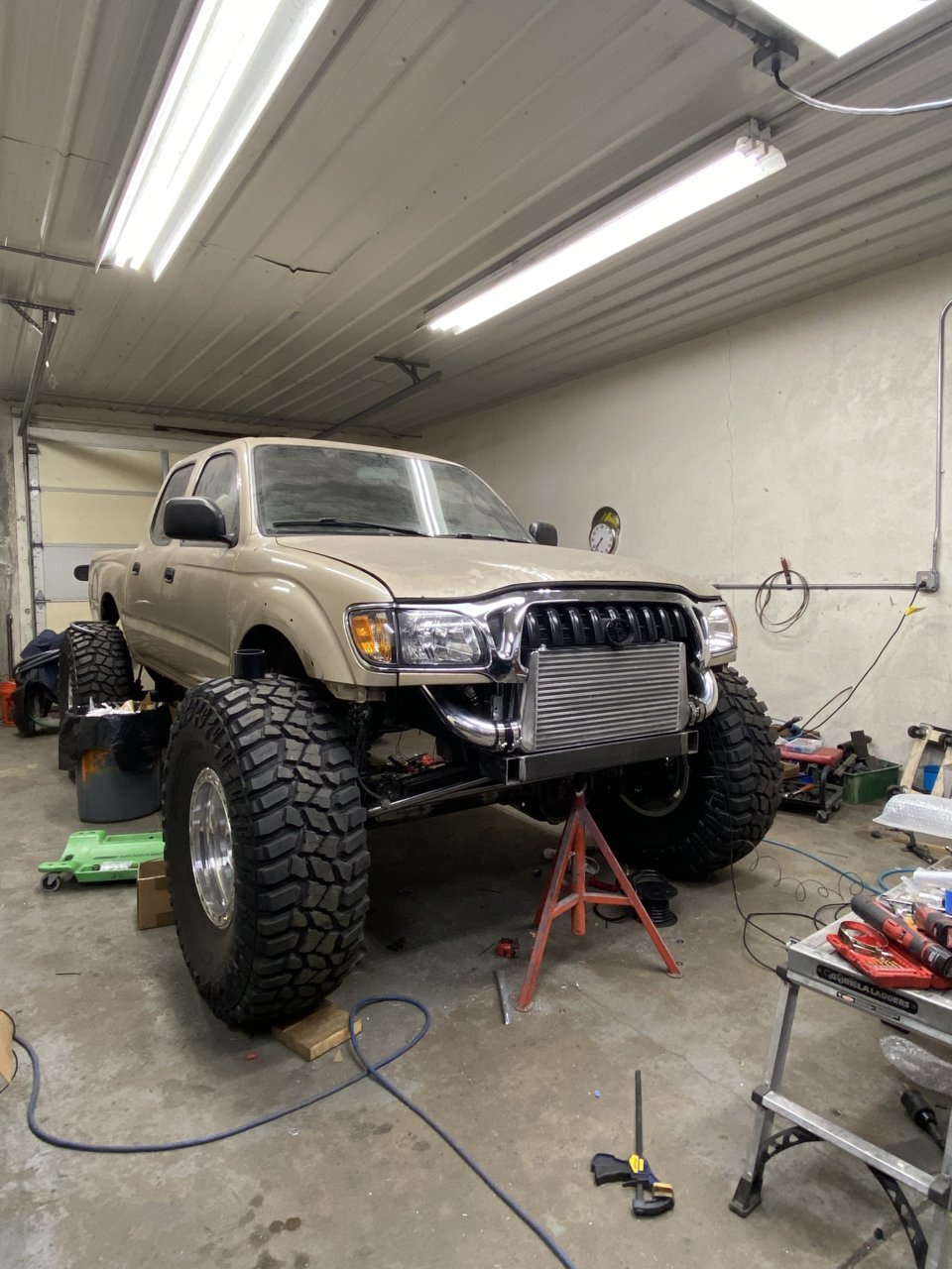

    That front grill gives me fj80 vibes at a quick glance.
    Sometimes it seems like you can accomplish more during the 30min shop time days than the 26hr thrash fests.

    That radiator has been through more he’ll than a 20 yr old one. It was only a matter of time before I fucked it.
    Oh, and thanks. That's a compliment for sure. Trying to keep the front as flat as I can. The winch will stick out a little but hopefully keeps that LC flat face look.

    This pic screams beast.
    Like a warthog about to ram you.

    Lol, wart hog is a funny name. This one still doesn't have a name. Been calling it Daisy but it doesn't like that name. Waiting for it to tell me what it wants to be called.
    Gotta do all the frame plating and reinforcing for the bumper like asap cause that 1/8" tube ain't ramming shit right now.
    This one has def tested every bit of my spirit. Getting the "its almost done" boost of motivation lately helps a lot.

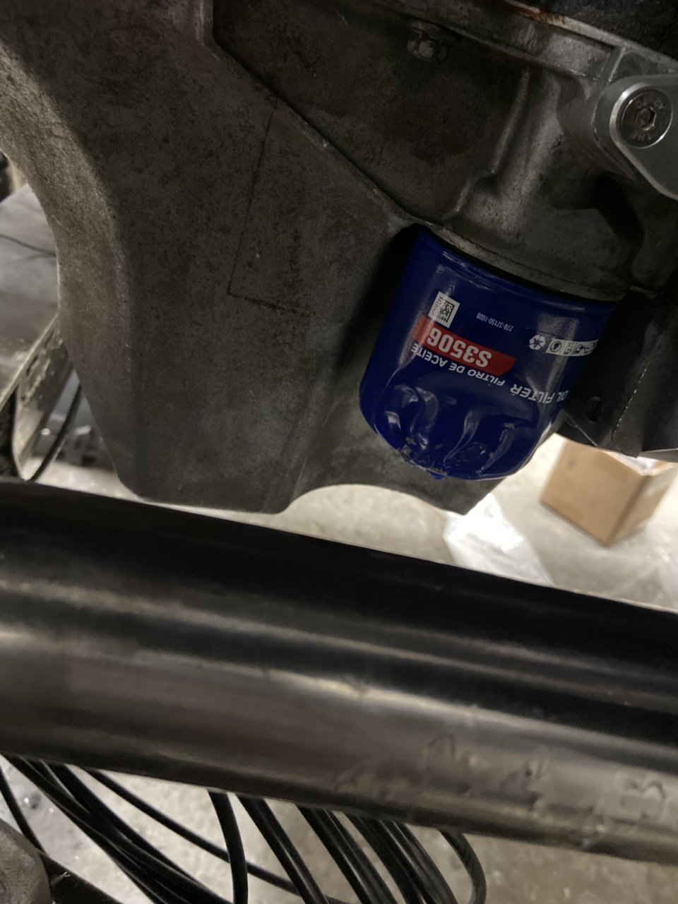

    Me after I pull the steering link bolt out, then the tie rod link bolt and I don’t realize that’s two strikes. Then of course I pull the Panhard bolt out.
    If you want to know what happens imagine a tower slowly falling over to the ground.
    glad the $600 coilovers and oil filter stopped it. :rofl::rofl::rofl::rofl:

    i was on the spectator side of truck so I guess. Took 2 hours to get it back to normal.
    Idk if you have had this happen but you cannot move the axle until you take pressure off the upper link. Took me an hr to figure out that. Soon as I jacked up on diff the axle could be ratchet strapped over. Sucked.

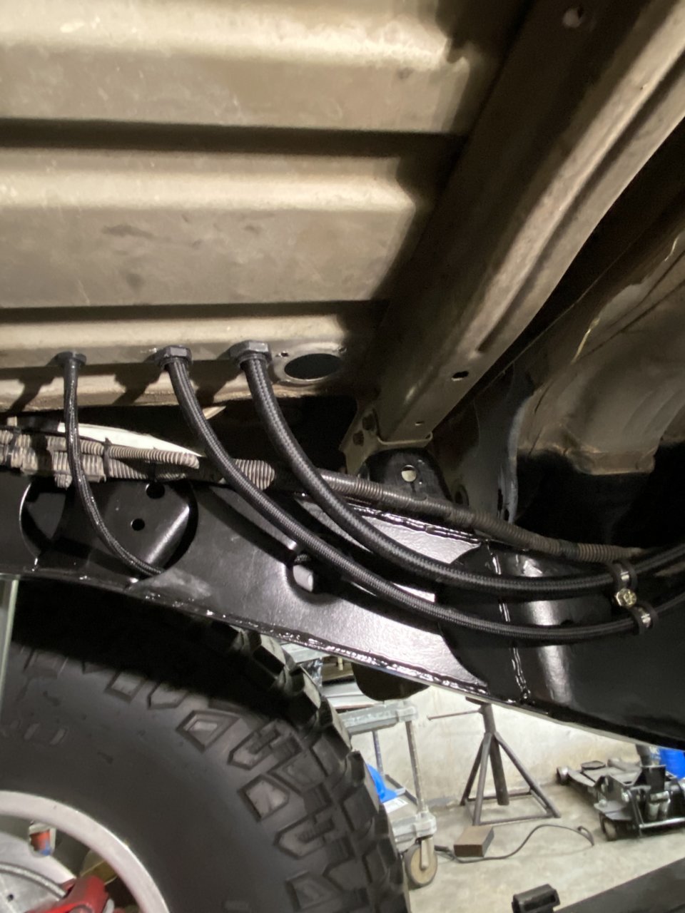

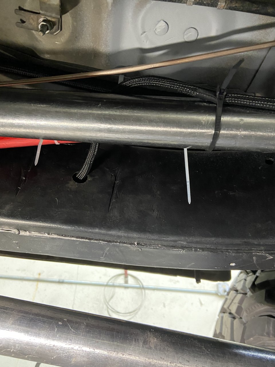

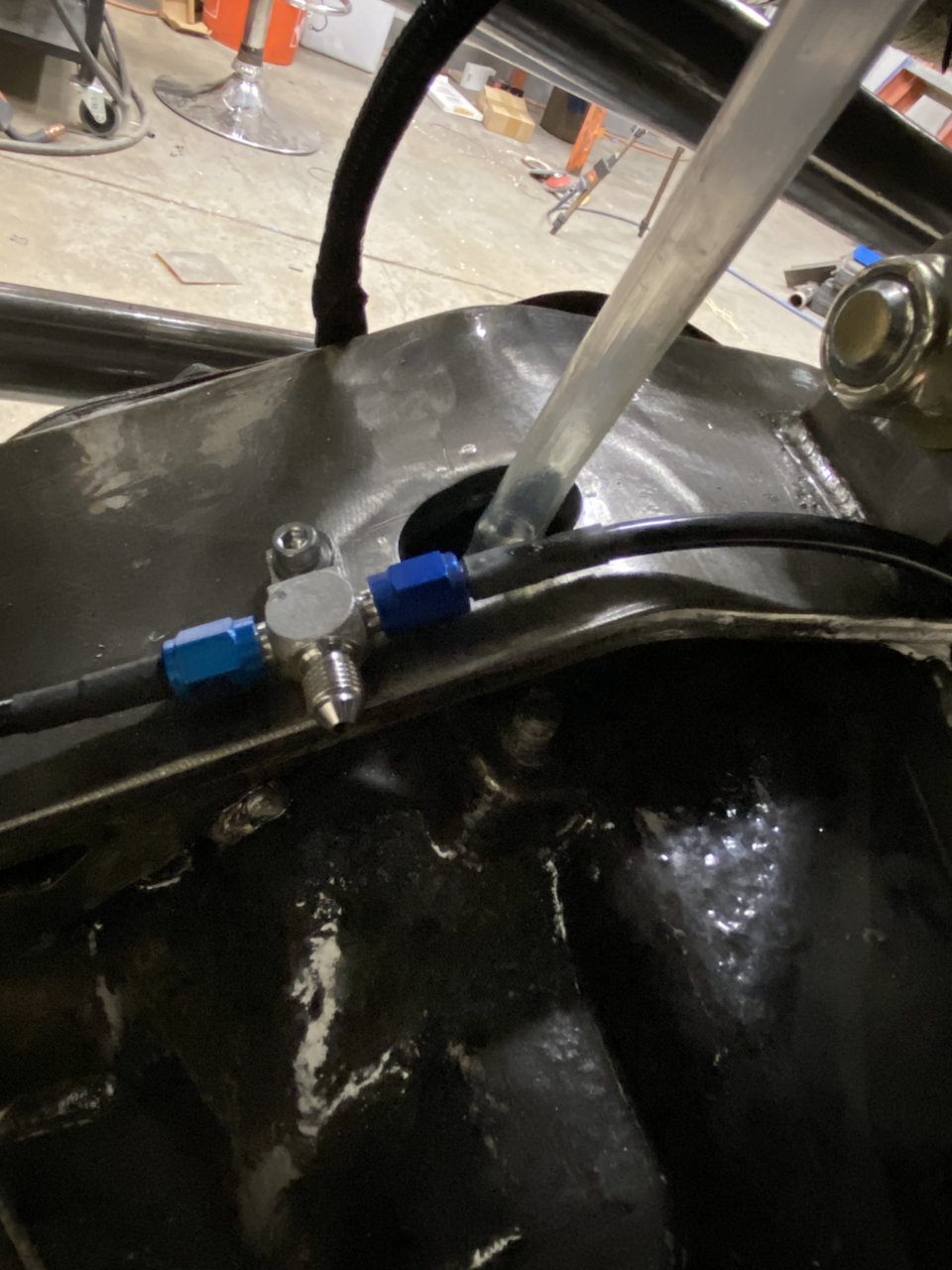

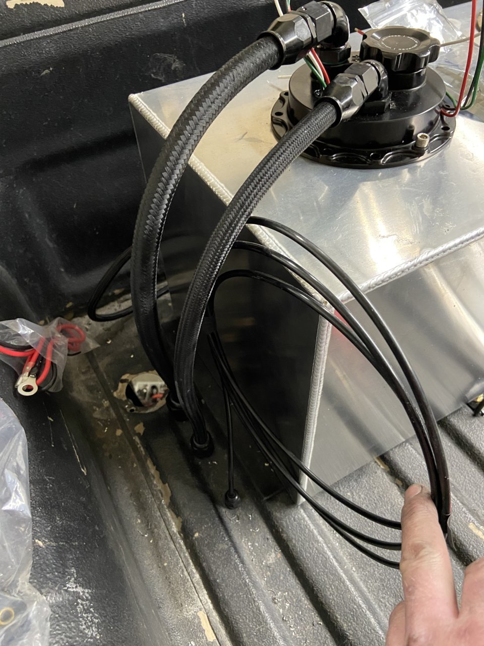

    Decided to redo the fuel pass thru’s and run air line in frame w that nice sleeving. Fuel official 100% done.
    15AAC225-4F89-4847-A134-B90F9AA339B8.jpg 92391BE4-D0FC-43F6-8A0F-29E15BFF4734.jpg EC33F558-672D-4433-ACAC-3A1B4D93FFBB.jpg 83DFF068-FA61-4D1B-A7C5-DFA543244B41.jpg

  14. Jan 19, 2023 at 5:11 PM
    #1394
    02hilux
    02hilux What do you mean there’s no road, I’m here
    Sep 14, 2016
    #197244
    6,293
    Planet: EARTH
    Nice tucked
    sparkystaco and Yota X[OP] like this.
  15. Jan 19, 2023 at 5:55 PM
    #1395
    Yota X
    Yota X [OP] Some say dresser, I say dryer.
    Jul 11, 2019
    #298961
    5,268
    NW New Jersey
    1st gen
    ls turbo, tons, 40's and a partidge in a pear tree
    Yeah, its safe, fully loomed and out of the way w lots of slack inside frame. I was gonna run it in cab but this way seemed more logical. Now I just have to figure out where to put brake lines.

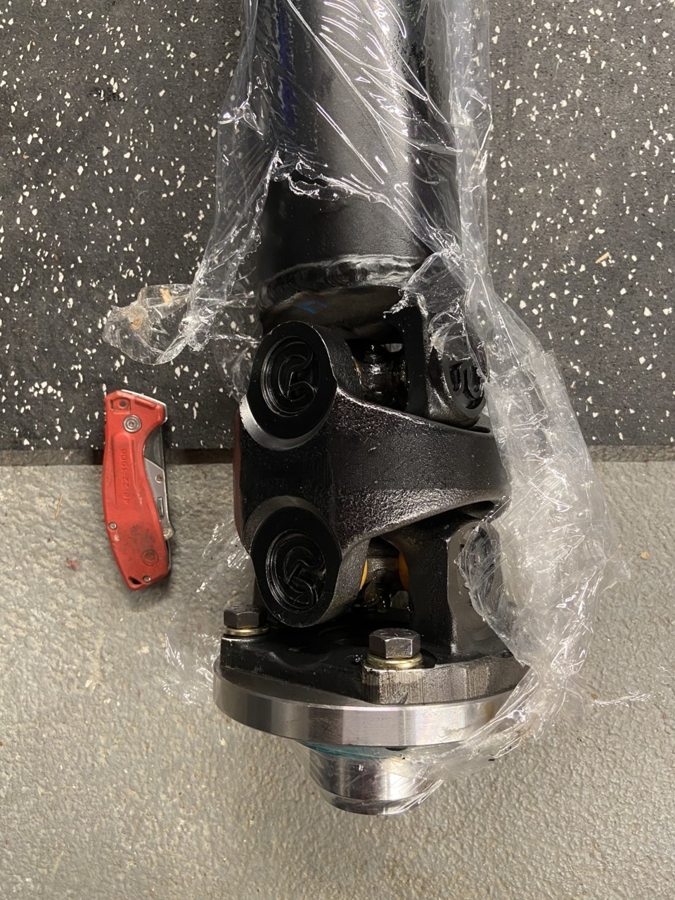

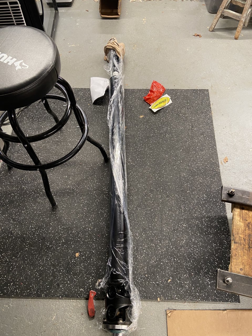

    This thing is beast.
    F5CC60EF-2A4D-405B-9006-A166A26D12E8.jpg A8502427-0A8A-44EF-948D-C2CD84E245F1.jpg
    …and this has to be the best sticker ever! Kinda sand lot-esque. Wish she came w the shaft. Lol

    Was it built with a thicker wall?
    Yota X[QUOTED][OP] likes this.
  18. Jan 20, 2023 at 6:31 PM
    #1398
    Yota X
    Jul 11, 2019
    #298961
    5,268
    NW New Jersey
    1st gen
    I told them my setup and what I planned to do w the truck and they decided what to make. It’s a 1410 cv flange at case, 1410 strap at rear and a 3.5” tube at .83 wall thickness I believe. They said if I want to drive it on the rd don’t go thicker.
    if it’s super smooth and I like it I’ll prob get a thicker one for special trips/backup.

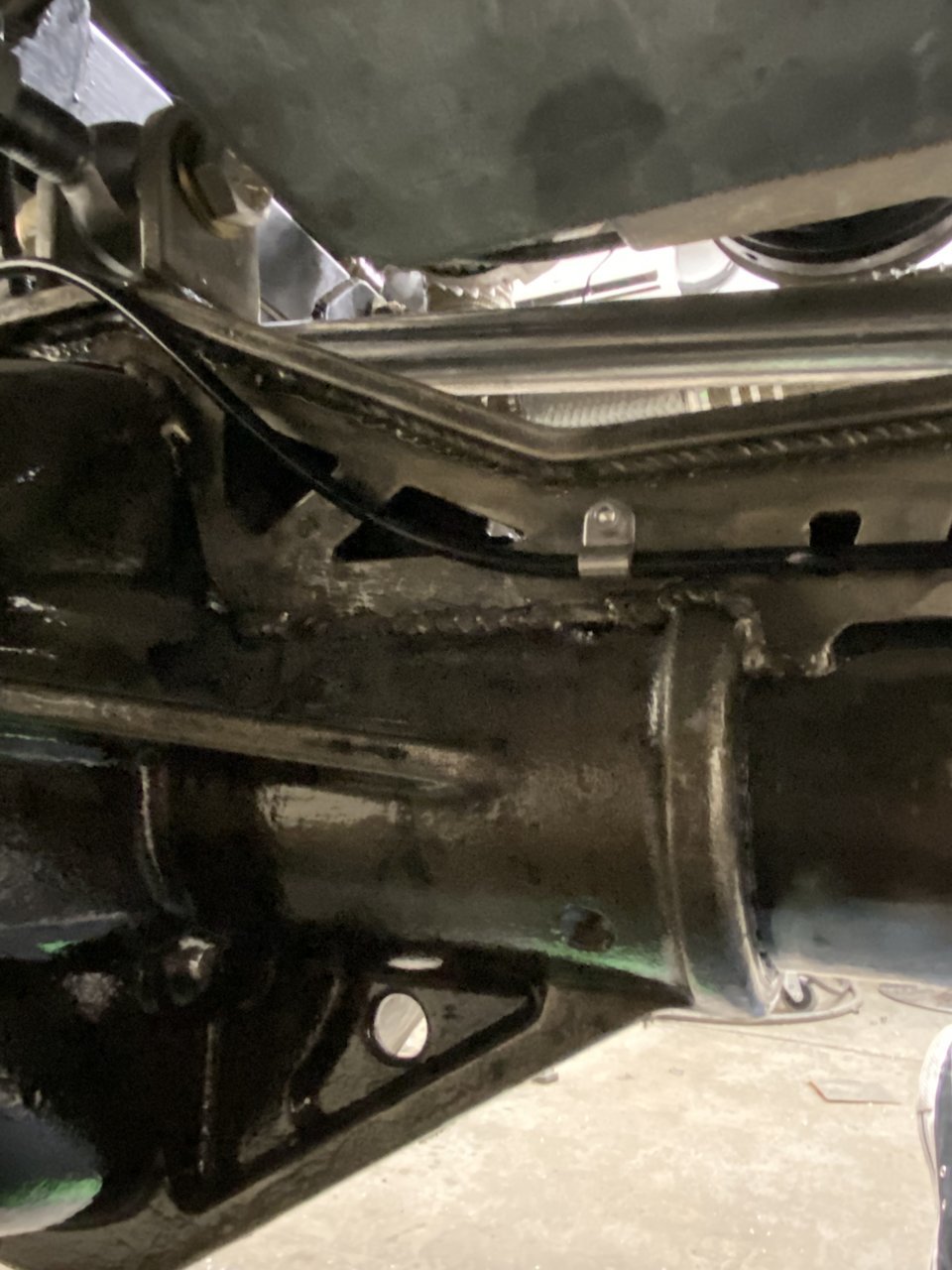

    Brake lines all mounted to axle. 23125720-92BA-45FF-8CD7-408015A648AD.jpg 9C3545B4-CA9F-4AE9-B148-14DE00344F5D.jpg

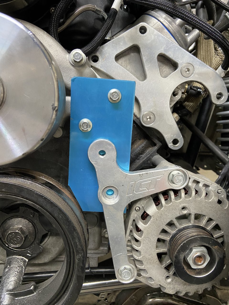

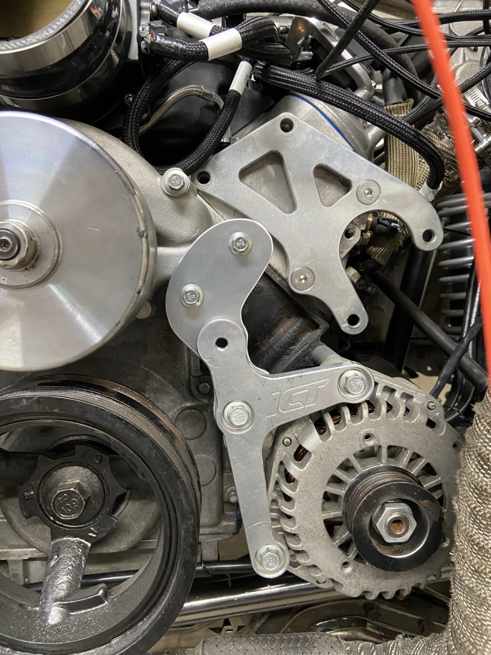

    Had to make a little bracket for the alternator
    2CF6F07E-9C00-4B56-A971-1BCC3100C491.jpg 128D79E8-0C4B-4FFF-A133-6BC957C5BCE2.jpg 2833325F-7B90-4101-85D9-4618E382A02F.jpg
