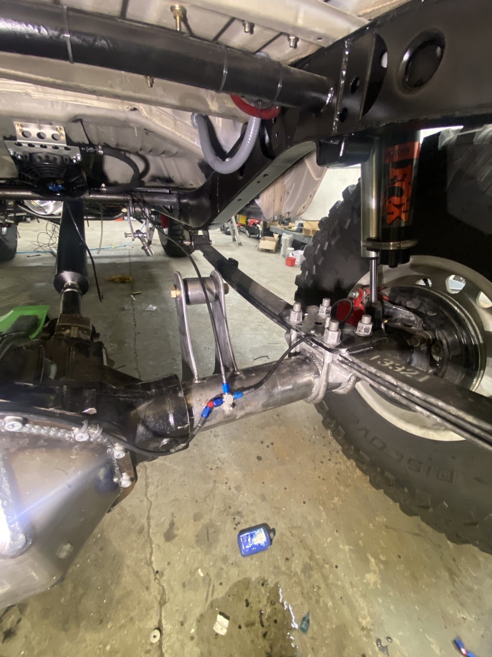

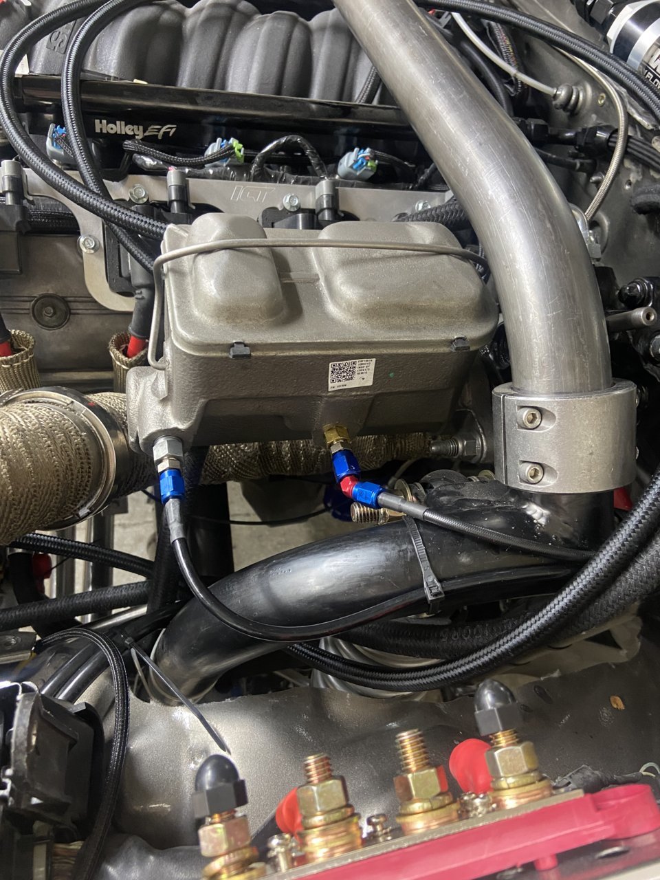

    Spent all day running back and forth to speed shop fitting brake lines. Had to settle for 2 ridiculous red/blue 45’s but should have brakes at least. I abandoned rivnuts for packs of zip ties for times sake.

    Gotta get a 45 for one of the high pressure lines then I am gonna start motor. Been fixing fuel rail leaks. Whole shop is like a fume bomb.

    That sucks. All my brake stuff is new so I hope it doesn't act up. I ended up using 2an lines with 3an fittings on the whole brake system so we'll see how it works out. So far the truck seems like it is happy with everything. All the interior shit works, it cranks, has oil pressure. Getting belt tomorrow so, im prob gonna do a test start and see how the motor behaves. I always prepare for the worst, so, barring a knock ill be happy.

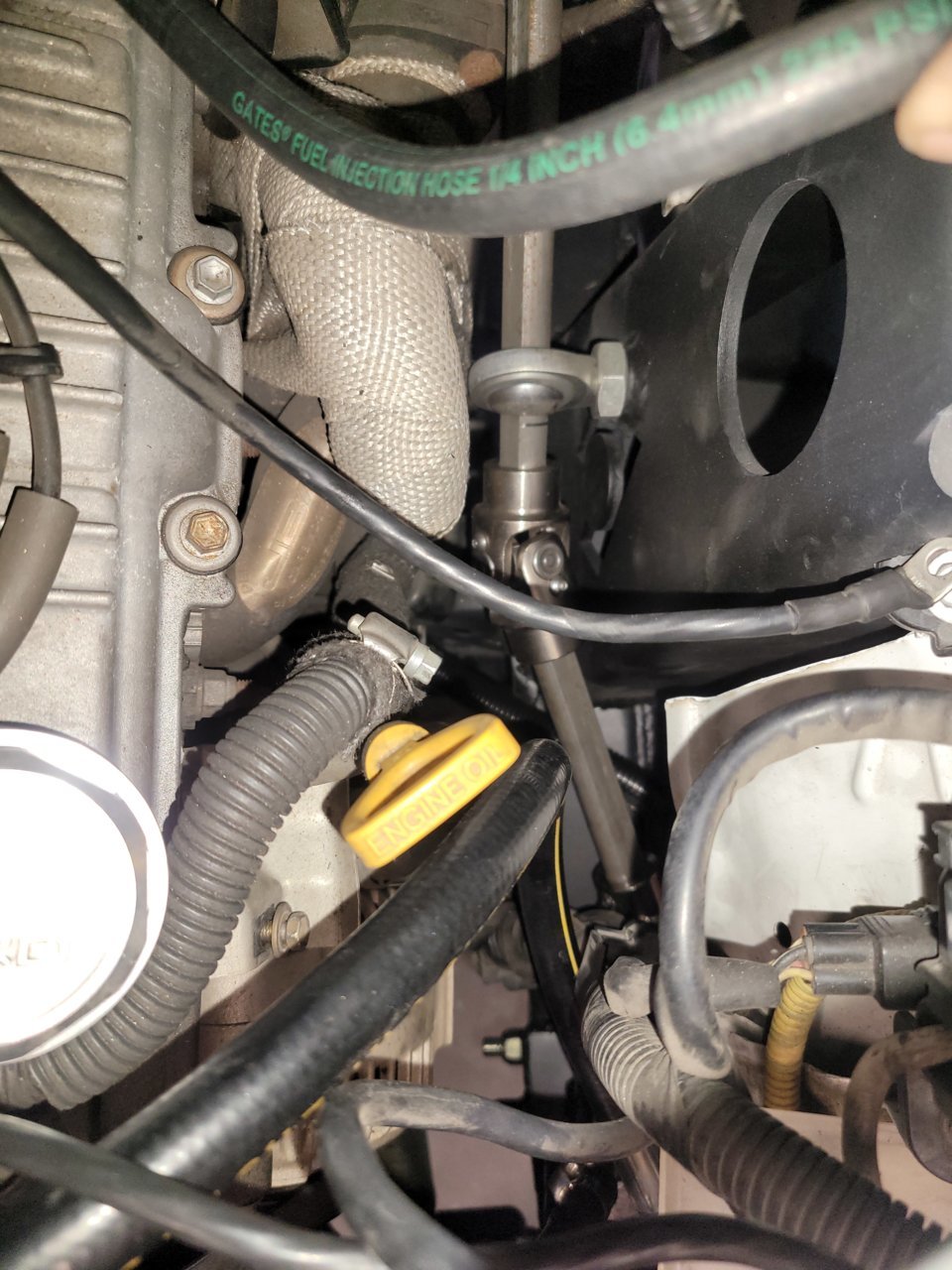

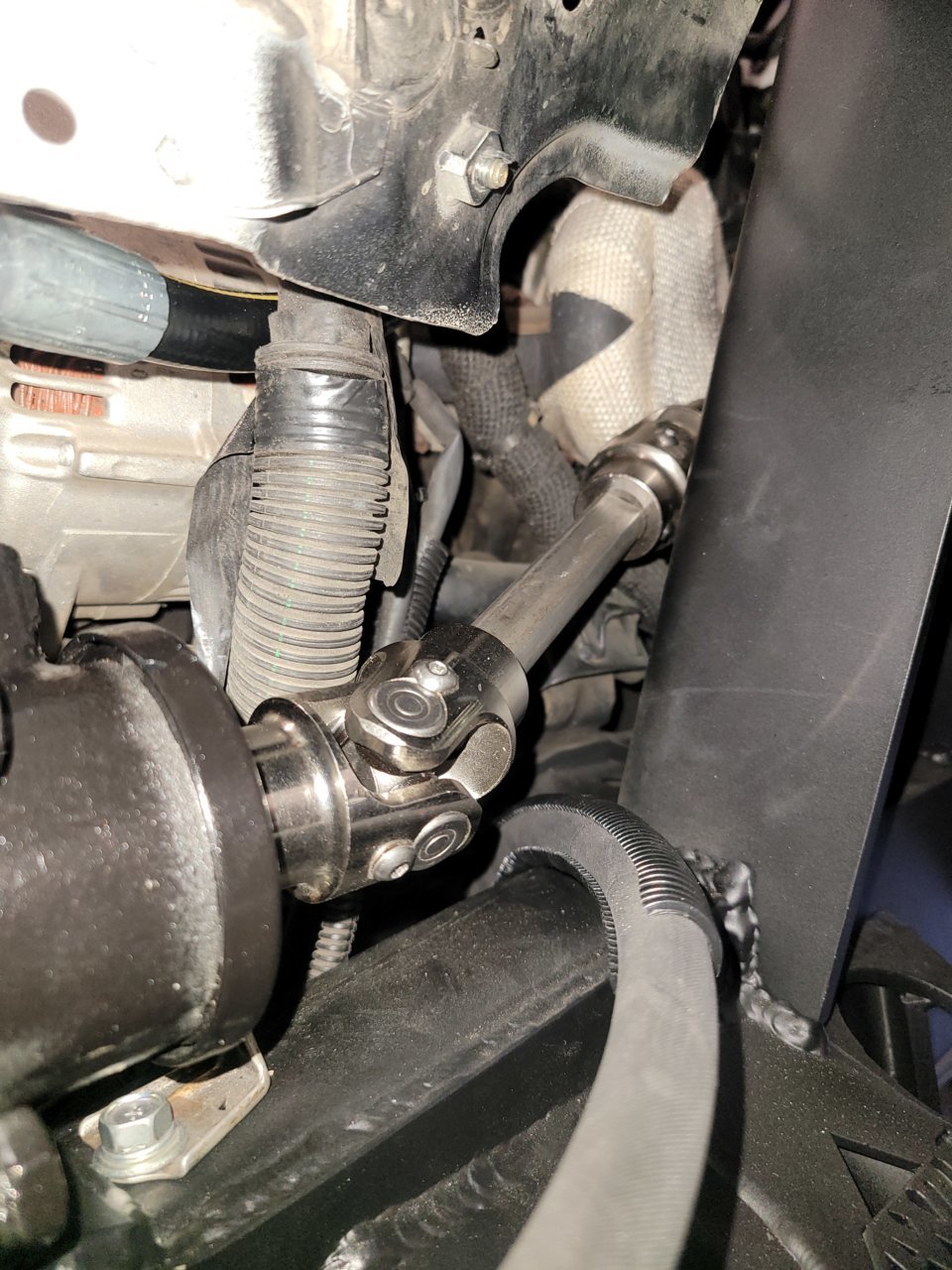

    Not yet, lol. Supposely 1 month project turned into several months later, haha. The towers are cut off, prepped, and frame cleaned tho. Setting up steering shaft tomorrow I hope and will mock towers. Hopefully it'll be back on its weight by next week or so.
  14. Jan 26, 2023 at 6:32 PM
    #1434
    Yota X
    Yota X [OP] Some say dresser, I say dryer.
    Jul 11, 2019
    #298961
    5,268
    NW New Jersey
    1st gen
    ls turbo, tons, 40's and a partidge in a pear tree
    Why are you messing with the steering? Hitting the new tower?
    sparkystaco and Taco critter like this.
  15. Jan 26, 2023 at 6:40 PM
    #1435
    02hilux
    02hilux What do you mean there’s no road, I’m here
    Sep 14, 2016
    #197244
    6,293
    Planet: EARTH
    Originally fab it with a 2 piece steering shaft with a 3/4" heim attached to the tower for support so it can wrap the tower.
    Ordered a Borgeson 1 piece (3/4" to 1" D) shaft and will re-do. Keeping it a 1 piece now and will built the tower around it.
