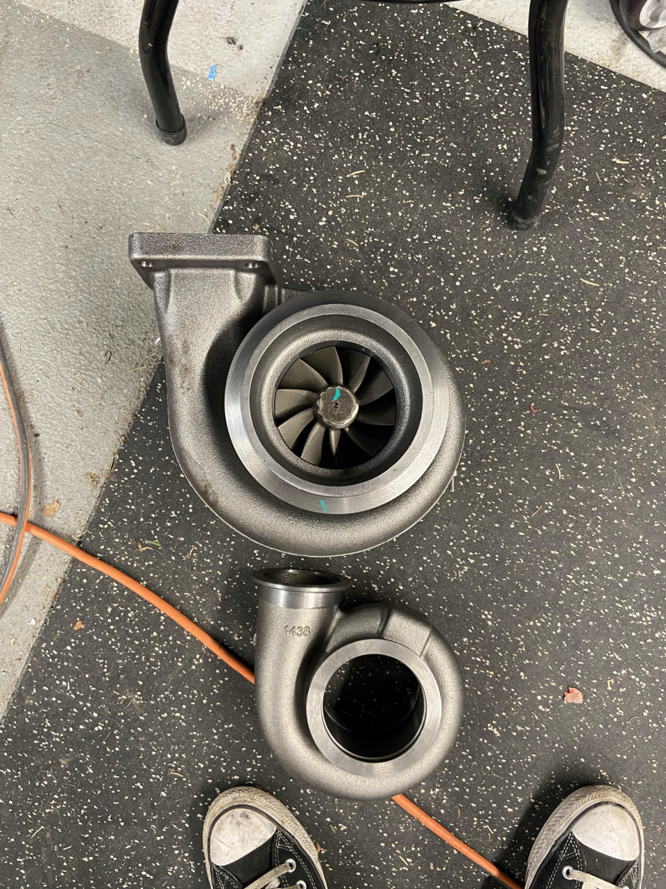

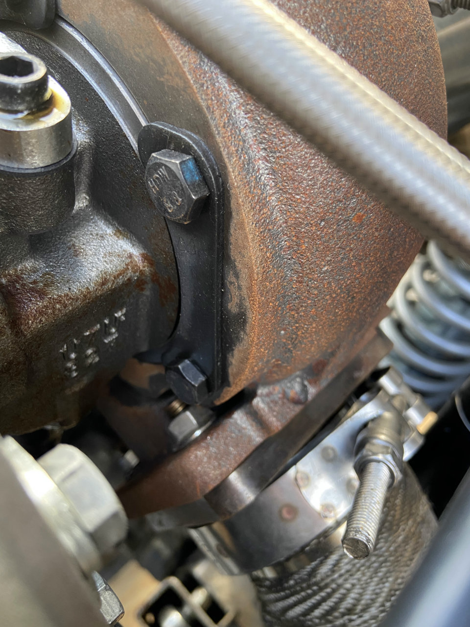

    -Got new turbine housing and it is questionably small. Found a really good turbo guy in Al of all places @workturbo and he is sending me a ceramic coated housing w v band inlet so I can fit the big turbo.
    -GT45 ebay special is cooked. Think the ex side journal bearing is toast (may be from lack of oil priming at start up on my part). makes boost but burns oil.

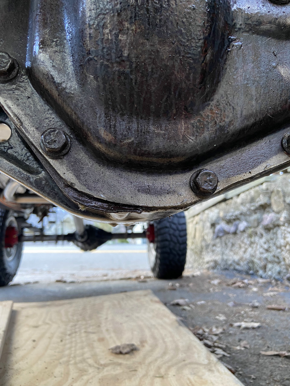

    -Front diff gasket leaks.

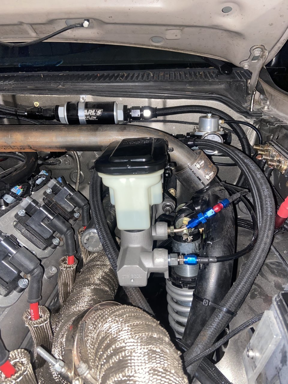

    Actually figured out today that the trans issue was a combination of low fluid due to the aftermarket dipstick I assume being off. Added a quart and helped the reverse vibration a lot. Had my step bro video the under carriage and the rear axle is flexing a lot and the suspension sags so the antiwrap bar should fix all that thank god. Didn't feel like pulling the trans.
    Gonna deal with diff leak next week. It seems like it is actually chillin so it should be fine till first oil swap. Ill try silicone vs the paper bullshit gasket.
    Got my upper link back from powder coat spot so can use the old one for anti wrap. Prob do that tomorrow.
    Timing is def a huge issue. I added some today and it made a huge difference.

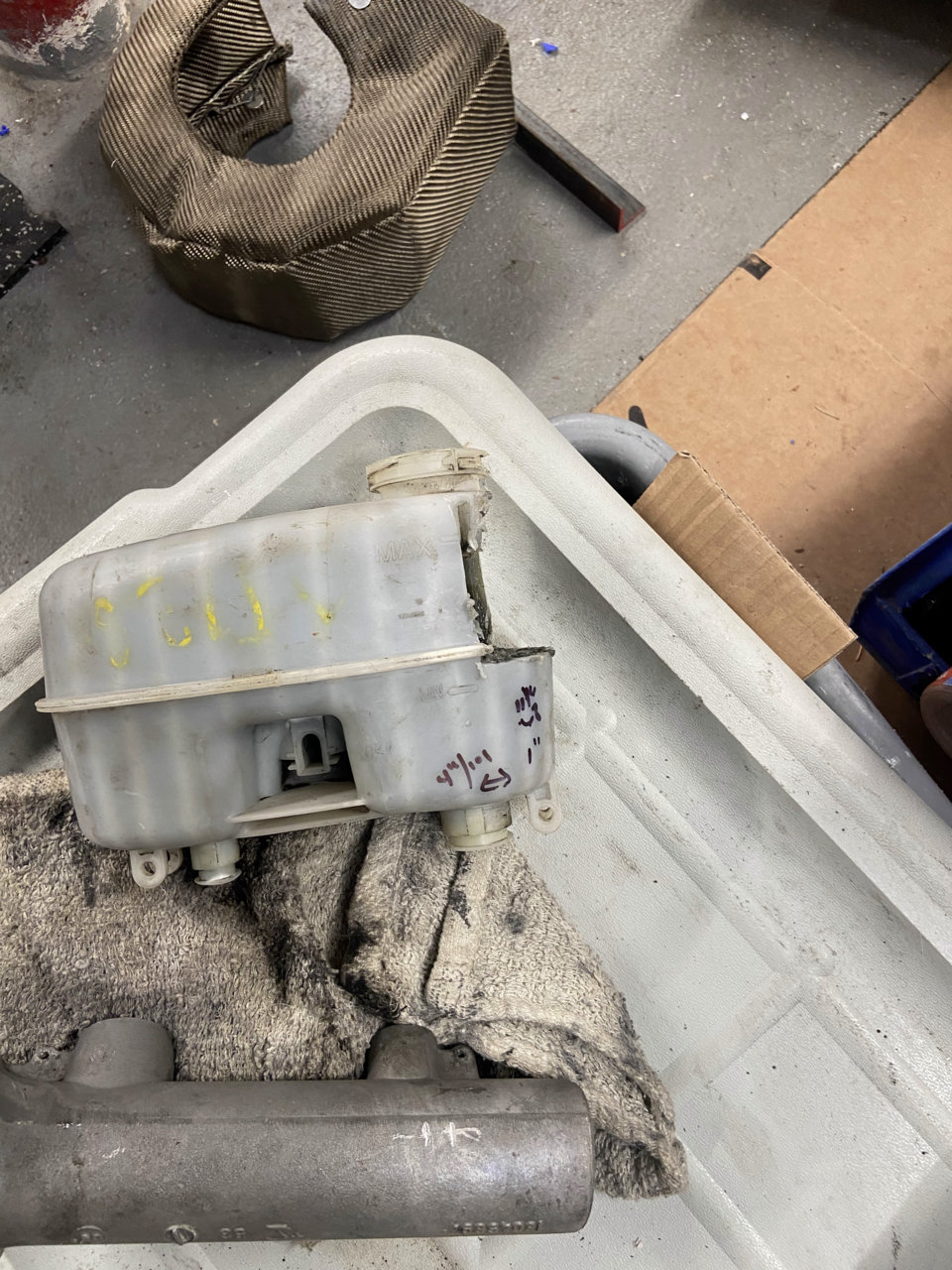

    Blew out hydroboost again. Prob from too much pressure and no place for fluid to go. Have to throw some new seals in that.
    Going to auto zone to pick through MC reservoirs this weekend to hopefully find one that meets this criteria. lol

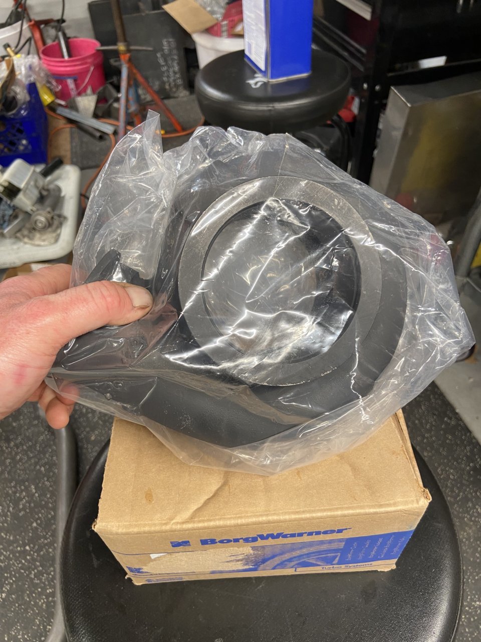

    This is the housing I got sent to swap to v band. no bueno.

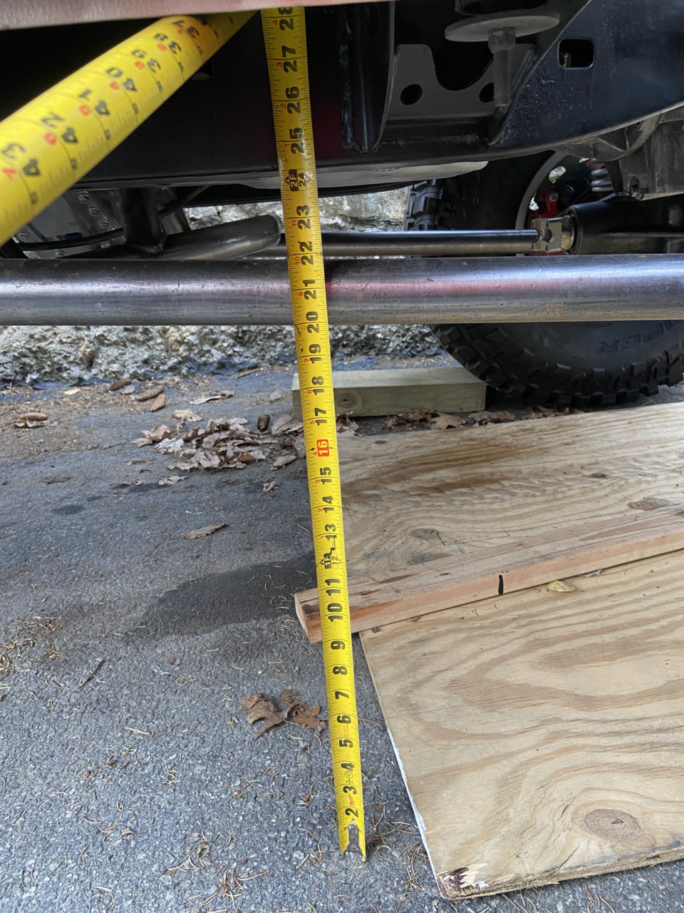

    In the driveway my fabrication rate doubles and my paint rate doubles, then quadruples. Plus the emulsions I have are not the best. Remote res setup would be a big improvement Im sure.
    If I just throw a 16 in there will I get 2" height out of it??

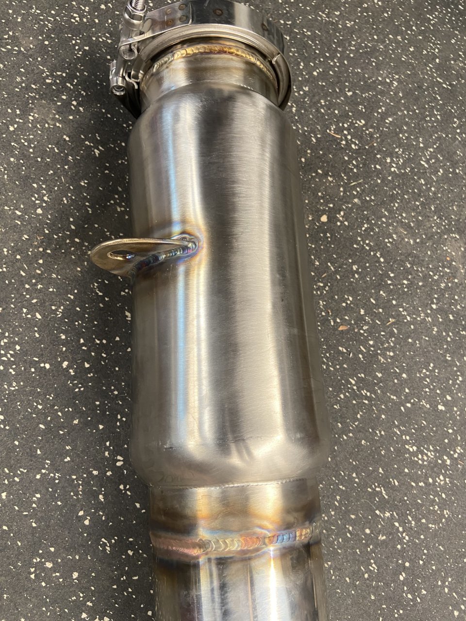

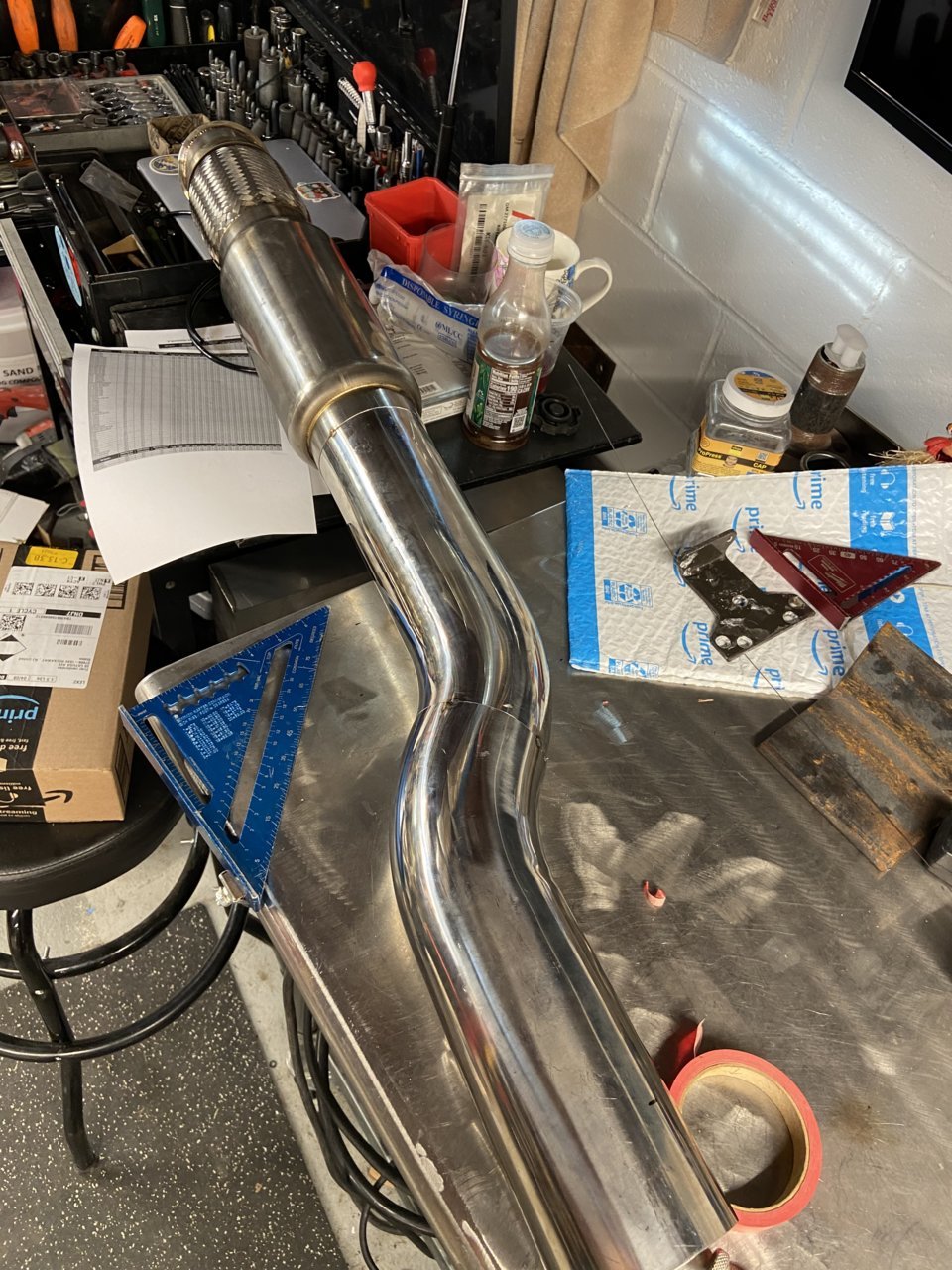

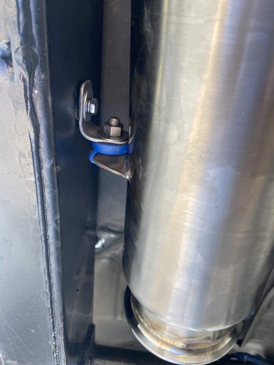

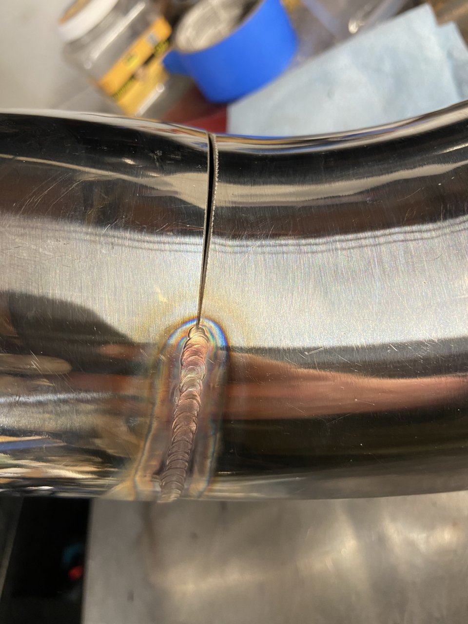

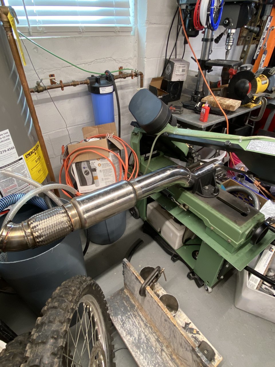

    Exhaust day
    BE1CAAFD-8EB9-45B0-8C4E-B24BB2D3E140.jpg 1BA3EE2B-2AB0-4740-9E84-4588A71ED5A3.jpg
    BassAckwards, Slashaar, Wulf and 8 others like this.

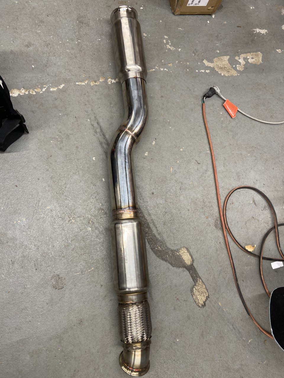

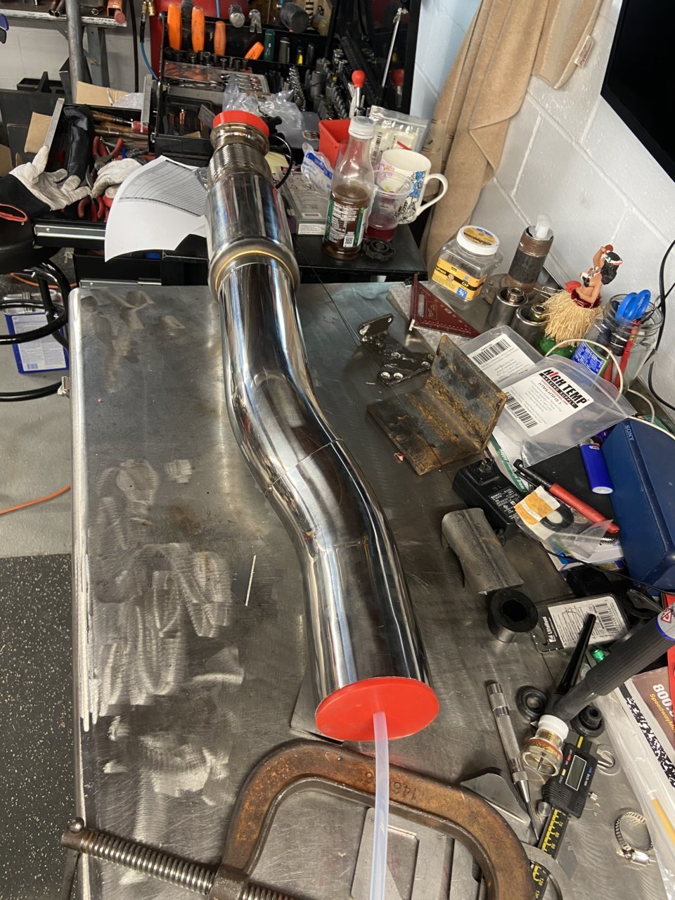

    Main run is close to done. Moving along good.
    2773145F-9EFB-49DE-A09B-75A2E66D0F34.jpg 1D329517-20FF-4DF9-84FF-A47A4A0FB0FC.jpg ECFF2AE4-ABF5-4926-B417-D7FB58624CC9.jpg BE4783E3-CF26-4AD1-8E0B-C2A537C90AD9.jpg C99E0615-AE70-4B30-B307-B02218A2F648.jpg

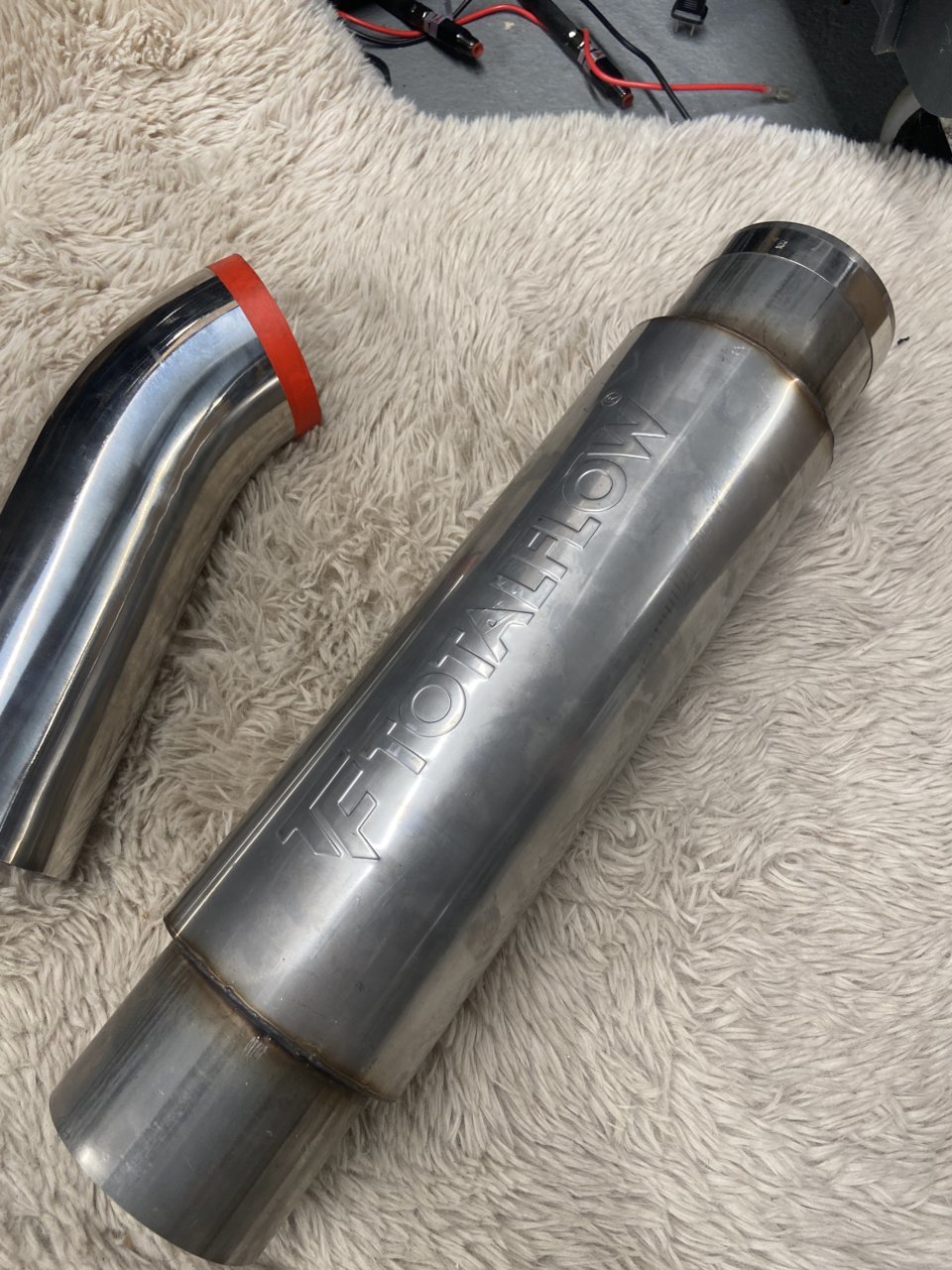

    What bottle muffler/resonators are those?

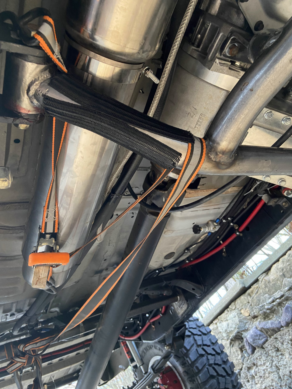

    Total Flow. Those are 10” t-304 resonators and the “diesel” 304 muffler.
    Lol. Too loud still. Have to do a double 45 over the crossmember and then gonna try the diesel style round muffler but may have to go to a dual chamber. I want the thing to be stealth. Right now it idles like a classic annoying american v8. Exhaust is surprisingly hard to get perfect.

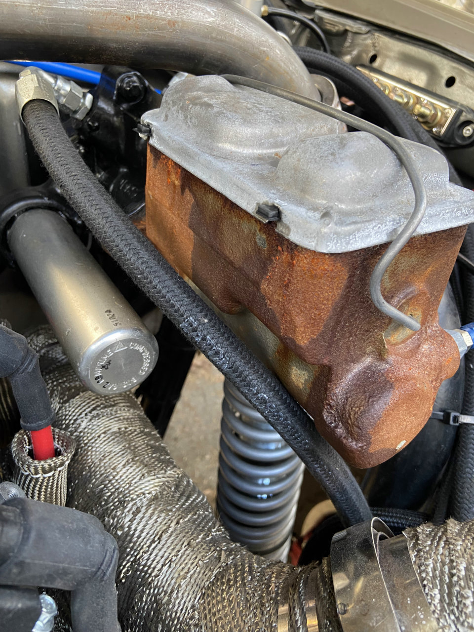

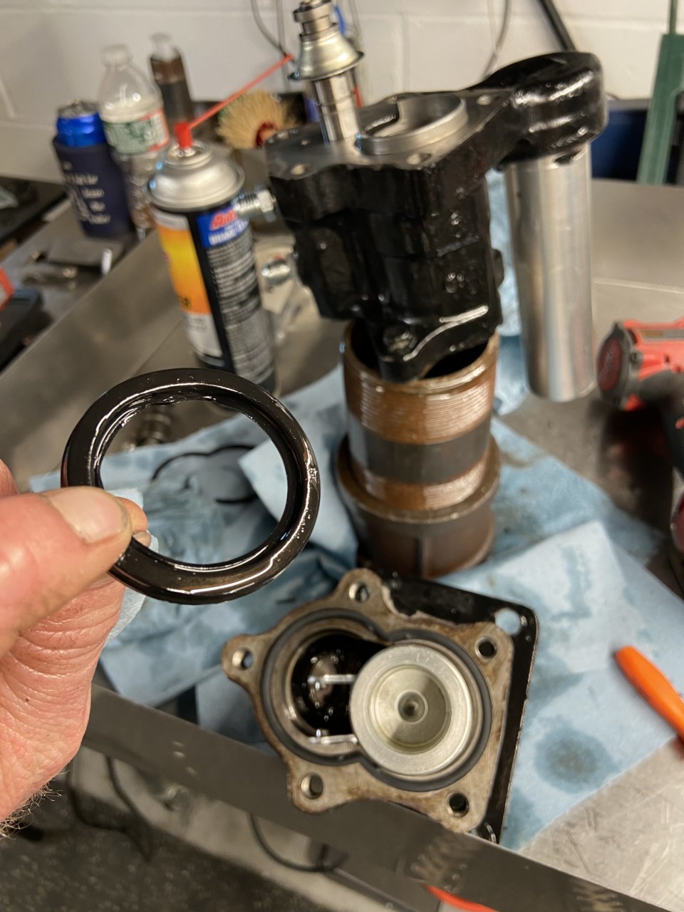

    Got the brakes perfect finally thanks to a good ole astovan hydroboost master cylinder. Have to rebuild the hydroboost again cause old MC was so hard to engage it was blowing seals.
    A8B0C0A2-C4FD-47F7-8F35-DCDE6068D72F.jpg 480877F0-1B33-4BCD-82C1-B36290C24E5E.jpg 294D8F23-0907-41BB-A8AF-C74C982278A6.jpg

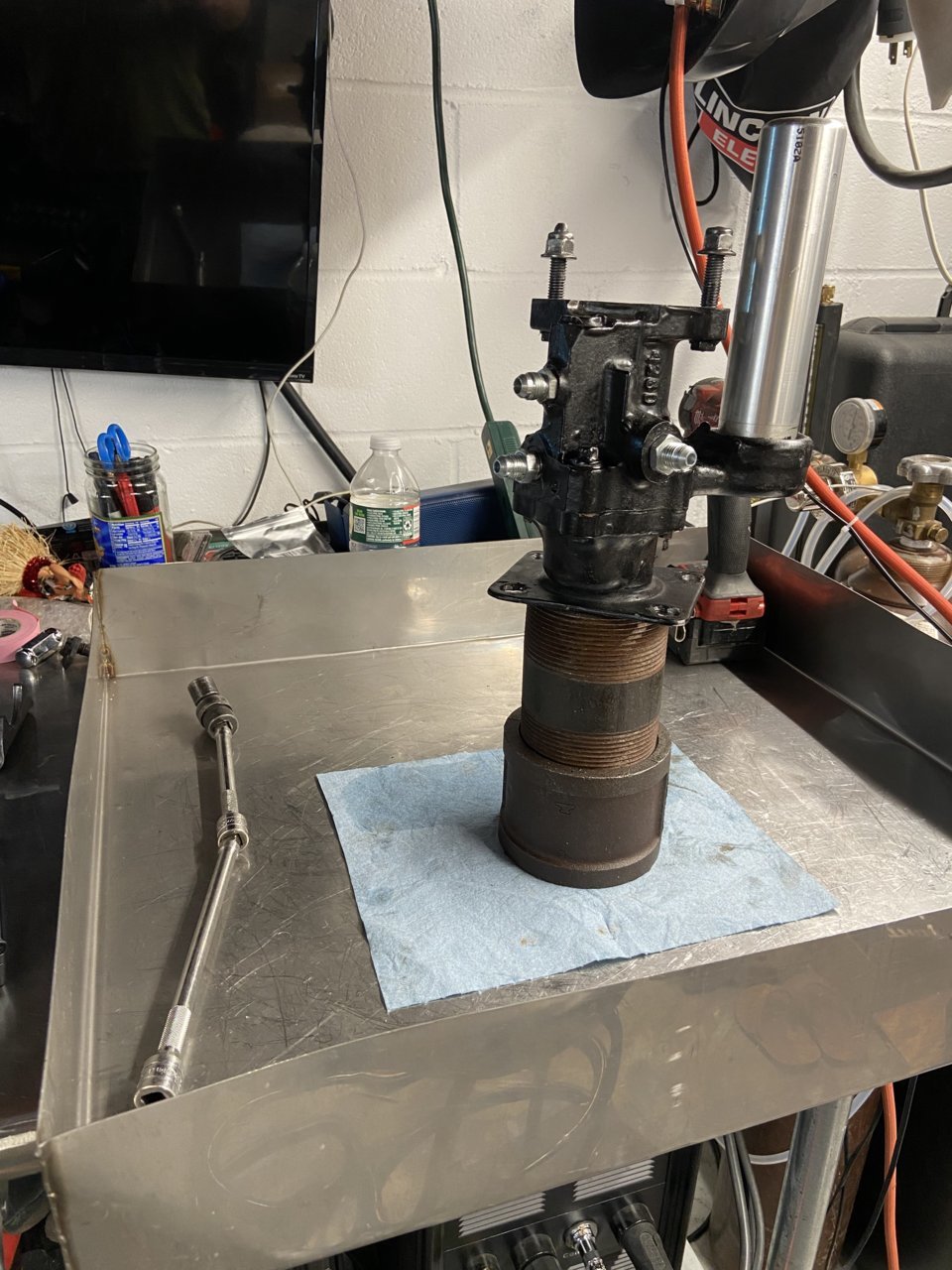

    Round 3 on hydroboost. Ended up being the plunger seal again. Finally got the touch on getting plunger in w out damaging it. Kinda tricky.
    97F5F09C-9621-49D7-9124-71FEF5246411.jpg CE3DB44D-8E71-4CA3-AC24-F4836912D63F.jpg

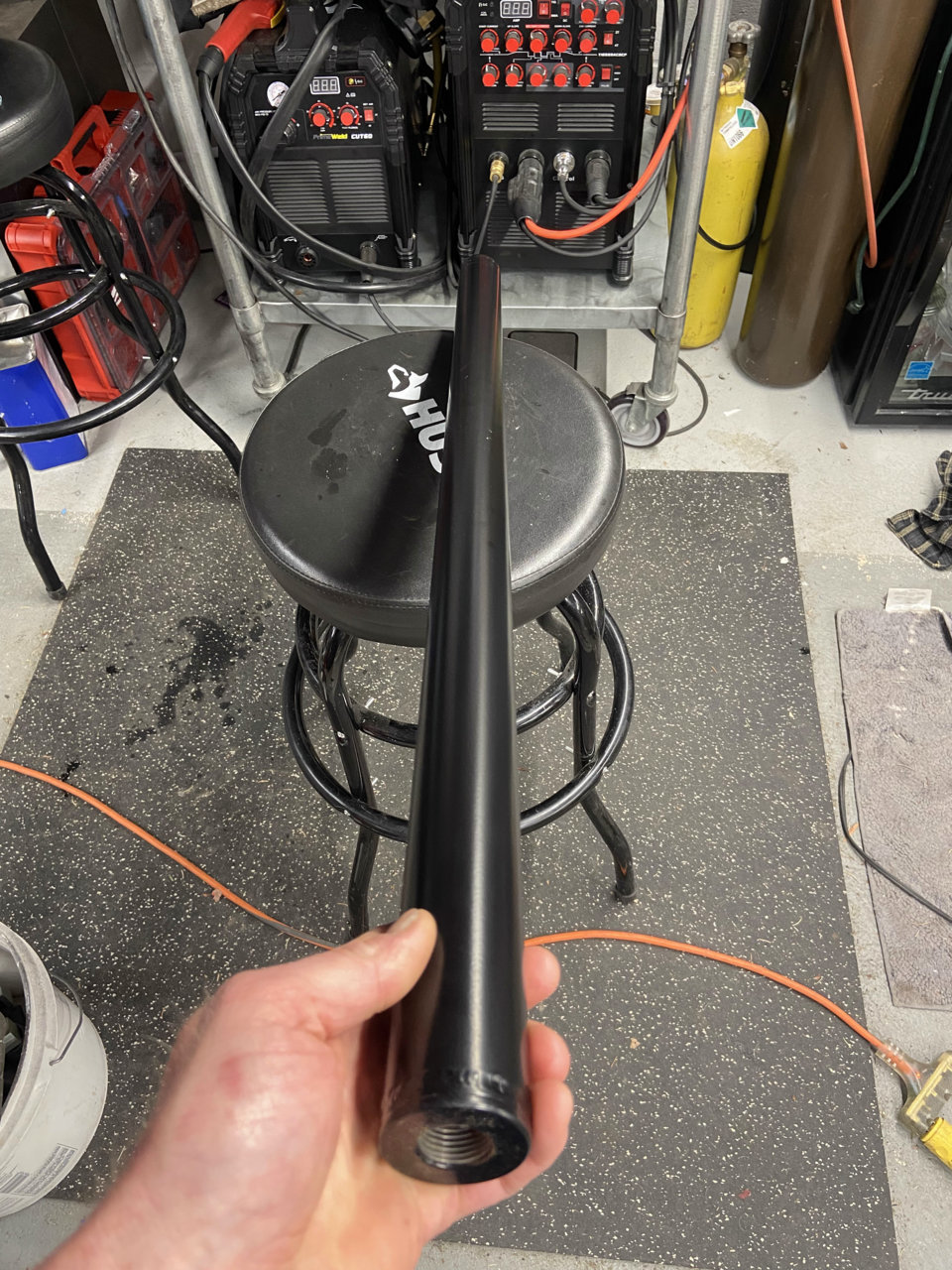

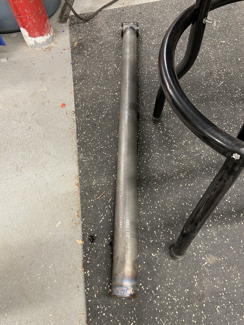

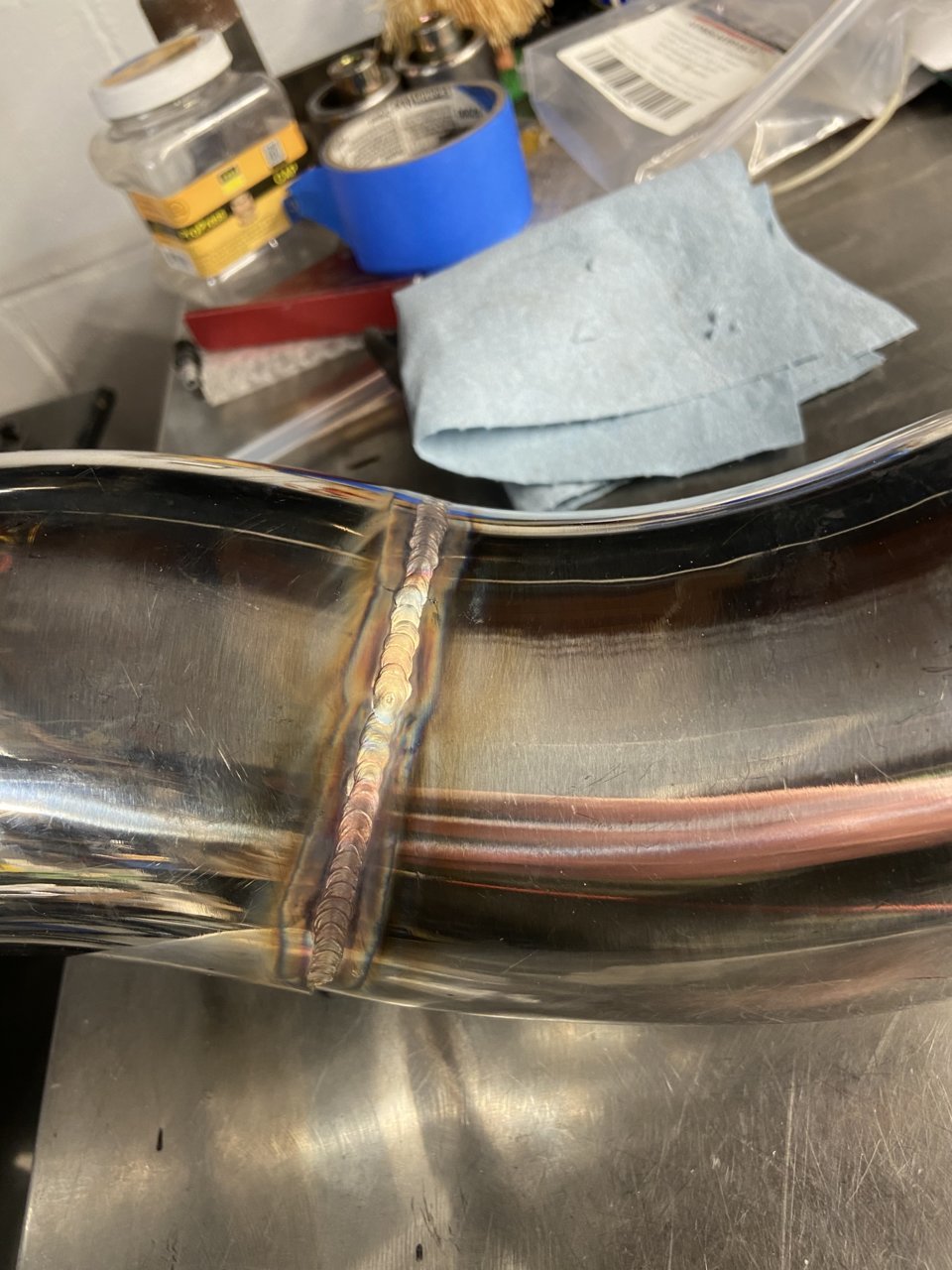

    Anti-wrap bar started. Decided to tig. Took 4 passes to fill in the .250 wall dom. Stupid. Other than the floor board being setup for a Flinstone she is ready for a real drive and break in/or break down trip on the open roads once antiwrap is in.
    sparkystaco, la0d0g, Slashaar and 2 others like this.

    New turbine housing came. Now gotta redo all that shit and make my Australian LC sealed air box and snorkel. That is gonna get 100% of my attention and should be really nice.
    C711D2F1-1EE4-4476-9C49-50EF0052125E.jpg 64DD258B-8FBB-4802-94BA-5CE2F94042DA.jpg
    Aiming for this setup w out that whack visible bracket and fender entry vs hood.
