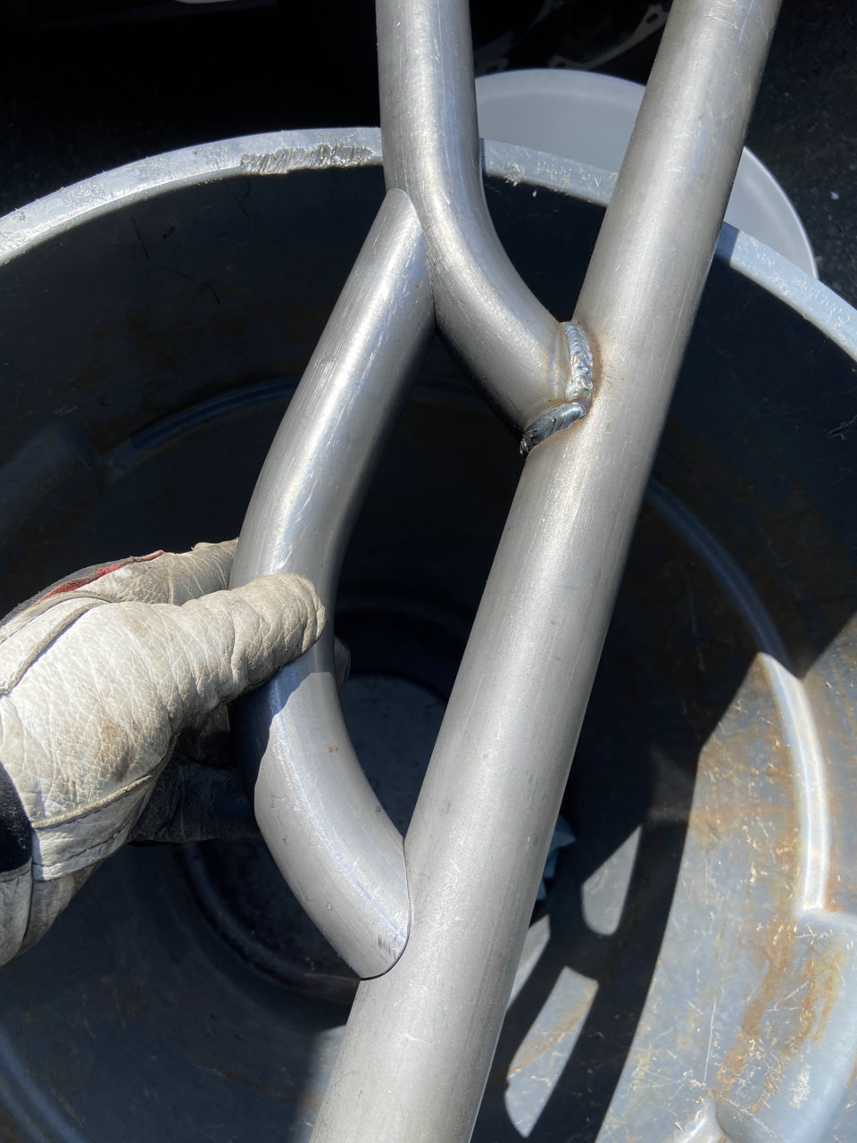

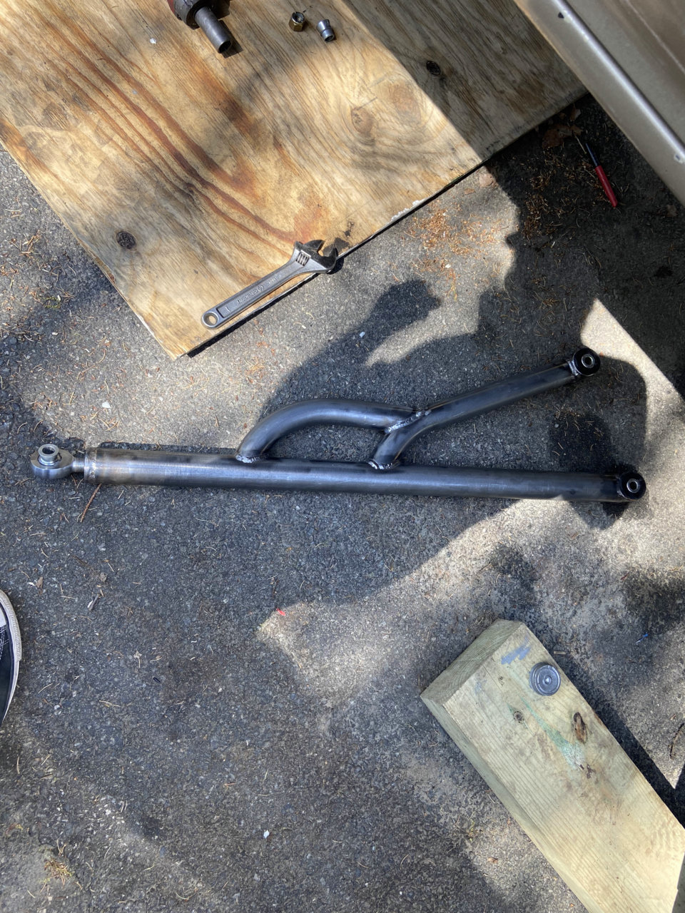

    ls turbo, tons, 40's and a partidge in a pear tree
    Got the damn anti wrap done finally. Kinda rushed the welding but powder should cover most.
    In theory, this design should be stronger and have more push down force than straight bar up top.

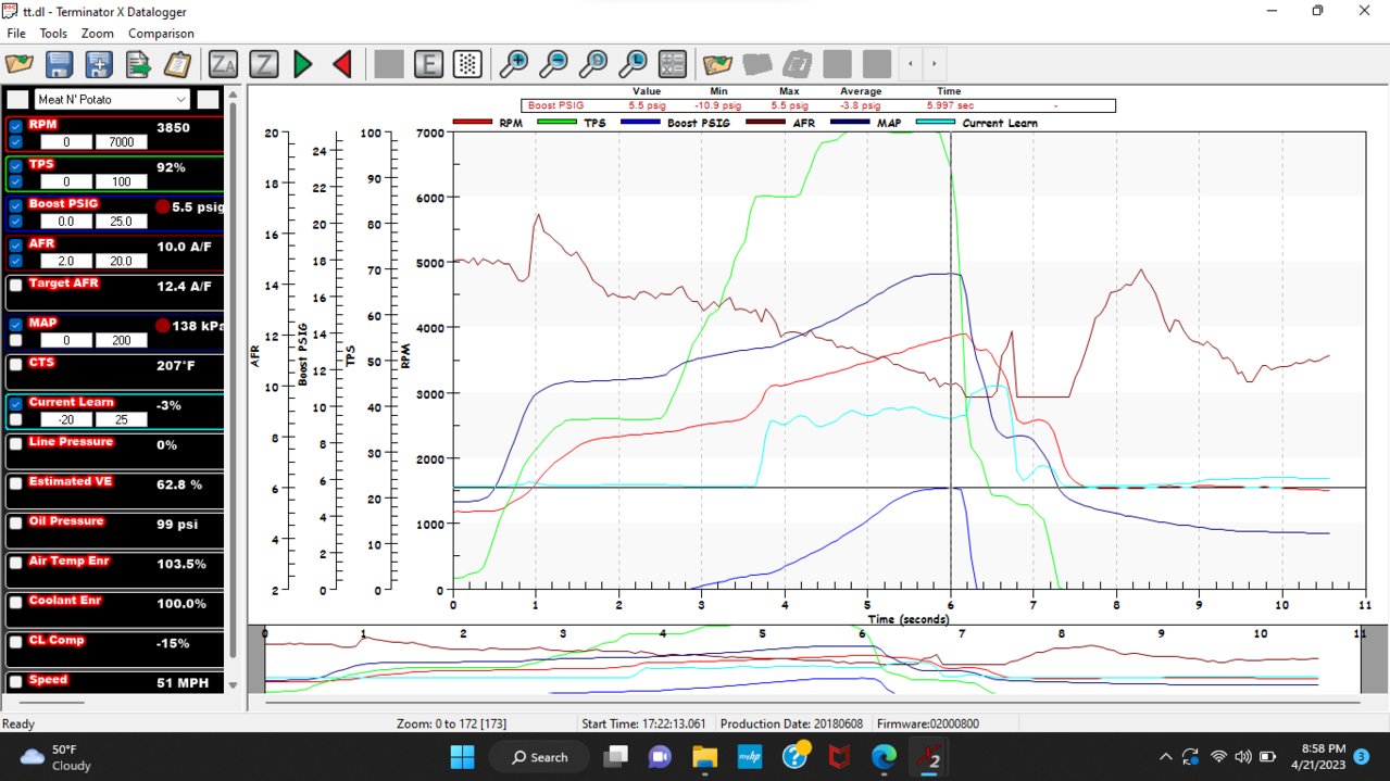

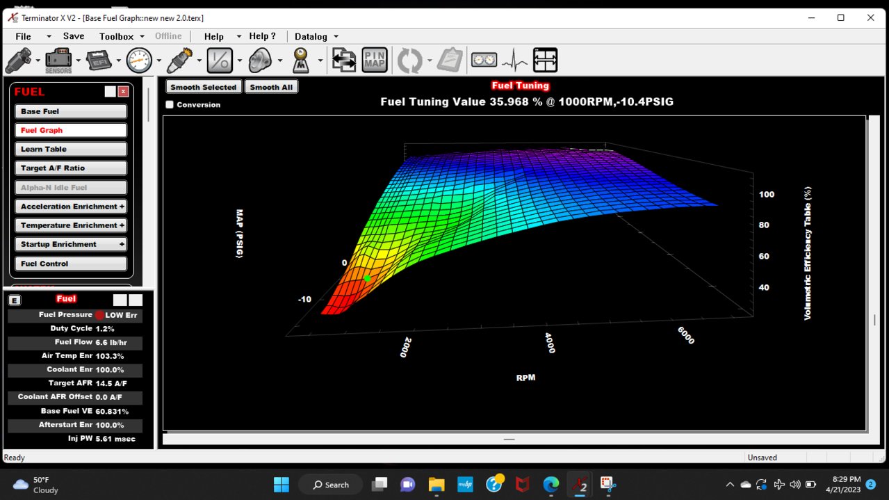

    Worked on fuel map and enrichment for like 3 hours and tried to add 10% to a section and added .01 vs .101 and couldn't undo it. Took 30 min to get truck to run again. Map is shit at idle now but it runs clean. Idles at 14.5 cruises at 14.7 and runs a little rich into boost. For anyone who wants to see what the holley stuff looks like.
    Fuel graph
    Data log from a little pull. All the stats are on left side at full boost of 5.5lb. Wastegate spring needs to be changed. I think AFR is a little choppy cause ebay turbo is leaking oil and hitting wideband.

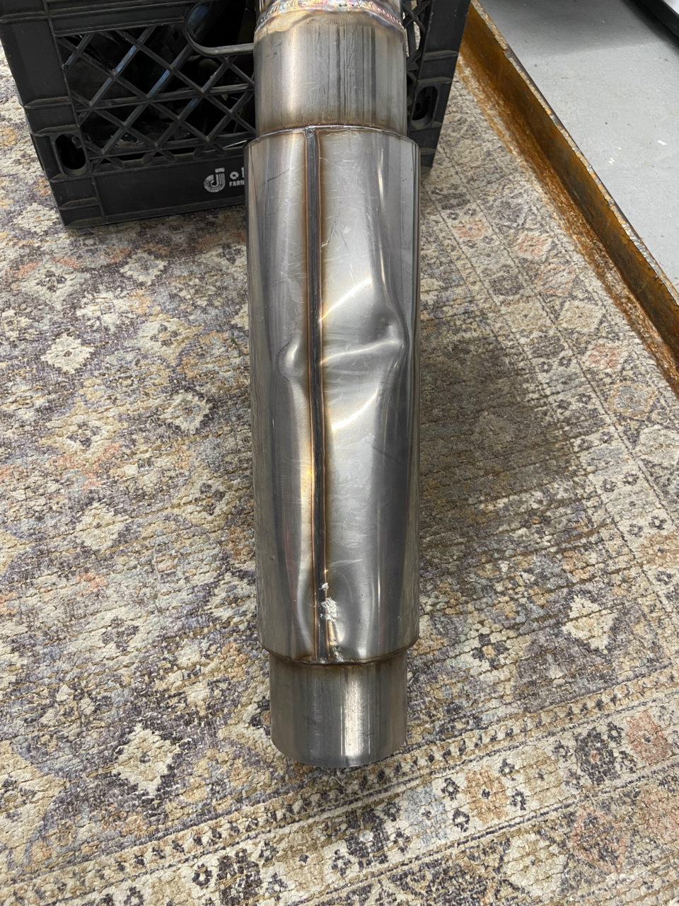

    What happens when you can't get a tac to break free and you are in the wrong frame of mind for fabricating..Then you use the driveway to beat the shit out of your muffler.

    Yeah, an annoying gurgle. Swapping it tomorrow so its all good.

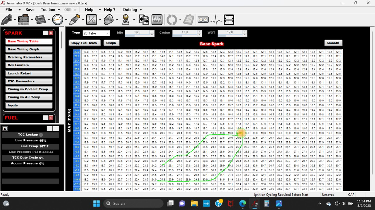

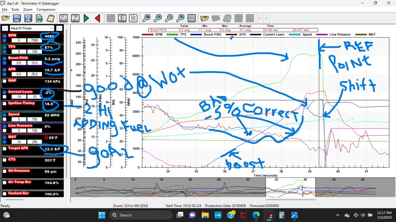

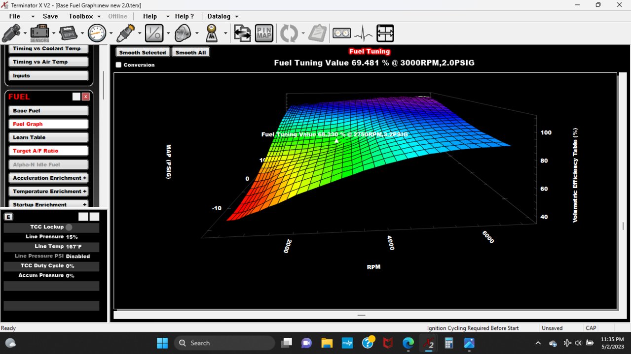

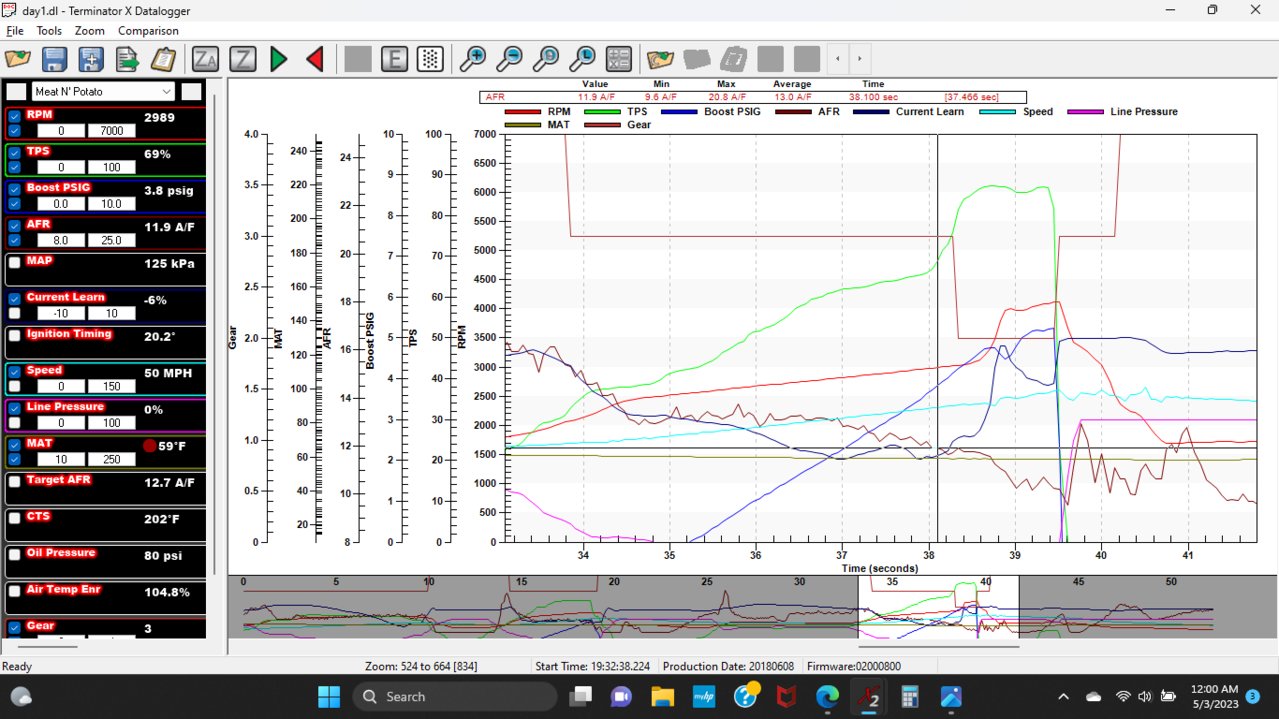

    This is basically what I have been doing for the past 2 weeks. Make a little pull under boost and look at log. Which looks like this w whatever parameters I want to see. This was a light throttle run with new ignition map I had to build from scratch cause Holley one was crazy sketch.
    No writing and some diff parameters. You do a data log pull, then overlay it on maps like below.
    Overlay (this is for ignition but same for fuel. Then I have to go smooth it out on the graph below this.
    Graphs - This is where you make the small changes. (ignition still too high and map is like half done but good on the wot stuff)
    Fuel graph. This one I started fresh on too and is same, bout half done. Still really flat and basic. (This map has like 5mpg at cruise right now and 25 at wot- wide open throttle)

    It's less Tacoma and more mod
    Looking like you're on the right path though, even have the ign advance retard a bit at peak torque (lotta guys miss that).

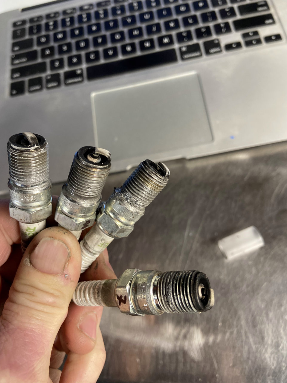

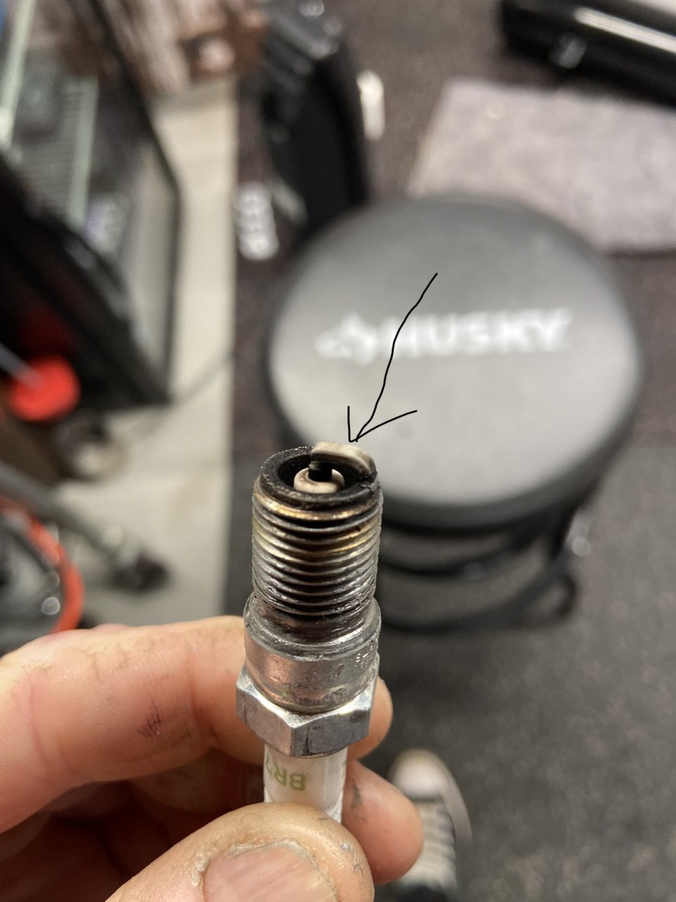

    Yeah, that ignition map is new and kinda only done on the idle, vacuum, and to about 5 psi. Once I get into a full pull I will prob drop the timing down at 3000-3500 then bump it up a degree or so after the load subsides. Right now the fuel is still not great so don't want to waste my time w exact timing. I just changed the plugs to a bit hotter and gapped them tighter. The timing line is a little high up. I can't remember if that is too much or too little timing? Idk if you know that?
