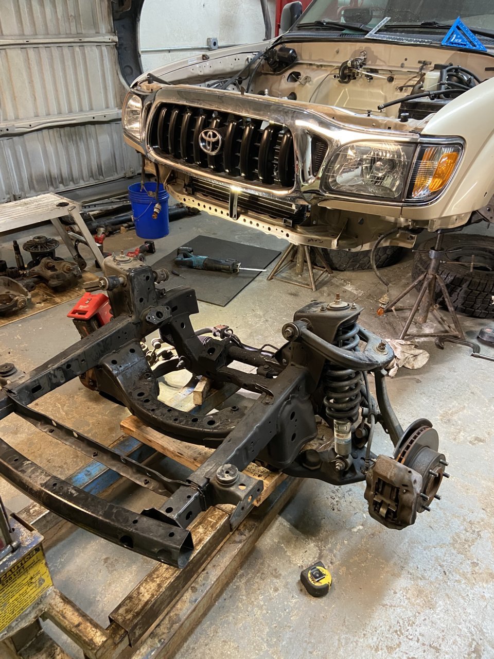

    FE133BD7-5BB9-4491-9DAD-D684F0B1C7DC.jpg 43F5DBAD-B2CA-43B4-872C-A3C399C4CFBC.jpg
    officially out of real estate

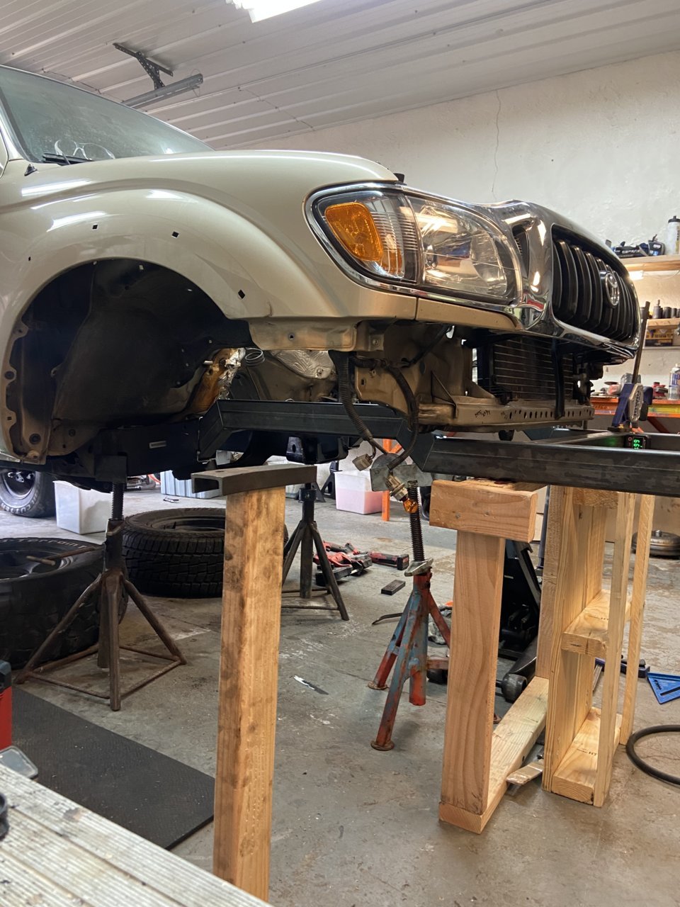

  2. Mar 4, 2022 at 5:20 PM
    #162
    Yota X
    Yota X [OP] Some say dresser, I say dryer.
    Jul 11, 2019
    #298961
    5,268
    NW New Jersey
    1st gen
    ls turbo, tons, 40's and a partidge in a pear tree

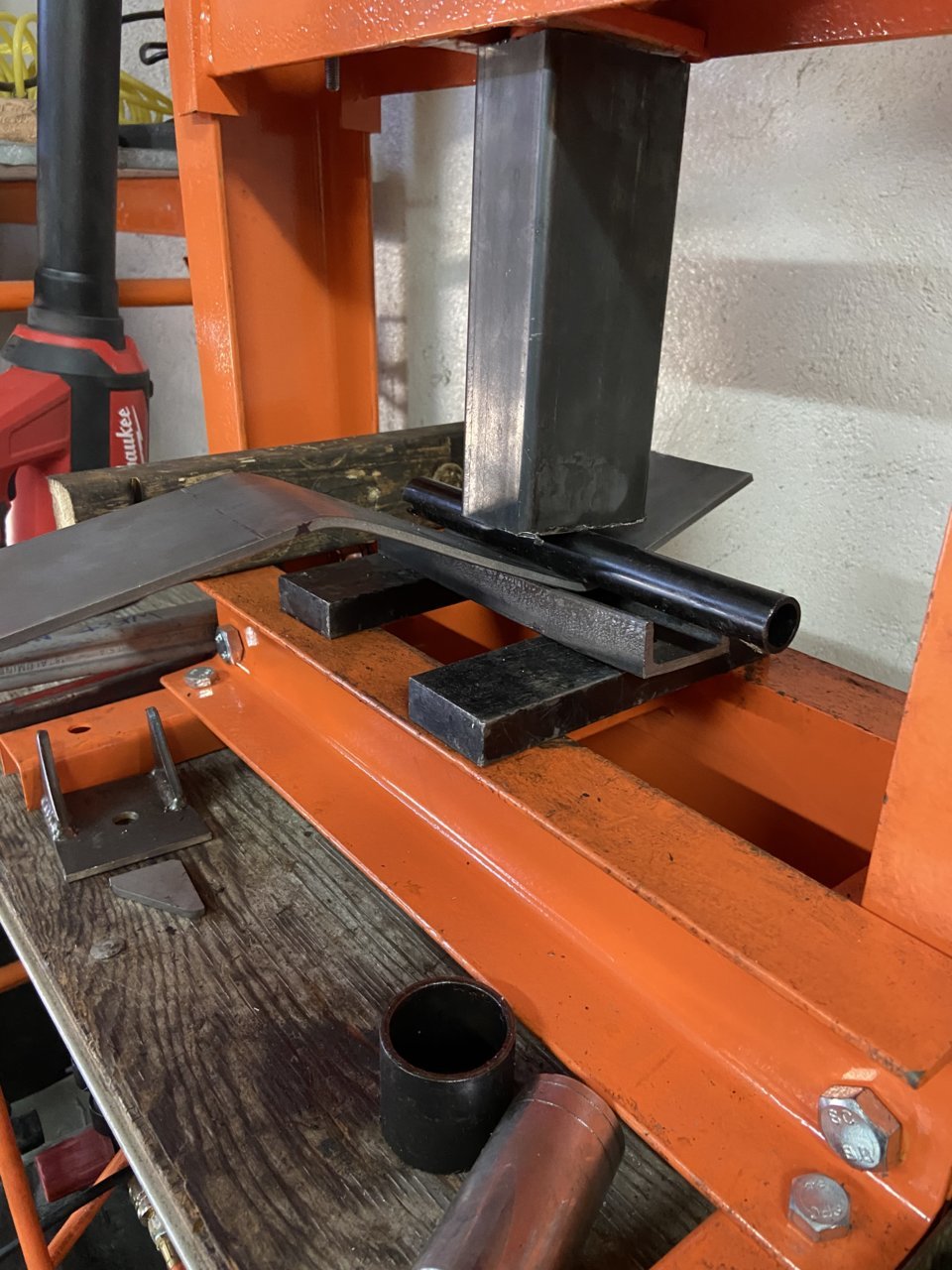

    New parts whipper.

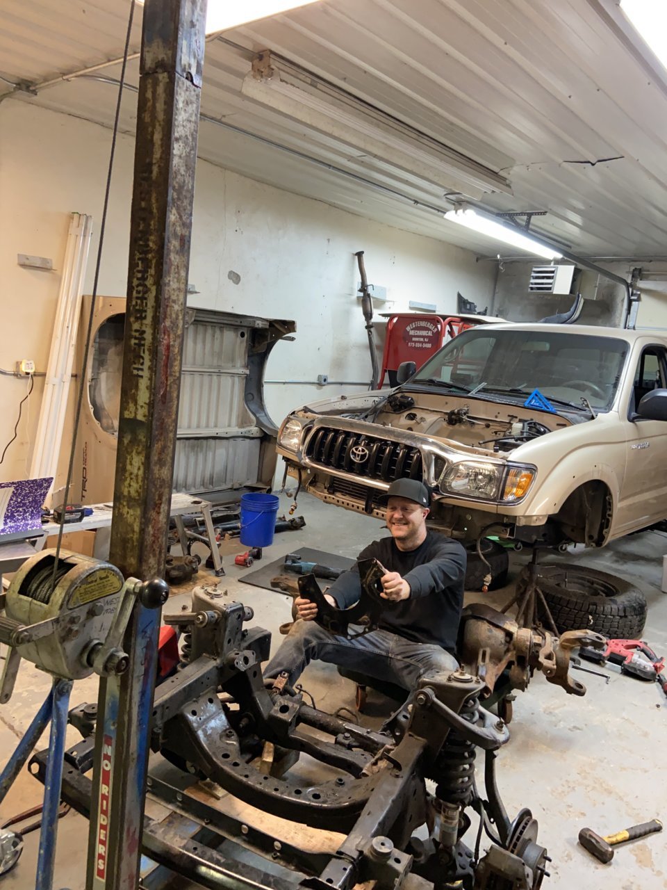

    UPDATE- CUT THE FRAME BACK WAY FARTHER. LIKE 2-3" FARTHER BACK CAUSE THEN THE 2X3 WILL BE NARROW AND THE FRONT DRIVESHAFT WONT HIT ON A 1 TON SWAP W A SD AXLE.

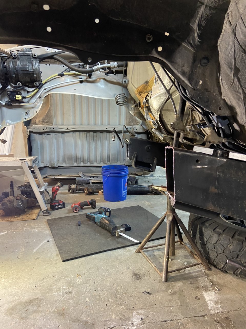

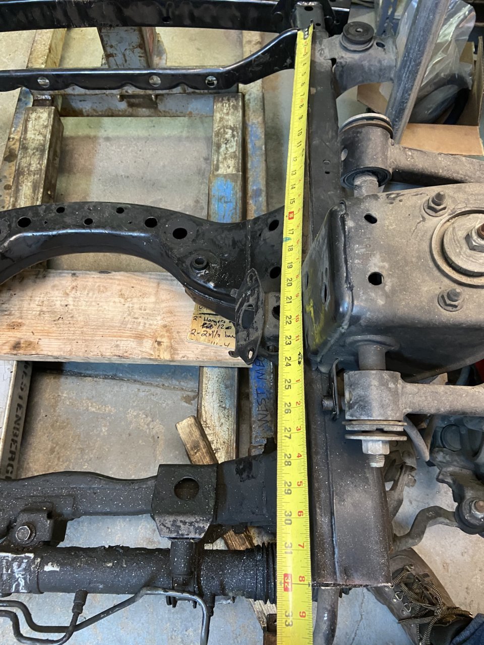

  3. Mar 4, 2022 at 5:31 PM
    #163
    Yota X
    Jul 11, 2019
    #298961
    5,268
    NW New Jersey
    1st gen

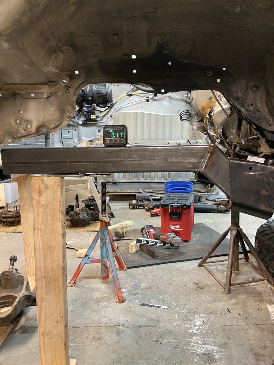

    32” from front of frame. 4 degree positive of 90 degrees I guess it would be.

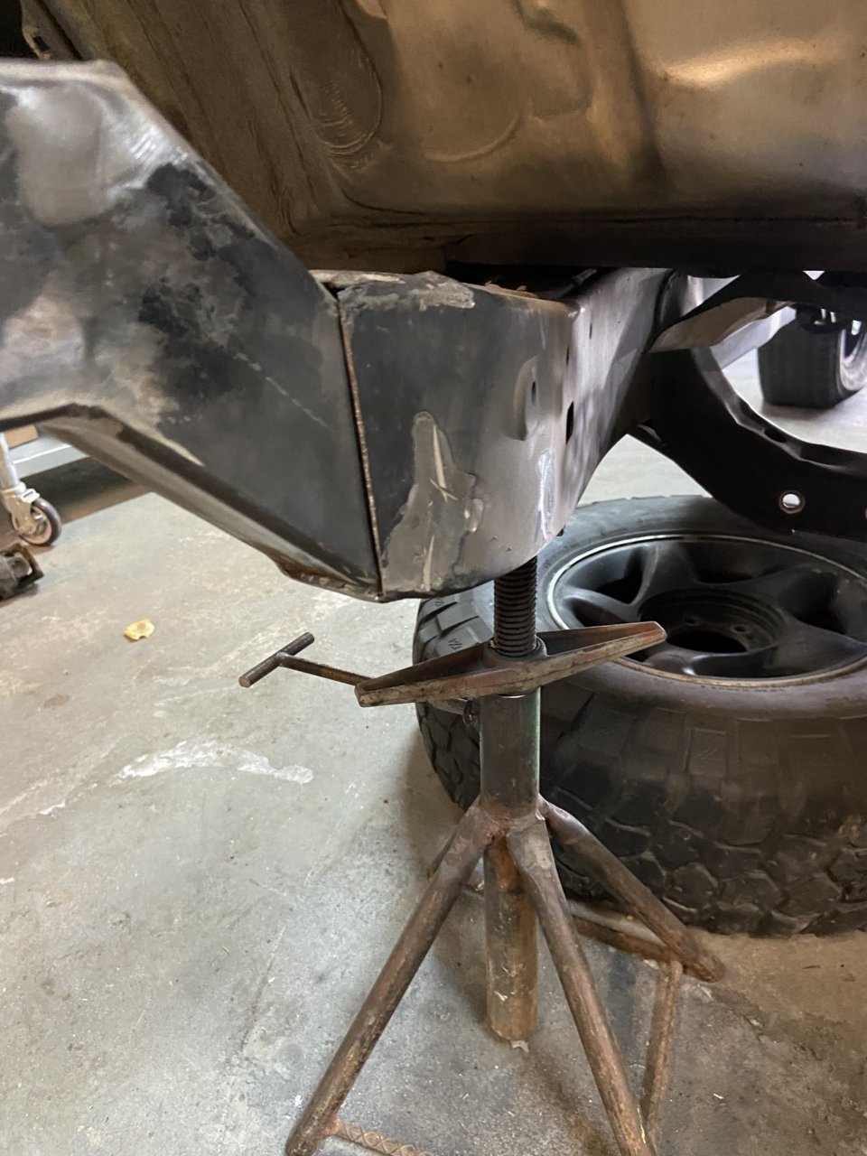

  4. Mar 4, 2022 at 9:27 PM
    #164
    Yota X
    Jul 11, 2019
    #298961
    5,268
    NW New Jersey
    1st gen

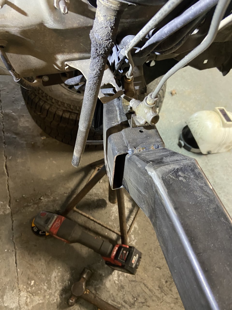

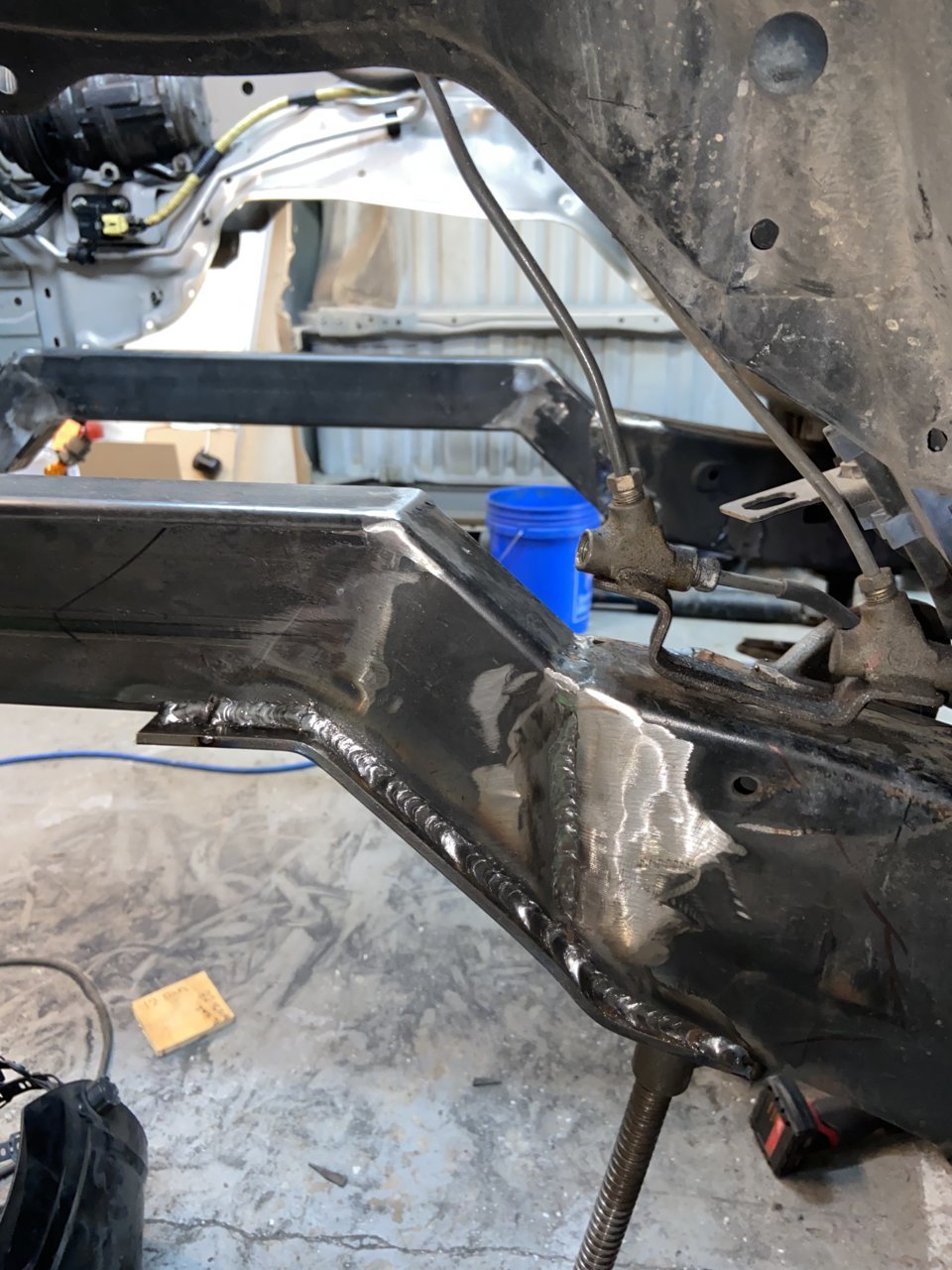

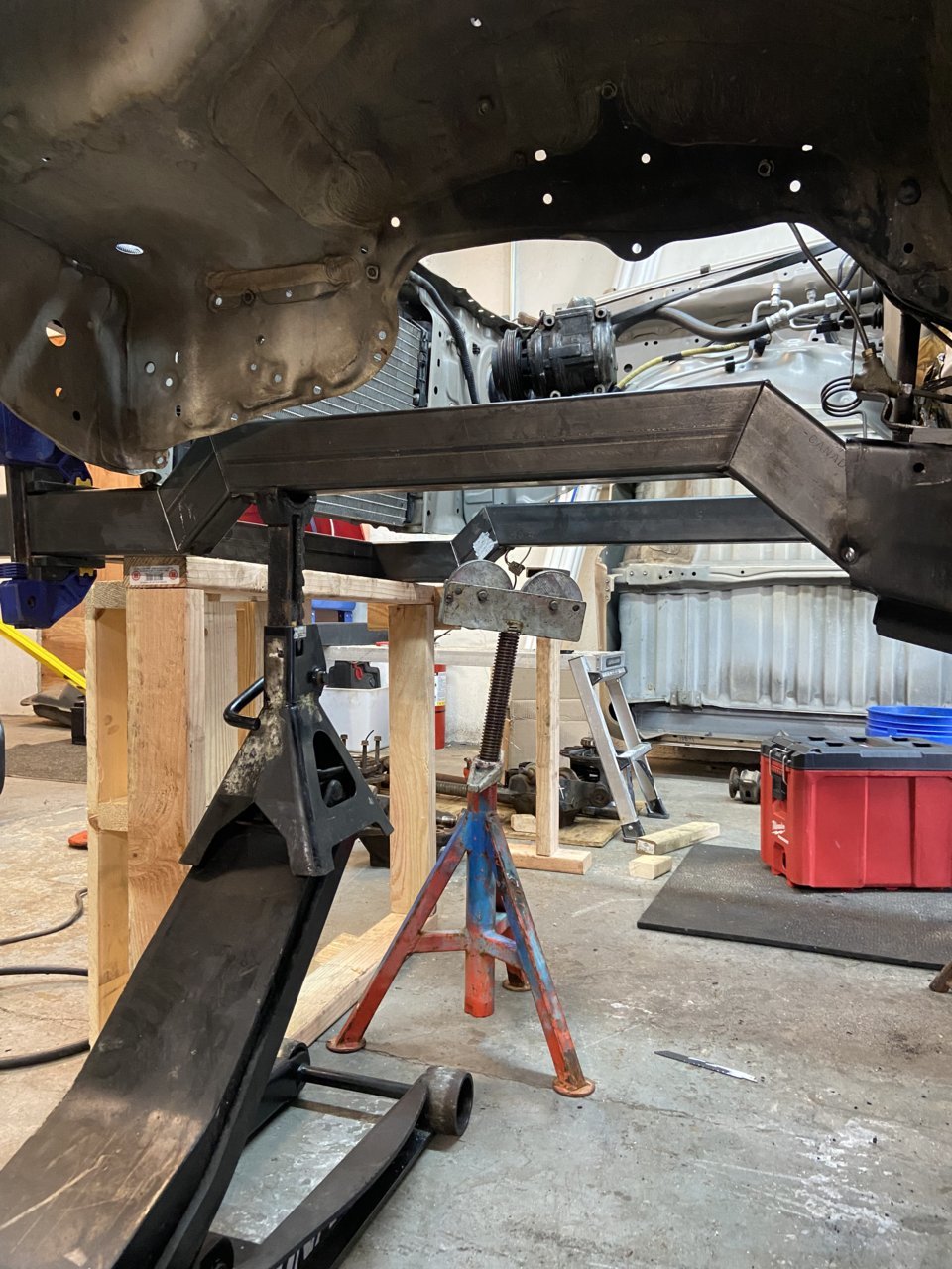

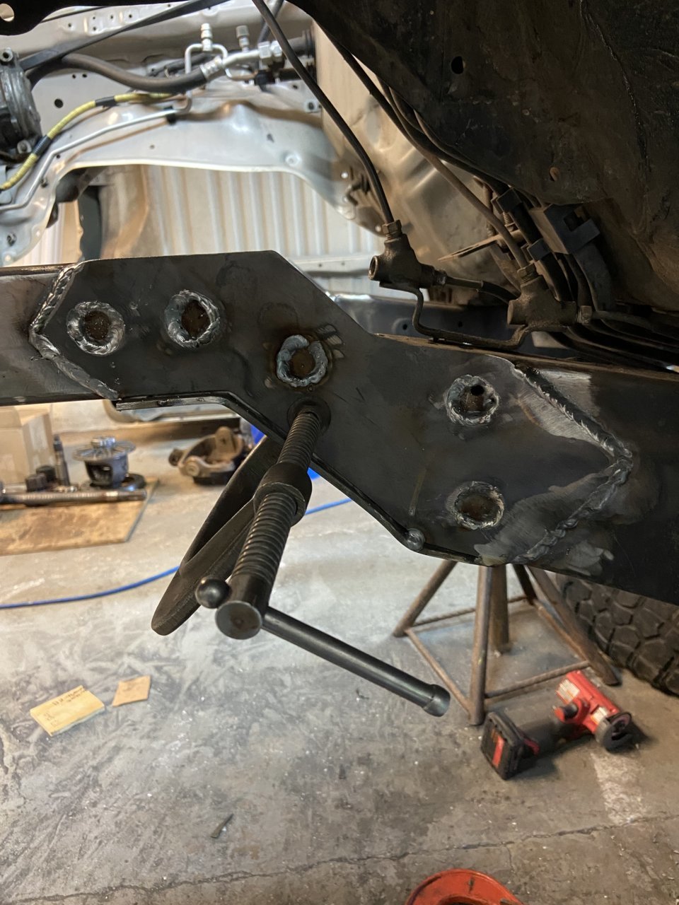

    This has been a lot harder than I thought. Figuring out the first angle and height I wanted took forever. Just have to copy on other side now.
    96FE9AC5-AC55-4975-9180-BBCDAFA51657.jpg 3C0A6C3D-85AF-4049-ADED-CCF08D6A30D7.jpg

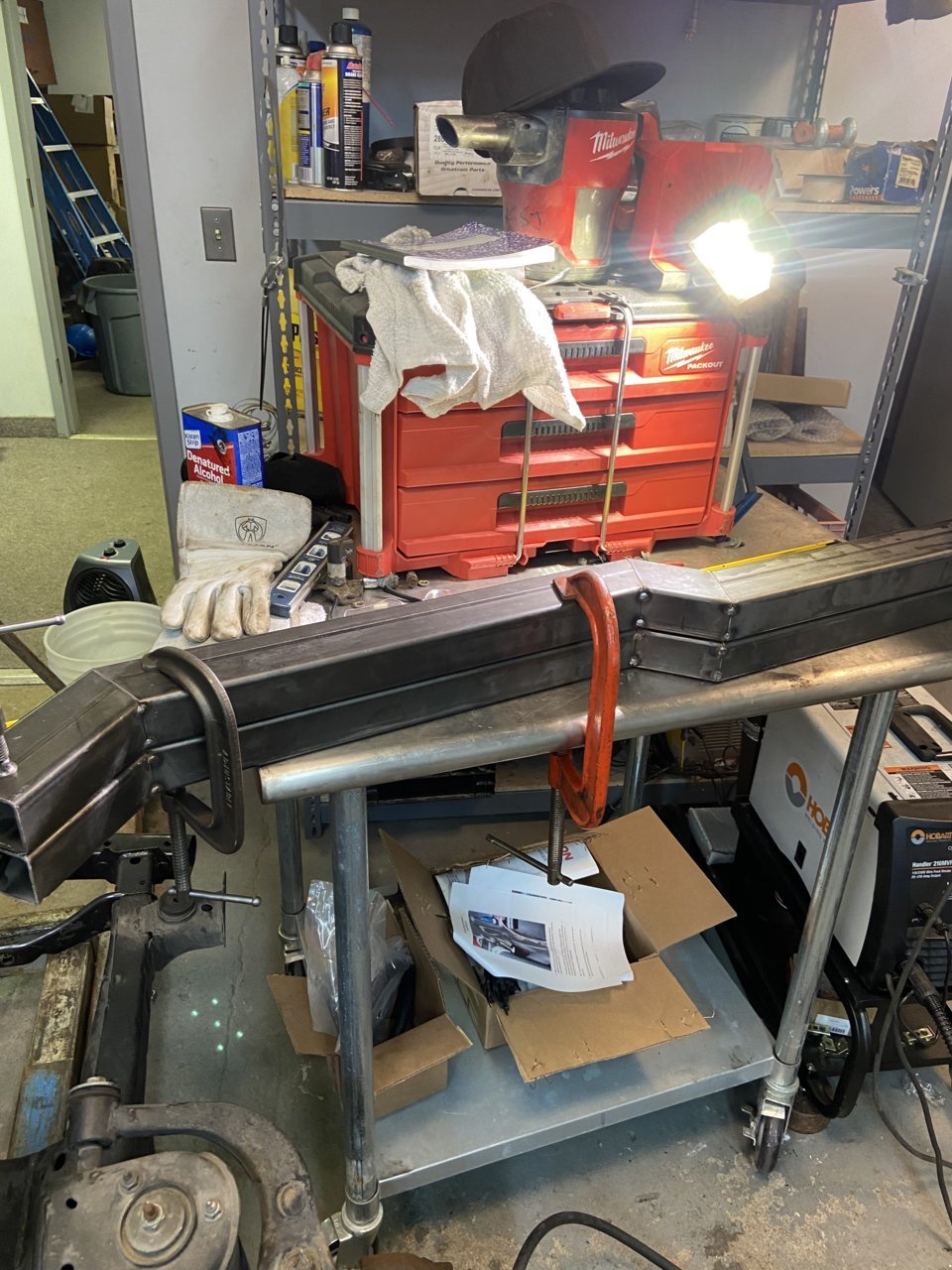

  7. Mar 6, 2022 at 1:53 PM
    #167
    Yota X
    Jul 11, 2019
    #298961
    5,268
    NW New Jersey
    1st gen

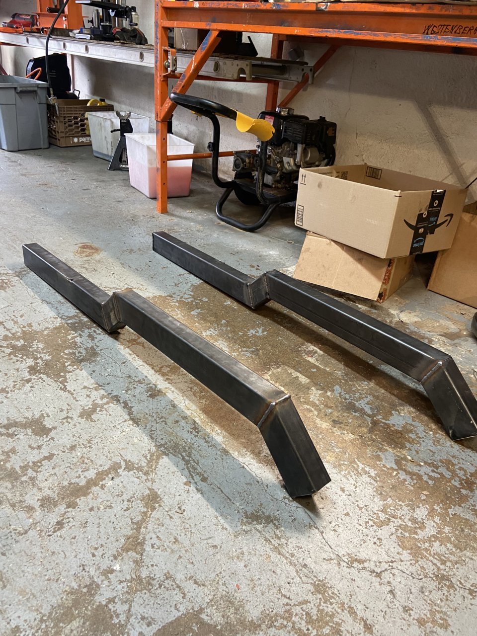

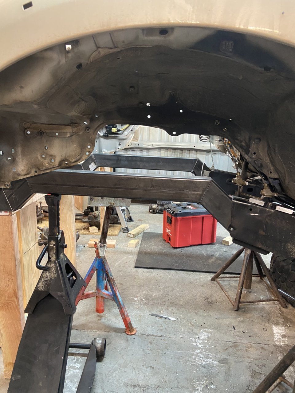

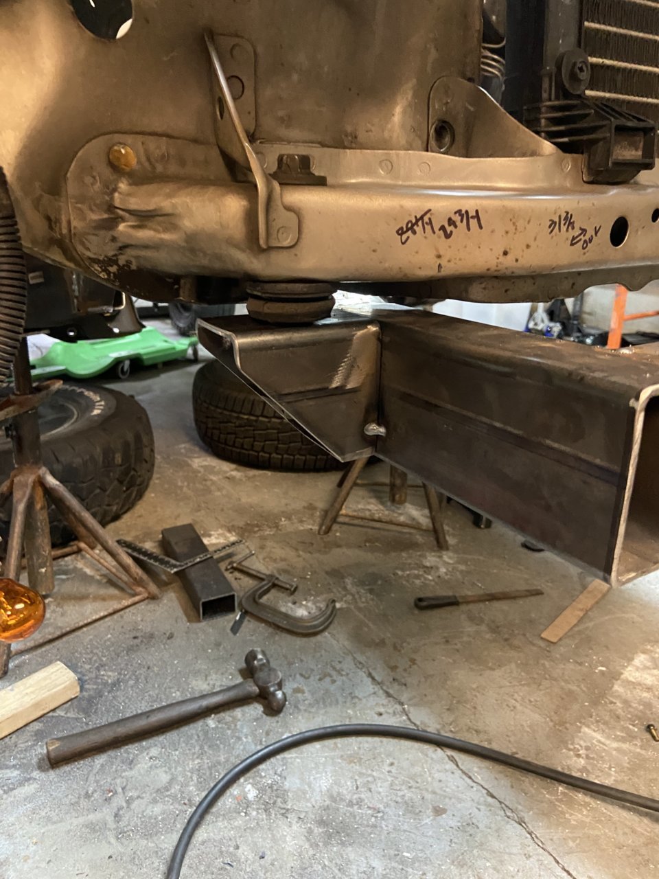

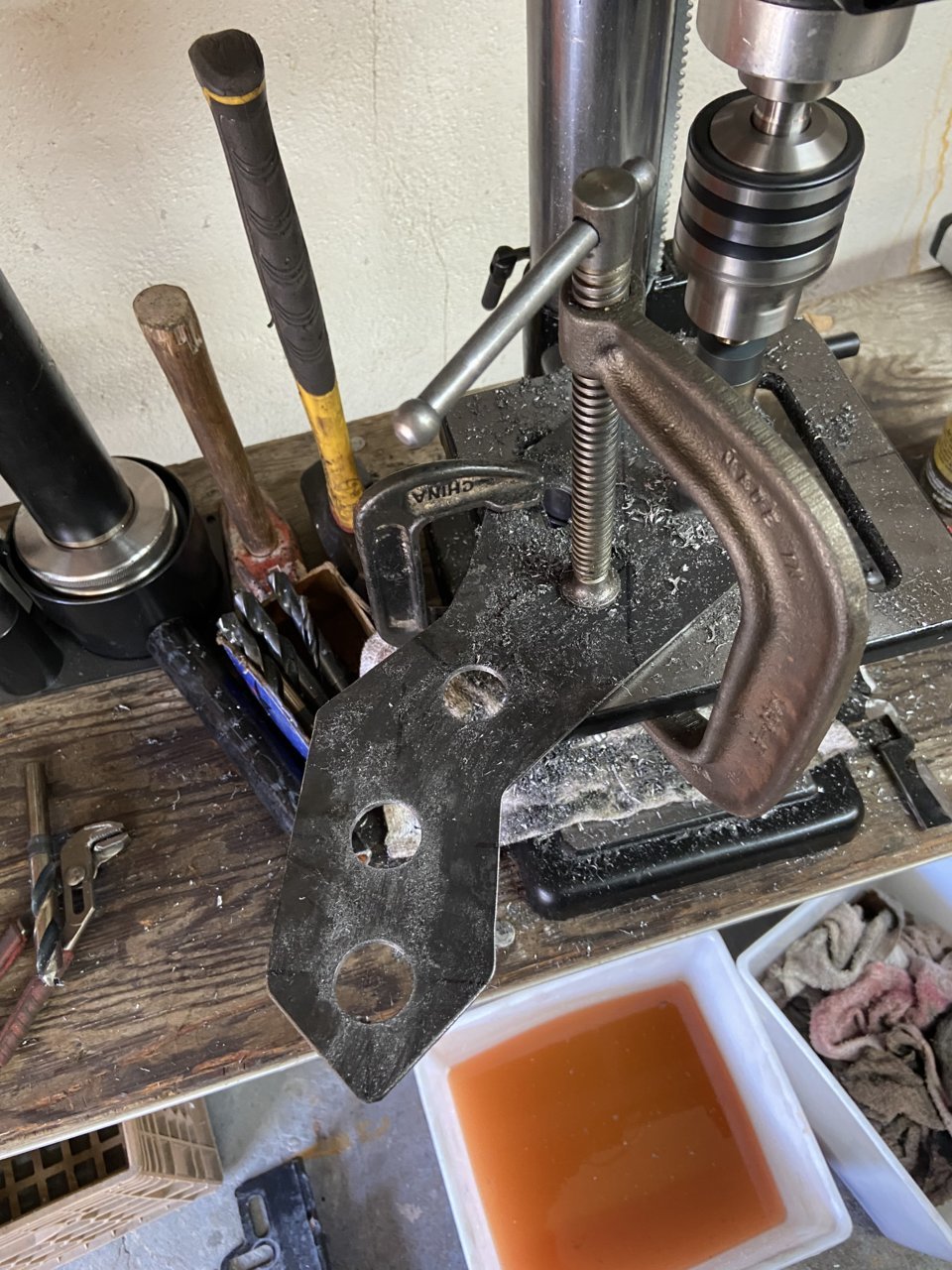

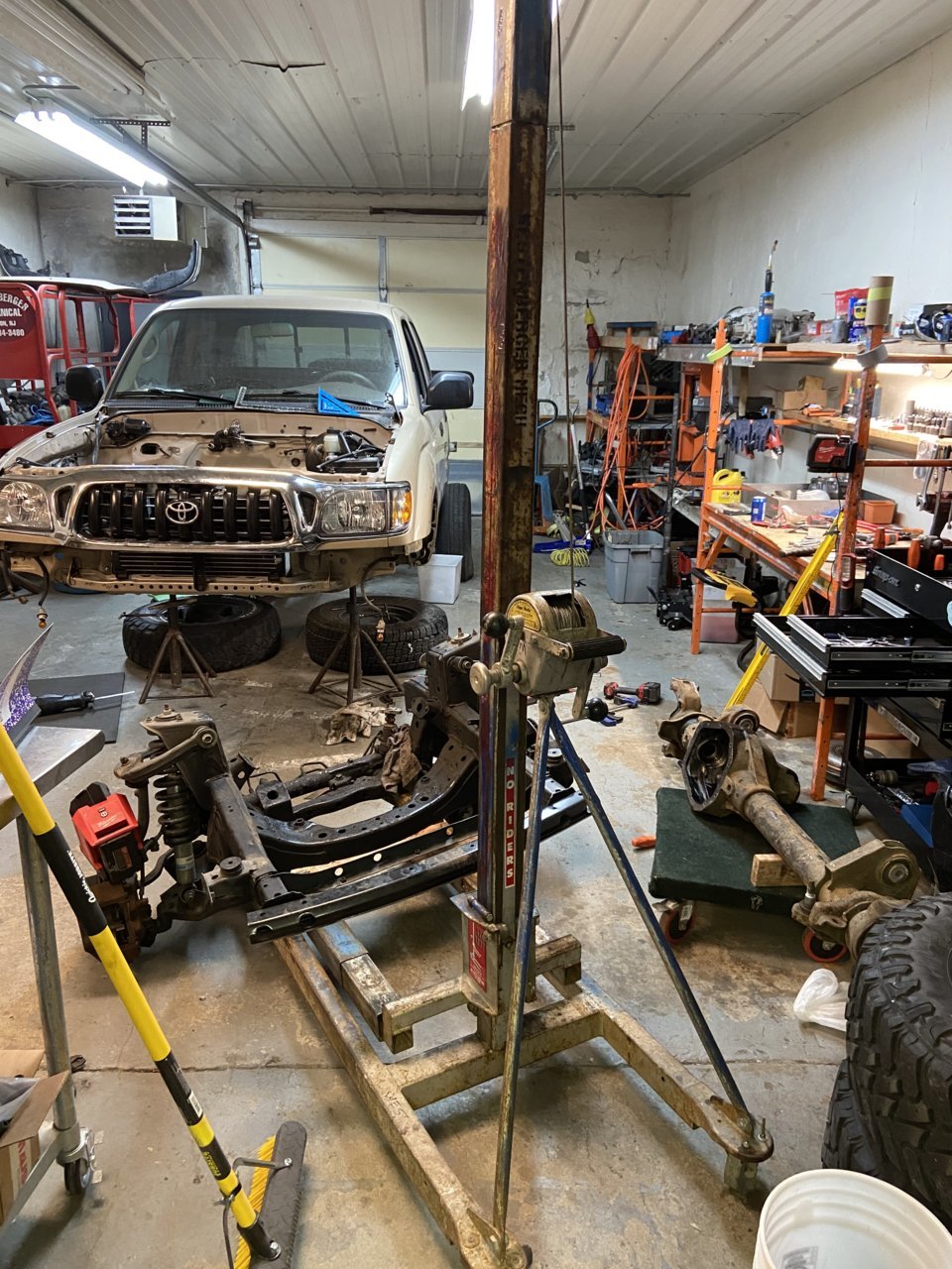

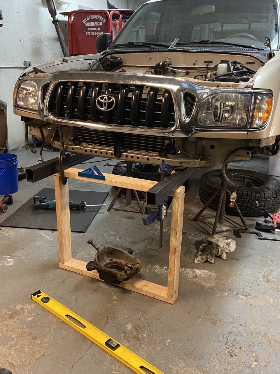

    Got frame done. Just have to reassemble and weld into old rail. Really hard to do this alone. A second person would cut the time down substantially. This truck is ethnic as fU$%! I have a mexican truck, japanese motor, half canadian frame, american axles and I know there is some chinese in too!

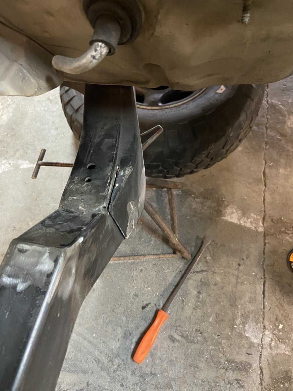

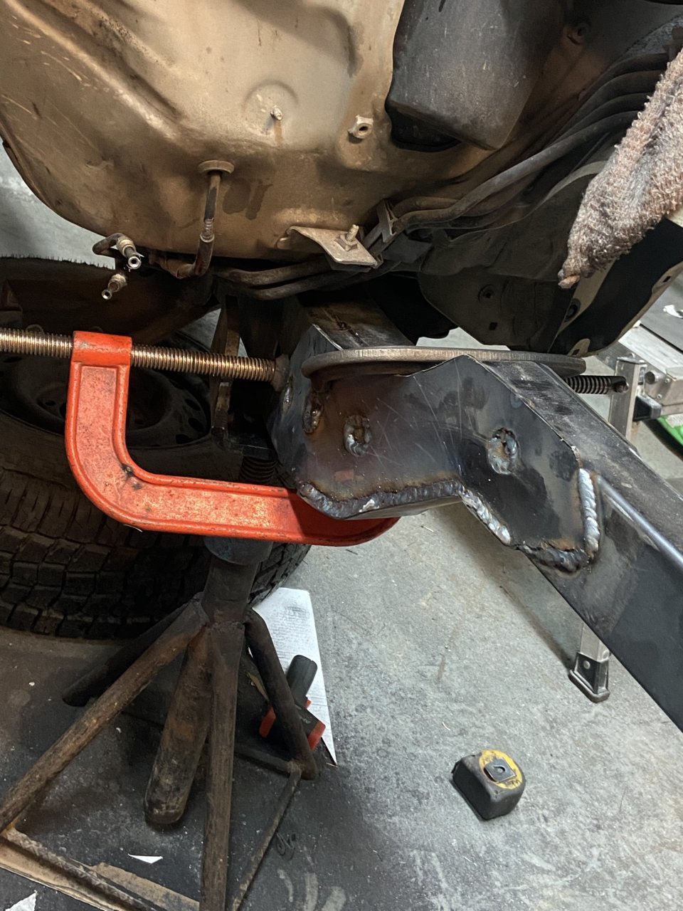

    Welding getting a little better. Got 1/2 of 1 side done today. Lot of work and effort to make it as seamless as possible.
    E8580831-6F48-4C84-8C65-048C9E82FFD4.jpg 291CC62D-B3BA-41F6-AE12-8DB8546CF14B.jpg F9FC2AEF-0F90-44F8-906C-3E1C10F36812.jpg 7F0AB1AE-D75D-416F-8413-8B5988C61992.jpg

    You got any crossmember up front to keep it all straight or did I miss it?

    shit. Yeah haven’t even taken any pics of that. Just 2x3 across all cut flush. Still deciding on a plan for winch. This is from Monday before I cut it flush. You can’t really see.

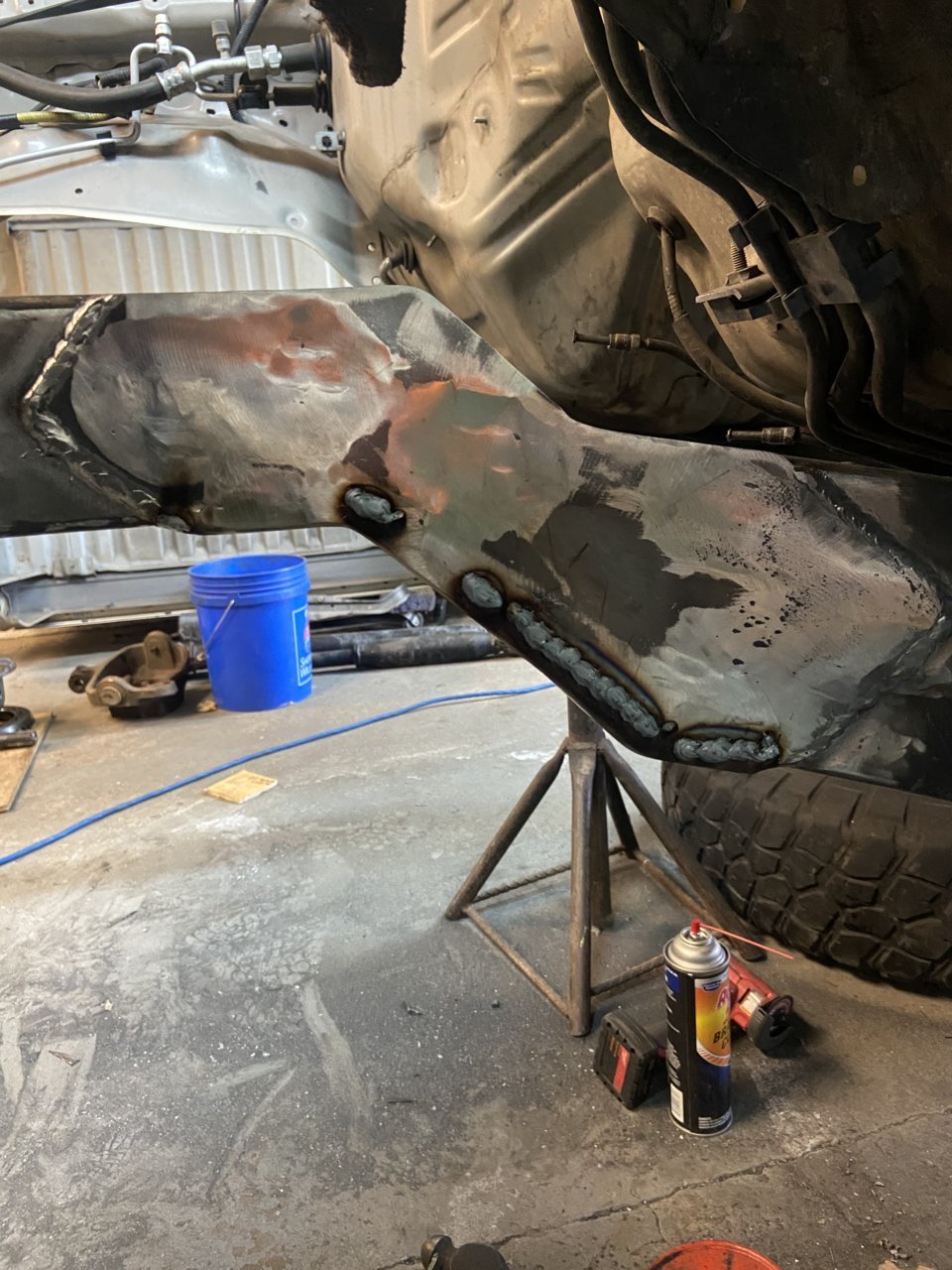

  15. Mar 9, 2022 at 8:17 AM
    #175
    Yota X
    Jul 11, 2019
    #298961
    5,268
    NW New Jersey
    1st gen

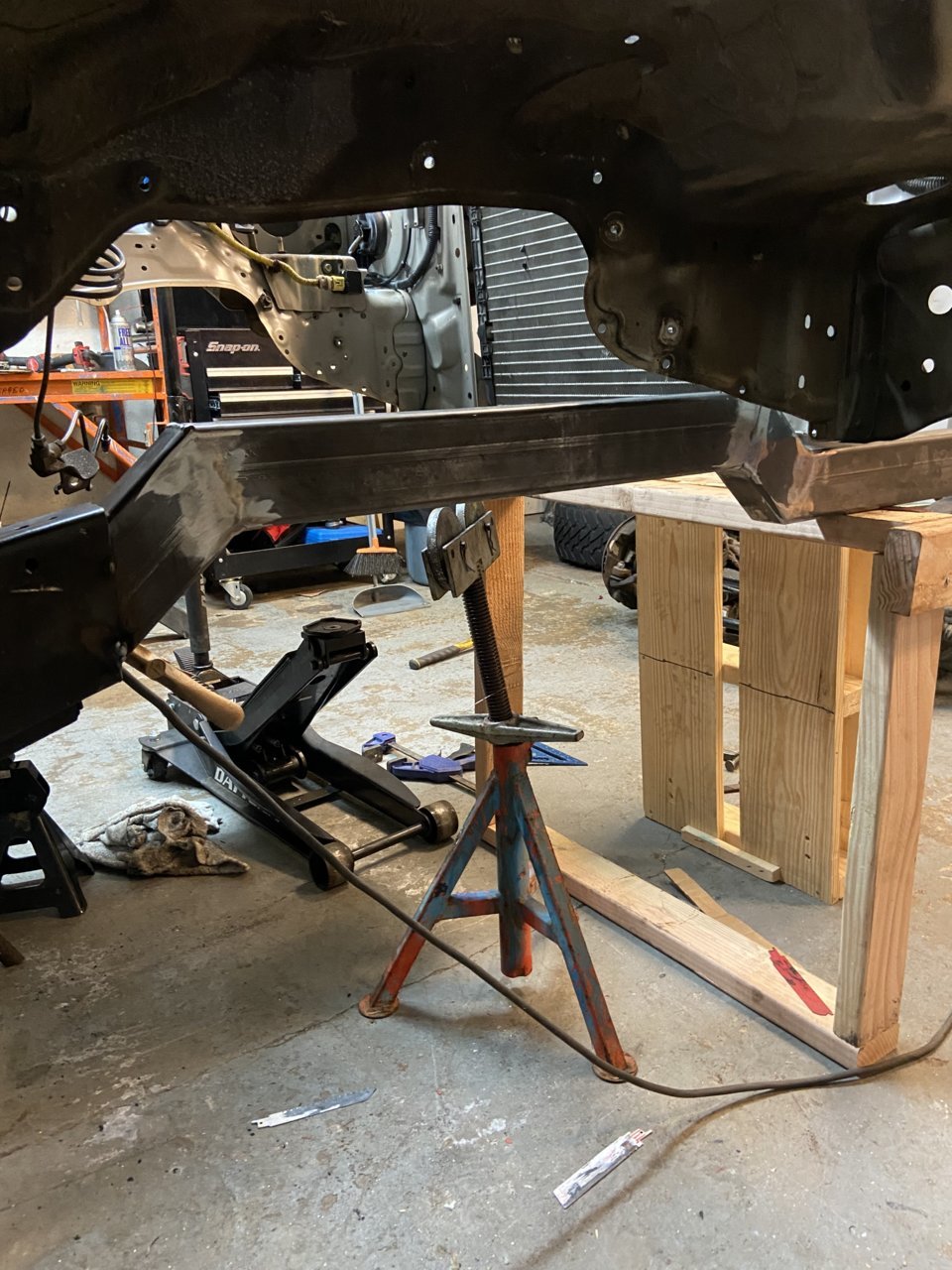

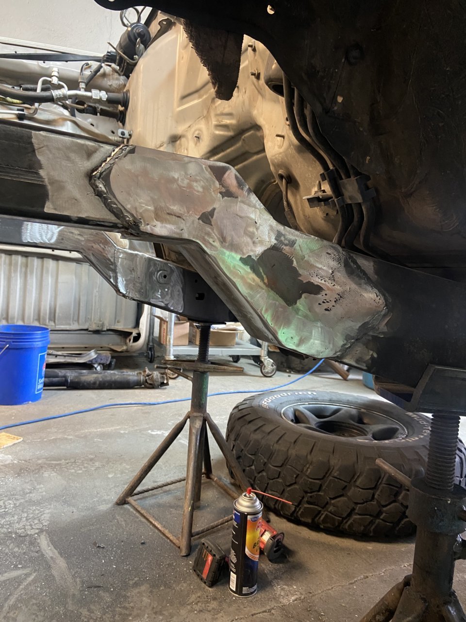

    I prob shouldn’t have done this the way I did but wanted a smooth factory look. Welds rust up here first. Gonna keep the inside plates normal. Welds starting to be presentable. Kinda like the big puddle. Looks kinda cool. Maybe @Kwikvette will approve.
    A97DE940-8986-4F6E-9F9A-25CB4DB5B888.jpg 2B248AE7-A764-4A0D-AF13-93AFCCD70593.jpg 464650D2-F6F1-4C65-9667-C3AB2D5727DB.jpg
    jubei, Coma 13, Slashaar and 4 others like this.
  16. Mar 9, 2022 at 8:24 AM
    #176
    Kwikvette
    Feb 27, 2019
    #284735
    81,587
    Fresno County
    4 run, 2 don't
    That's nice and hot!
    It ain't easy doing that out of position welding that's for sure.

    Cost myself about 8 hrs trying to do this fancy bullshit w plates everywhere and I don’t even like it. I’m kinda pissed at myself that I’m not done yet.
