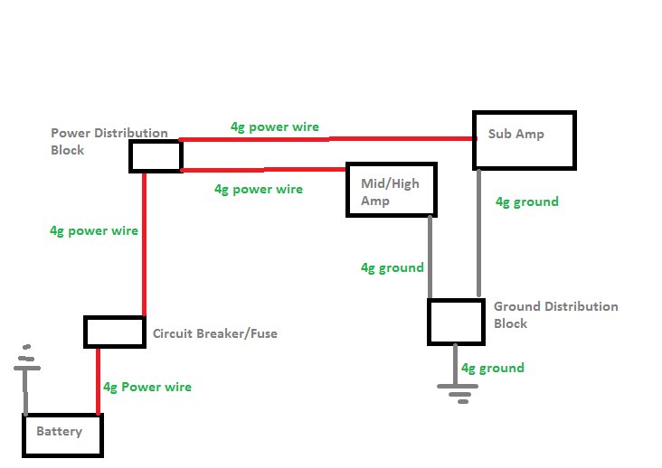

    Good call on ripping it out and starting over. And having mix/matched wires isn't a good thing. People will tell you it doesn't matter but it does. Like you said, some of the shielding on your 4g is much thicker then others. Wire MAKES the install, use crappy wire on high end stuff and it will still sound like shit.
    I'd still look into running 4g to the back, then splitting off with a distribution block. There is no need to run 2 x4g runs from your battery to the amps. I think you have over complicated your install a bit and should back it down and go with the basics. That crappy diagram I made should get you by. Also, good job on doing the Big3, not many people realize how much that makes a difference.
    Most peoples stereo's that I end up troubleshooting has to deal with the ground wire for the amps. Bad grounds can cause ALL sorts of issues with stereo. That JL plug works great.
    Do me a favor and answer these questions so I can help you out better.
    1. What are the model number of your amps/head unit/speakers
    2. are you running all your doors off of your stock wiring or did you run new wire to each door speaker? If you ran new wire what gauge did you run?
    3. List the brands of your 4g power wire if you can. Some of the wire out there is just outright horrible.
    If you run into a major snag or whatever PM me and I'll shoot you my cell number and we can talk over the phone.

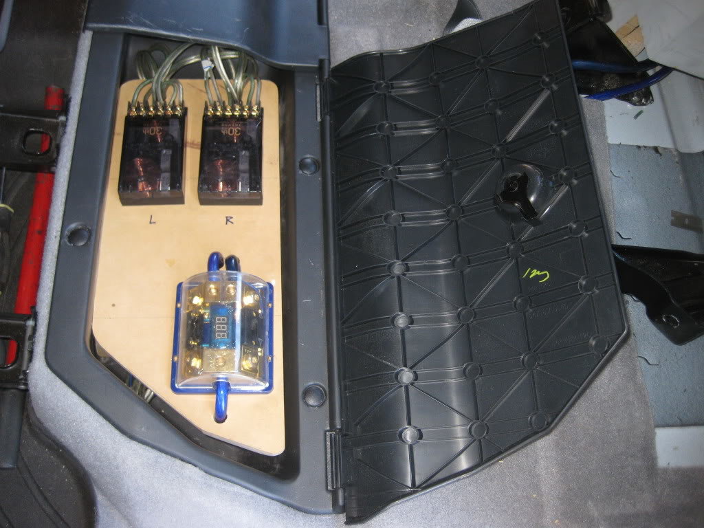

    1.
    H.U. - Pioneer DEH 500UB
    Front Comps - PB S6C
    Rear - OE
    Subs - 10" Hifi Zues HZ 10
    Amps - Sub; USA USX800F, Mids/Highs; Hifi ZXi 4410
    2. All OE
    3. all printing on wires is either too faded or just rubbed off from time. :(
    "I used to have all speed bags with 1inch valves in my 98taco, great setup but it was VERY loud. I like the idea of a smooth/quiet setup."
    NICE! I used to love pissing people off when I pulled up next to them and dumped all the air. lol. Now I guess I'm somewhat more of a creeper.
    attached are the pictures of how I put al the wires and such along with the start up voltage and resting (13.7/13.8 start - 13.5 resting).
