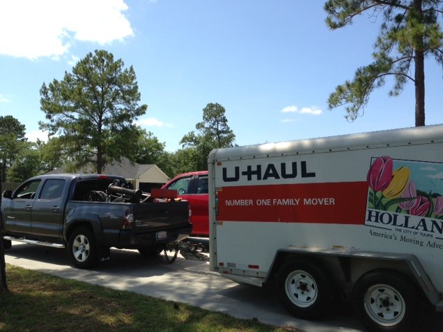

    Towed one of those from central Oklahoma down to southeast Georgia in the middle of summer. Truck drove like a champ. And I'm pretty sure I had the trailer near max weight limitations. I'll see if I can find a pic.

  16. Apr 6, 2015 at 8:46 PM

    This is something I happened to do while on my excursion. I'd drop her down into fourth. :)

    I never said I cooked my tranny. I said I dropped it down into fourth gear...for large hills. Other than that, the truck drove just fine in OD. I just didn't drive it like I stole it.
    And I'd say the trailer, loaded to the point the door would barely close, was a lot higher than 2000lbs.
