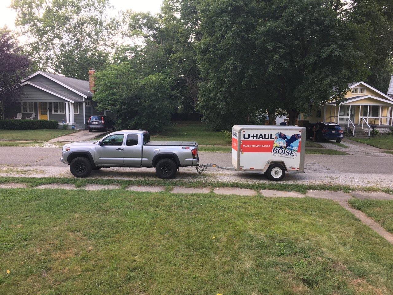

    LongBedOrNoBed
    LongBedOrNoBed M̴̯͖̖̐̀ȩ̶̝̼̓̋͘m̶̗͗ḅ̸̬̈̈́ḛ̶̘͆̿̈͜r̷͇͔͆̾̅
    Apr 30, 2021
    #364364
    77
    '21 2.7 SR SX Access Cab 4X4
    265/75R16 Wildpeak AT3W
    Towed a couple of Uhaul 5x8 with my 2.7 just this month. They're light trailers, so the truck had no issues around town or on the highway at 70, even when loaded. Hitch rating depends on the hitch that you bought for it. Our tow rating is 3,500 pounds, but my hitch rating is for 6,000 pounds.
