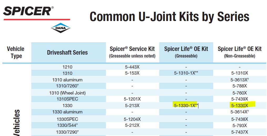

    For the rear I believe it is Dana Spicer 5-1330-1X

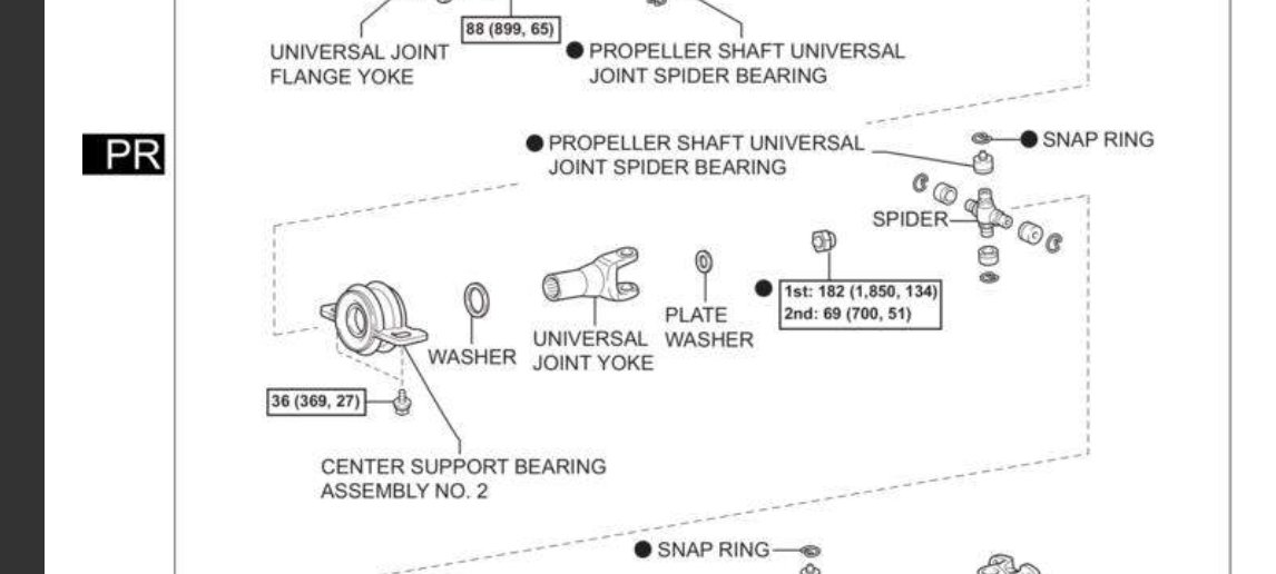

    A head ups on the CB too, make sure you dont miss the washer / shim thing when taking the old CB out. Mine was stuck to the old bearing and I didnt even notice until the driveshaft was back in the truck :rolleyes:

    IIRC, the 5-1330-1X (need 3) are for the rear shaft. The front shaft takes a pair of 5-1331-1X.

    This will be my first time dealing with a CB. Can u explain more about the washer and shim? I have no idea about that

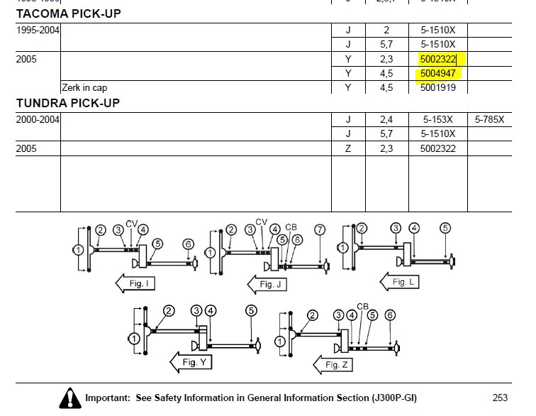

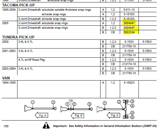

    Thanks for the part numbers but am having a hard time locating 5-1331-1x. Can you confirm that part number?

    Looks like Toyota calls it a washer. Its gets stuck to the grease on the CB. It looked more like a hardened shim to me though

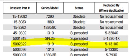

    I am concerned on getting the correct Spicer u joints. Rock auto doesn't show the part numbers 5-1330-1x listed as available for my year model. I wanna be sure I am getting the correct ones for the 2007 model

    I just replaced my rear 3 u joints and carrier bearing on my 12 4.0 4x4 using Spicer 5-213x u joints. Worked great. Add a little additional grease into the u joint caps to help keep the needles in place and use a c-clamp or a vice as much as you can when pressing together. If you cant get the snap ring seated, you've got a needle that's fallen over.

    oh yeah, the 5-213X come with the zerk on the cross instead of the cap. Makes greasing a little tougher but keeps them from getting whacked when going offroad.

    Can you explain the difference in the OSR and the SPL? I don't know what those abbreviations mean. Many thanks for the pics.
