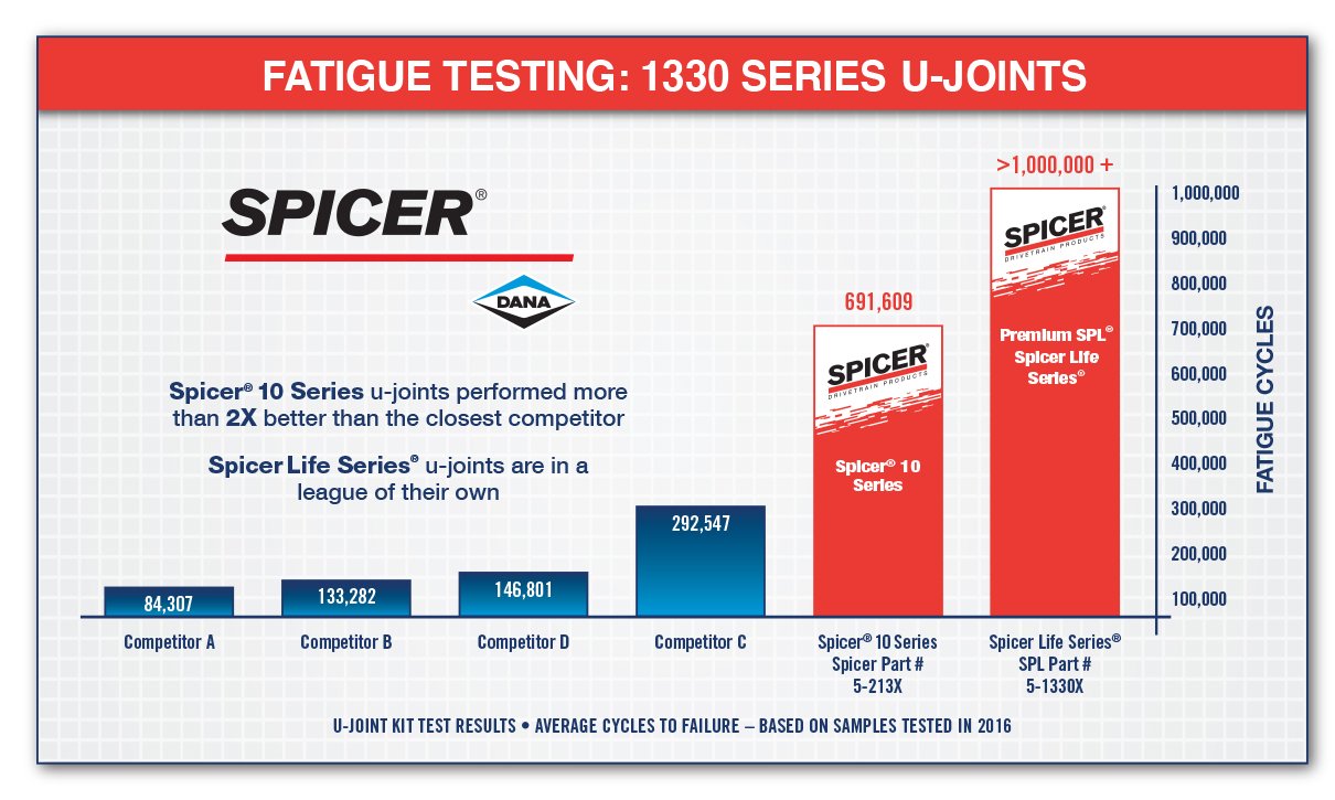

    OSR is outer snap ring it’s how the cap is held in the yoke. As far as the SPL it is the spicer life series joint which is a higher end one compared to their 10 series.

    you will want to make sure you get the correct SPL series with the outer snap ring. They may have the same series with inner which wouldn’t fit the Toyota yokes.

    Correct me if I’m wrong @6 gearT444E but your’e talking inner vs outer locking u-joints. This might help better understand:

    yes what is said below. The yoke for Toyota trucks that we gave utilize the outer snap ring, not inner.
