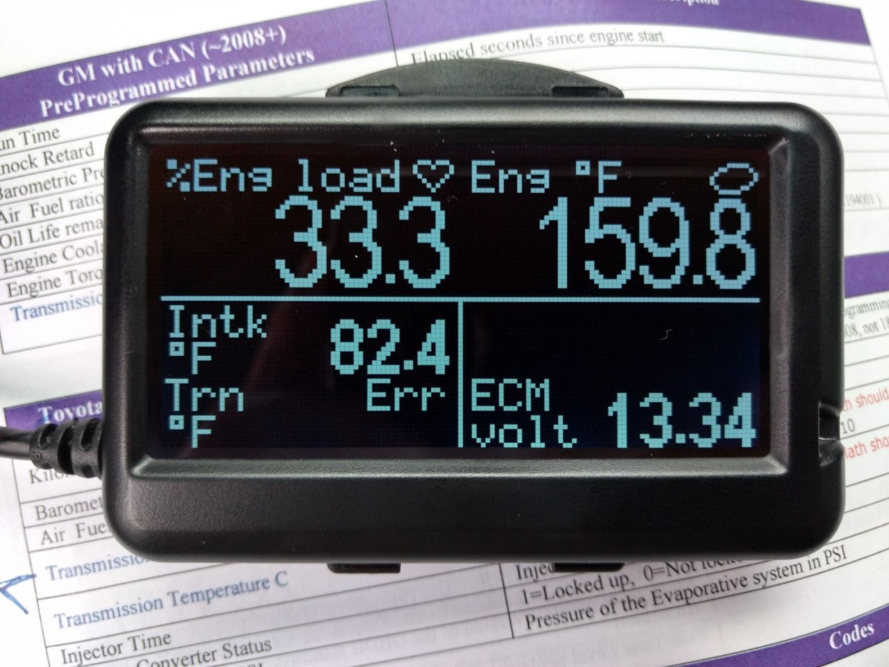

    Ultra gauge trans temp Err on 2011 Tacoma

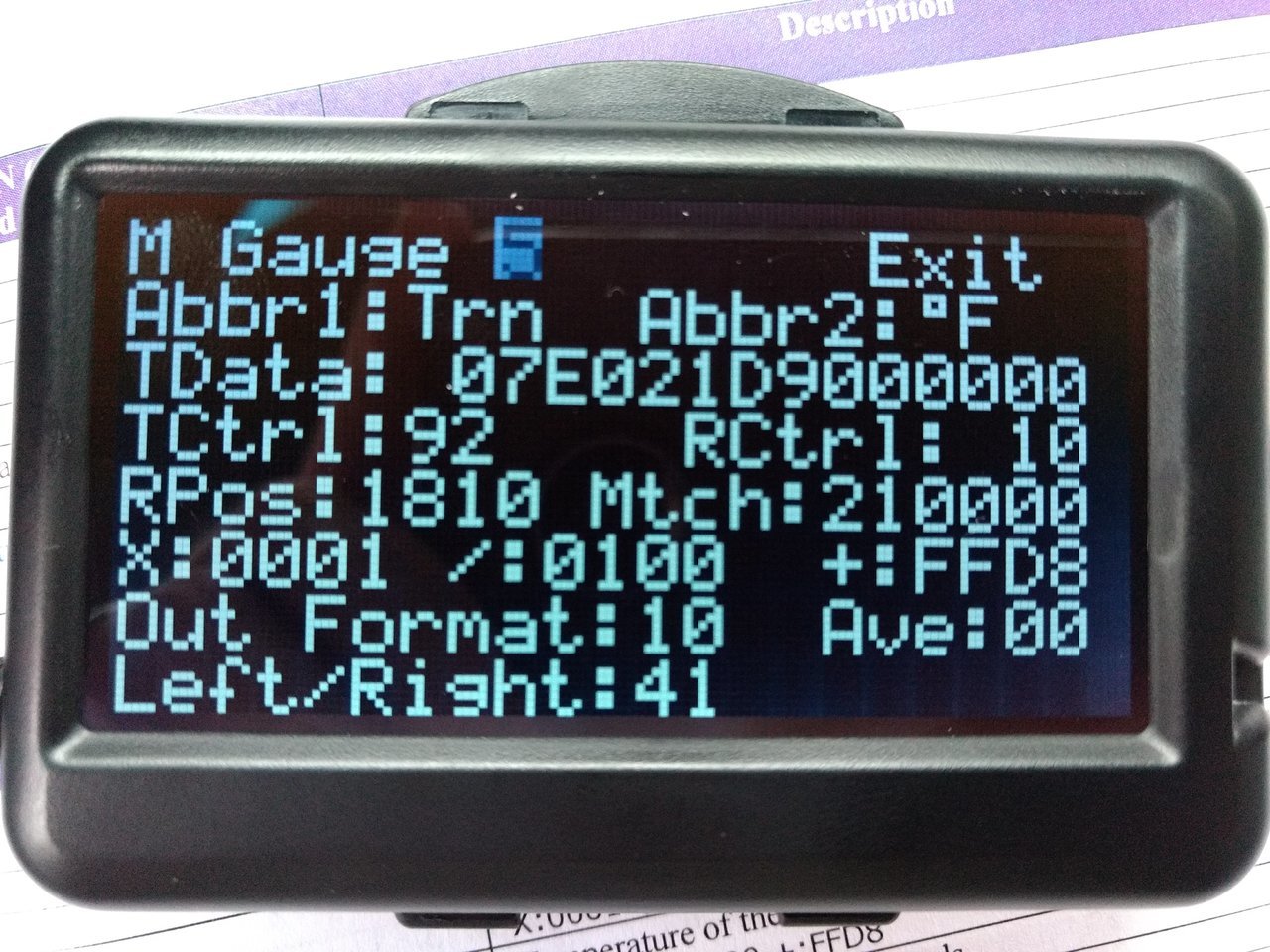

    I just get Err on my trans temp Mgauge. I have the programming set to the corrections per their website and direction.
    Automatic Transimission
    MX1.3 gauge
    Any help available here?

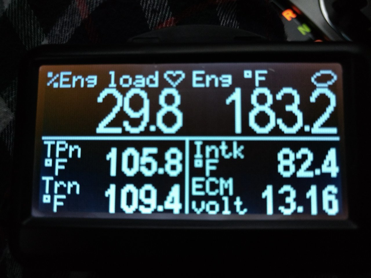

  3. Jan 27, 2018 at 4:18 PM
    blueboxfj60
    blueboxfj60 [OP] Member
    Oct 14, 2016
    #199738
    7
    2012 codes work !!!
    thanks for the quick reply and help
    07 sport 4x4 likes this.
