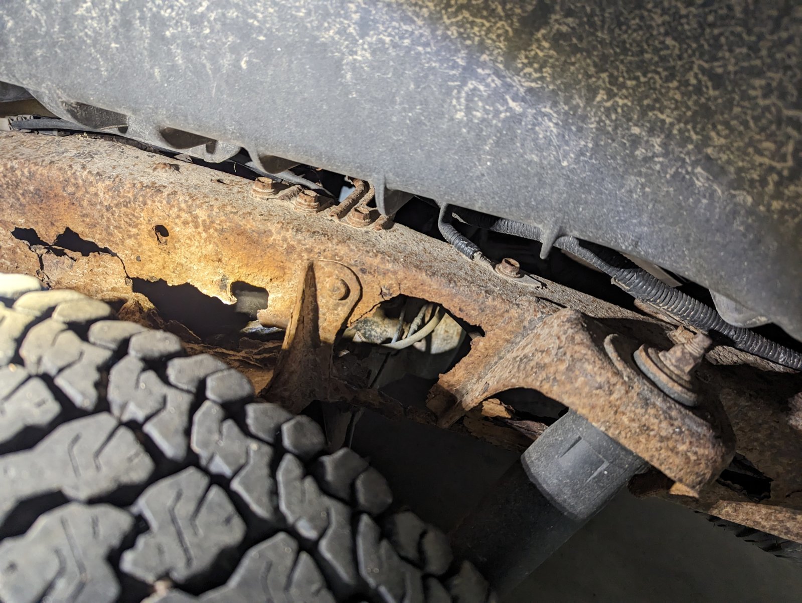

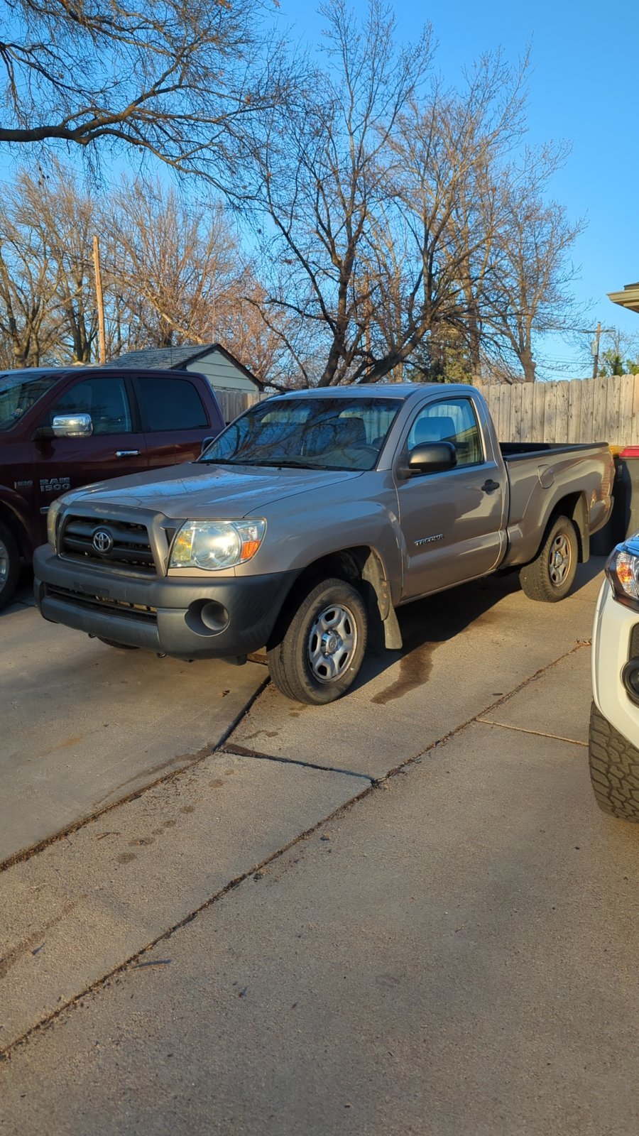

    Bought a 200k mile 5 lug RCLB - farmer was going to crush it (rusted frame), I saw a diamond in the rough needing saved. A few moments of negotiation and I was firing it up to drive it back home to begin the task of restoring/improving upon this basic little Toyota pickup.
    Get it home. Inspections begin. Realize the massive mountain needing climbed to even make it some what road worthy, even for short daily runs around town. Unsafe was putting it nicely.
    Here are some pictures from the day I brought it home. This was back in August of 2023.
    You can see the frame was rotten all the way through - some spots were such large chunks of the frame missing I could put my fist thru the frame.
    Yikes. But I do enjoy a nice challenge...

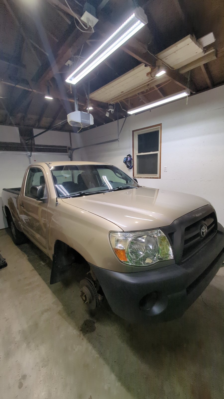

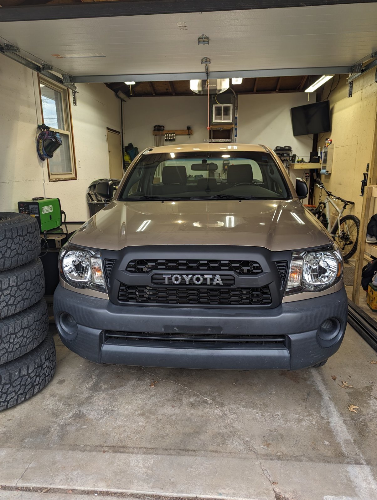

    New front pads and rotors installed. Working on OEM smoked headlights and 100w bulb upgrade w/ harness these next few nights. Should bring some new life to a tired front end.

    Followed the "ultimate 2nd gen headlight upgrade/mod" - new heavy gauge harness/relays, 100w bulbs, and some OEM TRD smoked headlight housings and added a pinch of style with a knock off TRD PRO style grille. Took some mods to get the grille installed how I wanted. The weather stripping they send with the kit to seal against the hood is pretty shit. Already starting to peel away from back of grille. Other than that, I think its nice subtle nod to some of modern TRD stuff Toyota is doing and freshens up this base model front end nicely. Only other thing that bothers me... I now want a new bumper cover or might try some products to bring back the "black" of the original plastic.

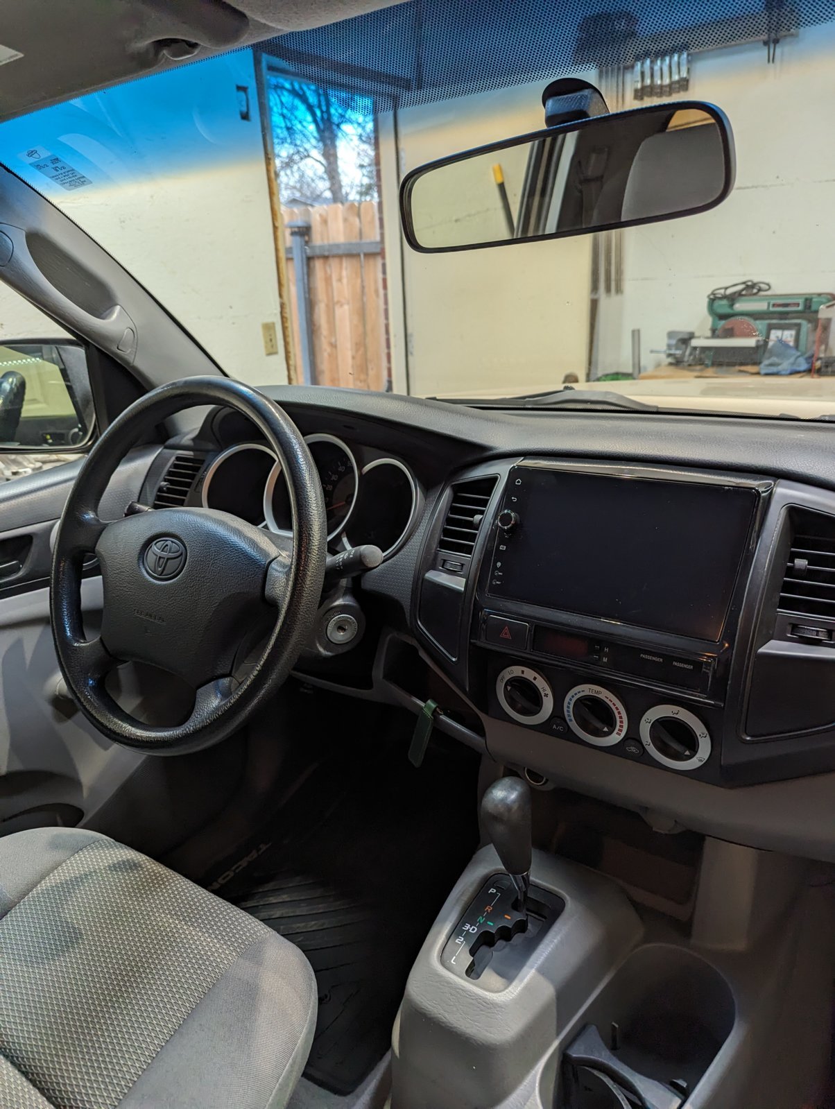

    Next big upgrade to tackle was the Joying Android Auto head unit and some RockFord Fosgate tweeters and door speakers. This was pretty straight forward if you have done car audio - speaker upgrade took some creativity. I wanted to re-use as much of the stock wiring/clips that I could. So there was some cutting, splicing, soldering and heat shrinking to get everything looking OEM. While I was in there, I laid down as much KilMat sound deadening as my hands could inside the doors. They feel nice and solid now when opening/closing, and helps keep the tunes sounding good inside. A few hours each night after work and its all sorted. Also went ahead and got a MasterTailgaters Backup Camera handle and a PopNLock handle. Combine the 2 - you get a nice, OEM type locking tailgate handle with the back up camera. Other than a few hours on my back, carefully running a few wires along the harness with some new split loom and splicing into the rear back up lights to trigger the head unit, I am finally finished today. Boy does my back ache.
    Android auto works well. Takes a few seconds to connect, but the head unit has good power and the audio quality is night and day from the old factory, paper speakers. Backup camera function, if wired correctly, will auto trigger the screen as soon you bump into reverse. These few upgrades are really going to help me not go insane - I am extremely fortunate to be around new Toyotas every day, and some of these more modern features are simply must haves for me. I am satisfied as of today. Time will tell if they stand the test of time and don't cause me headaches down the road.

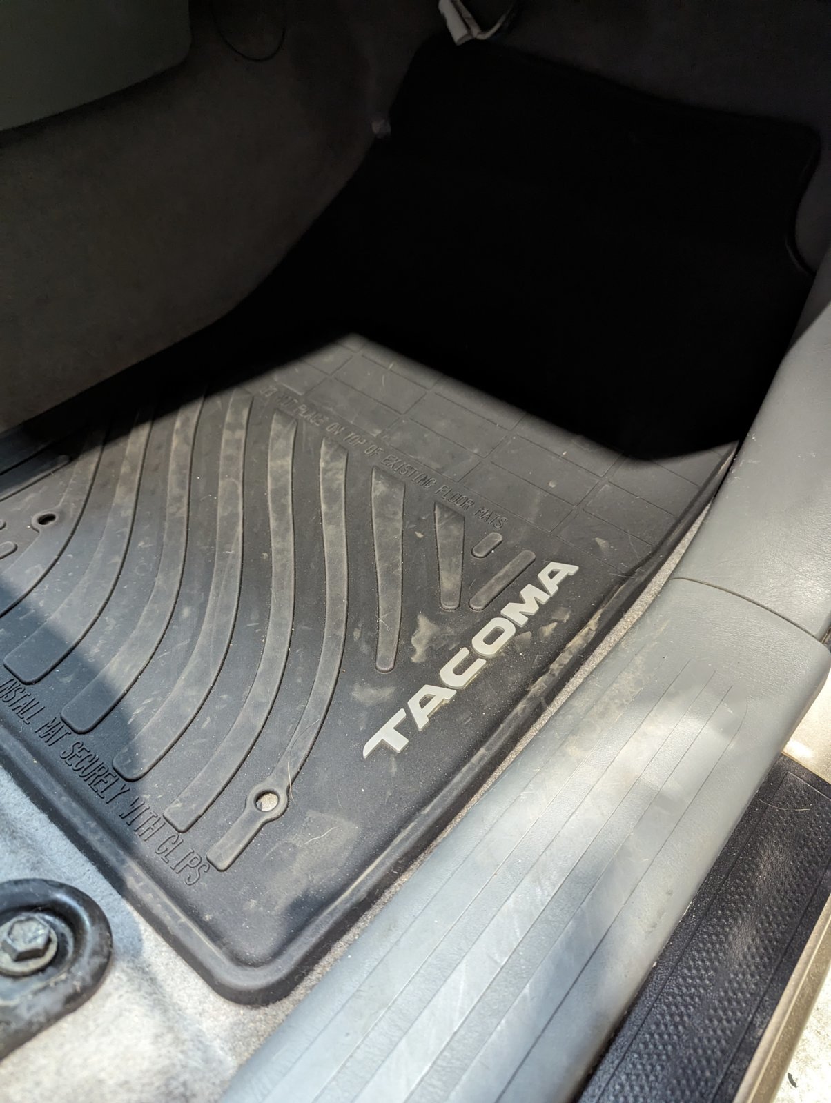

    Bonus: My parts guy at work was able to track down a set of NOS, OEM Tacoma rubber floor mats. Its the cherry on top of a build that I consider some what OEM+ . Shout out my guy for finding something super cool, that he knew I would appreciate the hell out of.

    Been driving it to work full time for about a week. All is well. Wireless android auto is some what annoying for my taste, coming from 5th gen 4runner where its wired even in a 23 model. I opted for a cheap USB port, drilled a hole in the storage tray in front of shifter location, and have gone wired. My headache is gone.

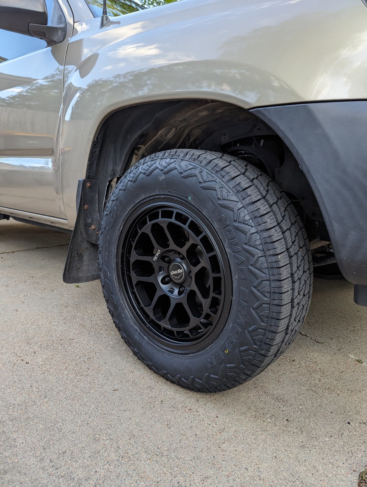

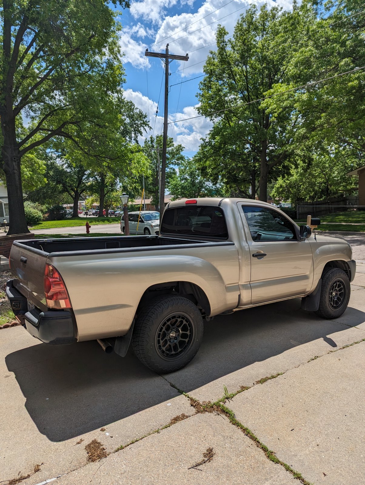

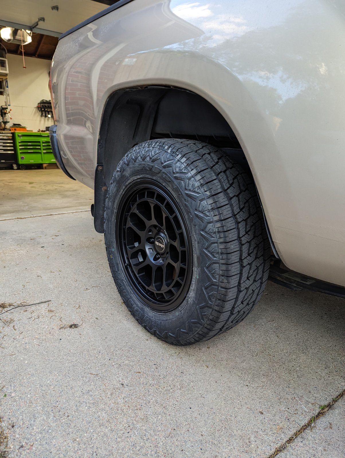

    Tint done, wheels/tire upgrade done. Got a couple hundred miles on the new setup, including a 3 hr round trip of interstate travel. Everything going smooth.
    Just got done in the garage doing new spark plugs and new coil packs. Worth the $200 for peace of mind and a chance at better MPG with fresh plugs.
    PXL_20240522_190140701.jpg PXL_20240510_003001854.jpg PXL_20240510_002954918.jpg
    Reika R30 Drifter 17x8 +20mm offset wrapped in 235/65/17 Nitto Nomad Grappler. 1st time going with this tire, and so far enjoying them. Good AT look, with a more on road tread. See how they hold up over time.
    For now, that is it. Im daily driving it with zero issue and will continue to tinker as I see necessary. But its basically new again other than engine/trans/driveline. Still trying to find a deal on a nice tonneau or topper color matched.
