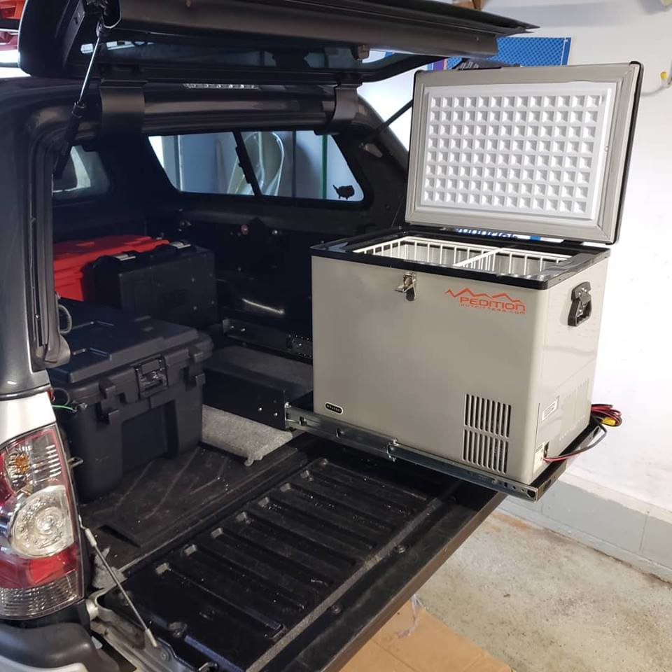

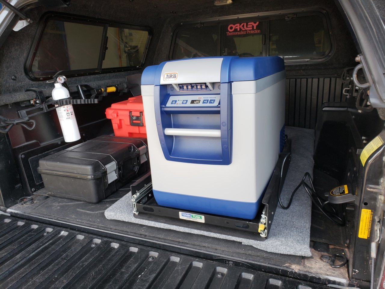

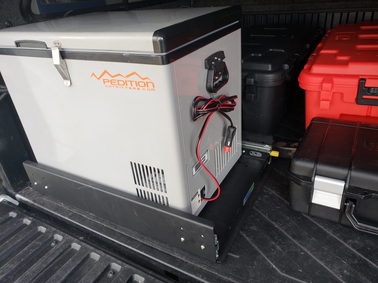

    Not mounted or installed yet. Whynter 45 fridge / freezer which I purchased from a forum member. We did the exchange at ok4wd in NJ so I took a look around and found a tembo tusk slide on clearance. Total fridge and slide investment was $525.

    Mounted up.

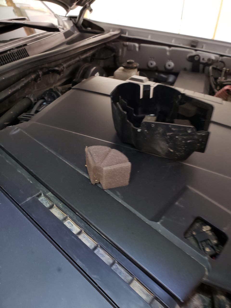

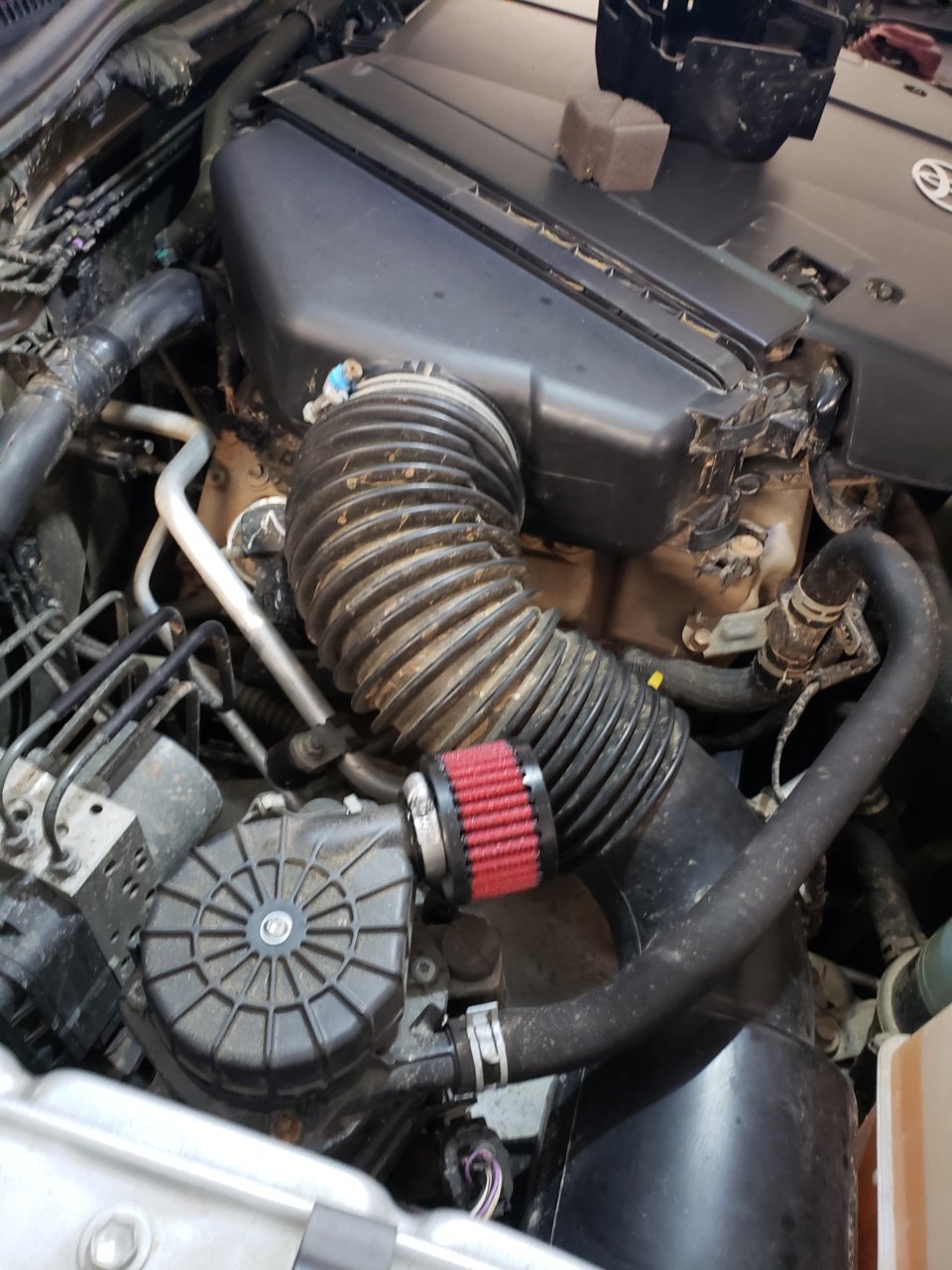

    Did uni filter also. 96000 miles and the foam was still in perfect condition though.

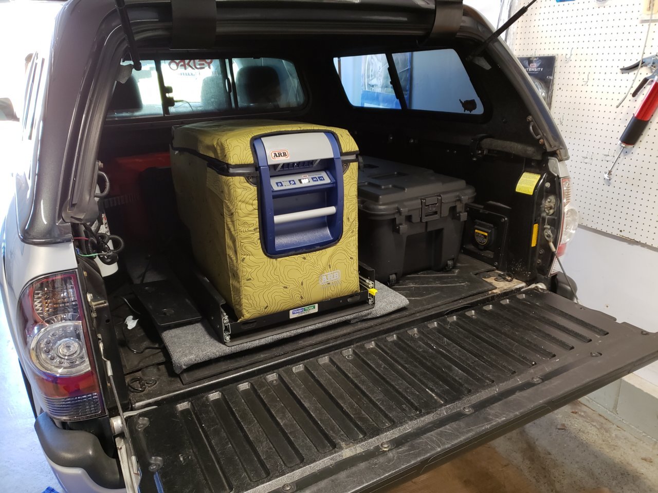

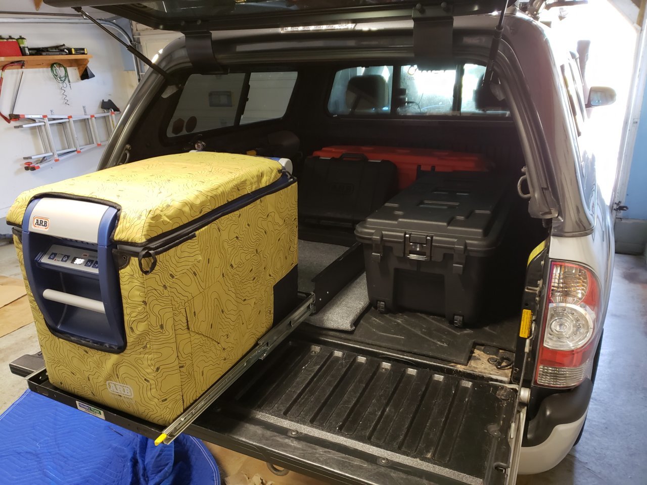

    Upgraded the fridge today..

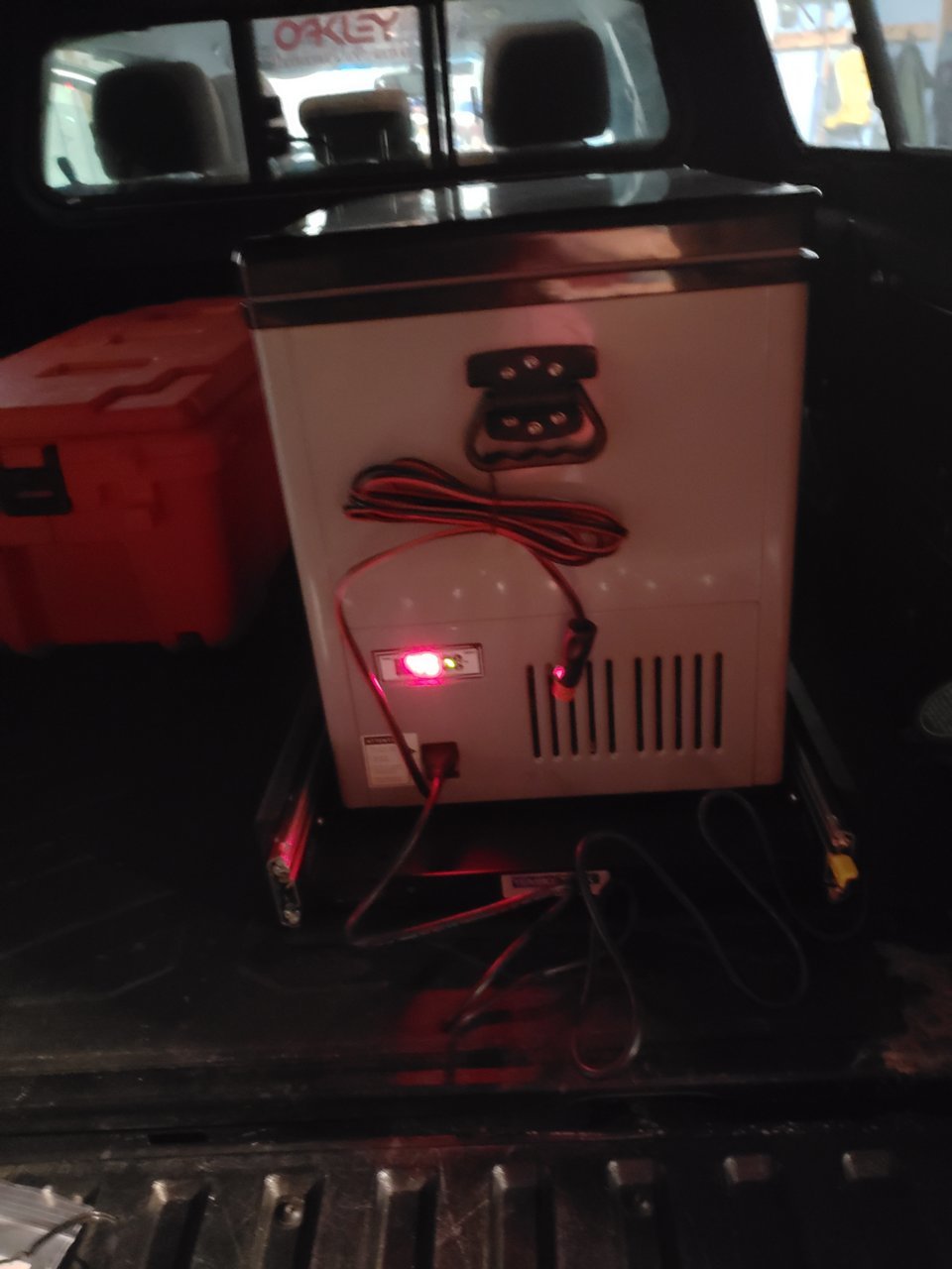

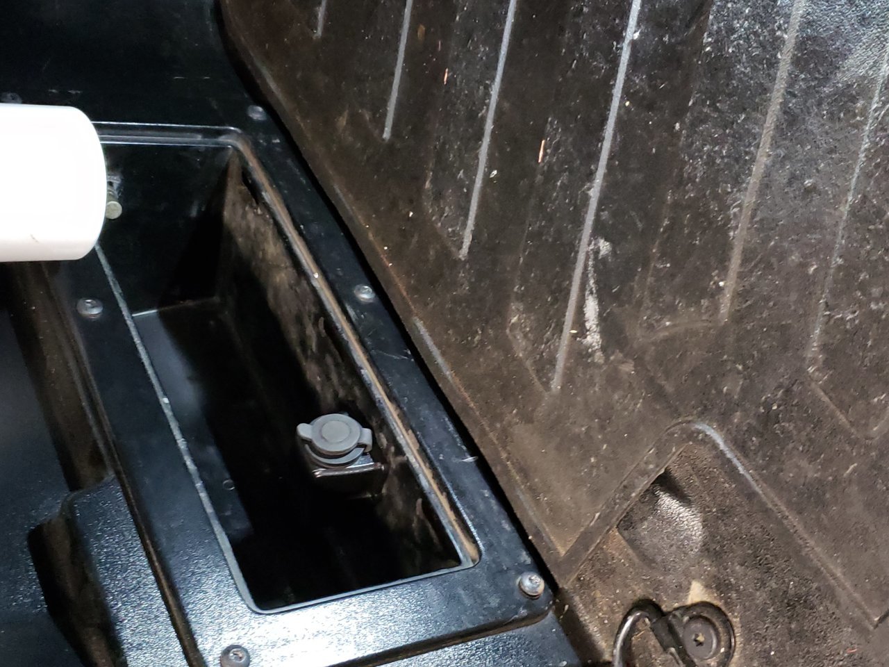

    Took some time to wire the fridge the right way today. After 4 hours and 3 trips to Home Depot I was good to go. Most time was spend trying to figure out how to route the wire from the battery to the back of the truck. I wanted to avoid the cat which is directly in the path of the wire run. I was able to run along the top of the frame which is also shielded by a heat shield.
    This is about a $1700 setup for everything before taxes. I ended up paying about 900 and change for it all. Just like with most everything else on the truck, I got a good deal on piecing everything together and saved myself about 850 bucks.
    I decided to hide the plug in the cubby hole since I don't use it for much and it would be out of the way. I also wanted to avoid knocking it off when loaded the truck. I used the ARB wiring loom.
    I was having an issue getting power to it using the right angle connectors they provide, so I went to home depot and got blade female connectors which are already insulated and used those. Much better than what ARB gives IMO. And after about 4 hours of trips to the store and back and forth thinking we've got power.

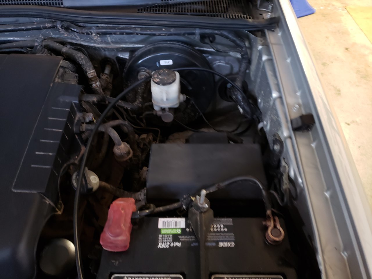

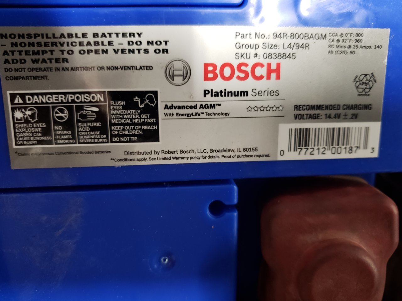

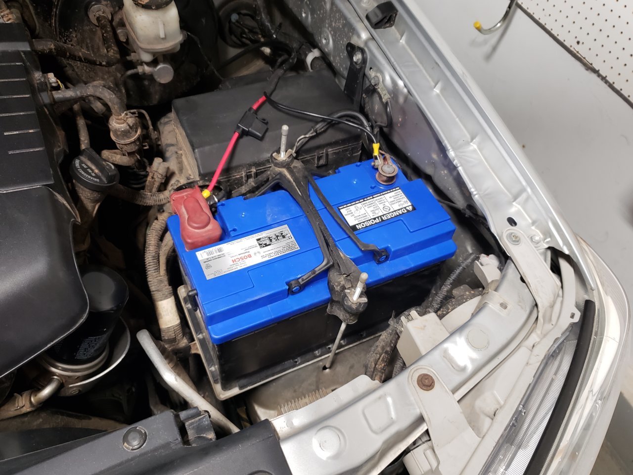

    Picked up a Bosch 94R AGM battery for the fridge today. Got a good price and has 80AH. Fits perfectly to replace the 27F.

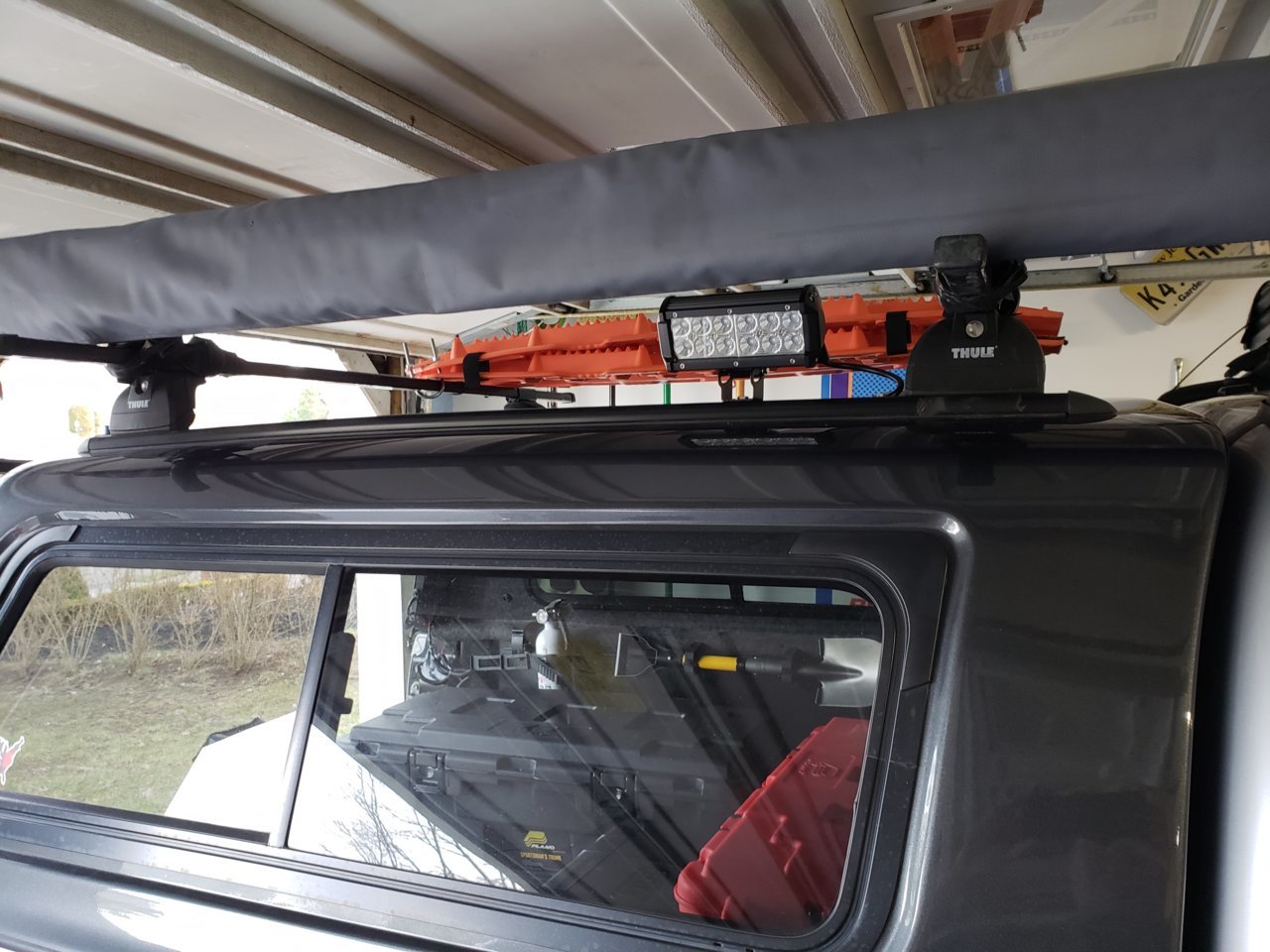

    Sweet build! What size awning do you have? Looks like the perfect width for the OEM roof rack
  17. Mar 3, 2019 at 1:06 PM
    #237
    diabetiktaco
    diabetiktaco [OP] Instalander
    Sep 5, 2016
    #196480
    5,738
    Eric
    New Jersey
    2022 GX460
    Thanks! In the later pics ita a 6'. The early pics it's a 4'.

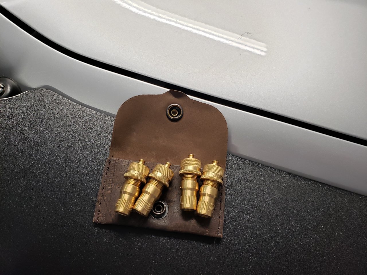

    Setup staun tire deflators today which is awesome. Super excited to use these..
    Pixel isn't a fan of leaking air sounds. Using ARB tire deflator to set PSI to 15.

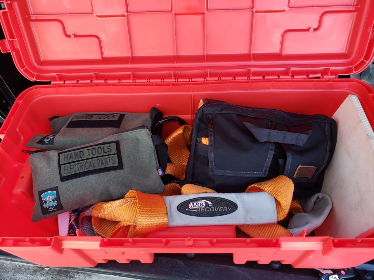

    Also took a shot of recovery tote inside..until I decide to spend $1000 on drawers or make them myself the totes will have to do. I've got three totes. 1. Recovery gear / tools. 2. Emergency equipment (MRE's, water, blankets, etc. 3. Cooking stuff. Stove, utensils, pans, etc. ) In here we've got spare fuses, connectors, and wiring, BROG air tool bag, Adventure tool company shop roll with tools, arb strap, 1/2" wood to jack from in sand, gloves, and misc spare parts.
