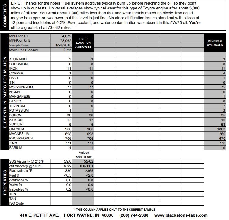

    All this debate on oil around the forum. Just stick with Mobil 1 and OE filters.

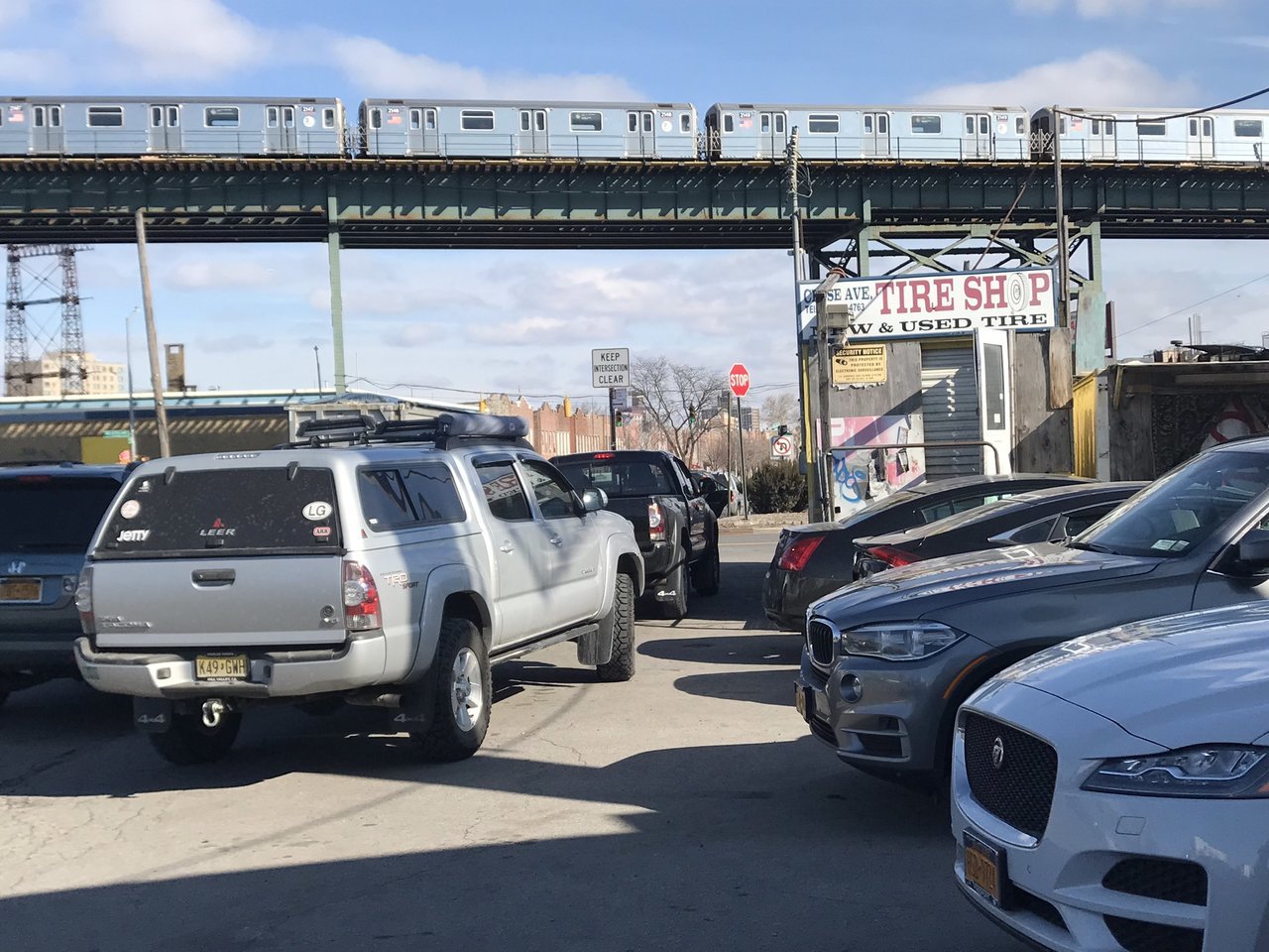

    Truck always looks out of place in the Bronx.

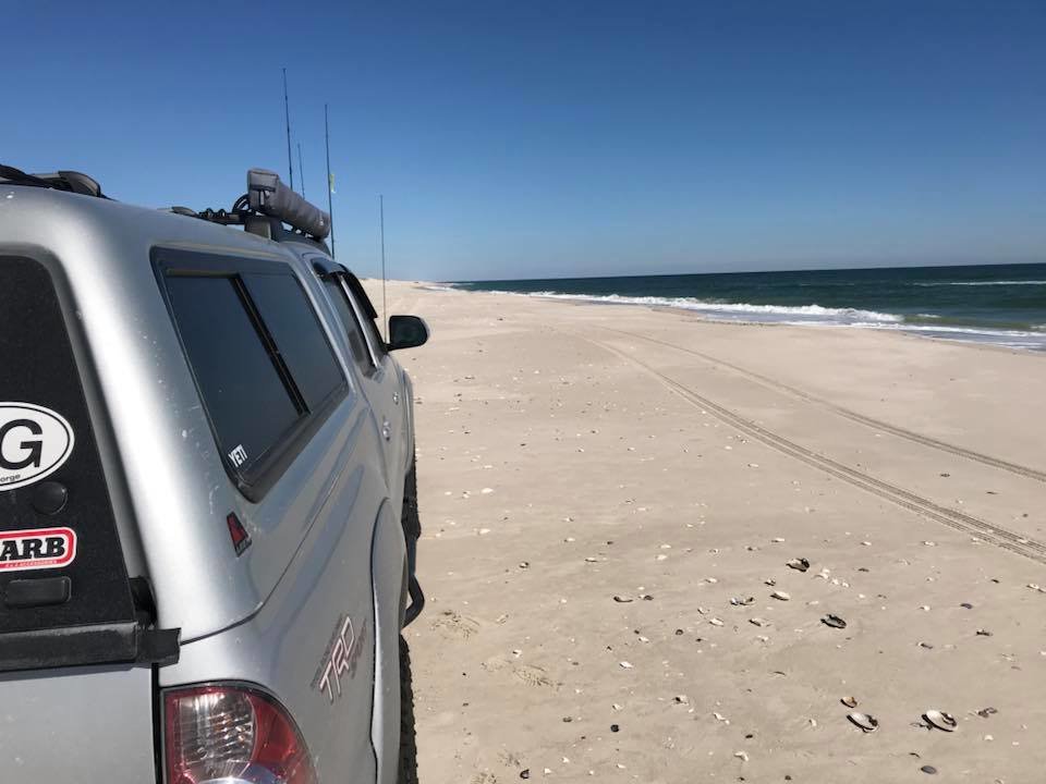

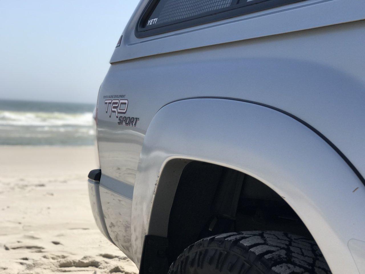

    Just some pics from last weekend.

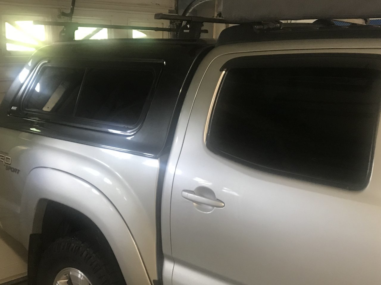

    Went a different route. Instead of installing cross bars I just bought a cap that had them. It’ll be painted to match at some point. Thanks @Tatts521 for a good price on the cap.

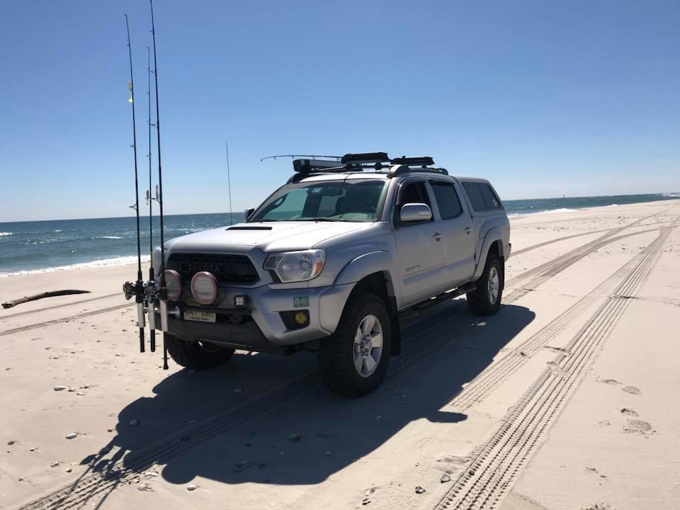

    Took this pic for something else and realized I was able to get all my electronics in at once.
