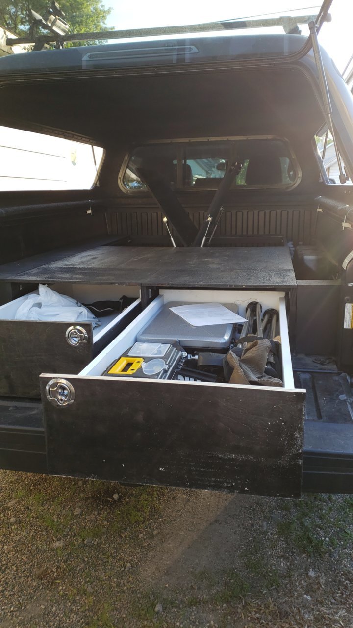

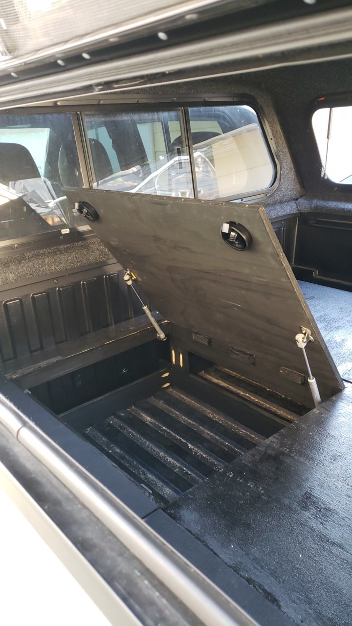

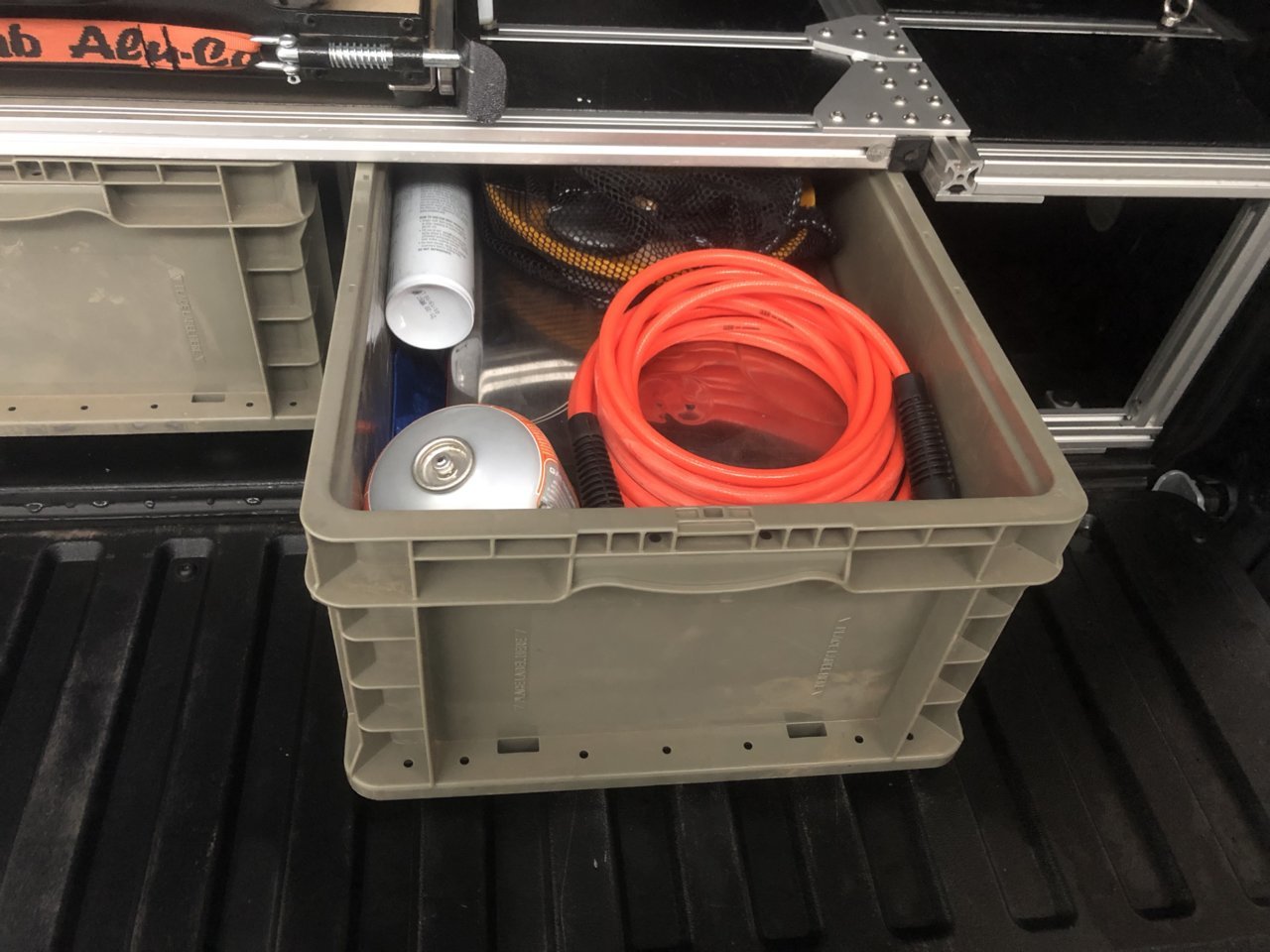

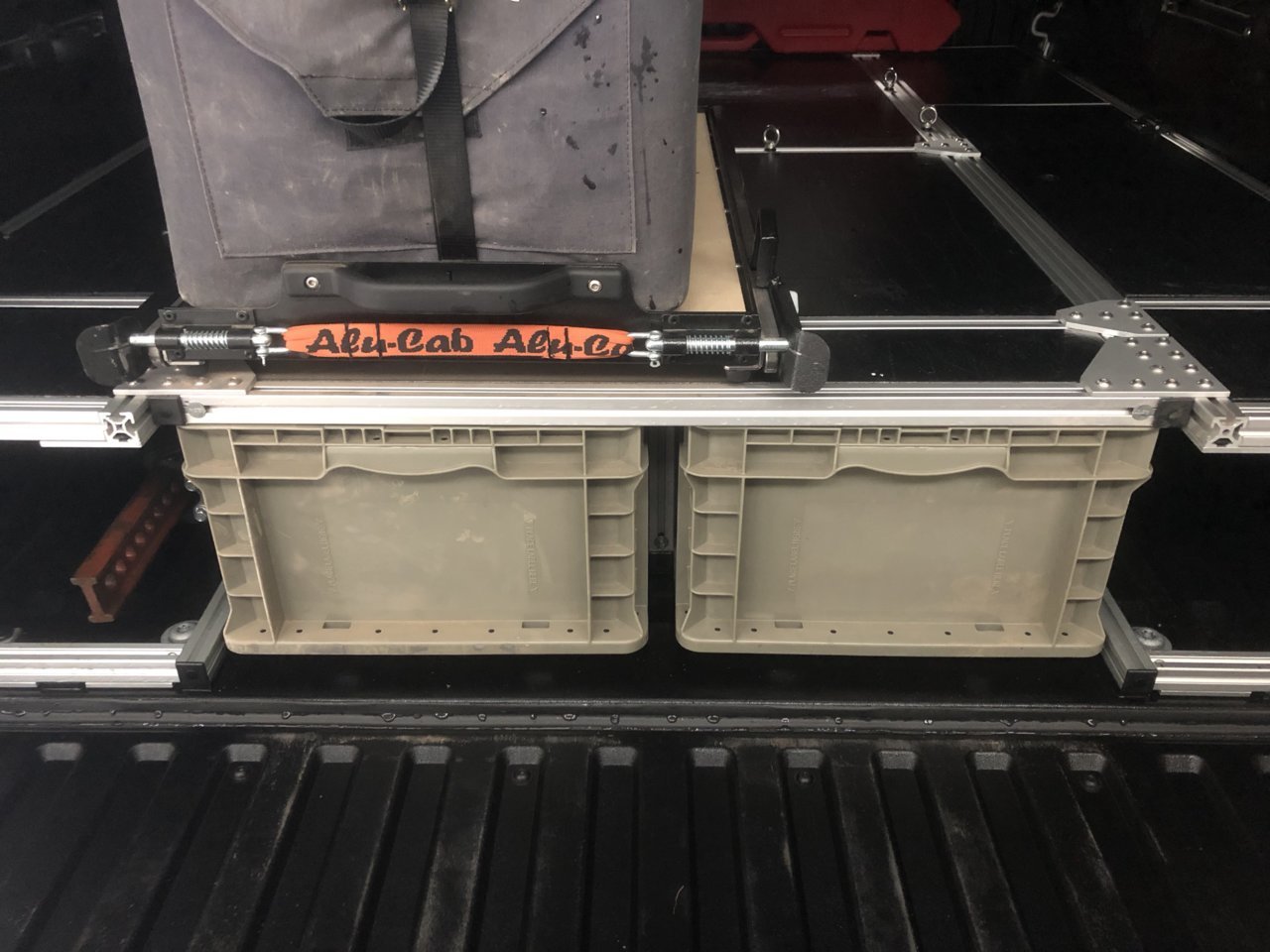

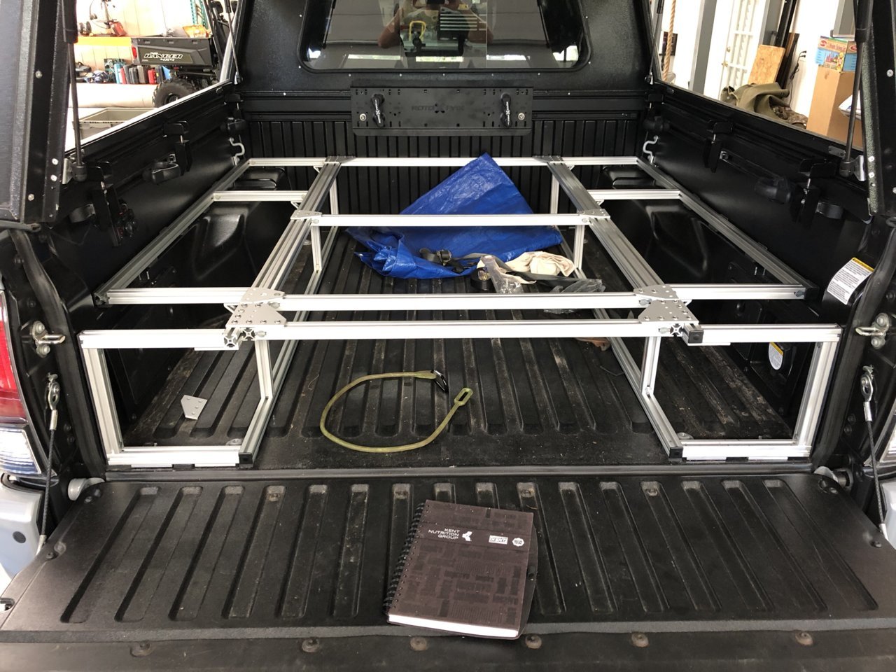

    None of the options on the market thrilled me, especially for the price.
    I had a checklist I wanted to mark for all of the things I expected of the system, and after much thought and way more work than I had planned...I got it all successfully accomplished.

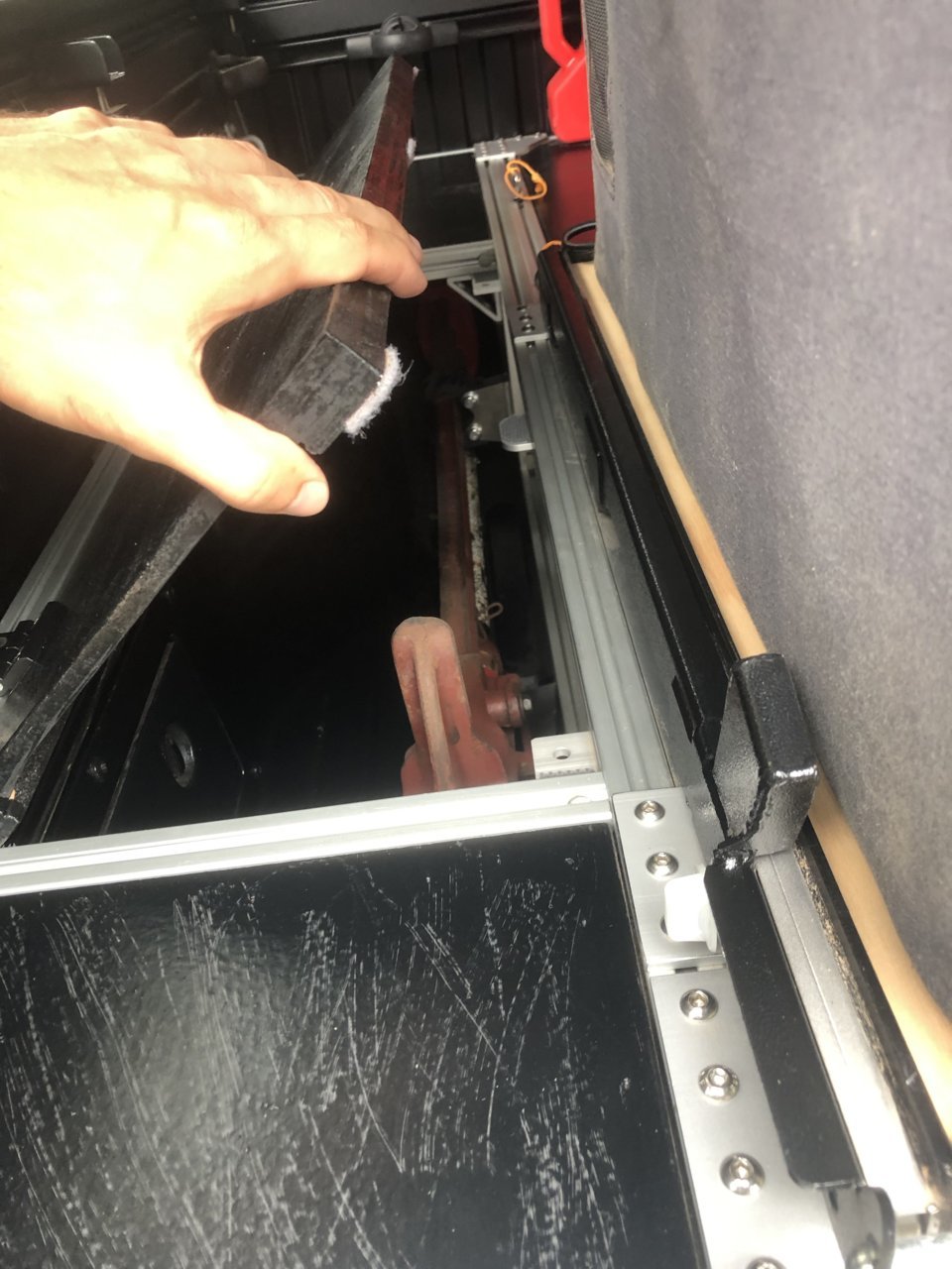

    Light Weight: Check- Significantly less weight than other market offerings.
    Modular: Check- I can run with or without the bins installed. I can run without the entire middle section, which enables me to do much more without taking out entire system. I could run a single side as well if I decided.
    Carries Hi Lift: Check- Rock solid mounts, and it's out of the way.
    No modifications to truck bed: Check- bolts in with factory bolts.
    Easy removal and install: 6 bolts total (Rock Solid)
    Nearly endless tie down options: check
    Off the shelf parts: almost check... Everything is available from 8020 (some parts were modified) except the panels, I ended up doing those out of marine ply (best thing for the job). The bins are Euro boxes, available in a few places, I have 6 bins that all nest snugly into space. The price point overall was a bit more than I was hoping, but significantly less than the other market offerings (which didn't thrill me anyhow.)

    Have you had an opportunity top take it out for an adventure since the build? Or is it something you find yourself interacting with on a daily basis?
    You mentioned the middle section being removable. I really appreciate the versatility of having that option. Have you done so, is so what time of disassembly time are you facing (approximately)? Lots of small hardware?

    It’s seen a few camping and hunting trips along with the daily chores. My buddy borrowed it for a pretty extensive off road trip. SOLID
    This is not the first drawer system I have made, a ridiculous amount of planning went into this system. Having lived with it for a while there is still not anything I would change. For what I use it for, it’s great.
    It’s a 3-5 minute procedure to remove or install the middle section.
