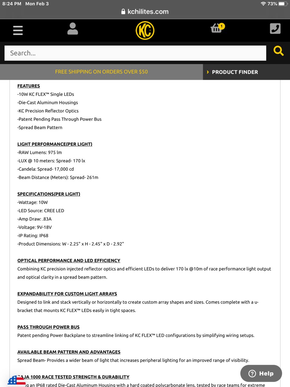

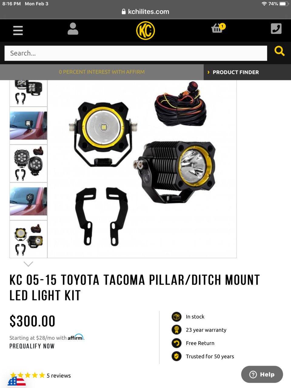

    @crashnburn80 . What are your thoughts on these KC pod type lights . Thinking about adding ditch lights ? Thanks ....... if I should post this someplace else let me know :oops:0F1BCB8F-C688-4FBE-A7DF-9475FA93F38B.jpg4C0E5DAC-217E-45B6-8BFB-1557A8A31B71.jpg

    For ditch lights, I like the KC Flex you have listed or Baja’s new S1. Both for compact form factor over a full size pod.
    https://www.bajadesigns.com/products/S1-Wide-Cornering-LEDs.asp
    The Baja’s spec higher raw output and more power, though the KCs optics are more efficient. The Bajas are also slightly better color temp spec at 5000k vs the Flex at 5500k IIRC.

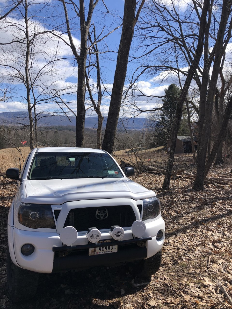

    @crashnburn80 sorry to bother you again :oops: I went with Baja Designs Squadron -R Sport lights in driving combo was thinking about mounting them behind the grill . Any idea as where to get a mounting bracket for this kind of set up ? I did purchase Cali-Raised ditch brackets but I might get a set of S2s for those . Looking to ditch my current light set up . Thanks for your help :thumbsup:599C2B7F-5F09-4A78-B924-4D763C799F92.jpg

    Bay Area Metal Fab makes one. I have it and plan on using it for some KC Pro6s.
    http://bayareametalfab.3dcartstores.com/Tacoma-Behind-The-Grille-Light-Bar-bracket-05-to-20_p_9.html
    For your ditch lights you might consider the new S1 instead, almost as bright as the current older S2 and smaller form factor.

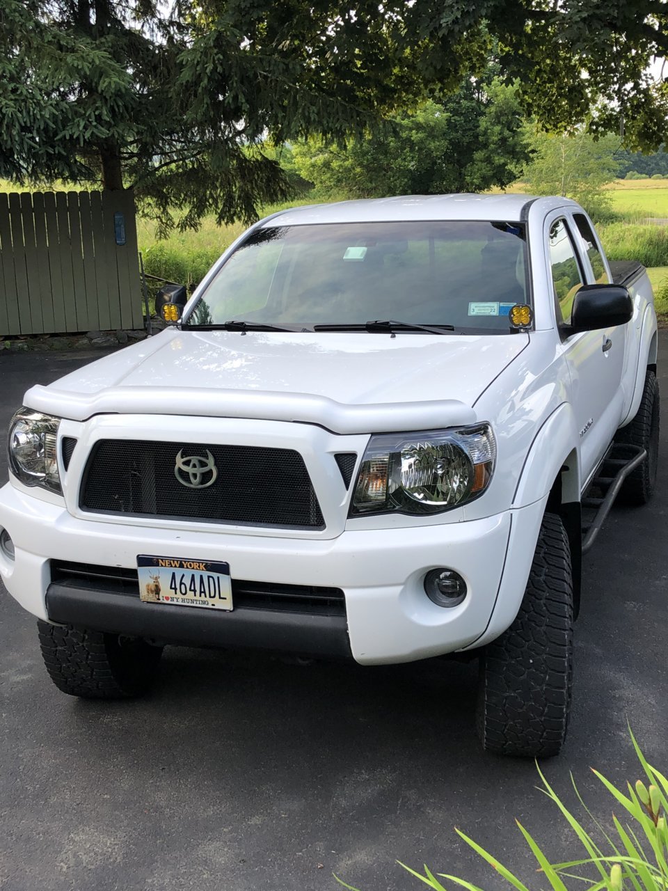

    upload_2020-9-14_6-24-21.jpgupload_2020-9-14_6-24-21.jpgwent with OEM Sport Smoked headlights and a PIAA night tech bulbs

    do you have the Morimoto Fogs and if so how do you like them? Any pics of their light output at night?

    I have the KC G4's in my fogs, and if you read his reviews on aftermarket fogs. The Morimoto's weren't that great.

    BAMF does make a sweet bracket for behind that nice open grille.

    Oh ok, they look very close to OEM style so i may take a look at those. I didnt see the KC light sticker or tag on the front in your picture which made me think they were morimoto. Just looked at them again in the fog thread. They do look good. Thanks
