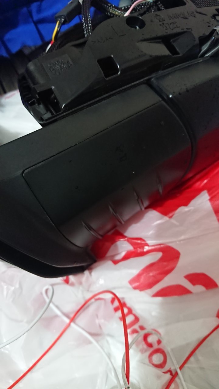

    Does anyone know have tips on how to remove the bottom plastic cover on the mirror?
    Can't route the wiring through with the cover in the way.

    You shouldn't have to completely remove it. Just drop corner down to install module. Wire will go in upper section and through door.

    I'm at the part of wiring the red and white wires through the assembly.
    There is the small bottom plastic cover at the joint between the mirror and the truck.
    I was able to get the wires through though.
    By fishing the white wire, taping the red wire to it, and using tweezers to pull them all the way through.

    Still curious on how to open it though.
    My curiosity might end up with me breaking something though...

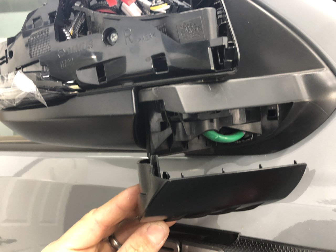

    Fold the mirror in, take a small flat head and pry at the seam of the plastic. It pops right off

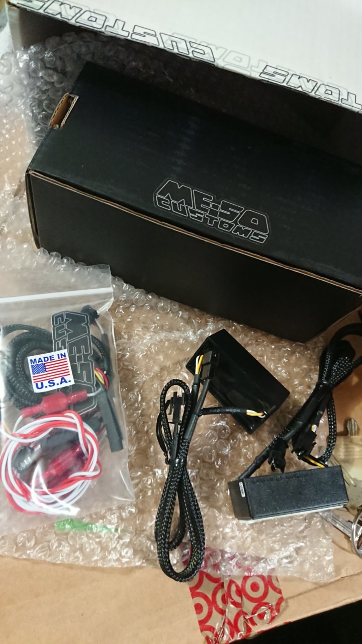

    I have also noticed, I did not get the wire taps/splice together in my packaging.

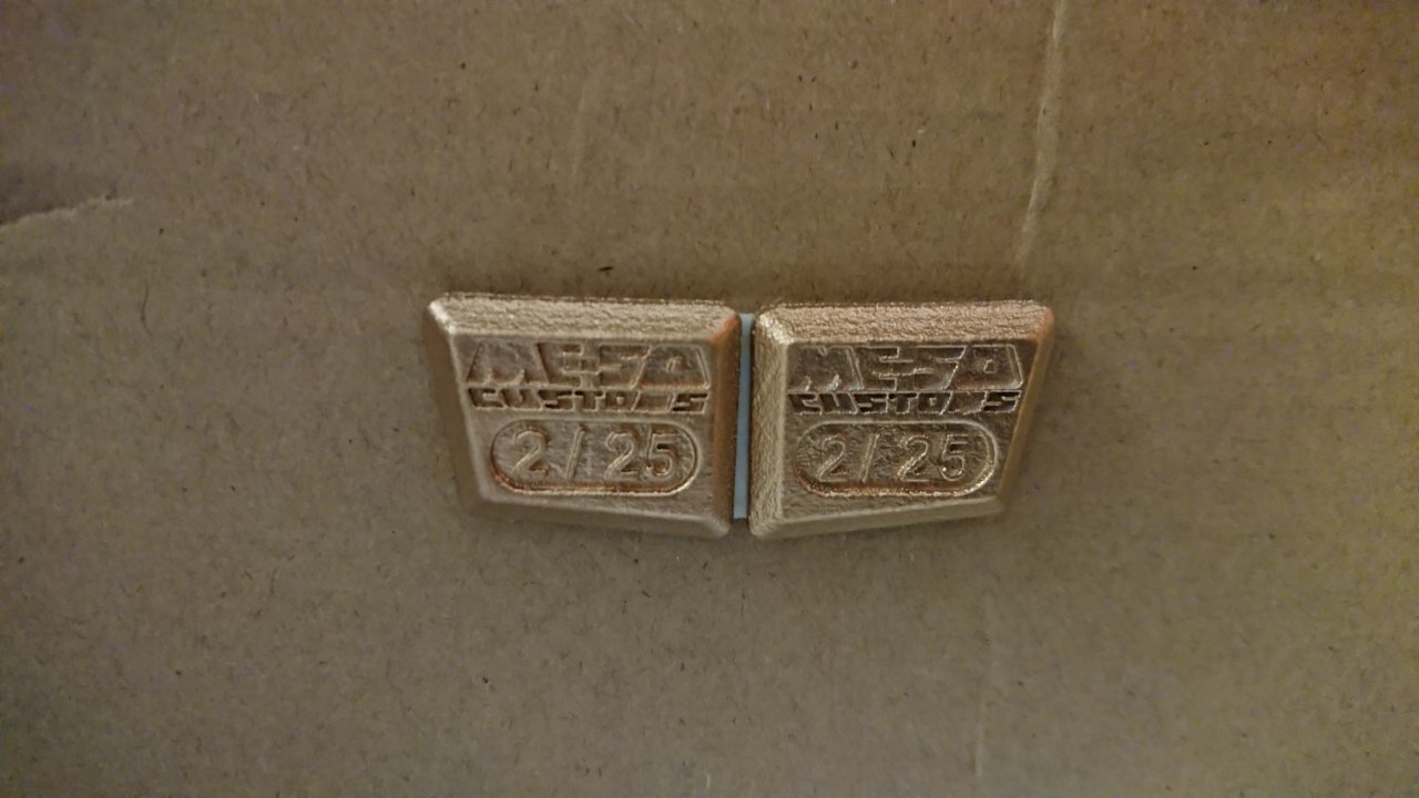

    I was order 3095 like you said but my badges are #8. I’m thinking it’s just random
    I was hoping for #1 (or #2 since that cement pro was probably #1)

    This is correct. I boxed all the lights up, then just pulled them randomly when shipping.

    I put a knife inside next to the little hole and pulled up. Easily works.
