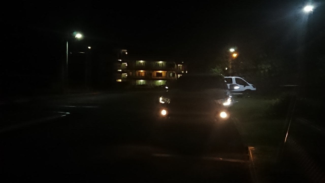

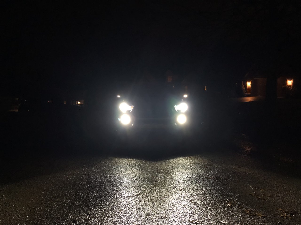

    I have mine set to be full bright and turns on and off with dash illumination.
    Only positapped the red wire, for blindingly bright drls.
    I wonder if we can just connect the white for dim drls, instead of using full brights.
    Not a really clear pic, but this was shot was after a remote start.DSC_0110.jpg
    My install pic also has a better image of it.

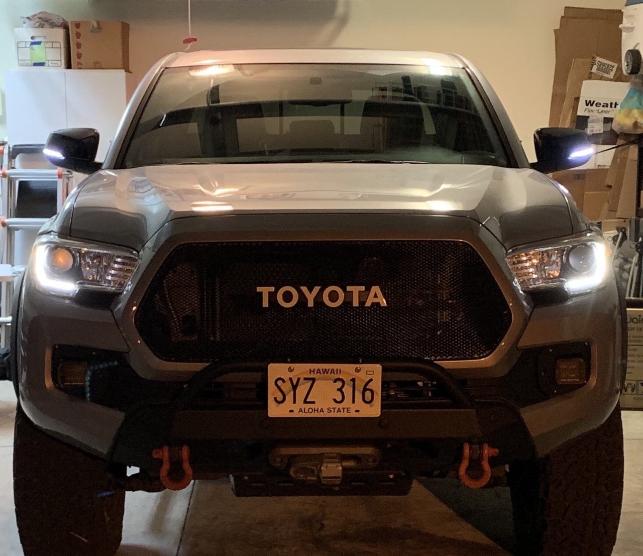

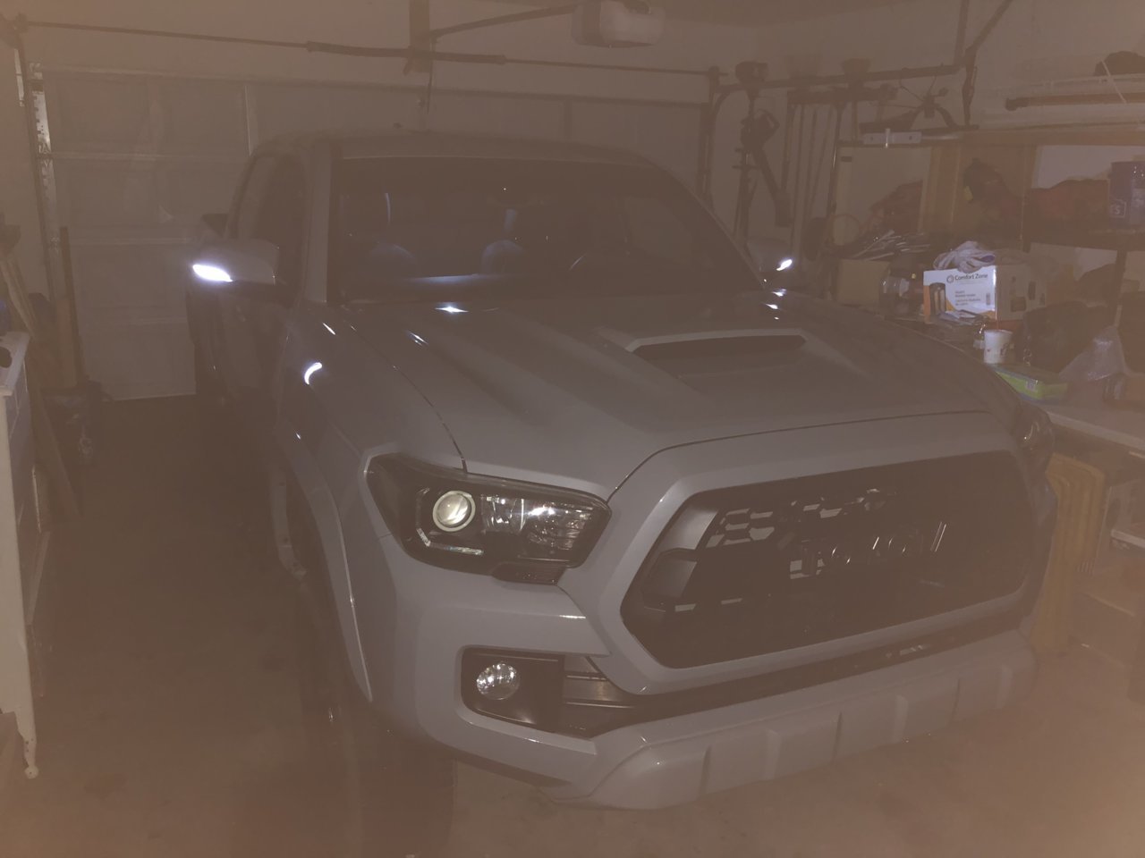

    Took another picture just now, not the best & my halo, DRL, & turn signal DRL all look different whites but it’s not that much of a difference in person

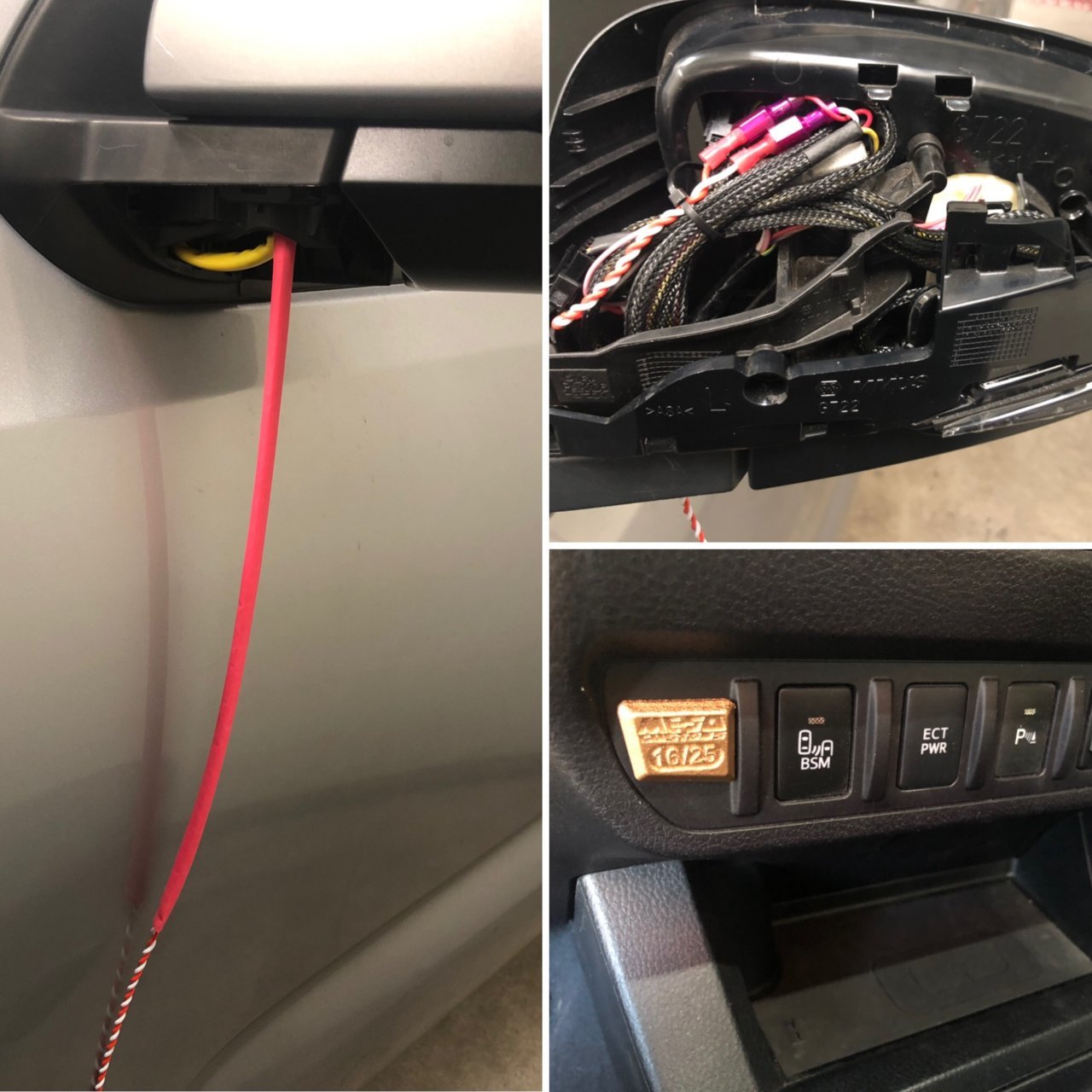

    Was anyone able to pass the red & white wires thu with out removing the mirror from the door?

    You can’t, there’s tape around a little grommet like thing that’s you have to remove to feed it through

    Yes, you may be able to but I don’t think it’ll be easy

    Tape does not need to be removed. Wrap end of wires with duct tape and it will tear through red tape as you push it.

    Gotcha, I just removed the tape & then taped it back with electrical tape
