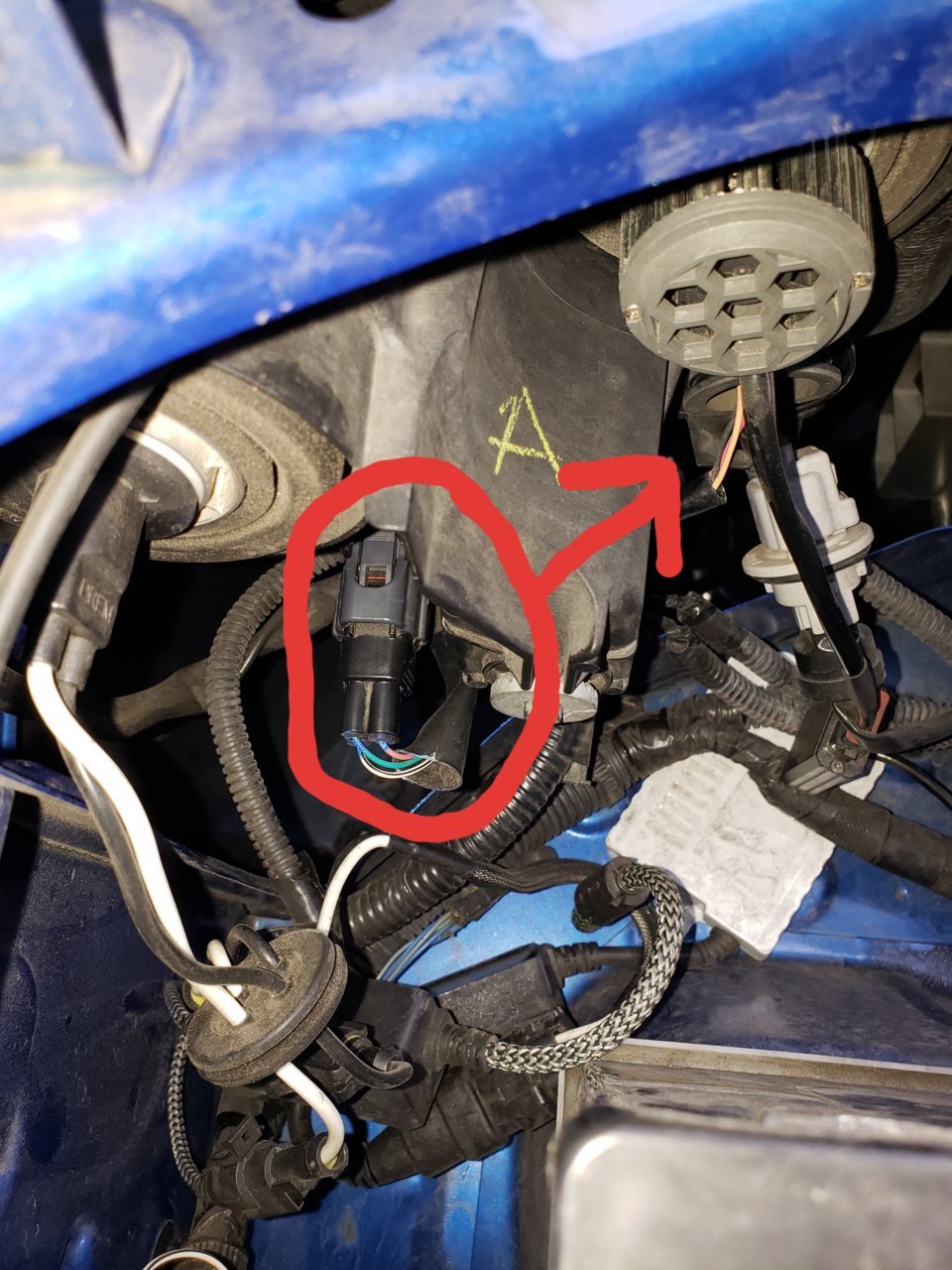

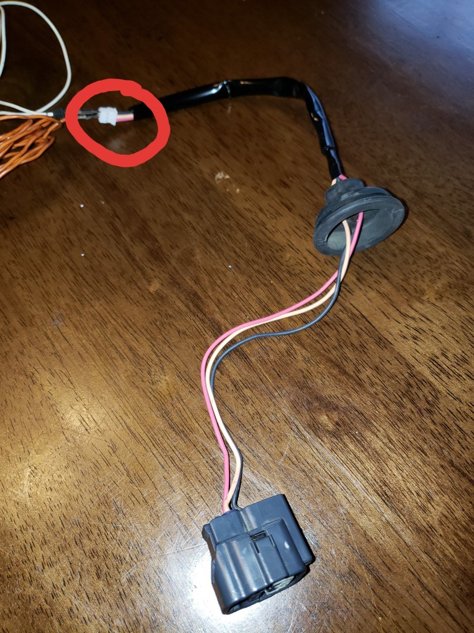

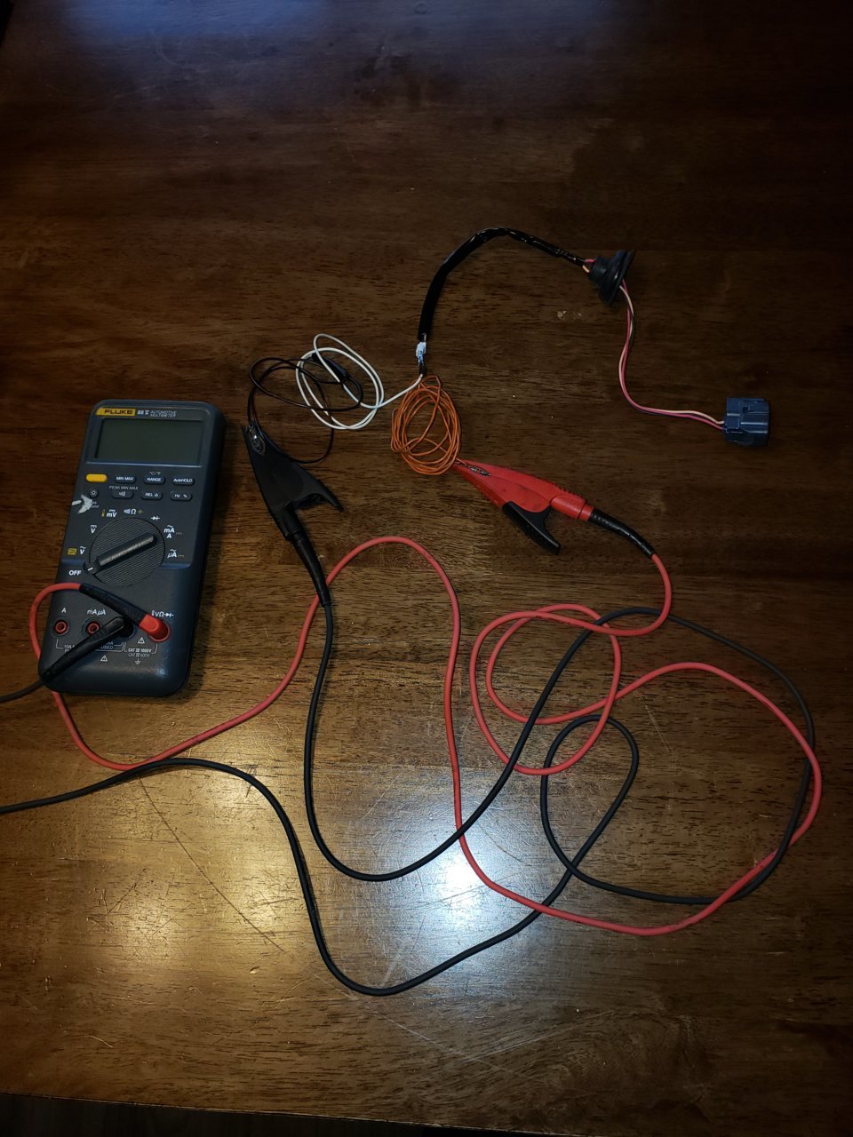

    I haven't done the install yet, but I started looking into it. Both headlights have a dedicated DRL connector. I attached a pic of the driver's side headlight connector and circled it. I drew an arrow showing where the wiring goes into the headlight. I checked voltages for the wiring and both the driver and passenger side headlights are the same on the DRL harness. Black is ground, red is voltage for the bright DRL, and orange is voltage for the dim DRL. I included a pic of the meter and wiring I used to check the voltage. I also included a pic of the DRL harness and circled the white connector that goes into the DRL board inside the headlight.
    It should be simple to run wiring from each of the turn signals. Just route it through the door harness, through the firewall, and to each headlight. You just need to remove the heat shrink on each DRL harness so they can be spliced. Extra wiring can be found on Amazon. Just search for 20 AWG style 1007 wiring.
