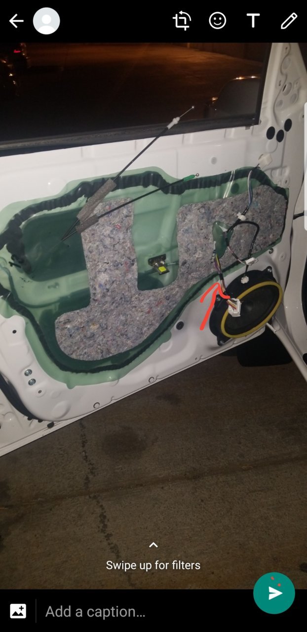

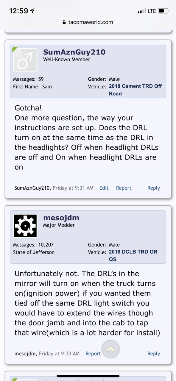

    If you are installing ur switchbacks.. and would like to turn with DRLs.. tap the wiring for the white light in to the window switch.. green cable..

    You found a DRL +12v source(via steering column switch) circuit in the door??

  6. Dec 6, 2018 at 9:34 PM

    Octavio
    Trd pro
    yes sir...

    I mean this is my built.. i am not familiar with your wiring.. im pretty sure is similar to mine...

    Maybe something is diff with your model, but I’ve checked mine(16) and a few others(18’ PRO, 19’ TRD O.R) and metered every wire...couldn’t find one.
    Sure you aren’t referring to the illumination/parking lamps circuit(green) ?

    Not first one i wired... but ok.. i own a pro.. so specifications should be the same.. if you are running DRls.. you are good.. unless ur switchbacks are different..

    Yeah prob just different switchbacks and wiring. Good to know that worked thanks. I think the bright white is a good safety feature during the day.

    Heres mine...
    My wiring very simple...

    I think you're right meso. . Seems octaviolg is tapping into the illumination circuit or in other words an accessory wire. This would have the drl for the mirror be on all the time while accessory is on. This would be different circuit than the drl setup you are referring to in the steering column. So basically before the truck is driven, if installed tapped into the door, the drl on the mirror would be on but at that point the drl on your headlights wouldn't be on. Eventually while driving the headlights drl would illuminate. Correct me if I'm wrong.
    I would prefer to tap into the real drl circuit in the column or elsewhere in the cab and not into a regular accessory wire in the door.

    I did... sorry I’ll get details up on my day off.
    But yes I got it to mimic the factory DRLs.
    On another note. The dimming on the LEs is not as noticeable as the dimming on the factory DRLs but it does dim only when the headlights is turned on.
    Stays on bright when only the parking lights is on.
    Turns completely off when you switch the headlight to OFF on the steering column.
    Also able to turn it off and on from the radio car settings.
