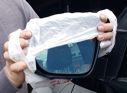

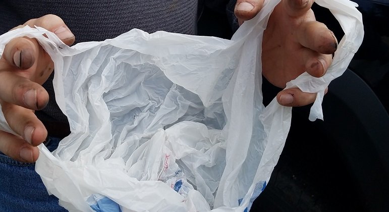

    Any tips for us new turn signal owners when it comes to removing the size mirror covers?

    Use the plastic bag removal method. Or, apply blue painter's tape on the housing before you remove it.
    You will not have a very good grip on it when you first start trying to remove it. When it releases, there is a good chance it can slip out of your hand and land on the ground

    What's the plastic bag method? Put a bag around the mirror and tie a knot, so if it pops off, cover falls into bag instead of ground?

    pretty much. I just placed the bag over the housing and looped a couple fingers into the handles then push edge of the bag up to make a tight fit over the housing and pulled.
    Pardon the grubby hands.

    Tying the bag over the entire mirror would more effective at keeping it off the ground. I just didn't want it to bounce off something else and get scratched anyway.
    I suppose blue tape and the bag would be the old "suspenders and a belt" approach, to be most safeguarded against scratches and blemishes.
