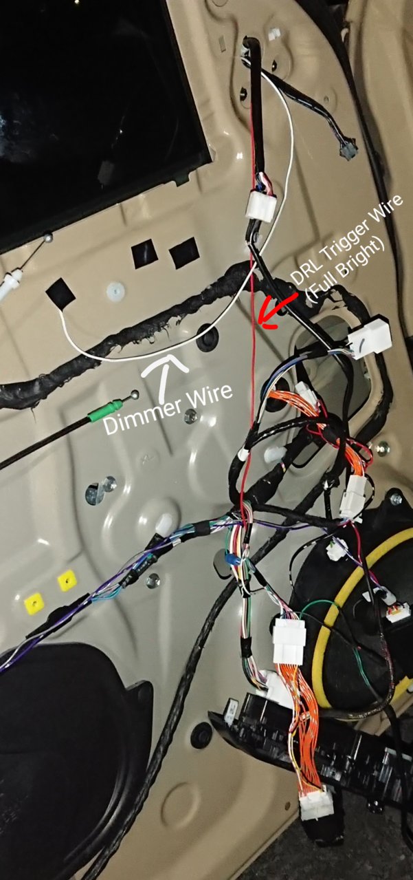

    So it may be a little difficult to see, but here is my wire set up when I initially installed my LEs. I was also installing puddle lights and power folding mirrors, so it is kind of messy in the shot. sketch-1632320466633.jpg
    So the original set up is, the red is tapped to an ignition circuit, and white is tapped into the parking lights circuit. This allows for DRL bright to come on once the truck is turned on and it will dim when you switch over to parking lights.
    Instead, I chose to connect the red trigger wire to the parking light circuit and not use the white dimming wire (I just taped the wire out of the way). Cause why should you ever dim the greatness that is MESO LED.
    So they turn on a step above DRL, since I like them stealth during the day. And I can turn them on at night or even during bad weather conditions. So I guess they are more like NRL (night-time tuning lights).
    I have control over when it turns on, using a relatively easy wire tap. No need to run a wire through the door boot, then firewall to engine bay.
