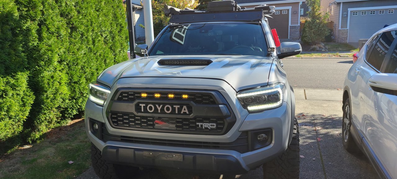

    Here's a pic of the lights working though!
