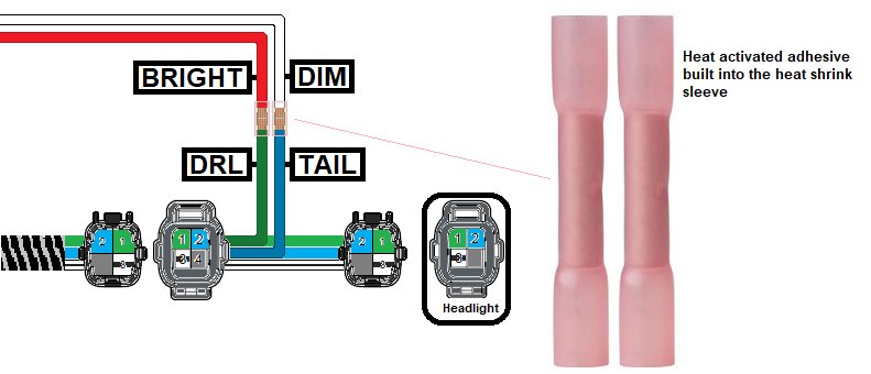

    That's the reason I wired mine to the headlights. I want to be able to keep them off while camping.
    I'm certainly not a wiring expert but this is what I did. I ran the red and white wires from each mirror into the door and then through the door boots into the cabin. I ran the passenger light wires behind the dash and I had just enough wire to get near the fuse box. Then I cut off the excess wire from the driver's light. I connected the driver and passenger red and white wires together near the fuse box. Then I took the excess wire from the driver's light and ran it from Meso's DRL harness at the headlight and through the firewall. Lastly, I connected the wire coming through the firewall to the combined driver and passenger wires. I also soldered all of my connections but that might have been overkill. Hope this helps!

    This is exactly what I'm going to do, most likely with the little self solder connectors and a heat gun. Where did you route the wires behind the dash from the passenger side? Probably going to tackle this install tomorrow or next weekend. My initial thought was under the dash at the top of the foot wells tucked under the carpet and going behind the center console. This is how I have my heated seats wired up right now.

    That's exactly how I did it. I tucked the wires under the passenger carpet, then behind the center of the dash, then I zip tied it along the dash under the steering wheel area.

    Are you running the puddle pods v2? I installed mine and it was simple, mostly plug and play. Red wire was high and it plugged to one of the two wires from the pigtail. I tested both black wires before I soldered them together. Ran the red and black wire pigtail from the top to bottom following the mirror yellow wire, soldered them with solder seals and a heat gun. I will be re-doing it once there's a PnP harness for the LED headlights to gain dimming and DRL functionality with the stalk.
