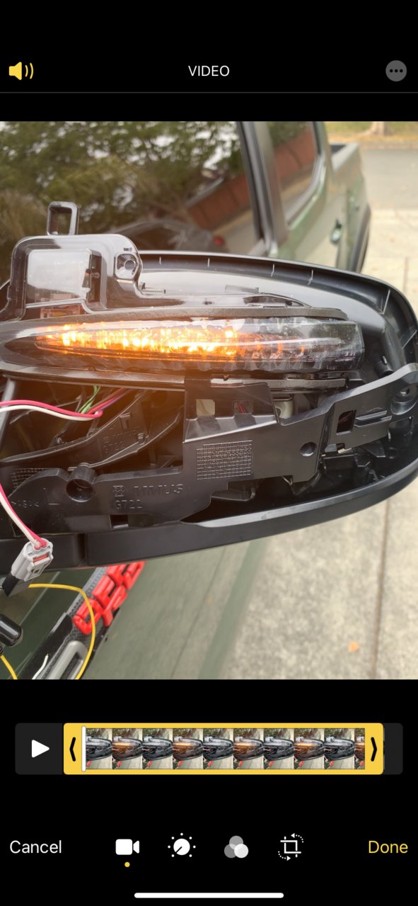

    Driver side 3 leds out I sent in a warranty claim to @MESO it looks so cool except for these missing teeth lol

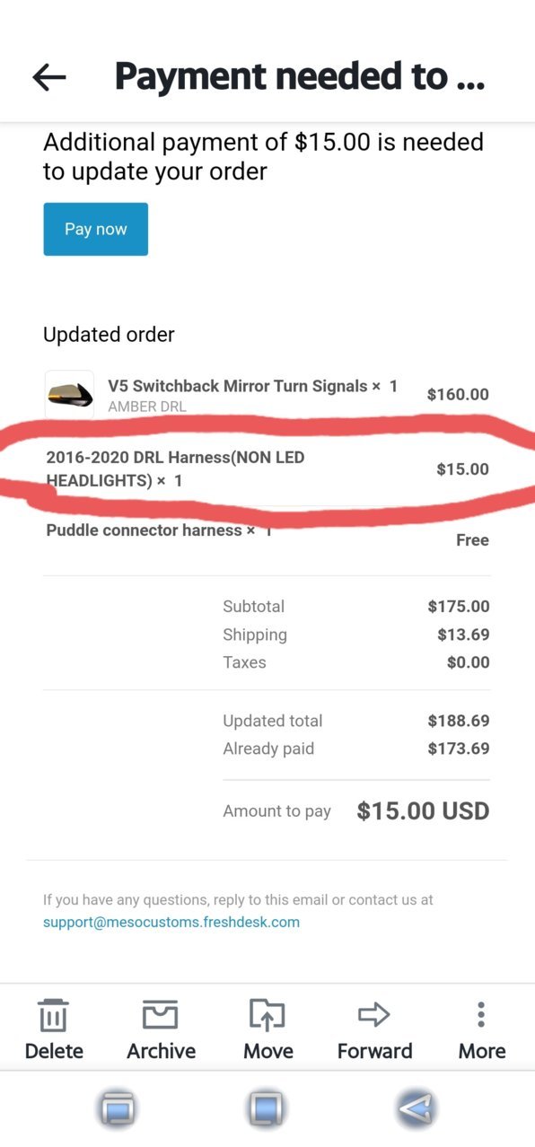

    I ordered the add on harness for 2017-2020 nonLED.
