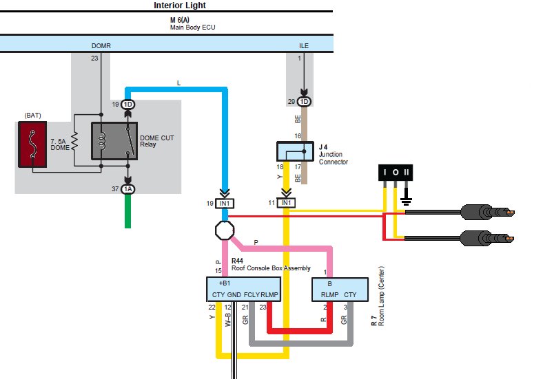

    My overhead lights function normally unless the puddle switch is in auto. Then they don't turn off at all.
    RyanDCLB[QUOTED] likes this.
  7. Sep 26, 2021 at 3:31 PM
    NoeWiy
    NoeWiy Well-Known Member
    Jun 26, 2020
    #332616
    157
    Alex
    Washington State
    2018 TRD Sport MGM DCSB
    I didn't tap the puddle circuit. I connected the pigtail connector that game with the v5 to the red and white cables on the v5. Then I connected the pigtail connector to the wire that was extra from the puddles.

    Here's what I did. I took the pigtail two pin connector that came with the v5 and spliced in the red and white cables from the v2 into the pigtail. Then, I plugged the pigtail into the extra wire that was ran with the puddles. Then, I connected the turn signal connector from the v5 to the stock one on the truck.

    Do the puddles function correctly?
  10. Sep 26, 2021 at 3:47 PM
    NoeWiy
    Jun 26, 2020
    #332616
    157
    Alex
    Washington State
    No. They won't turn off unless I unplug the battery. The switch has no effect on them.
  11. Sep 26, 2021 at 3:48 PM
    caribe makaira
    caribe makaira Well-Known Member
    Feb 13, 2011
    #51121
    11,791
    Caribbean, Puerto Rico
    05 PreRunner TRD Offroad AutoTrans
    Hood Struts, My version Fogs always ON, Map & Overhead Light Mod,
    My guesstimate is you have a bad switch. Remove the harness T that mates the switch to the puddle circuit, and mate the ends as if no switch is there to chose ON/OFF/Auto.

    I thought that as well. Unplugging the switch still left the lights on. I will try taking the harness out though and report back. Thanks all for the help!

    If the switch is not present and the circuit goes ON, then you have the puddle ground wire pinched.

    Is there a difference between unplugging the cable that goes into the switch and removing the harness? Sounds like I pinched the ground on the puddles , most likely when pulling the cable through with the yellow wire for the mirror power (factory)

    Wound that cause my overhead lights to stay on while the switch is on auto?

    With the switch removed you could check continuity from the output of the switch to the puddle connector. No need to open the door panel, window down, puddle light panel removed, puddle lamp disconnected. Carefully probe the connector pins on the face to the removed switch harness. Battery ground removed before you play.
  19. Sep 26, 2021 at 4:38 PM
    caribe makaira
    Feb 13, 2011
    #51121
    11,791
    Yes, if you're talking about the overhead switch in auto.
    Edit: Actually the input from door open (door frame, not at door) and unlock signal is the input that activates the ILE ground in the Main Body ECU. So now the wormhole is pulling harder....hmmm. You might have the unlock wire (very small gauge) pinched to ground.
