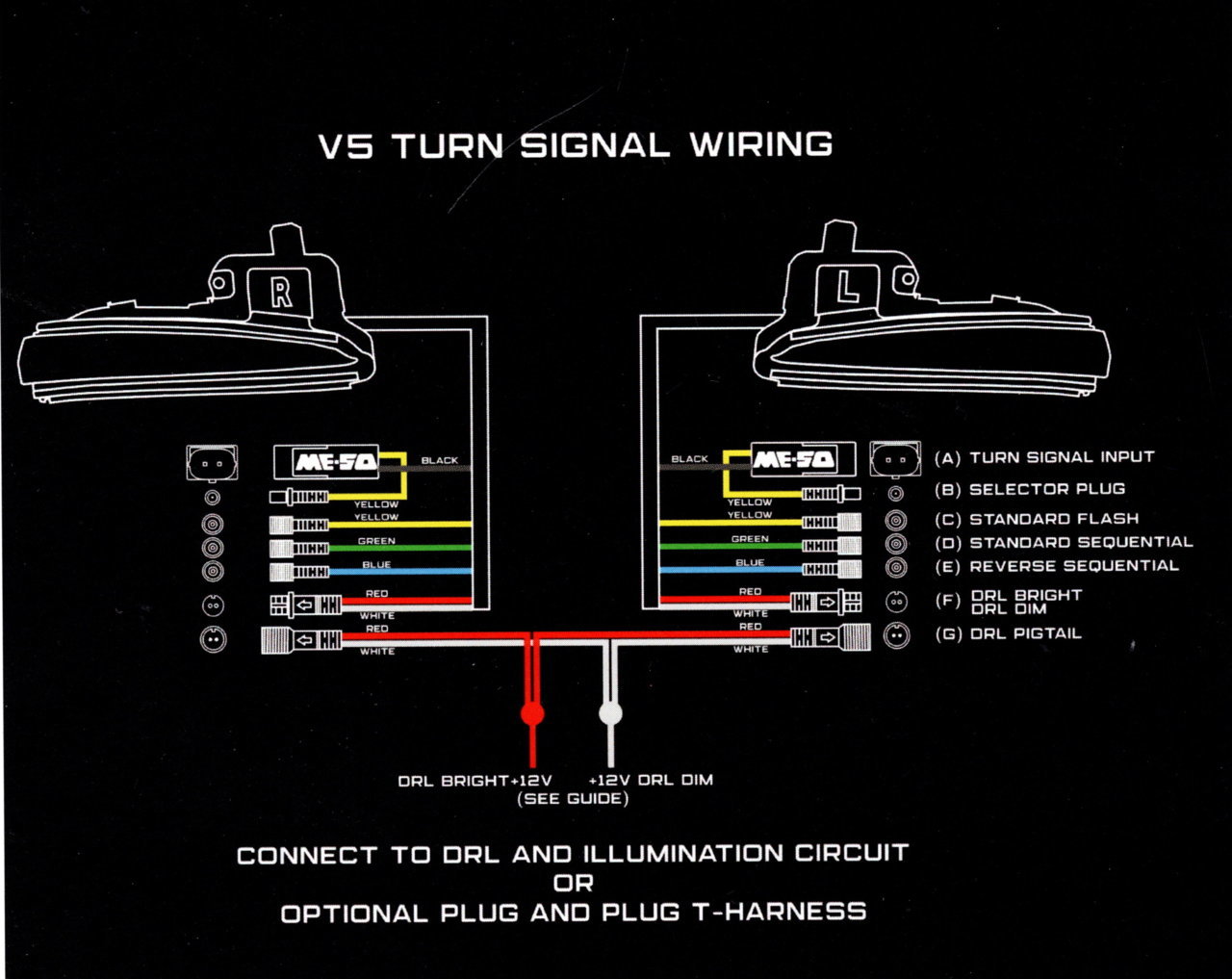

    I've seen a few posts about the drivers side signal having 3 LED's out. So far I have a list of 18 customers that have contacted me about this. While it's not a lot compared to how many went out(almost 1,000 sets) It's more than I'd like to have. I am going though inventory again today to see if I can find one that replicates this issue. I need to pinpoint if it's from assembly(when sealing the halves together) or from production(bad component, driver, etc). Either way, rest assured I have some aside for warranty and can will send out a replacement the same day if you are affected.
    Regarding the wiring. If you have OEM 2020+ LED headlights, I am still working on a large production run for Plug and Play adapters. In the meantime there are a few forums members selling "T"harnesses in the Classifieds section that will work as well. All you are doing is tapping 2 wires; DRL and ILLUMINATION.
    I have received questions if you need 1 or 2 PnP harnesses. The answer is ONE. Both LEFT and RIGHT mirror wires will go through the door and into the cab. Then through the firewall and connect TOGETHER into 1 harness that plugs in behind the headlight. All we are doing is getting power/signal from the stock wires. Theoretically you could tap off either side headlight as the side does not matter.
    IF YOU HAVE PUDDLES and want to use the 2 "pre-wire" that are already in the door, you can opt for this install as well. You will NOT need to use a Plug and Play harness if you go this route. One or the other. Keep in mind, the puddle wires in the door are IGNITION and ILLUMINATION. NOT a true DRL. Basically the signals will turn on bright when the truck starts(and off when it shuts off) but you will not be able to control them though the DRL switch on the steering column stalk. A true DRL signal was not available in the A pillar(puddle) Harness. The ONLY way is to run it in the engine bay and grab the signal behind the headlight.

    Sorry if this has been discussed already but is there a how to write up on running the red and white wires from the turn signals to the headlights where I will connect to the harness provided - IE: best path to follow, steps needed to do this?
