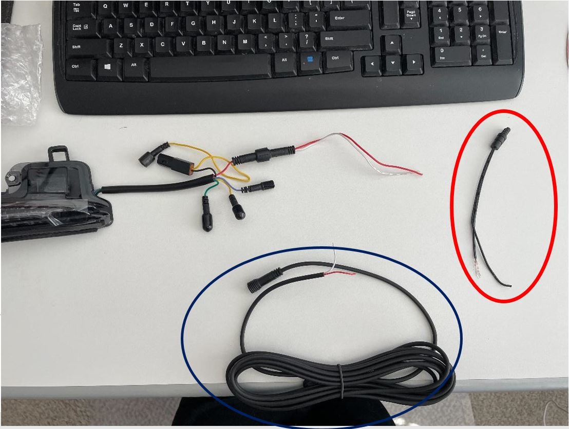

    This was being discussed earlier. I don’t think anyone knows the answer to your questions besides @MESO himself. If I were a betting man, I’d say the connector on your puddle pod’s harness is a positive and a ground. So technically all you would have to do is find the positive from the pods, and attach either the bright(red), or the dim(white) wire from the V5’s to it. Unless that connector needs to be grounded, then I guess you would just attach that to one of the grounds in the mirror, but again, I have no idea. Your best bet is to test the two wires coming from the pods connector. And see what they are.

    Black '17 OR
    Nah those should both be 12+. One for Bright and one for dim. Unless I'm missunderstanding the assignment.

    Puddles have 4 wires. Dome Ground (for puddles) ignition, parking and +12v. AFAIK the puddles use +12v and dome ground which fades. Otherwise puddles would not work with ignition off which is when they are most helpful.
    leaving parking and ignition as the 2 unused wires. Both positive signals. Ignition routes to red DRL and parking to white dimmed inputs to the v5’s. Which is everything you expect minus the ability to turn DRL off when the stalk is off instead of DRL or higher.

    Ahhh, see I was under the impression that when MESO added the connector to the pods, the DRL’s on the V5’s were only on/off. I didn’t realize he had plans to dim them from the start. I thought his plan to dim them came after he sent out the V2 pods. Makes sense. That’s nice having all that functionality(minus on/off) right there in the mirror already! Well done MESO, well done indeed!:thumbsup::thumbsup::thumbsup:

    So to revisit this now that the more knowledgeable folks have chimed in, yes, you connect the adapter circled in red to the red and white wires coming from the turn signal, and then plug it in. Make sure and test which one is ignition and which one is parking lights. Red to ignition, and white to park. Also, the circled in blue longer wires won’t be used in your application.
