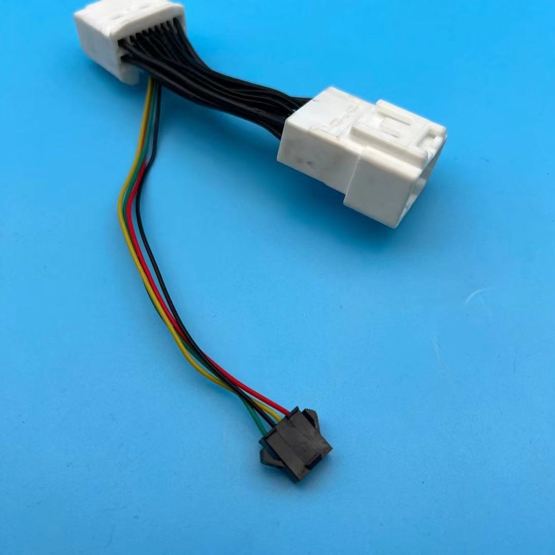

    Alright guys. After some trouble shooting with some extra fuses, I determined that the V5 being plugged in to the puddles is causing the fuses to burn out. After I unplugged the V5 from the puddles and replaced the fuse, the interior lights are fine.
    Knowing this, what could be the problem? Do I maybe have the red and white wires crossed incorrectly with the puddle pod adapter?

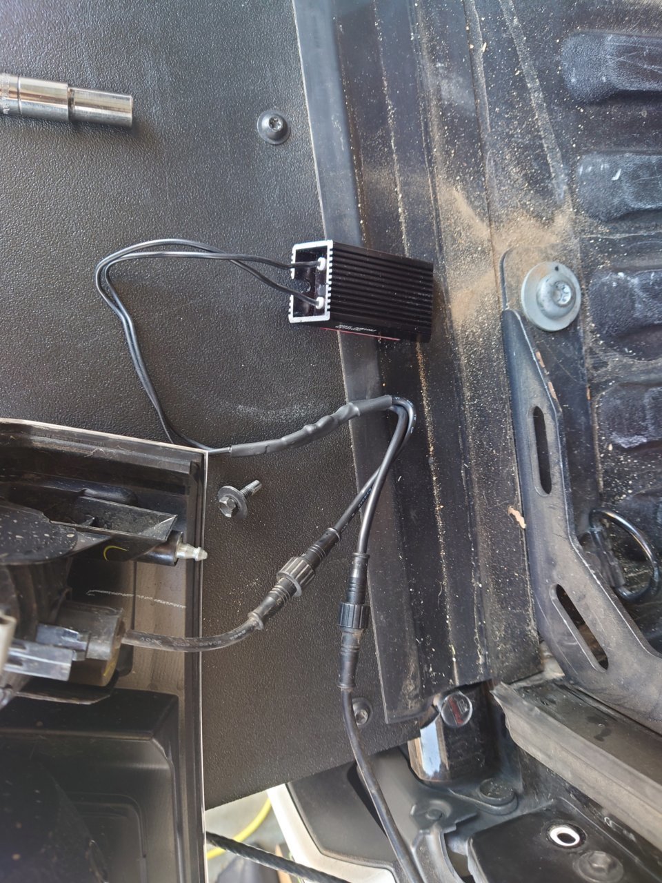

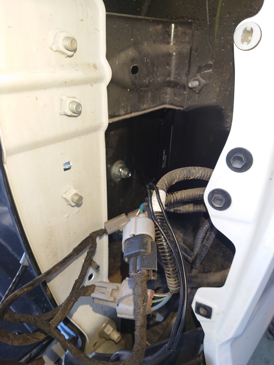

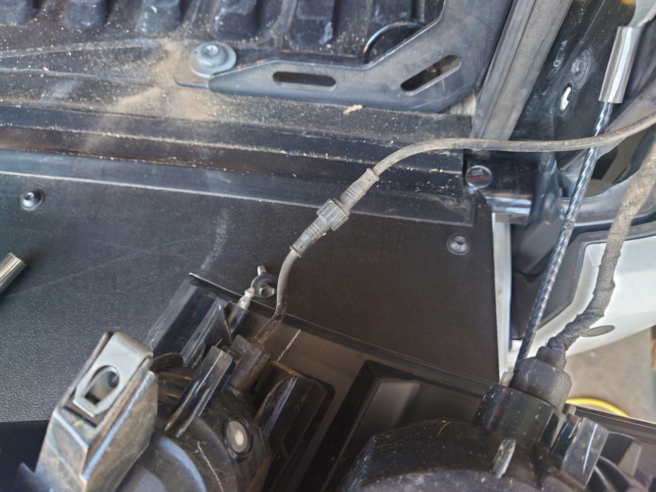

    Resistors arrived today. Took all of 10 minutes to install both sides, which included waiting for the spot that I wiped off to dry where I stuck the resistors. They just connect in line with the existing reverse/turn connector on the total tails harness.
    Best news is, they fixed the hyper flashing DSC_1853.jpg DSC_1855.jpg DSC_1860.jpg

    Can you take a look the A PILLAR T harness? My very first versions didn’t have the illumination tap. But I changed it right after to incorporate that. The easy way to tell is if there are black wires(1st version)or colored wires(current) coming off. That’s my only thought as why it’s not working. Here’s a pic for reference

    they are indeed black so 1st version. What does this mean? What are my options?
