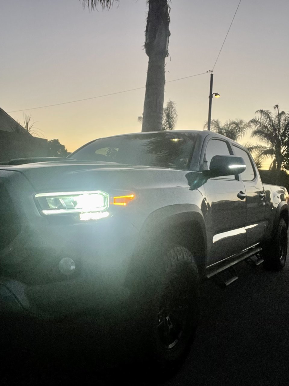

    Finally got it all wired up. Thanks MESO!

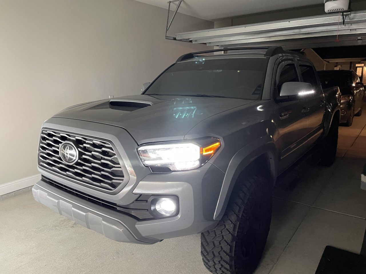

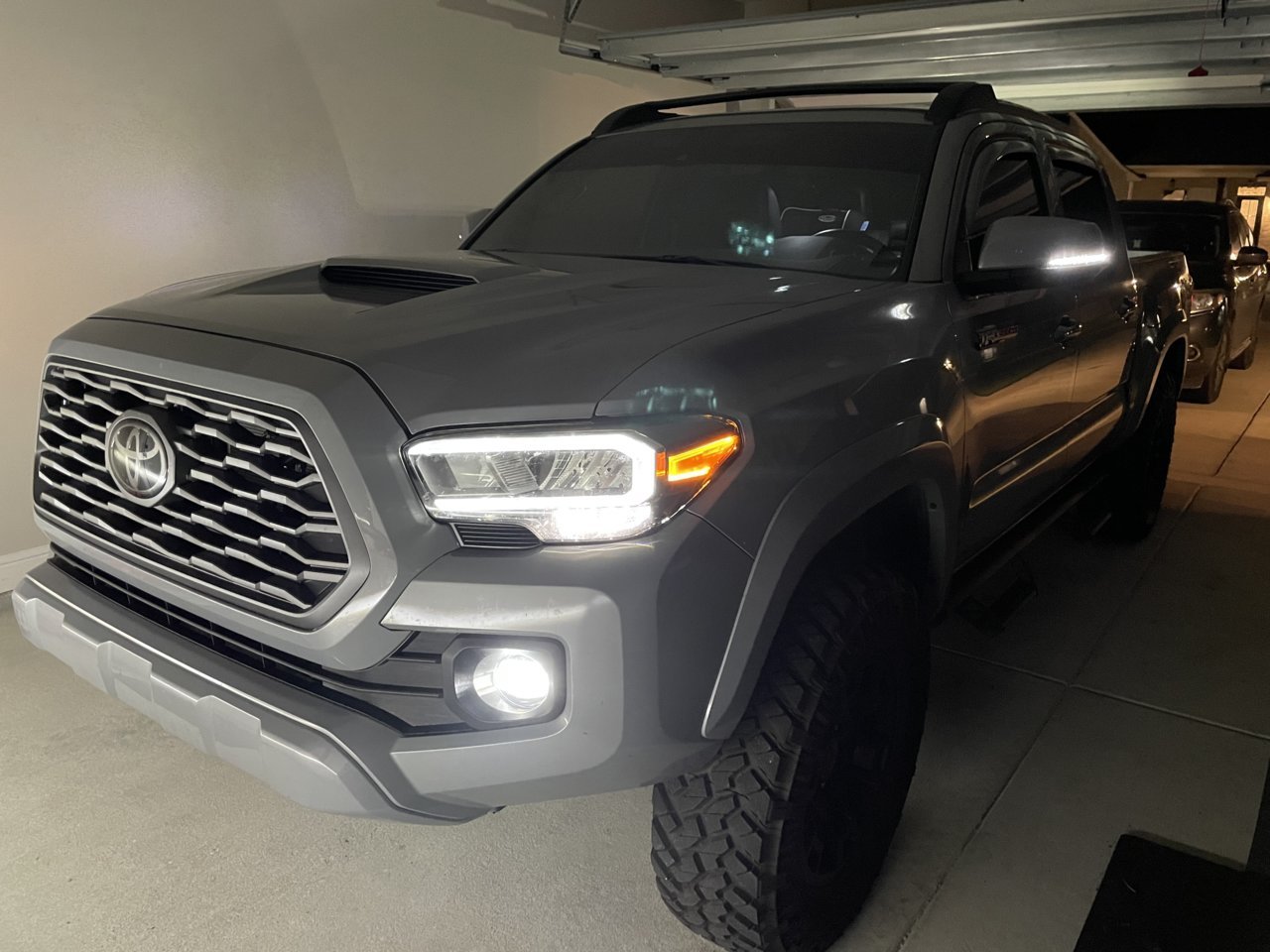

    So it took me a few weeks to install my white / amber v5’s. Normally I wouldn’t wait so long to install a rad accessory such as these, but my dog fell ill the same day my v5’s arrived in the mail (2 days after ordering on their release). Unfortunately after a week of trying to save my pup my any means, i ended up being forced to lay him to rest. This lost made everything else seem pointless. (Loved my dog more than anything). Now that I’m finding the point again, I took the time to get the v5’s on my 2021 double cab long bed trd sport and I have to say I’m super pumped on them.
    I had been chomping at the bit on the v5’s. For me, the switchback drl function of the mirror turn signals gives my truck a higher perceived value. It’s odd that this option is not offered from the factory because it really makes the truck stand out. Nonetheless, I was so excited for the v5’s, yet dismayed by their delay, I went as far as researching and designing my own version. During my research, Meso Customs announced that the v5’s would be released soon, so I put my research aside and decided to wait it out. I knew that anything Meso released would be more than 10x better than anything I could come up with. I’m happy I waited.
    Install is pretty straight forward. Normally I’m A red pill guy (matrix) but since I have converted my headlights over to the oem LED style headlights with sequential indicators, I assumed I would end up choosing the blue pill, to match the sequential indicators of my headlights. Unfortunately when I tested them out, the headlights and mirrors flashed in the same orientation, yet their timing was just ever so slightly off. As a result I ended up choosing the yellow pill, mirror turn signals flashes like a normal indicator. No matter. As mentioned above, I wanted the v5’s for the drl function more than anything.
    The most challenging part of installing the v5’s was running the wires through the rubber boots between the door and the truck pillar. Since I had converted my truck over to the oem led headlights, I had to install a harness to mate my truck’s factory headlight wires with the connectors of the oem led headlights. Because of this, I was able to use the drl headlight adapter that Meso offers. Normaly I would opt to try and tidy things up by stream lining the connections instead of connecting Adapter to adapter, but the mess isn’t too bad that carefully placed zip ties can’t fix AND it gave me a little extra length for the drl wires from the passenger v5 to reach.
    After running this wire through the passenger door and under then across the dash, meeting up with the harness from the driver’s side mirror, then through the firewall with the harness from the passenger mirror, the harness JUST reaches the drl adapter. Initially I thought it would be short. Thankfully it wasn’t but I did have to trim the driver side harness to length.
    The quality of the v5’s that I received are great. Fortunately I don’t have any dead led’s nor do I have any hyper flashing. (I do have Meso tail light kit stage 1 installed, but even with that kit installed, I still haven’t experienced any hyper flashing). The white drl function of the v5’s is awesome as is the switchback to amber indicators.
    All in all I am very happy that I waited and happy with my purchase of the v5’s! I even upgraded my speakers during the v5 install since I had the door panels off.
