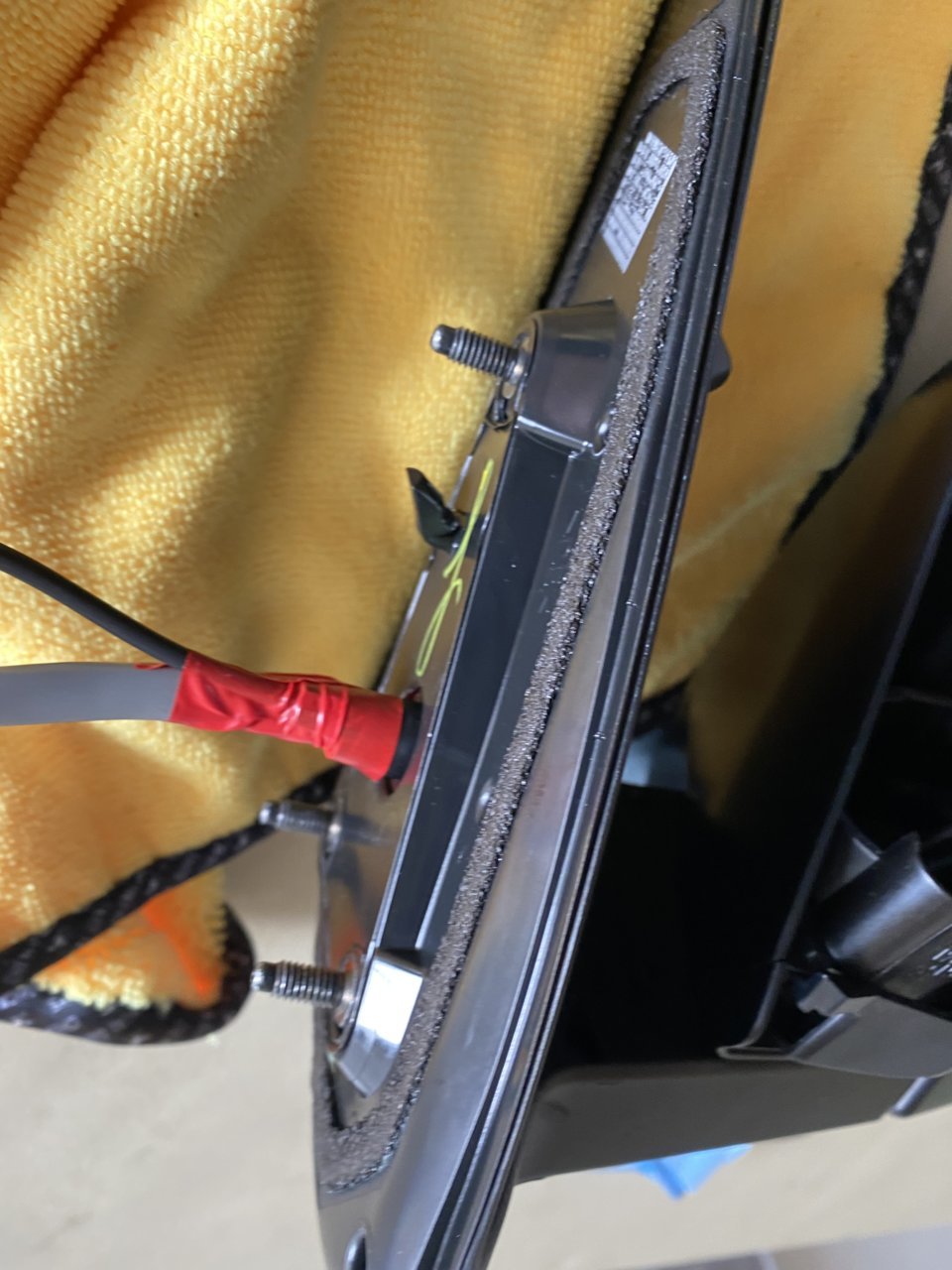

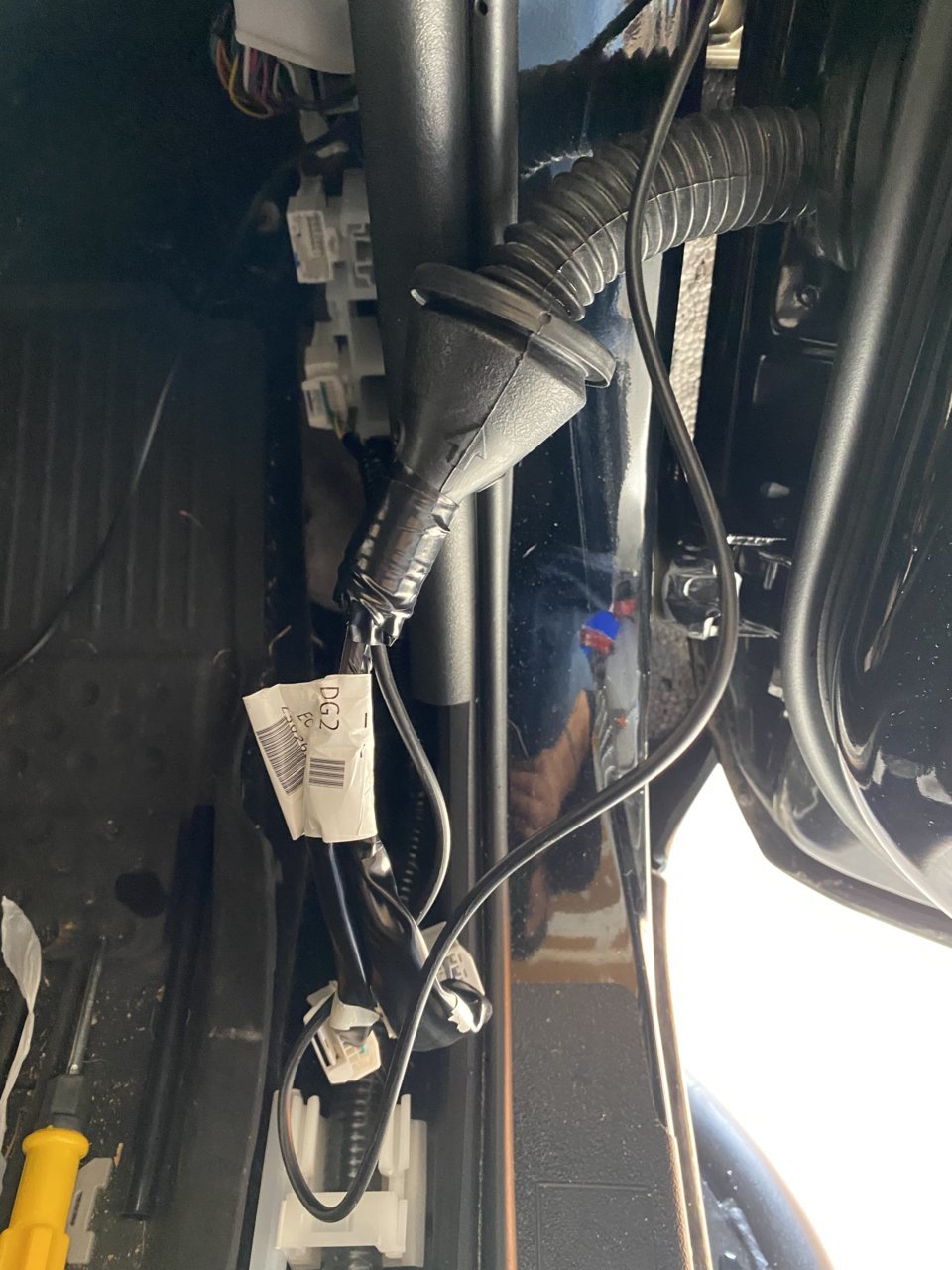

    Sorry about resurrecting a thread that has been beat to death, but want to confirm a couple things from those that have done the install.
    Going to finally get around to installing V5's over holiday break, after bench testing...fingers crossed that I have a good pair. As far as disassembly, I get that the door panels need to come off in order to fish wiring through door boot, but do mirrors have to be removed as well or does it just make the job easier? I have factory LED headlights, one of Dave's custom harness connectors for factory LEDs, Meso Total Tail 1 with resistors, and no Puddle Pods. Thanks all.

    i took the mirror off. I’m not sure I could have ran the wire without it, or at least it would have made it more difficult. It’s 3 nuts holding it on so not much to get it off. Put your windows down before you start lol.
    I also recommend disconnecting the wires that go through the door so you can easily deal with the rubber pass through thing. Makes life much easier. You can see the backside of the mirror in the first pic and the door pass thru in the second.
