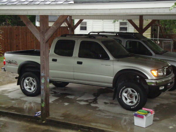

    ok guys I've started posting pics in my gallery...more to come....let me know if yall can see 'em.

    Started install @ 10am saturday till 5 pm saturday evening. Install wasn't terribly difficult, I had a buddy help who was familiar with what we were doing.
    Installing front coilovers, one of us had to stand on the wheel assy to push down to line up the bottom bolt. All went well with rear add-a-leaf. Guessed where the aluminum plate went, as mentioned, no instructions on that part.
    Instructions said coilovers were set at 2 - 2 1/2" from the factory. After install the front was way higher than the back. It took some time to crank them down, glad I had help, much easier with someone helping.
    My truck sat at 34 1/2" in front to the bottom of the fender flare, ans 36 1/2" to bottom of fender in rear.
    Now it sits at 38" front and back.....so how a 3" lift kit, set @ 2 1/2" from the factory, and cranked down to be level...how that gave me 3 1/2" of lift up front and 1 1/2" out back...I don't know.
    It rides good, the alignment was not way off, the ride isn't greatly improved but certainly hasn't gotten worse, feels good as new.
