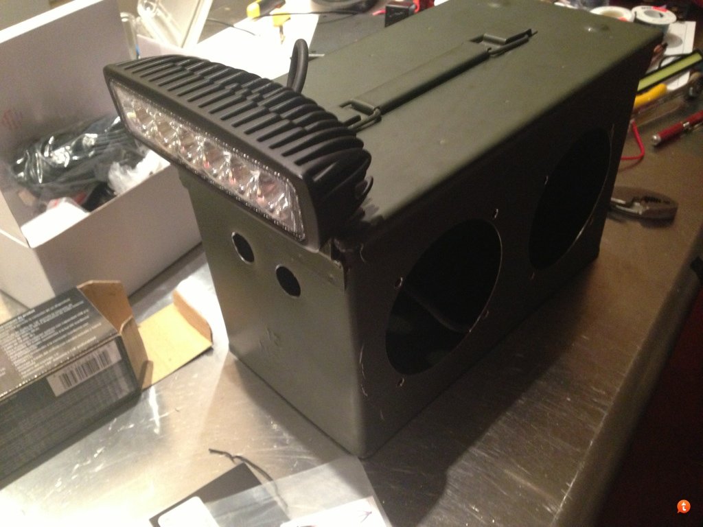

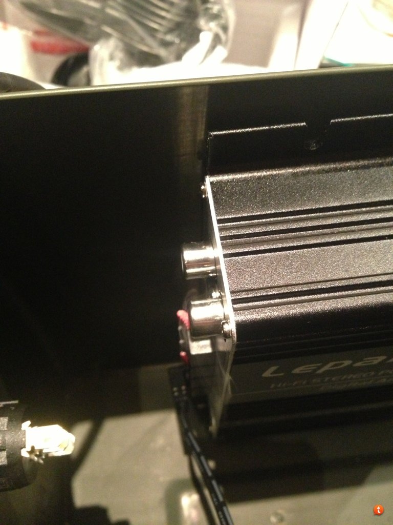

    All of the bits for my box showed up today. It turns out the amp has a 3.5mm jack as well as the RCA jacks. I may just keep this simple and use the bluetooth adapter internally instead of adding the external port.
    That means I'll have to open the box for certain operations, but that's no big deal. I don't expect to try and change the song while it's pouring rain on me. :D
    As for charging the phone I'll just wire in a female cig power outlet inside the box and use a car charger. Should work for the time being.

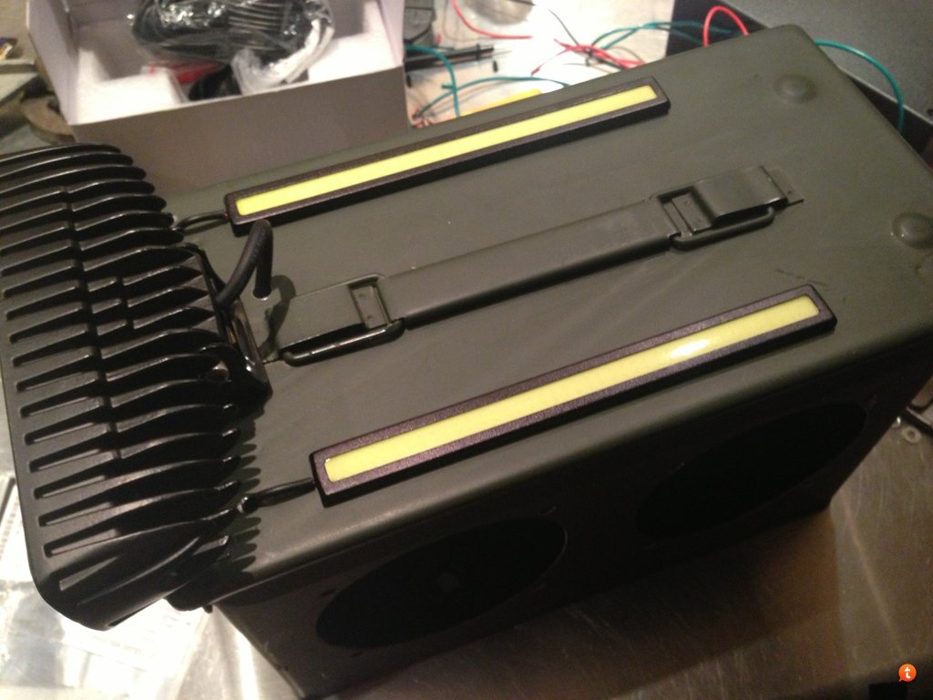

    External switches, or are you using the one built into the battery?
  18. Apr 2, 2014 at 8:30 PM
    #58
    SMKYTXN
    Mar 11, 2011
    #52810
    14,040
    Nathan
    Houston
    11, 4dr, TRD Sport, 6sp
    DCFB

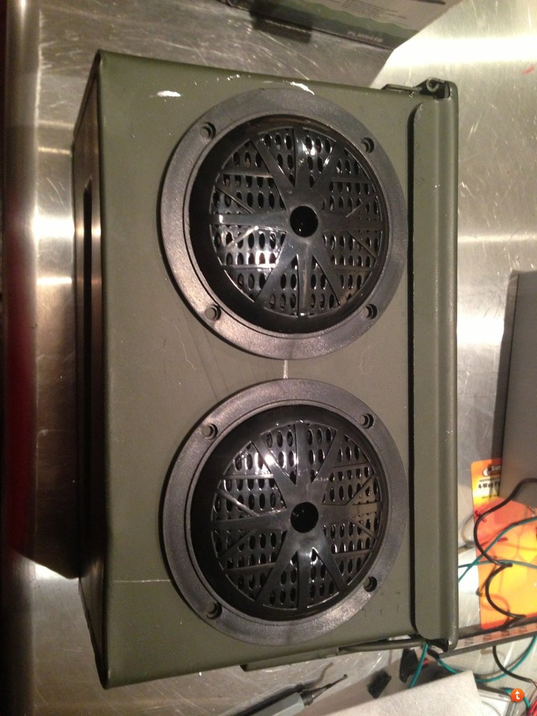

    Two external switches. One for the spot and the other for the floods. The amp has a switch as well as the battery so those are covered.
    I don't understand how they can label these speakers waterproof. They don't provide a gasket or seal of any kind. I'm planning on running a bead of silicone around the perimeter of the speakers to seal them.
