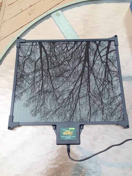

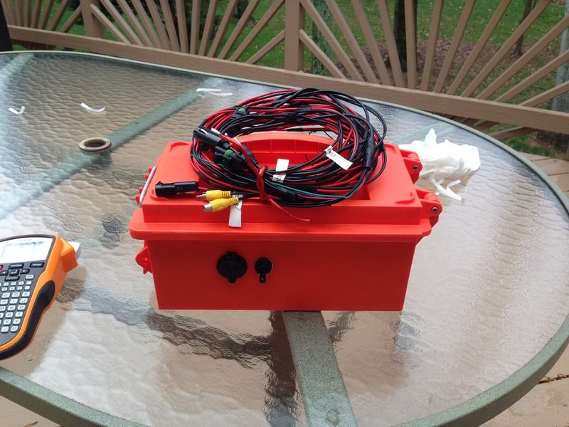

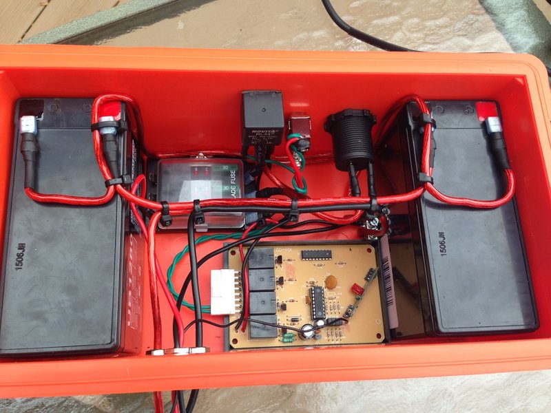

    end result: I built a waterproof box that houses batteries for the light, so It can run independent of the boats electronics. it also house all of the circuitry and wireless module. the wireless unit and the lights are powered by two 12 volt batteries, and it will run the lights for a long time, but I wanted this to be a set it and forget it kind of thing, so I wired up a solar panel with a built in charge regulator, so they'll never have to manually re-charge the box.

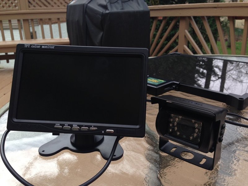

    then my mom mentioned to me that my dad was looking into having a backup camera installed on the boat, to make getting in and out of smaller slips at the dock easier with just a single person. so now the box and remote also power/activate a backup camera and monitor.

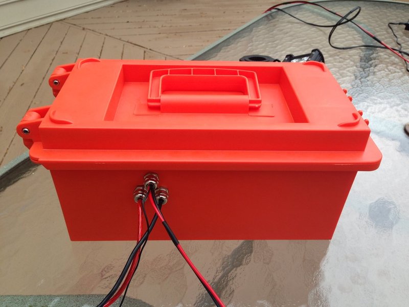

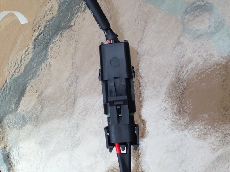

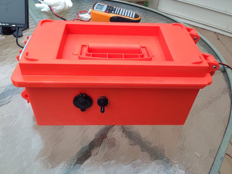

    the box itself. master on/off switch, and a 12v charging plug (just in case you want to charge a phone or something).
    waterproof wire penetrations. top one is power in for the solar charger. bottom two are power and ground out to the lights and camera.

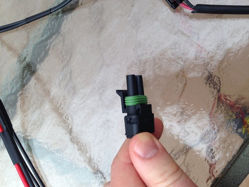

    the guts
    solar panel. just over 1 square foot. box sticking off the bottom is the charge regulator.

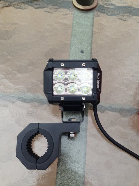

    gave him two lights with some pretty serious brackets to mount them to the handrail on the upper deck of the boat, facing backwards, to light up everything behind the boat.
    the monitor and camera. the monitor may not be needed, as I think the nav system on the boat has video in channels. being that it is going to be around salt water almost constantly, I got a more robust, durable camera than what I use on my truck.
    waterproof plugs on everything

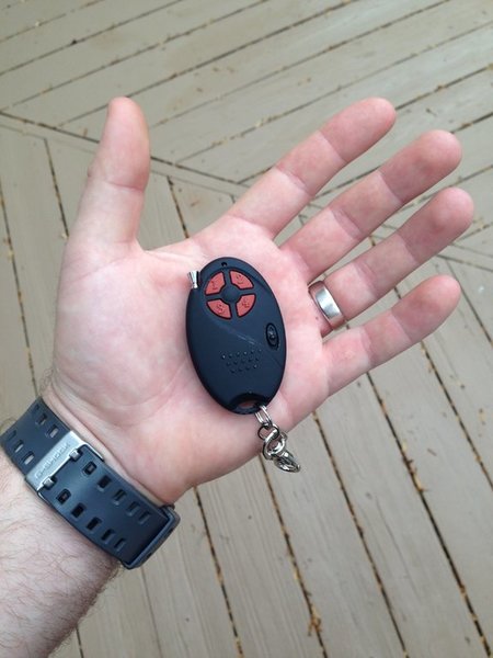

    the remote. tested at roughly 1/8 of a mile, and it worked great. couldn't test from any farther, since I would have needed some waders to walk ant further away.
    wiring harness all coiled up, ready to go down the boat for install.
