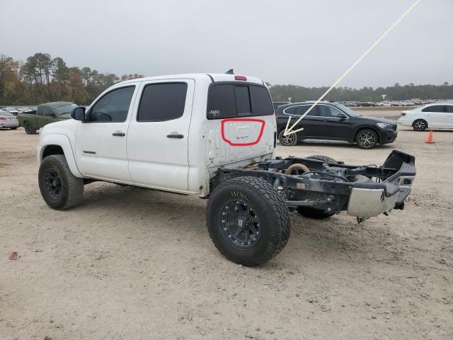

    I did the pool noodle trickover a year ago, but I was never sure exactly where to stuff it. I placed them vertically on the DS and PS between the bed and cab. Seeing the post from @N64_Wallmaster got me thinking and that got me to searching.
    That search revealed that I didn't do it right. I found that the noodle is supposed to go horizontally between the bed and cab. I had one noodle left over so I went out crawled under my truck and stuffed it!
    While under there I noticed that the vent on my 07 AC is dead center on the back wall of the cab. See the attached "borrowed" picture showing (circled in red) where the vent on my truck is.
