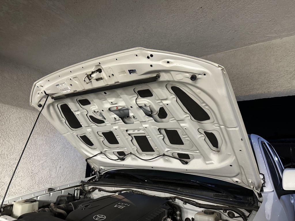

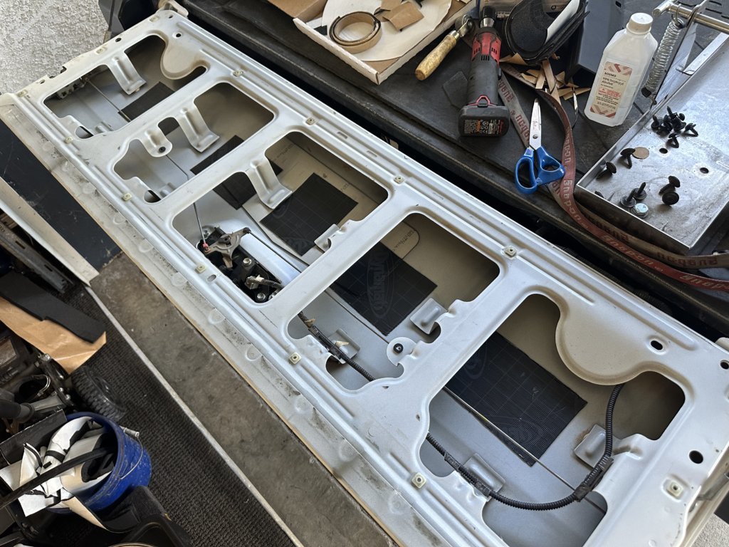

    Using extra material to sound deaden the exterior panels and see if it further reduces noise inside the cab. So far I’ve got the hood and tailgate complete. Next up will be front fenders and rear bedsides. I’ll post the results when I’m done!

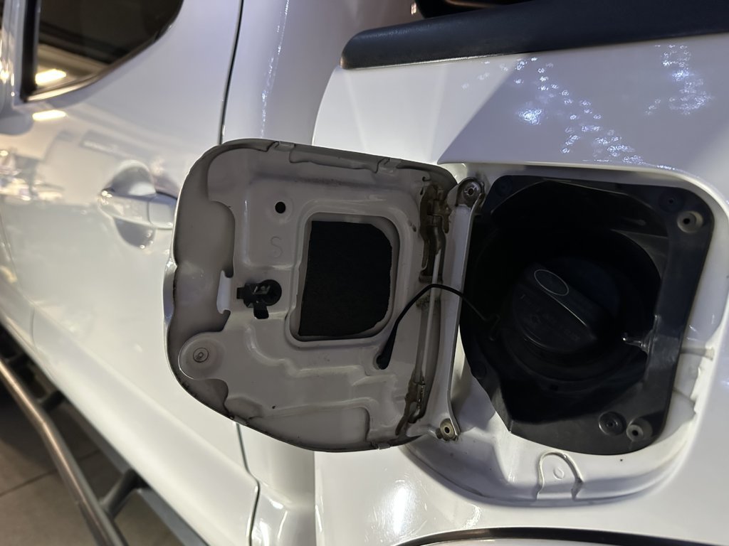

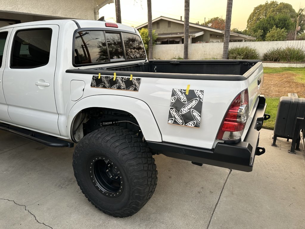

    Bedsides and gas cover today.

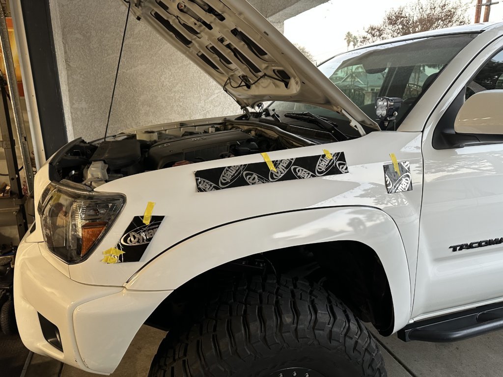

    Front fenders and C4 Fab fender liners today.

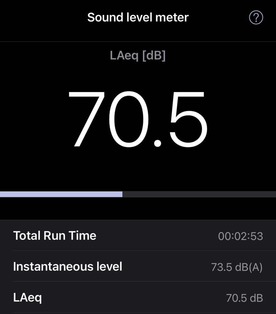

    Just went on a test drive and measured the db after sound deadening the exterior panels. I recorded a huge drop in db levels! The last time I was at 75.7db and now it is at 70.5db for a total reduction of 5.2db.
    A lot of the mud terrain tire noise is diminished and the engine noise is much more relaxed. Overall I would definitely recommend if you have the extra time and materials.
  13. Dec 5, 2024 at 6:15 PM
