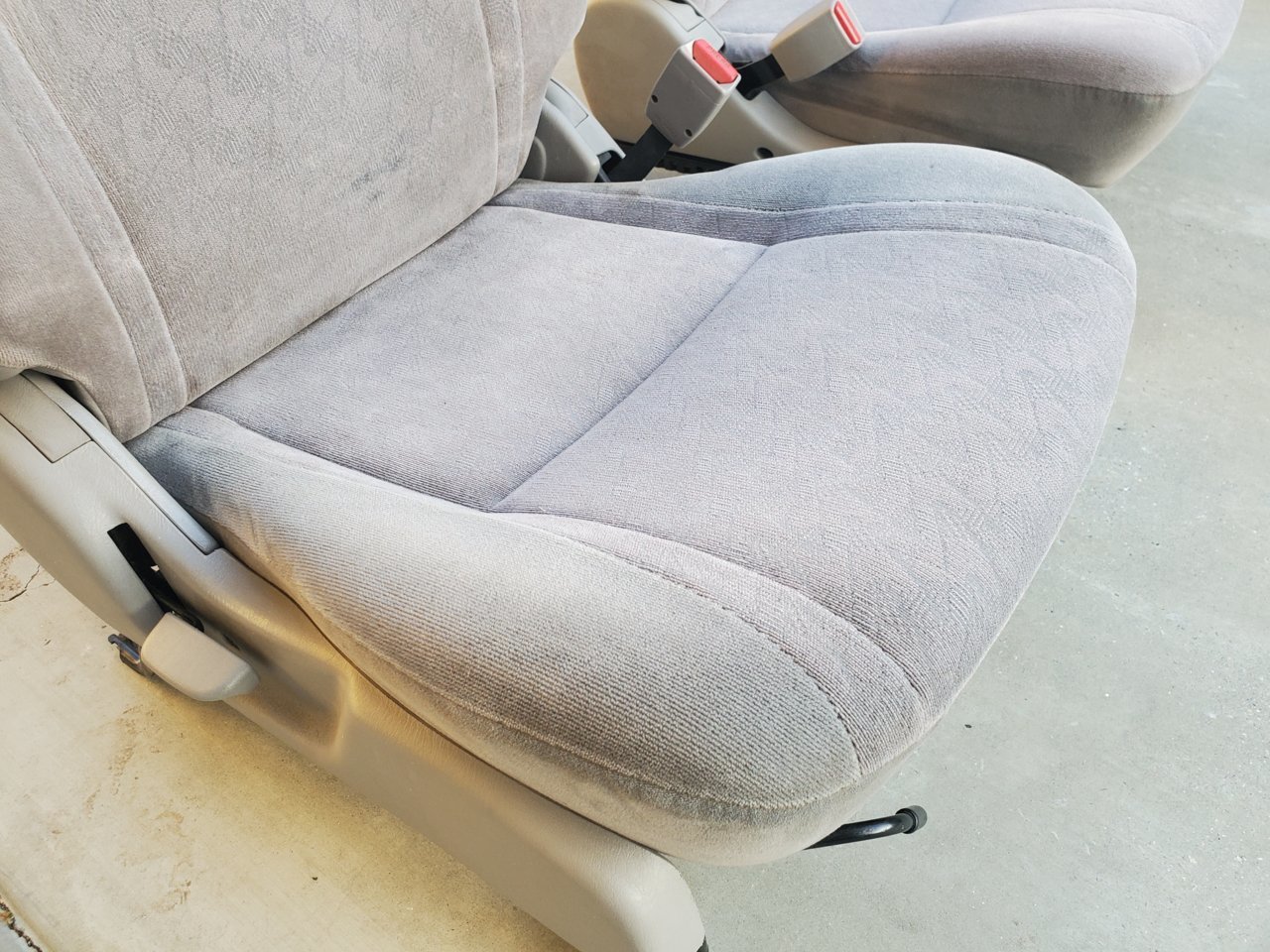

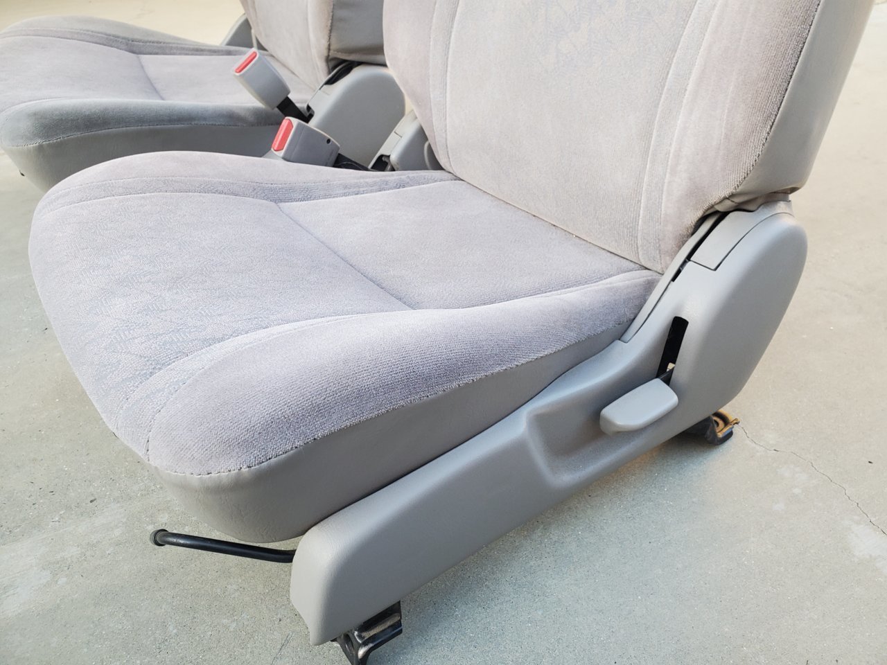

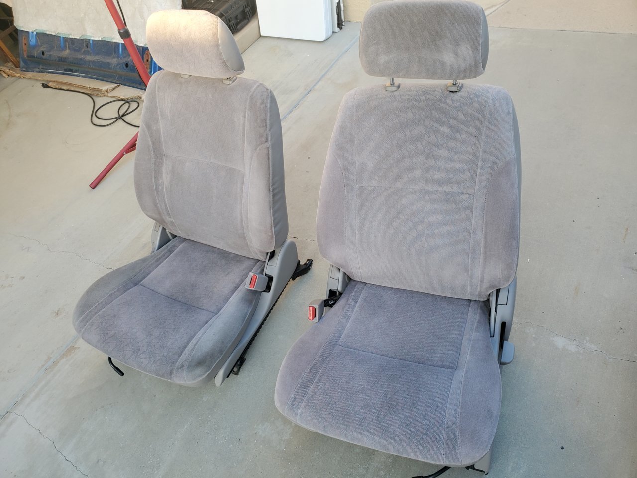

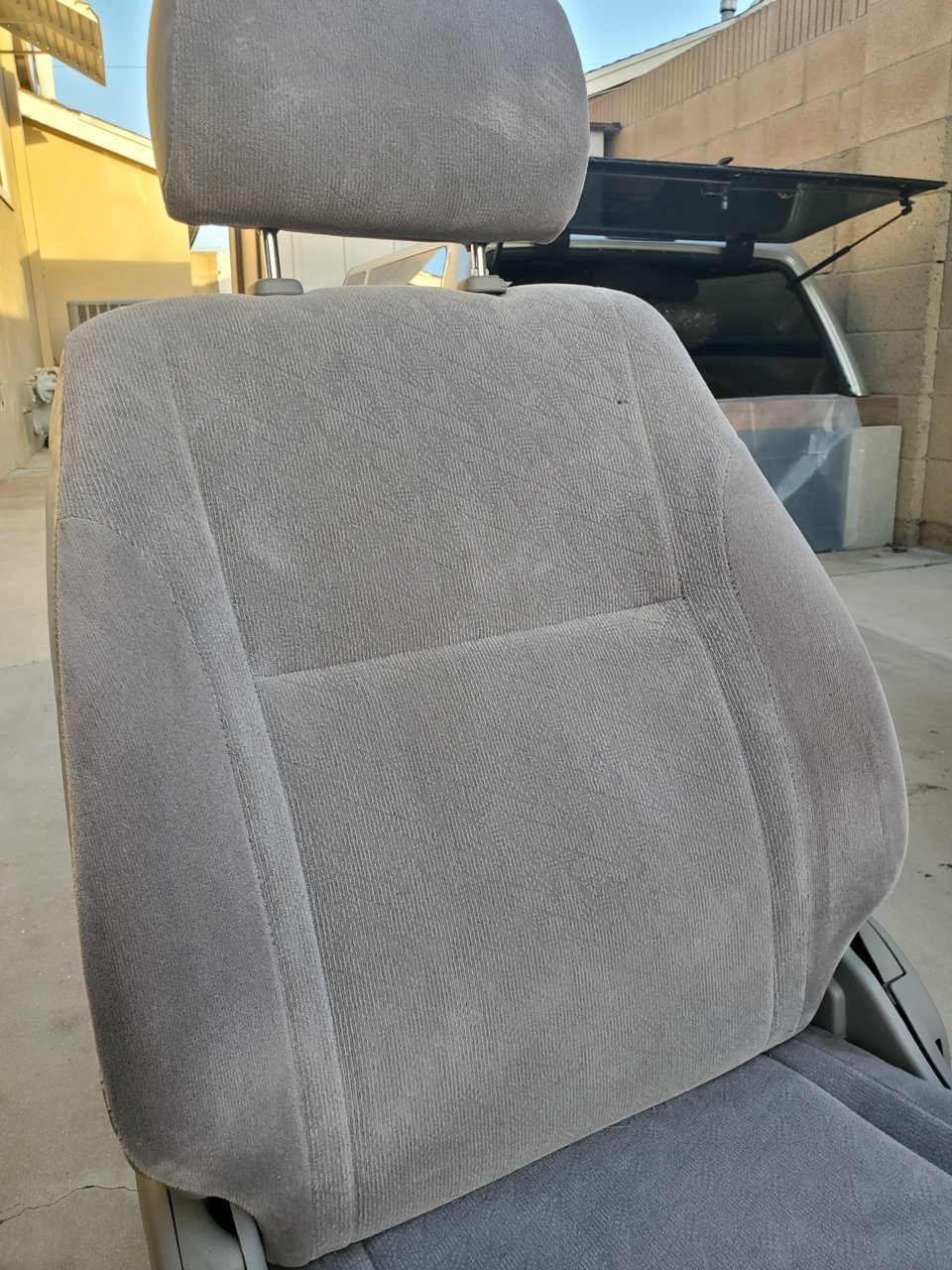

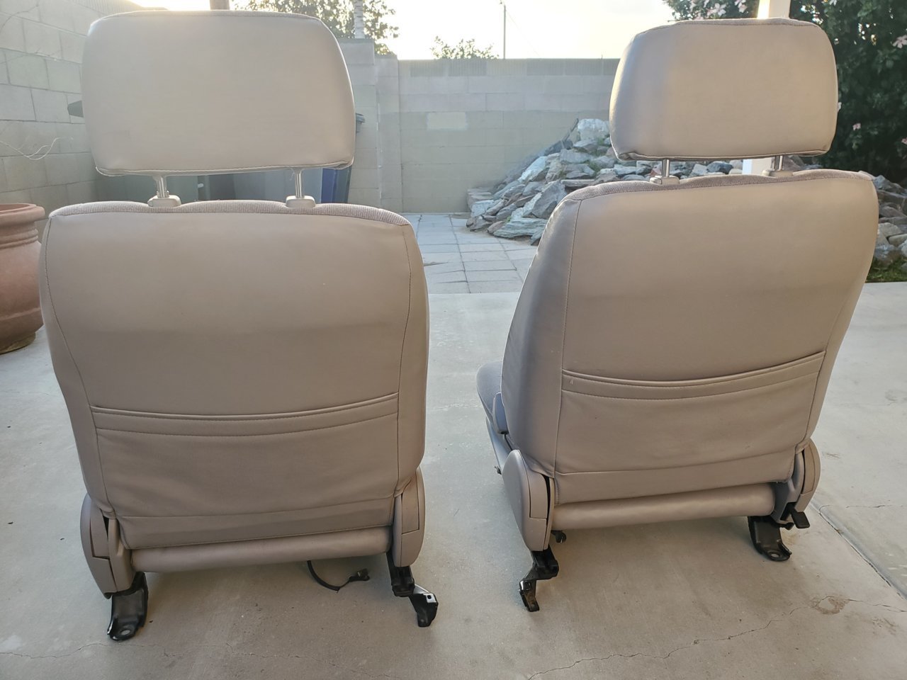

    Here is a sample set I recently fixed up swapping cushions from the best of parts I had on hand and a good cleaning. These are 2001-2004 standard bucket seats in "charcoal" or gray.
